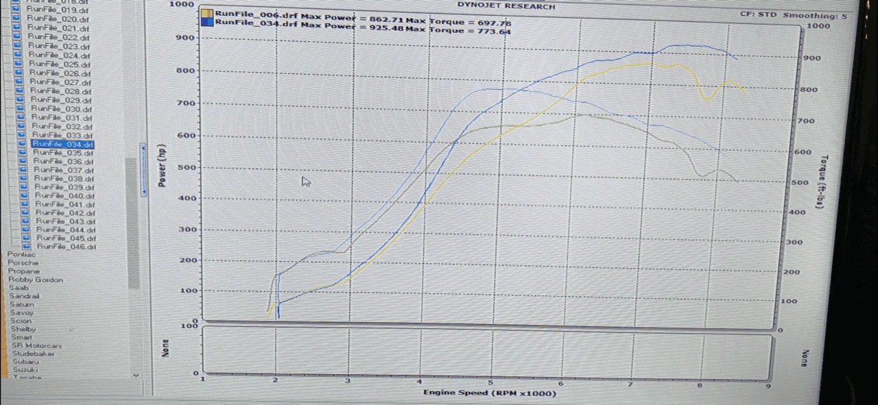

YES. to be clear: the 6 port head is a direct plug and play upgrade for the 2 port head. Everything from cams and valves / springs / retainers / Sensors / injectors / fuel pump are all the same and can be swapped over. Dyno comparisons below. We're using borgwarner's EFR9280 turbo with Full Race twinscroll kit, and standalone motec ecu. the ONLY changes here are 6 port cylinder head + 6 port exhaust manifold and tune.
1/ Midrange: This first comparison shows 2.2bar boost. The yellow line is the A90 2 port head VS. the blue line of A91 6 port head. First few pulls after the 6port head and turbo manifold install - the 6 port (blue line) consistently gained ~200ft lbs of torque at 4500rpm and carried those gains through the rpm band. zero loss of performance anywhere. this is absolutely massive.

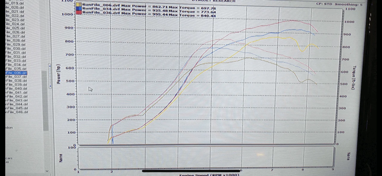

2/ Top end: the 2 port head (yellow line) chokes at 32 psi (2.2Bar) boost. Porting, cams, valves, etc won't make more power.
But the 6 port (blue and red lines) is operating on another level entirely. The red line added here shows the 6 port head at 38psi (2.6 Bar) boost and the turbo is able to stretch its legs. <995whp without nitrous>

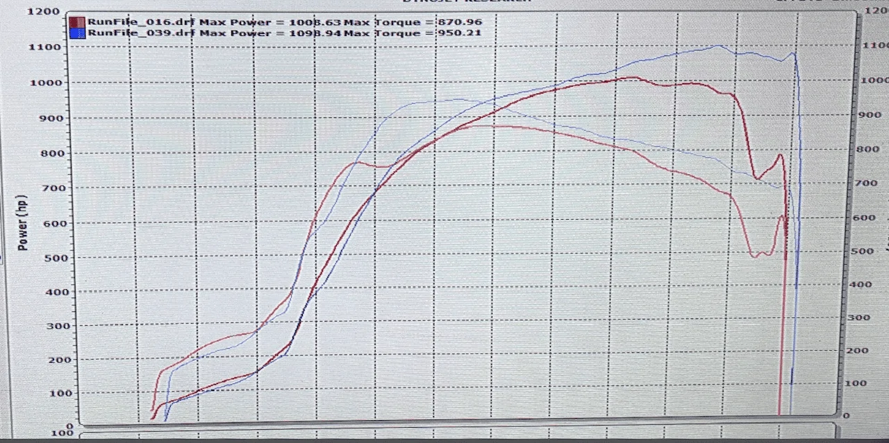

3/ ALL IN + 50 shot nitrous. The 2 port head all-in @ 32psi + nitrous (red line, 1008hp) VS the 6 port head 36psi + nitrous (blue line, 1098hp)
at this power level the 2 port head is completely choked and the nitrous is not helping. After trying every trick possible to get more from the 2 port, the HP and Torque fall off in the upper RPMs ... while the 6 port head is steady at ~1100hp. We did not want to push the 6 port motor any harder on the dyno, will save that for the track
