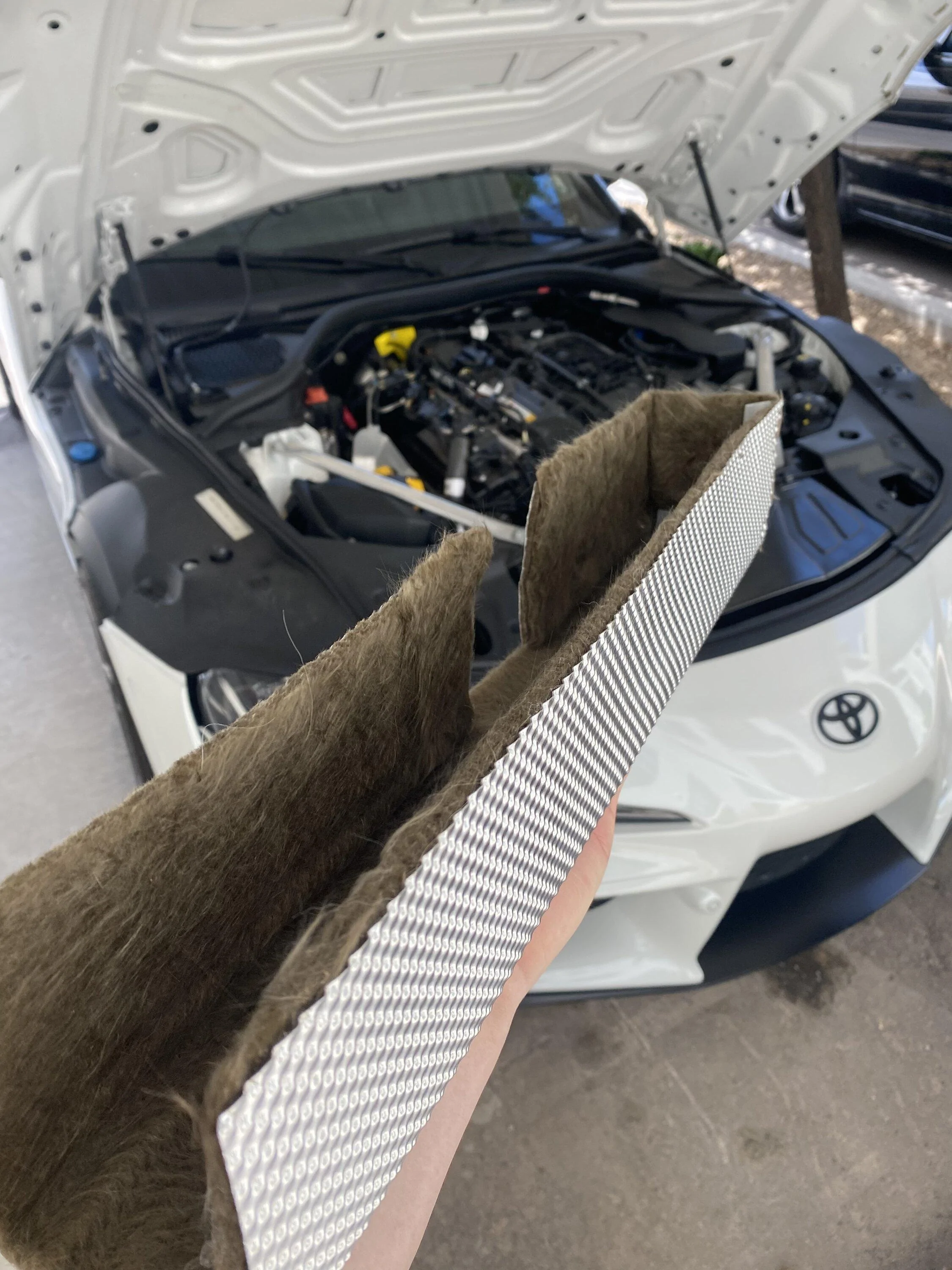

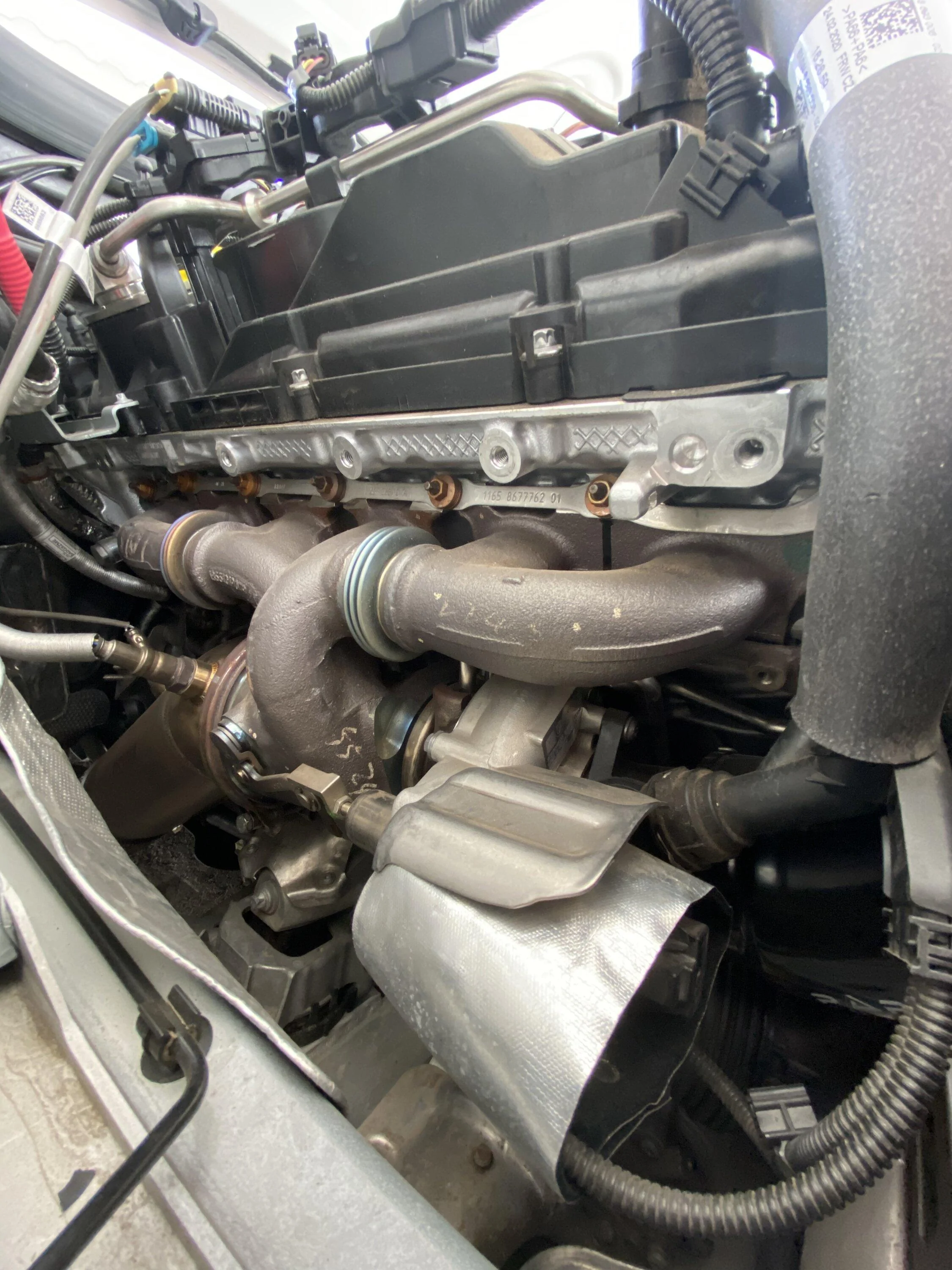

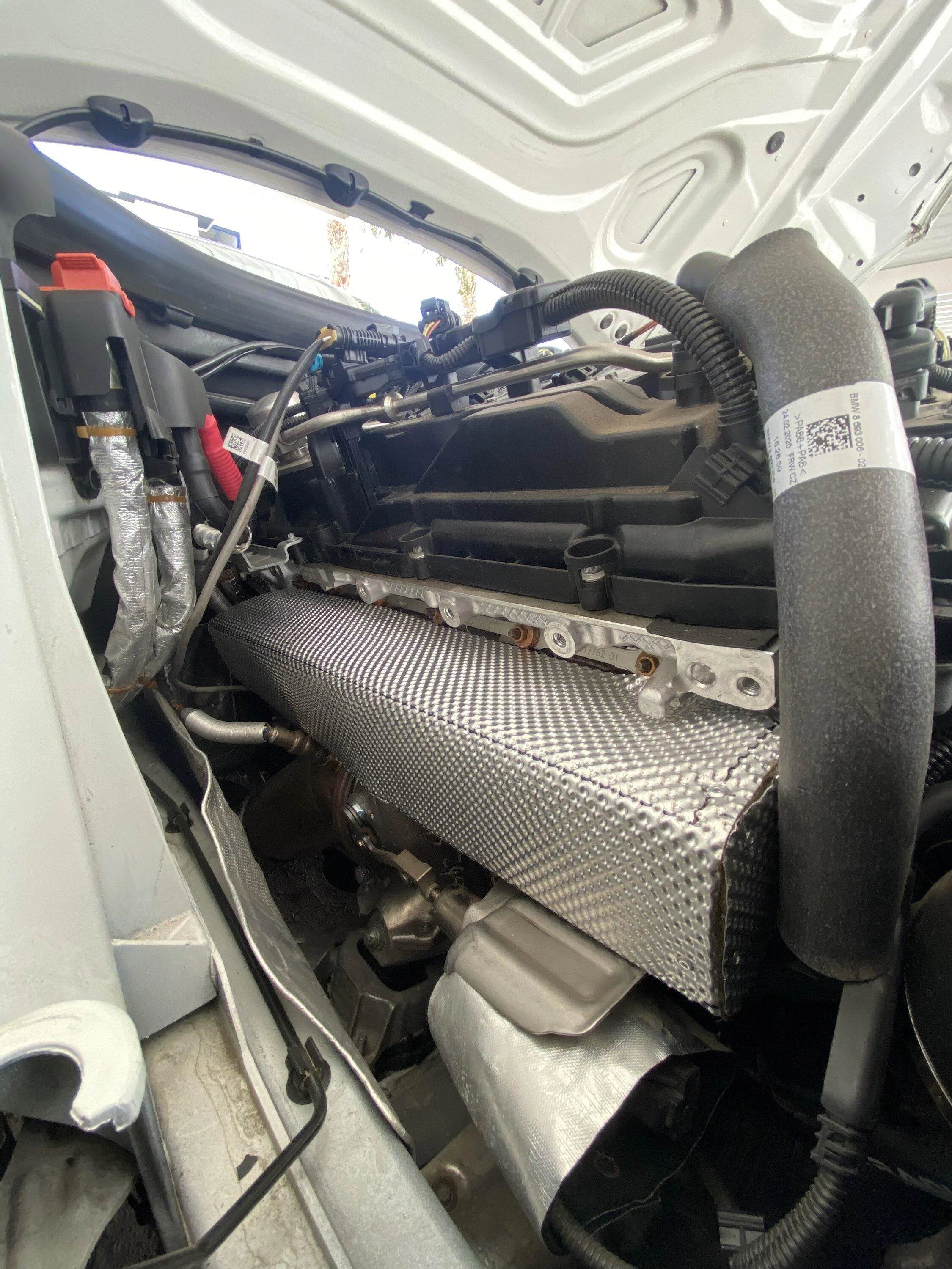

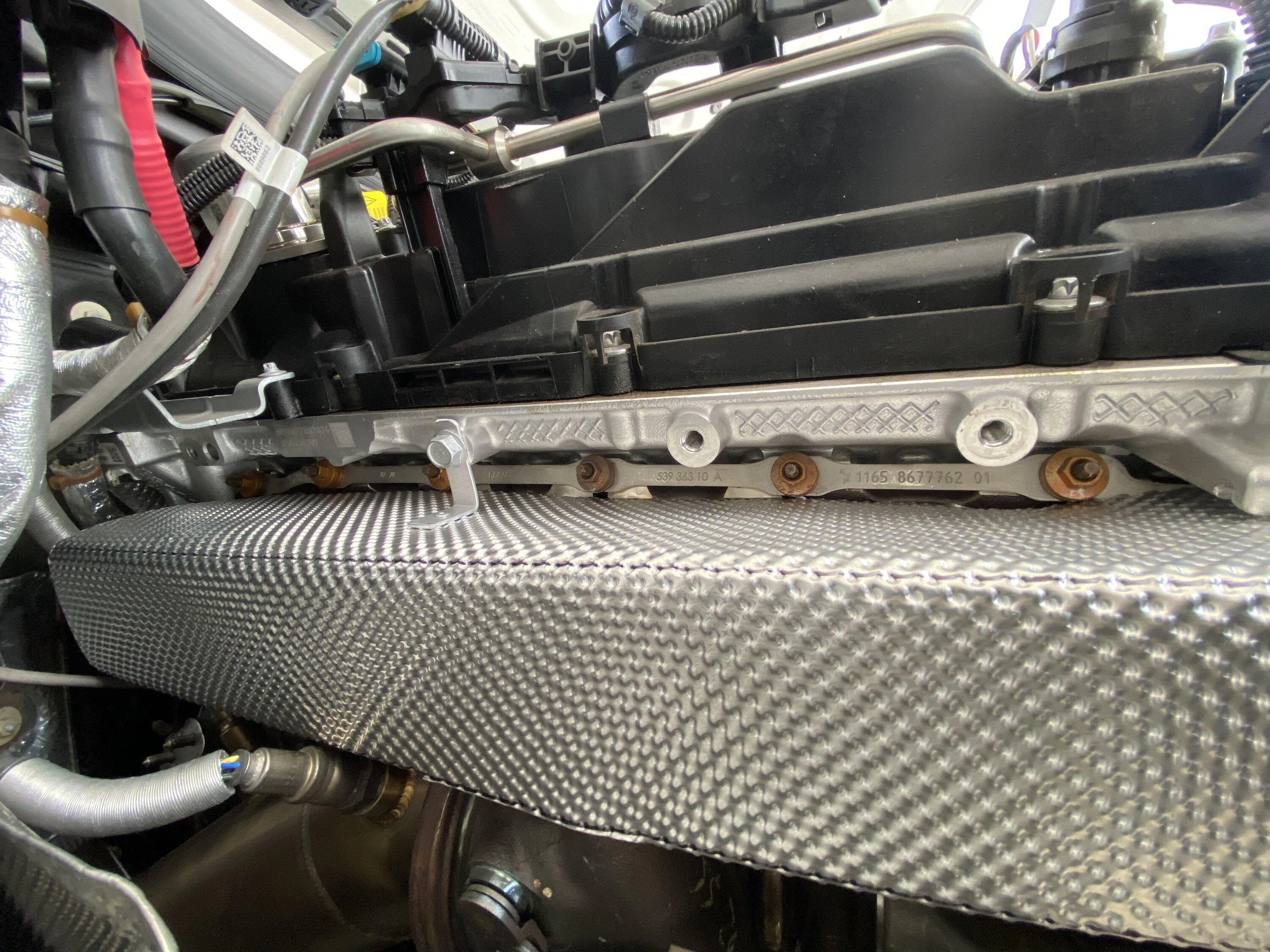

DIY’d a manifold heat shield & intake snorkel.
racebuild
Jul 14, 2023
241
290
BMW

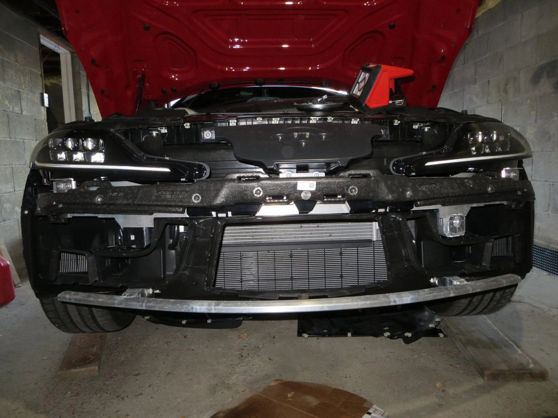

fyi, you can square off a 3" hose and it actually goes inside the intake ducting
if you need more pressure, you can block off the brake ducts. they do nothing for me on track.
all M cars are running this setup, with intake being fed from in front of the cooling stack. it's part of m340i's "hot climate package" as well.
Correct.
I didn’t want to fully seal the inlet trumpet with a 3” diameter hose, just wanted to direct some fresh air to the inlet. However we might try to cover the whole trumpet with a 4” hose.
I thought about pulling air from the side of the radiator cowl but didn’t want to take away too much pressure from top of the cowl.
Pulling air from the brake duct was step 2 for us if we needed additional fresh air to the intake inlet.

i think the only downside with not sealing it, is that you're pressurizing the entire front bumper cavity, adding lift.
