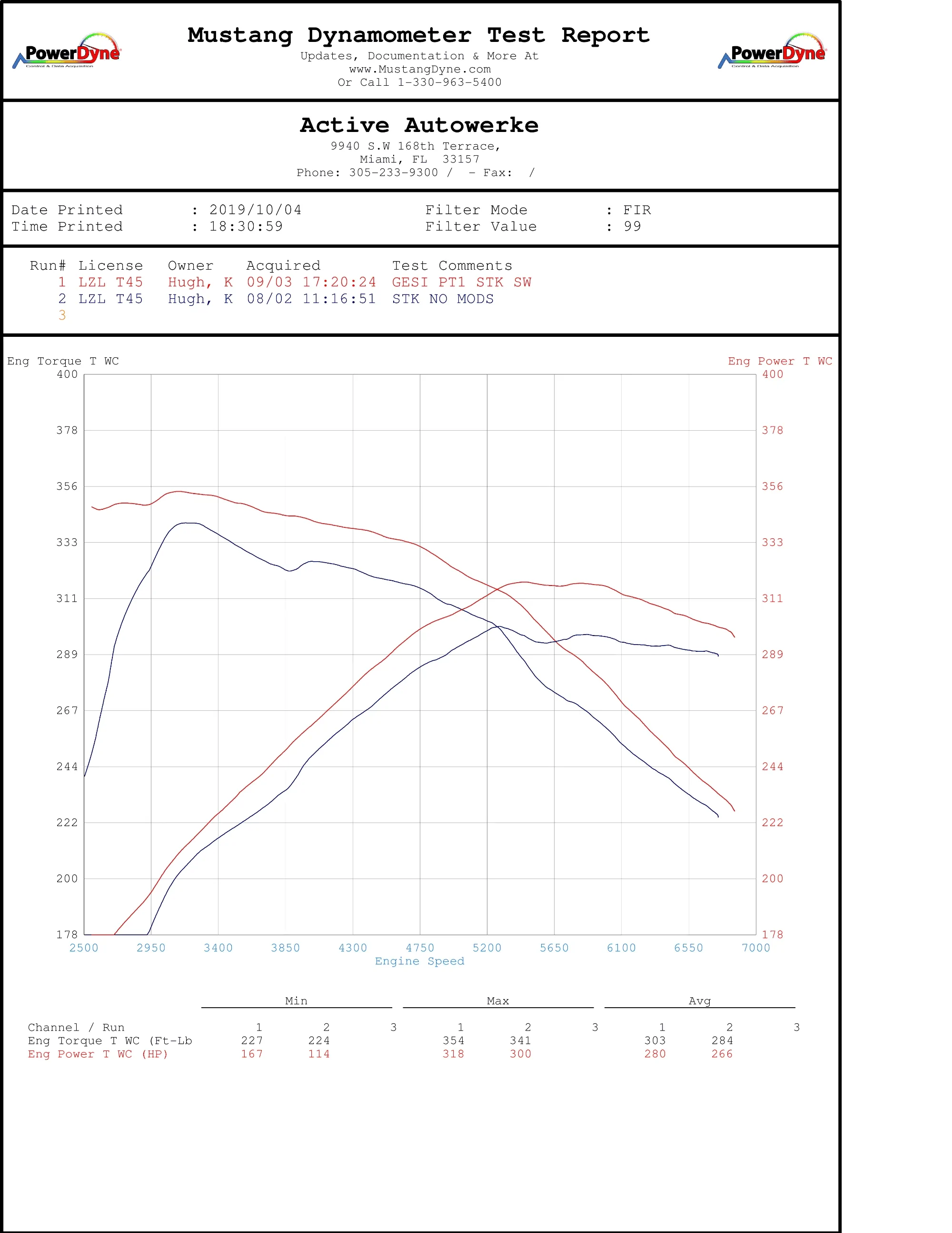

Power gains posted above from AA's dyno graphs also on their site.
