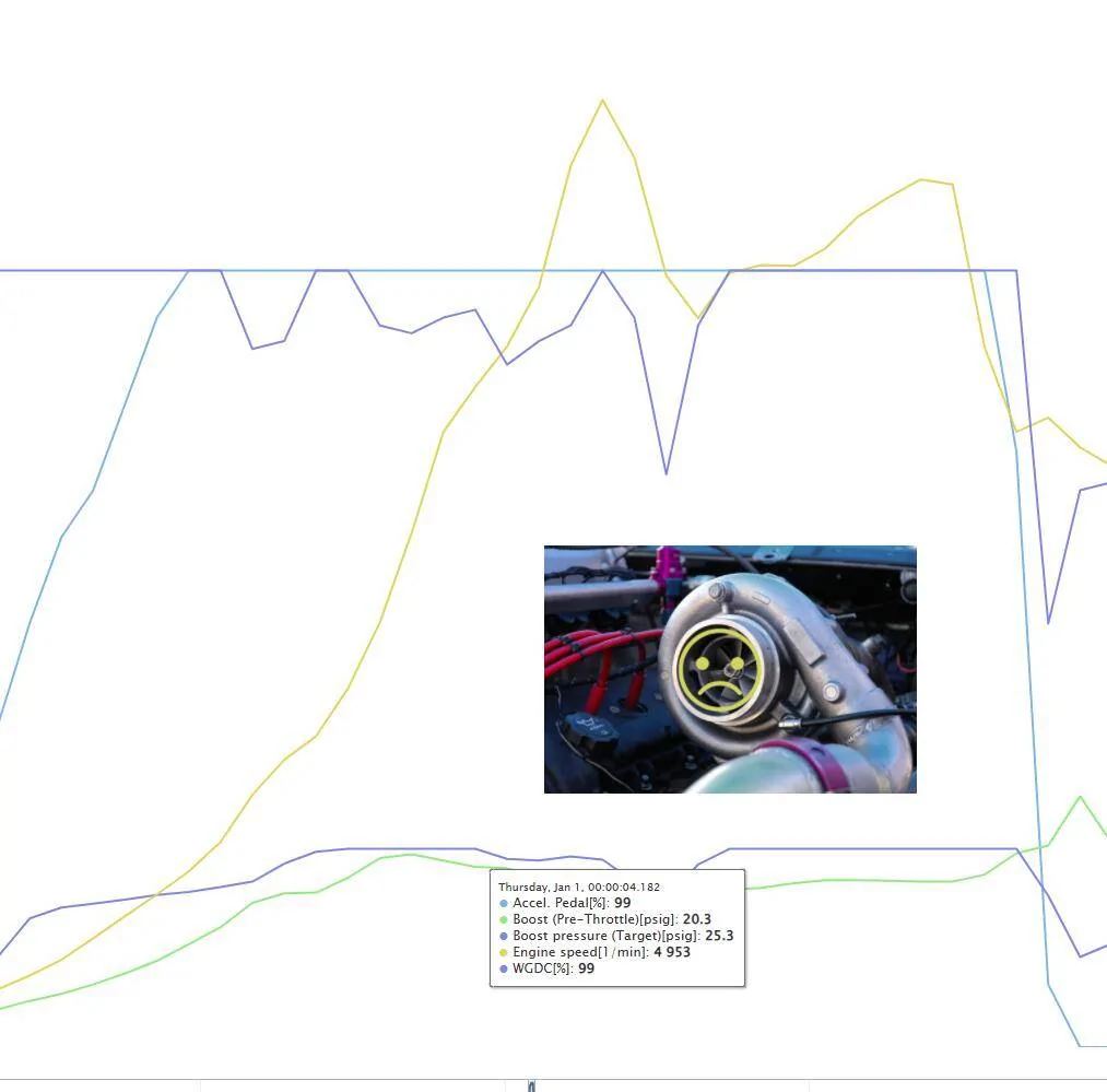

If I understand this chart as much as I've deluded myself into thinking I do, my stock turbo is aggressively trying to die on my BM3 OTS E50 tune. I think the altitude (6000 ft MSL, DAs above 10k ft in the summer) is too much for the little guy. I've come to the conclusion that the solution is more turbo.
It seems like the Pure 800, DAW ultra flow-x, and RP omega 65 should all be able to get me to my end goal of around 700 WHP if it weren't for the altitude. The omega should do it no problem but I don't like having to live with the intake noise. Would I need to step up to the Pure 900 or DAW 6466 to not be absolutely beating the turbo to death at that power level? Am I being a dumb idiot and I should just pick a tuner and plan it out with them?

5 psi under boost target on full wgdc means youre definitely out of turbo. You're never going to hit 700 uncorrected at 10k da with any of those turbos, including the 900, but you'd probably be pretty close.
