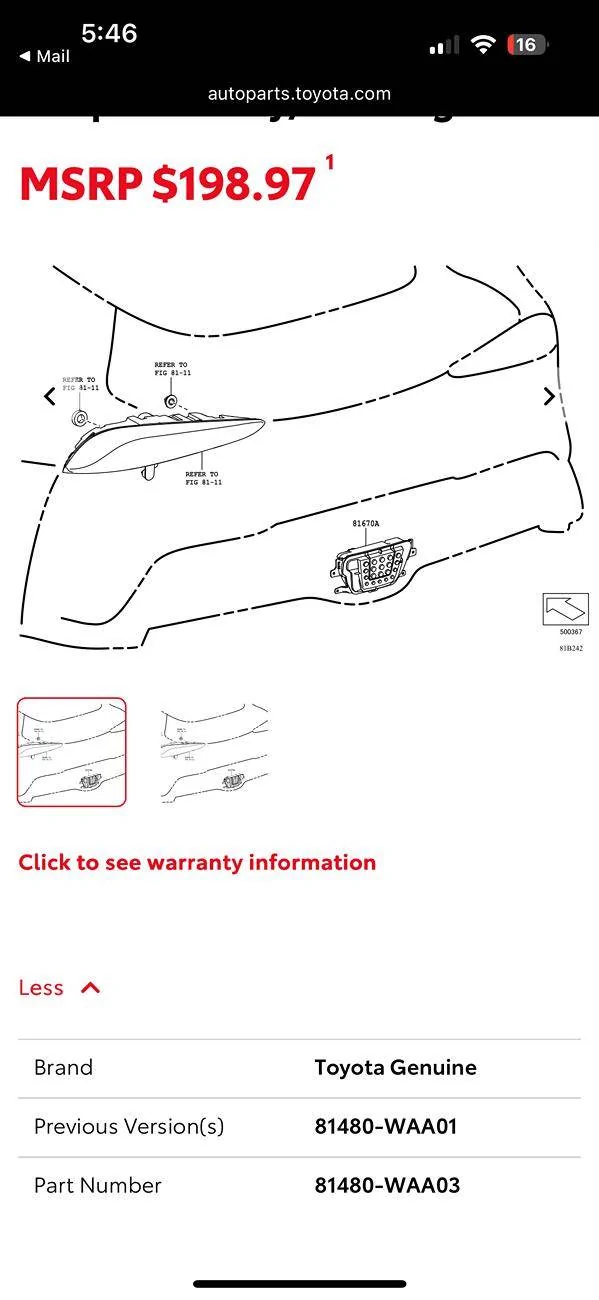

When I look up that81480-WAA01 part number on Toyota it’s considered the previous version to a new revised version labeled 81480-WAA03. When I look up the USDM part number there is no revised version. I am wondering if anybody knows what was revised in that 01 to 03 version because I am wanting the EDM model for the 4th brake light function.
Everywhere I have looked so far cannot give me clarity if the 81480-WAA03 is the same as 81480-WAA01 version with the 4th brake light

Yea I have been searching for 81480-WAA01 but all I’m getting is that number is discontinued from Toyota and the revised number is 81480-WAA03. I’m asking if anyone knows if this revised part number is just a number change and still has the same functionality as 81480-WAA01. When you look up the USDM part number on Toyota 81480-WAA02 you’ll see that there is no connection to a previous revision or new revision.

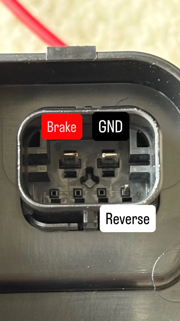

HELLO EVERYONE. I’m so sorry for the late reply. I did end up doing the gamble and bought the revised part number. I had to do some expert level wiring but I turned the brake light into a running light, with braking capabilities(I wired in a f1 3 flash module as well) I also plan on wiring in this week
a pulsing module so when I go into reverse I get the pulsing white LEDs but here’s how it looks! If you were also wondering I used bimmer code to keep my tail lights drls on. The EDM fog lights red matches perfectly with the tail lights. I did tint the red portion of the fog light red so when the car is off you know it’s red
