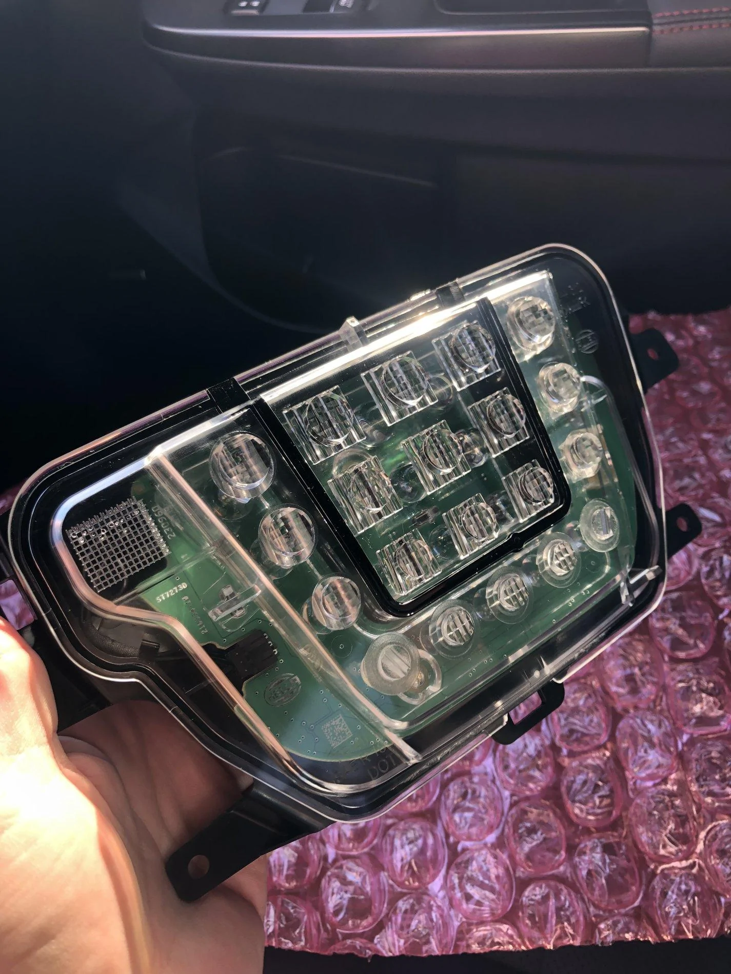

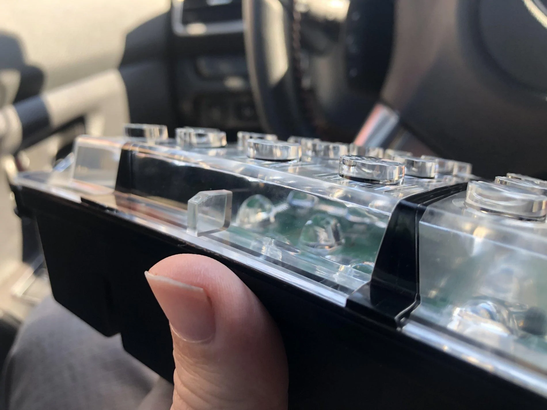

Anybody know if the US (full white reverse) versions not have this inner split wall?
Trying to determine if a used part is a Euro part.
I was looking for information or a working light with this feature but I could not find any info, Here are some photos of the light. the inside has a "wall" or divider in it if one part was reverse or one-part fog
Yes the US has the split. Both US and EU specs looks exactly the same.

Thanks for info!
What I feared... :(
Edit: Anyone in the future, PM me if you have one to sell
As long as you ordered 81480-WAA01 you will be ok. I had the same fear ordering from another US company and when it arrived it looked completely identical. You will know when you put power to it, if it lights up red obviously.

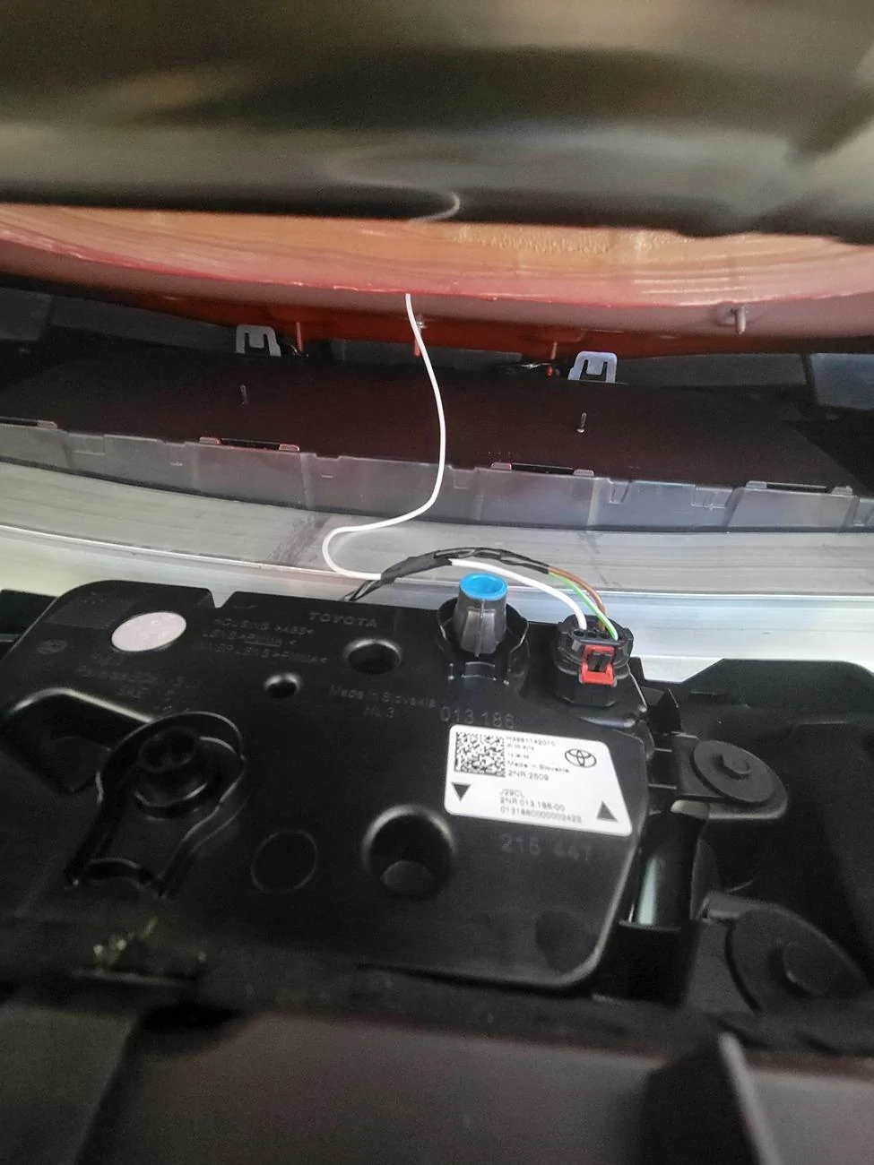

Does it flash when braking or is it solid?
Flashes at 1st (about 3 flashes) then goes solid. Sorry not the best pic. Go to about 5:15 into the video below:

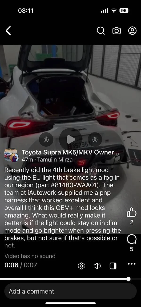

Saw a post on FB, there’s a PnP harness for the Euro spec light? Anyone use it? Didn’t see it on the iAutowork website.
m.facebook.com/story.php?story_fbid=1936468643518881&id=334097827089312
Edit: won’t let me link to fb so attached a screenshot
