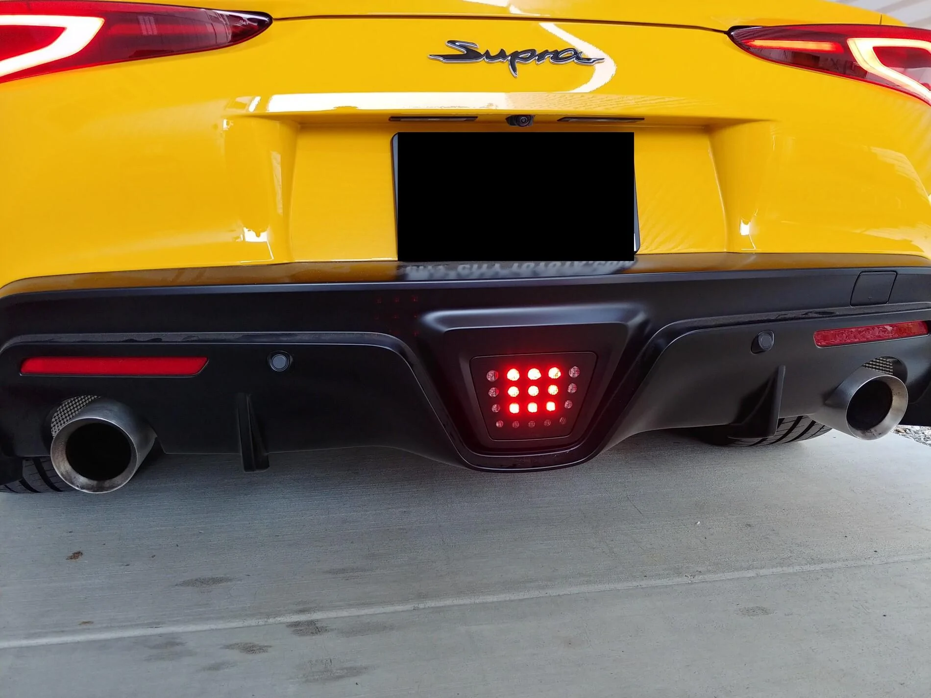

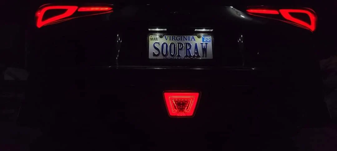

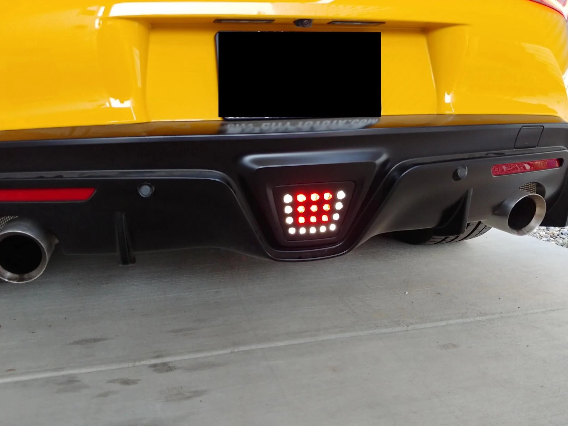

The install in complete!

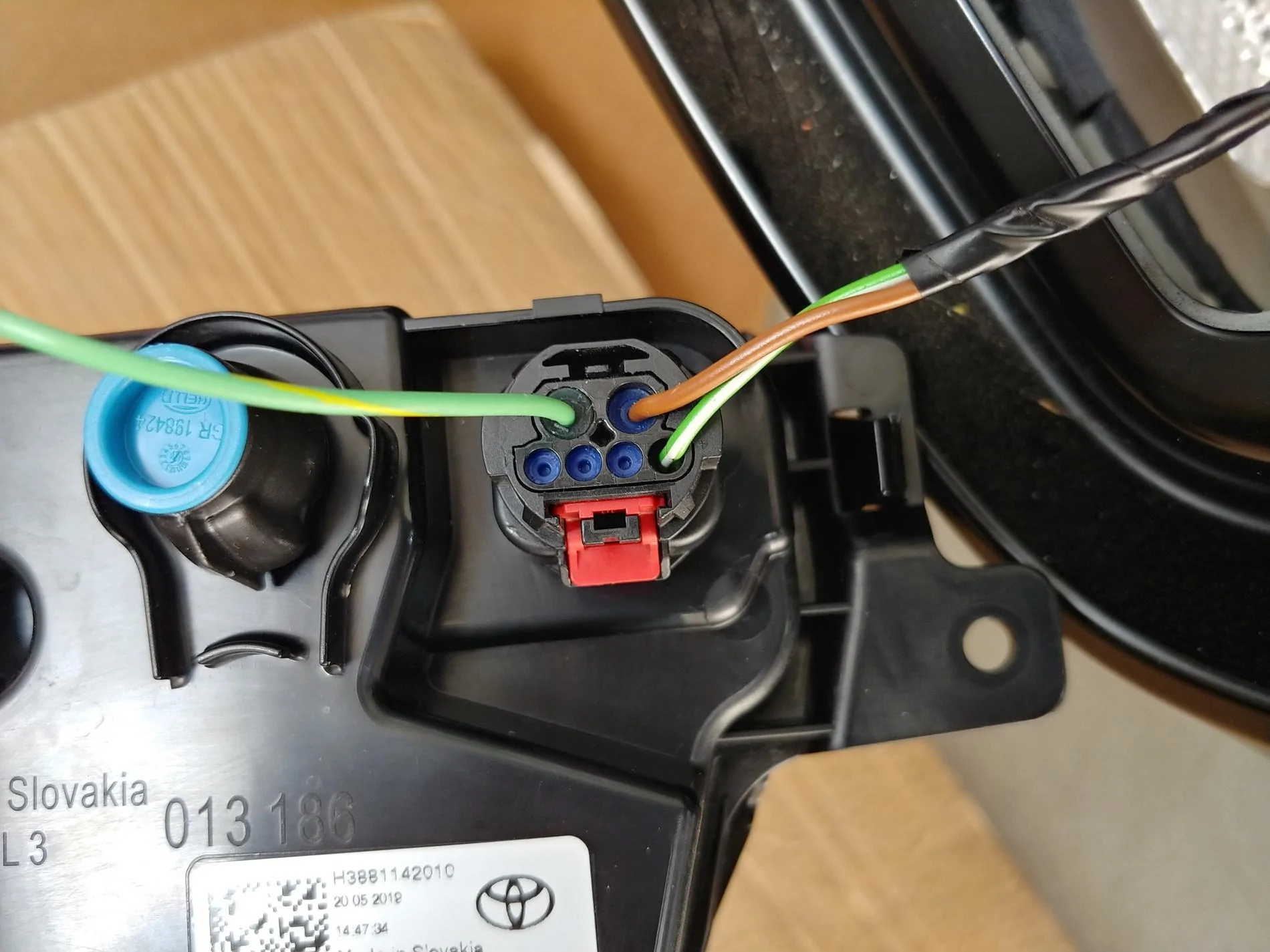

I also tried applying 12V to the rear fog pin on the original light and nothing lights up as expected.

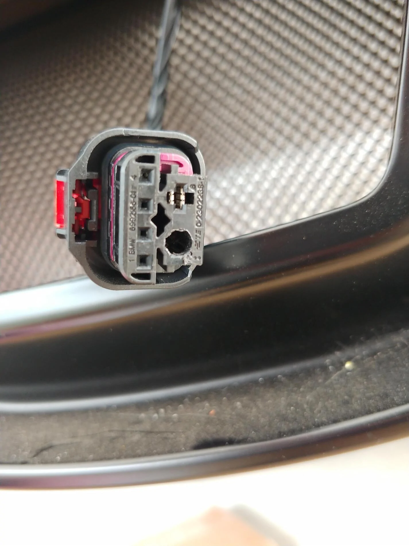

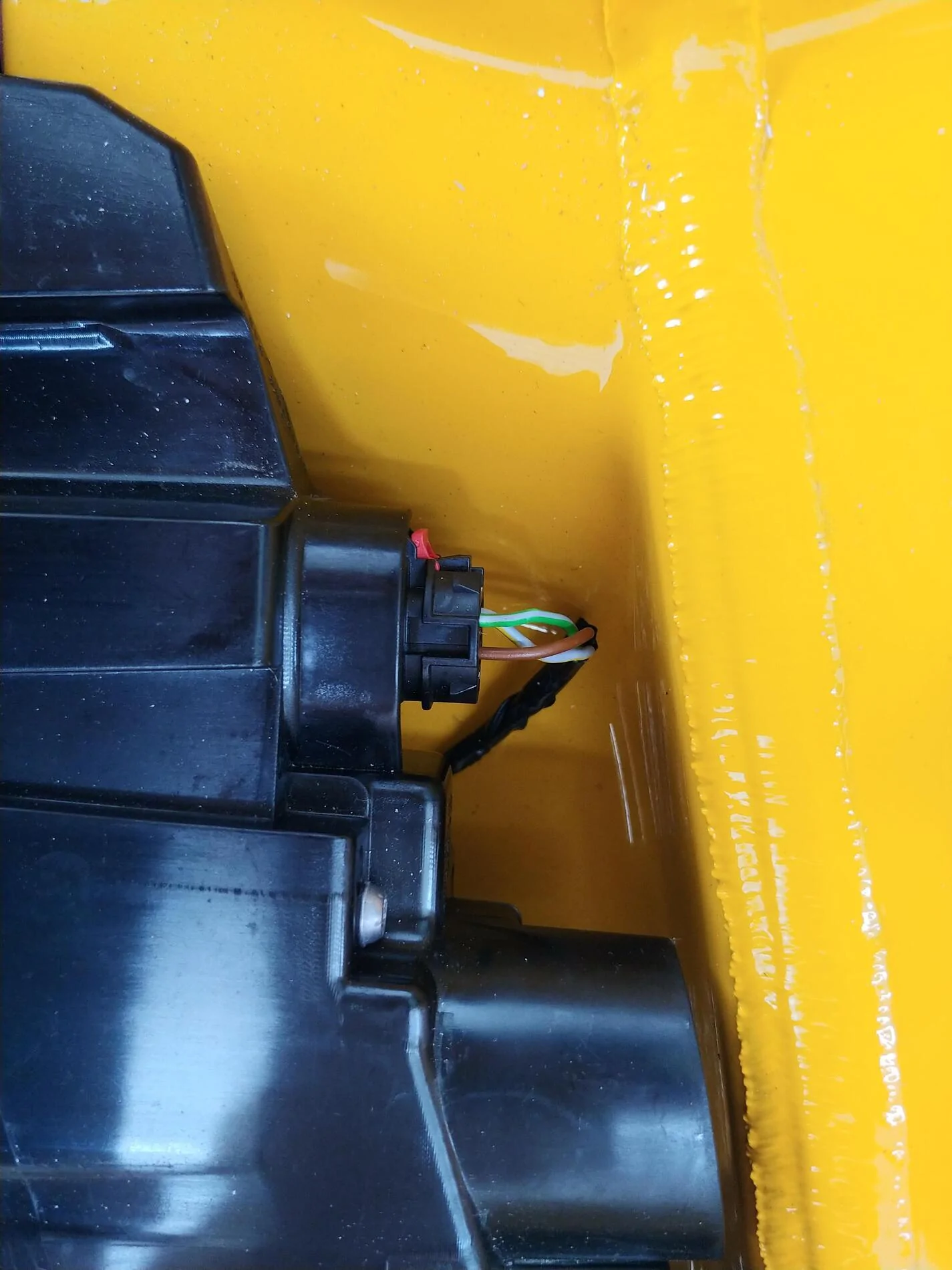

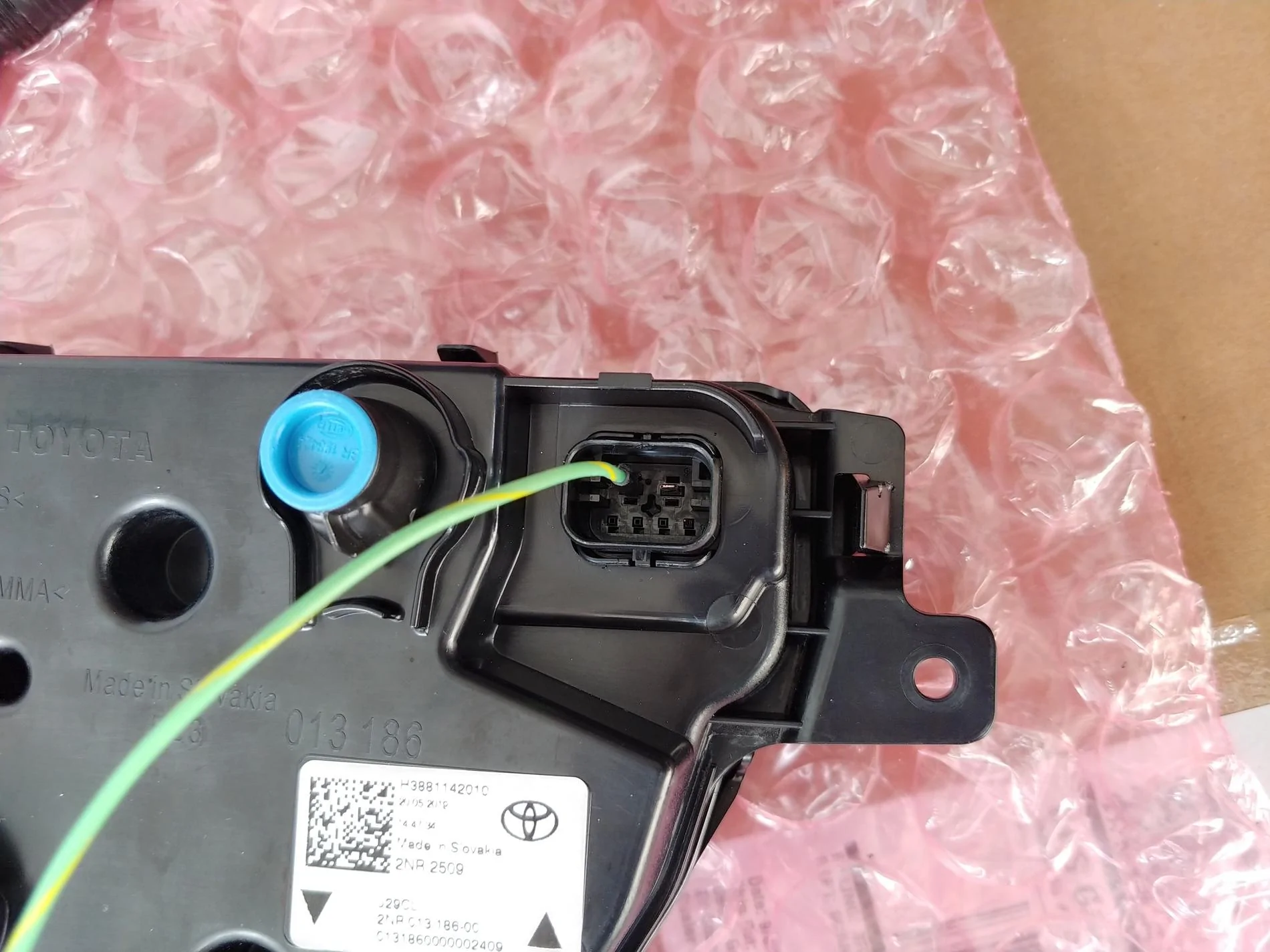

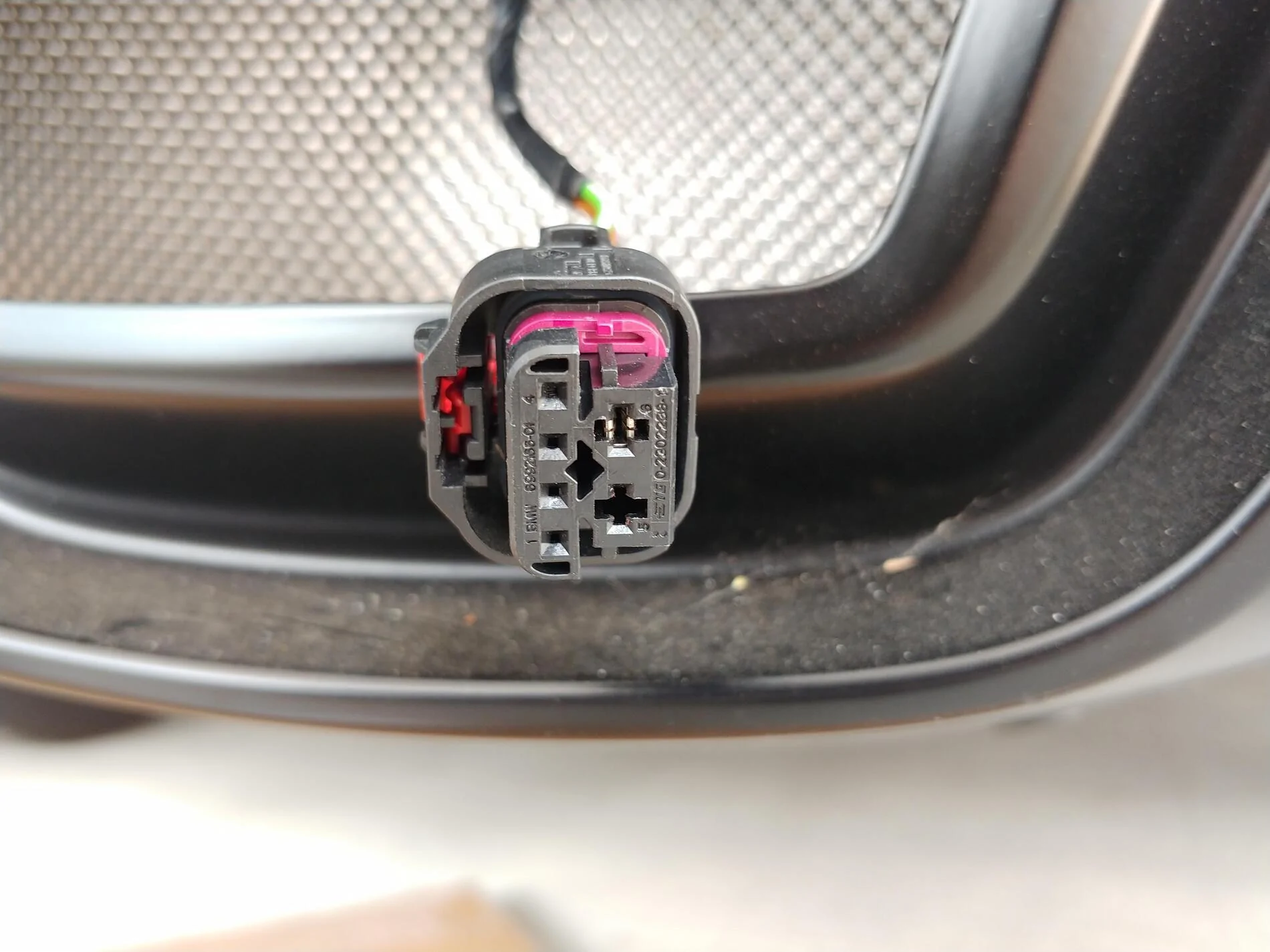

This is what the plug looks like. As you can see there are no metal contacts where the rear fog light pin goes in. It was also plugged up on the other side with a rubber piece that I reused later. What I did was solder a wire(green/yellow) to the rear fog light pin and drill out a hole in the connector so the wire can go though. This way, it can still be plugged in normally. Hopefully the pictures can show what I mean. I made a hole through the rubber piece so the wire can go through and put the rubber piece back in so prevent moisture from getting in.

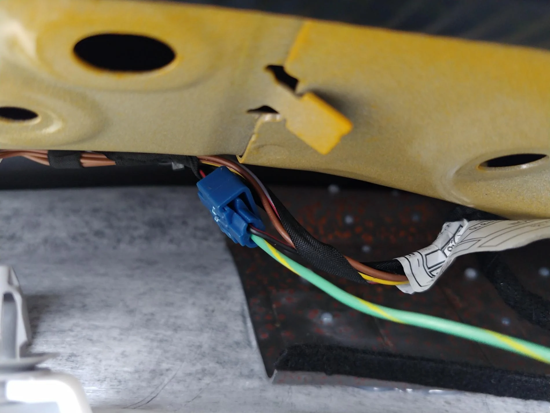

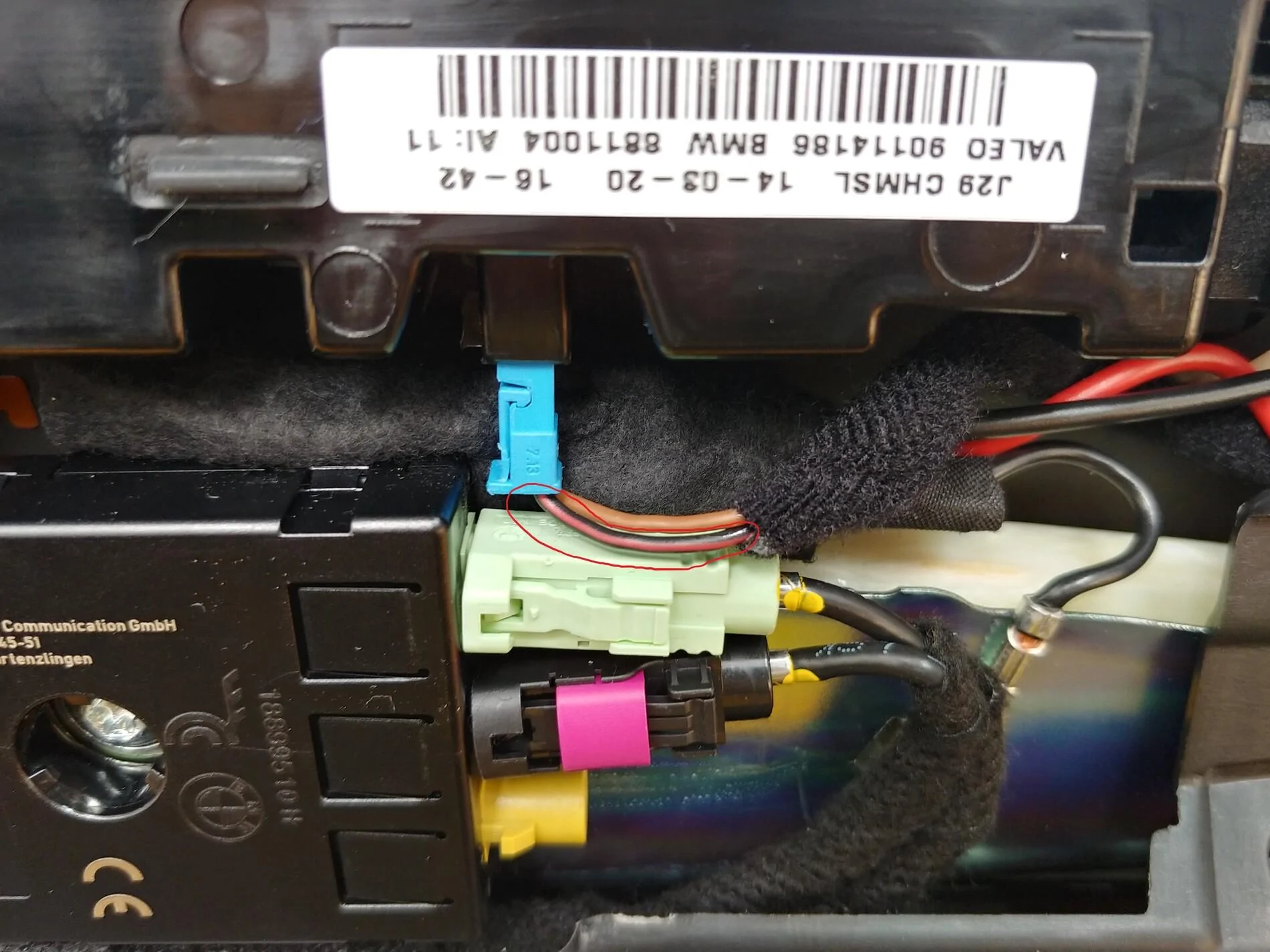

I tapped the green/yellow wire to both the tail light and the third brake light wire. You can't tap it into the regular brake lights since that also acts as your signal light. You could tap it to only the third brake light but I wanted it to also be on when the headlights are on. I also needed to install a diode so the tail light does not also light up the third brake light since they are all connected now.
The third brake light wire is the black/red wire. It goes under the head liner which is where I tapped into it.

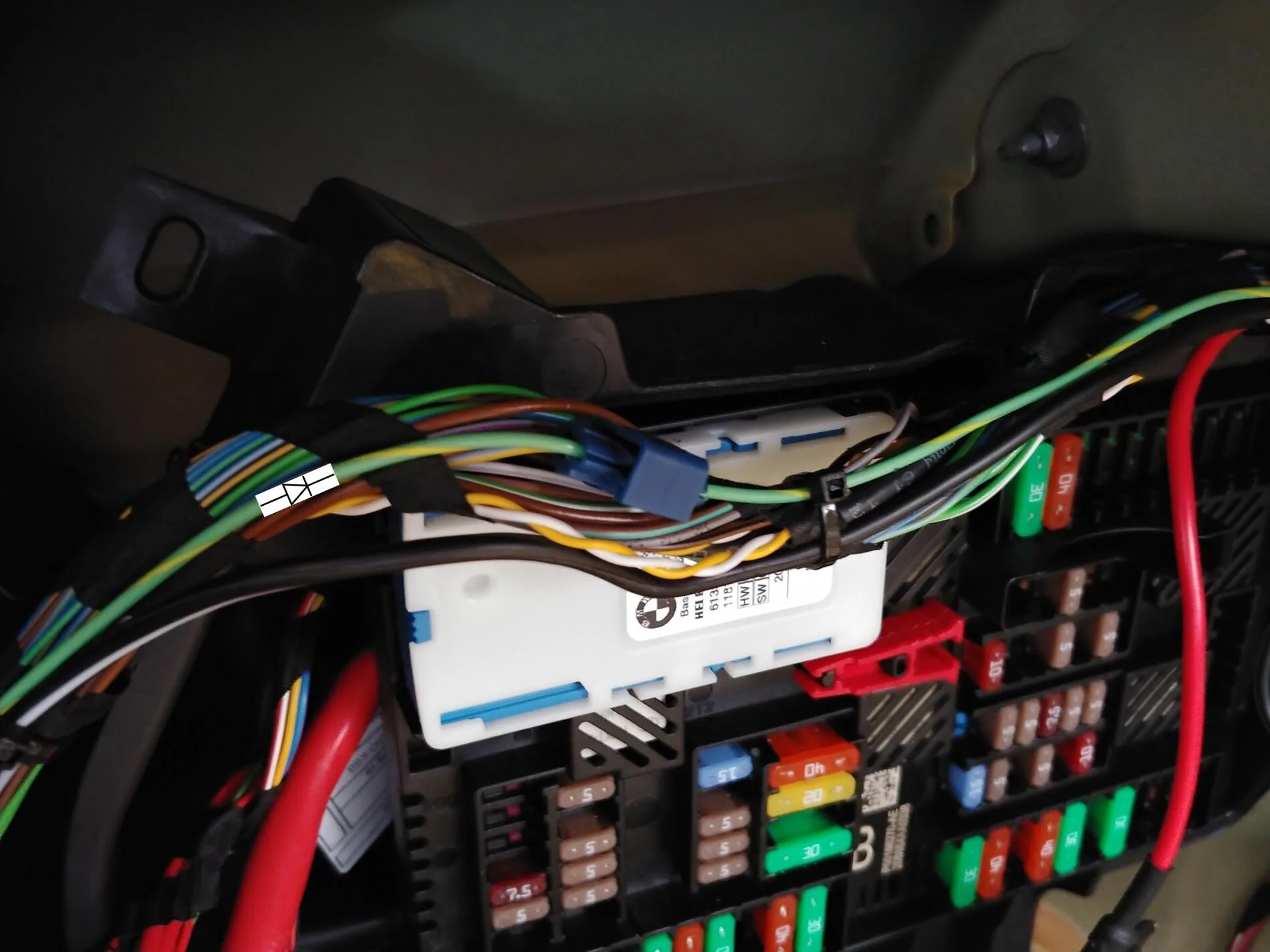

The tail light is the grey/yellow wire. I tapped into it in the bundle of wires near the fuse box. This is also where I will install the diode.

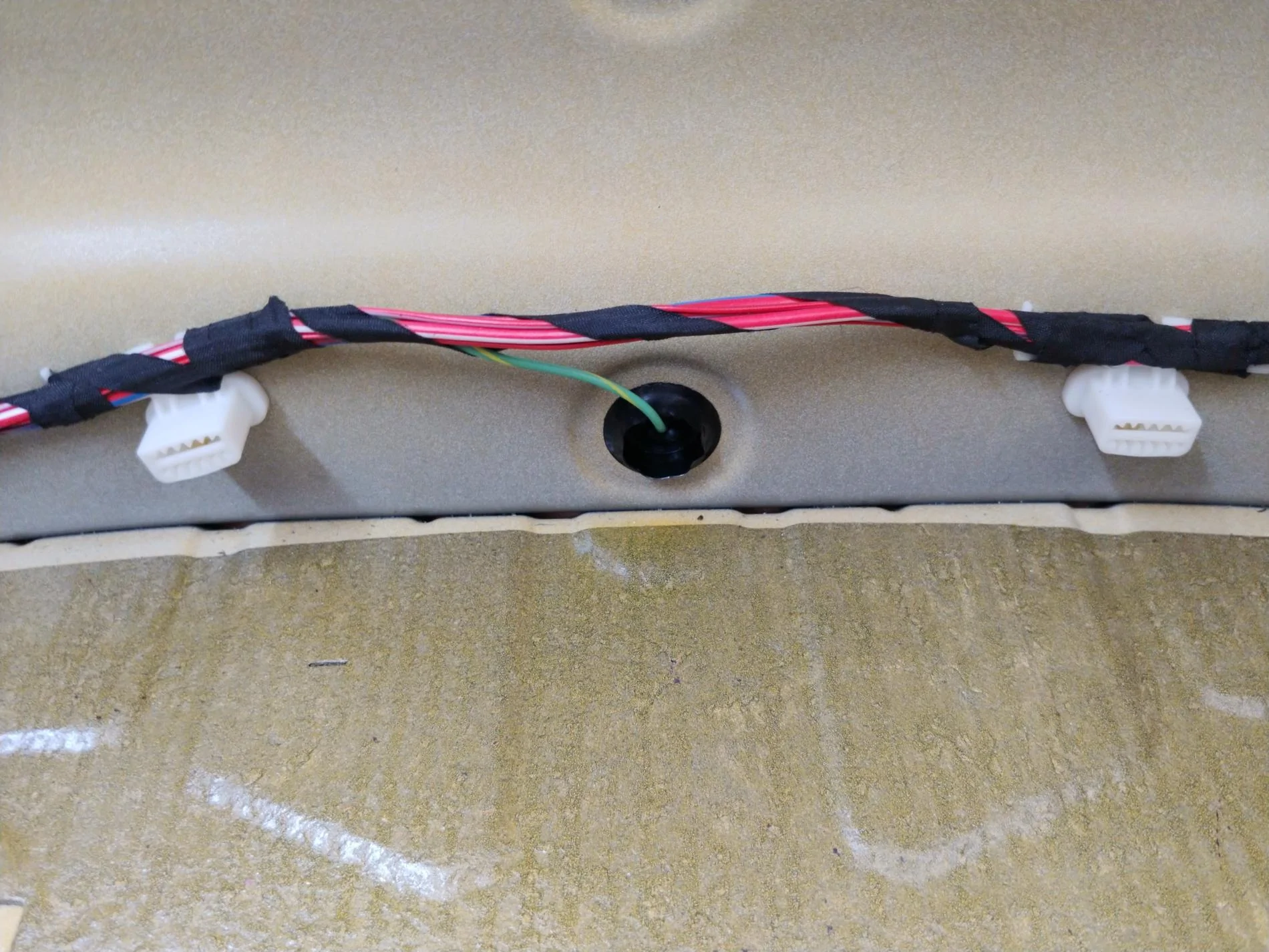

There is also a rubber grommet in the rear of the trunk there you can route the wire through by just poking a hole in it. It leads the the back of the rear fog light.
Hope this helps!
