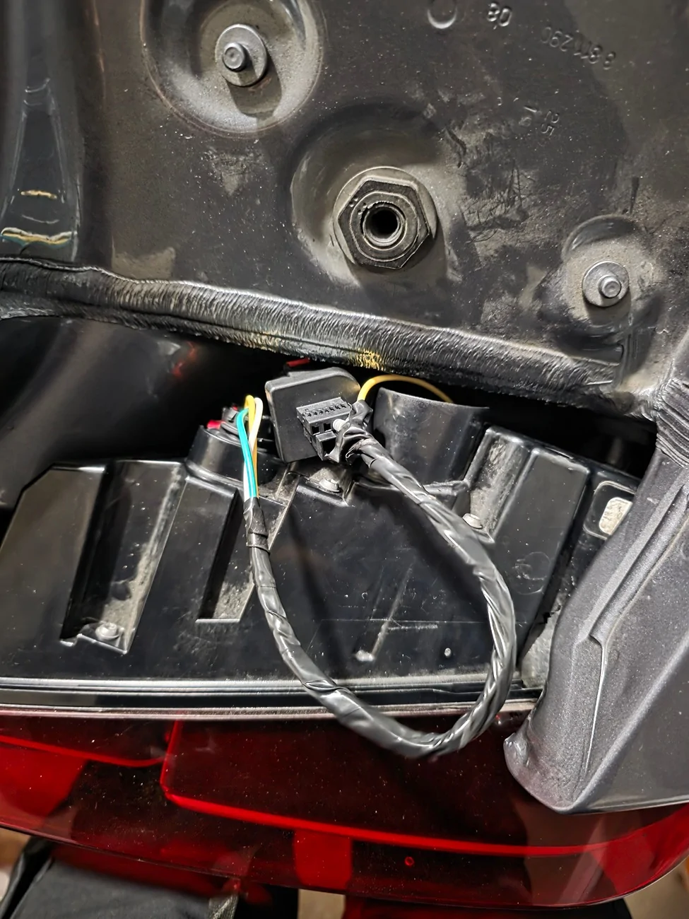

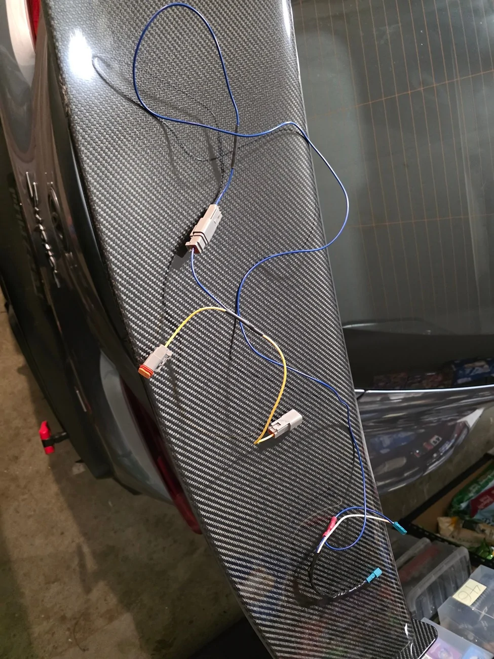

After years of procrastination, I have finally installed my euro brake light. Had my harness all soldered and using OEM connectors so that I can always unplug it resulting in no damage on the OEM harness.
Any chance you'd be willing to make another one of those harnesses and sell it 😅😅
I am planning to do a small batch of these harnesses since I ordered the connectors in bulk. DM me and I will add you on my list as I have a couple of members from my local Norcal GR Supra community who has asked for it in the past. :D

Made a V2 of the harness for my friends car. This version is connected to both of the taillights which allows the 4th light to come on when signaling both directions and also hazard. For those who have already reached out to me about the harness, hoping to get these all made in the next couple of weeks and will most likely check if you want the V1 or V2
