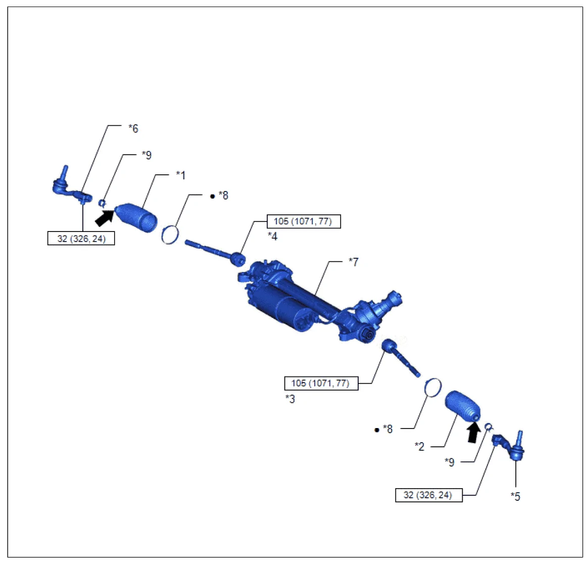

There is literally no belt on the power steering. They are lying to you and trying to take you for a ride.
You probably damaged the tie rods or tie rod ends. Take some photos.

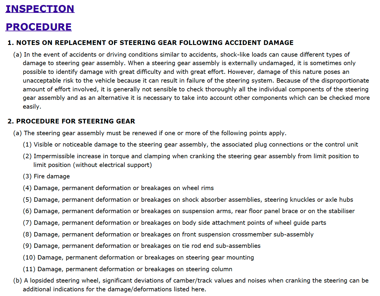

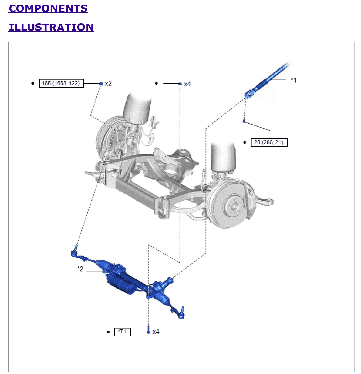

i also believe there is no belt from the EPS motor to the rack ... i think its a worm gear but im not 100% ... either way its not a replaceable part ... and knowing Toyota and the work i have done with the Trust bush issue on these racks they replace them in their entirety rather than fix.
either way jumping a cog or a tooth on the belt has probably caused "some" damage and as steering is a pretty crucial technical part keeping you on the black stuff i would seriously think about replacing it.
but .. agree with #RAZORLAB check the Tie rods they are designed to deform/break well before damage to the EPS rack.
If tie rods are ok you could ask for an EPS re calibration but i always air on the side of caution with brakes and steering issues.

You should make an insurance claim on this.

You’re talking out your ass bud. There is absolutely a toothed belt between the motor and rack.
Here is a teardown of a similar rack from a z4:
