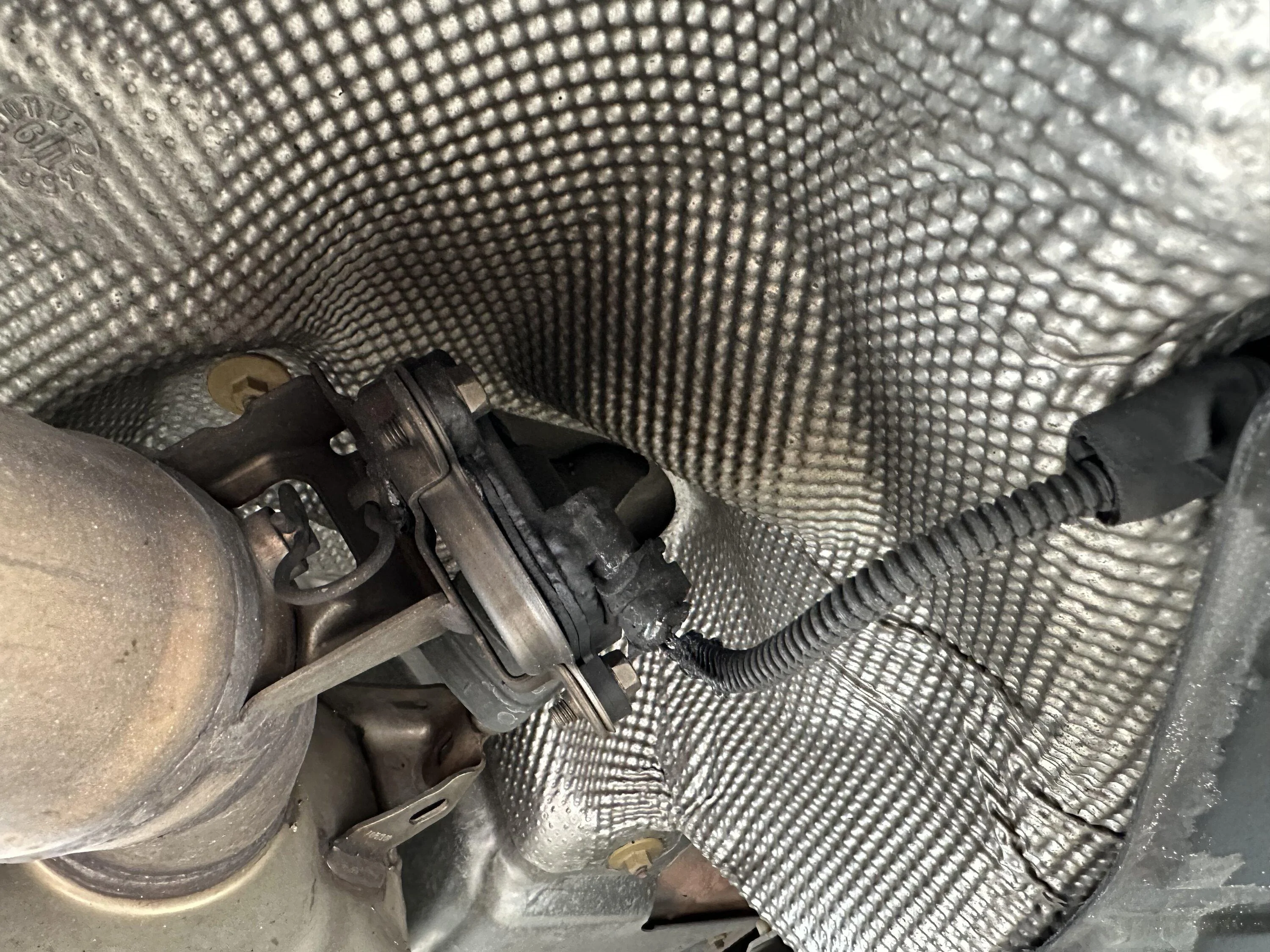

During/after a recent track day, I noticed my exhaust has a bit of a rattle (similar to rattling that others have posted videos of). CG Precision DP + stock catback.
I also noticed that even in sport mode, my exhaust is quiet like normal mode. After some investigation, I found that my exhaust valve is stuck closed.
I believe the rattle is coming from the valve.
I checked the fuse - all good.
BUT
I looked under the car, and I believe the plug/harness for the exhaust valve flap has melted.
Any guidance on replacing this? Not sure if itā€™s a plug on both sides (didnā€™t trace it back yet) and I can just replace it. Also havenā€™t tried to disconnect it (waiting for exhaust to cool) as it may be melted together (hope not).

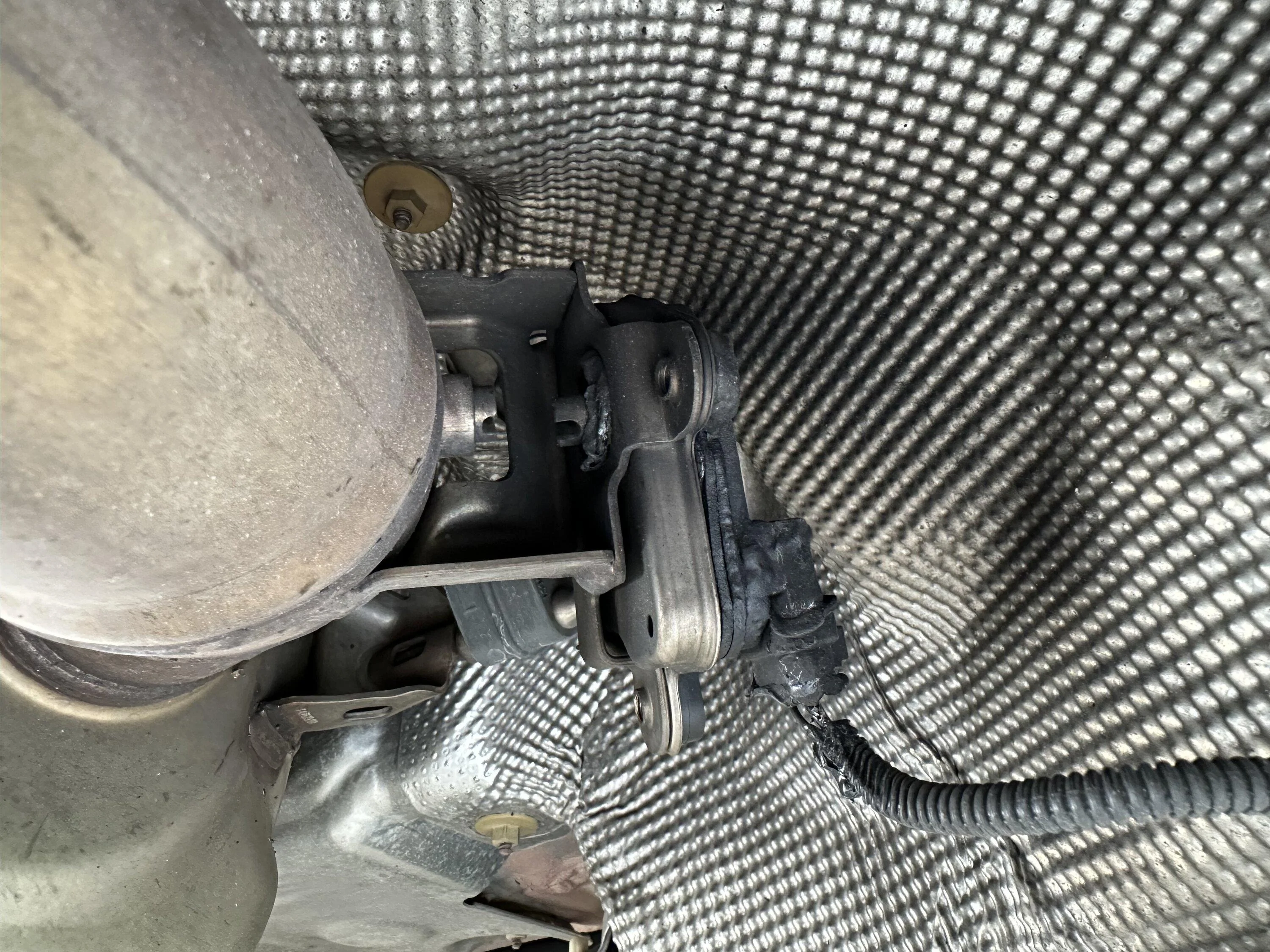

Assuming the actuator side is still good, Iā€™m betting Iā€™d have to replace the whole plug+cable.
Anyone have a part number and/or know how far this cable runs into the car?
sup.dc2
JJ
Aug 7, 2023
86
120
Fontana, CA
Mk5mt. DC2. T4R. e46
Its the connector thats bad not the whole harness. Those ends can be purchased separately and you can de-pin the connector. Assuming that it's actually the problem because it looks fine its that housing that looks melted it may still be making contact.

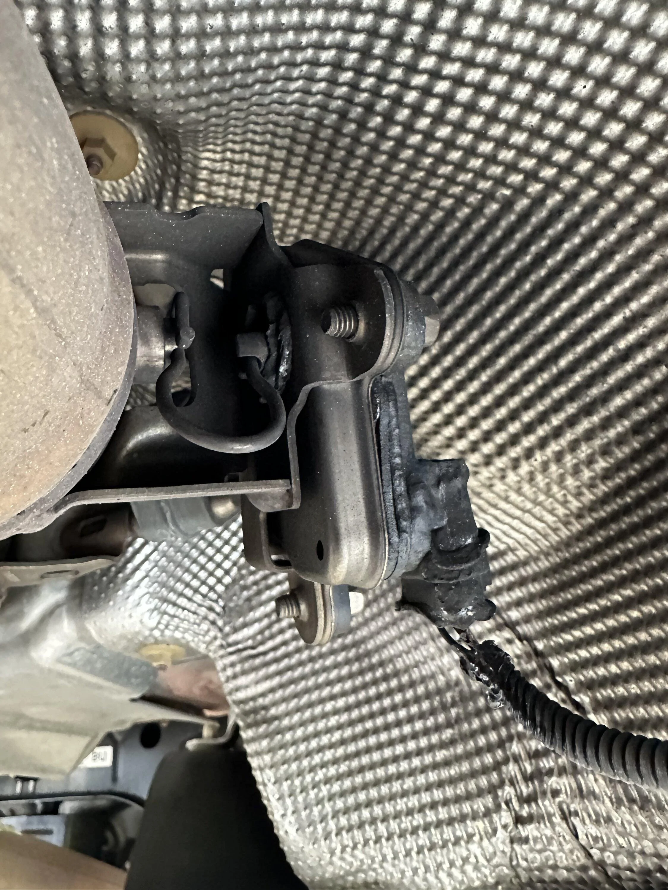

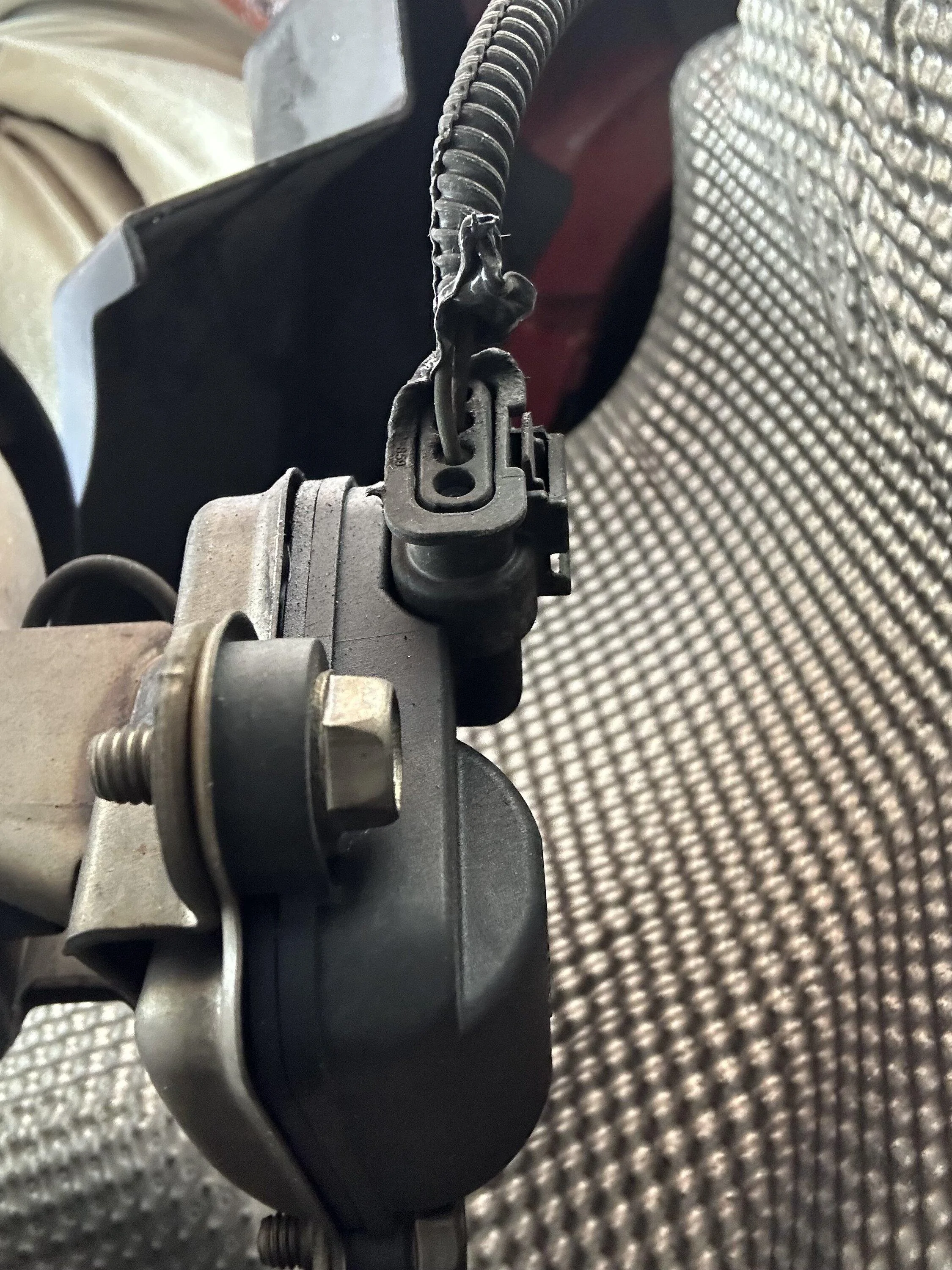

Updates:
  • The exhaust rattle was from the little spring that connects the actuator to the exhaust flap (see video)
  • The cable protection is melted a bit, but the wires look good (per @sup.dc2)
  • The plug is melted/fused to the actuator.
  • The part that rotates on the actuator is melted to the point where the actuator cannot be easily removed (see video).
  • The actuator is very notch when trying to manually rotate it (see video).
Solution:
  • Fixed rattle by stretching spring and reinstalling.
  • Manually opened flap and pulled exhaust flap fuse.
Good to go (but flap does not change) and now normal mode sounds better. The "back to OEM" solution would IMO require depinning the wires on the actuator, repinning a new plug, and replacing the actuator completely.
Apparently rattles are common on all valved exhausts. For any car that sees track days, I am now personally leaning towards disabling the exhaust valve flap (BMW even has OEM dummy plugs for this) or going valveless if installing an aftermarket exhaust.
