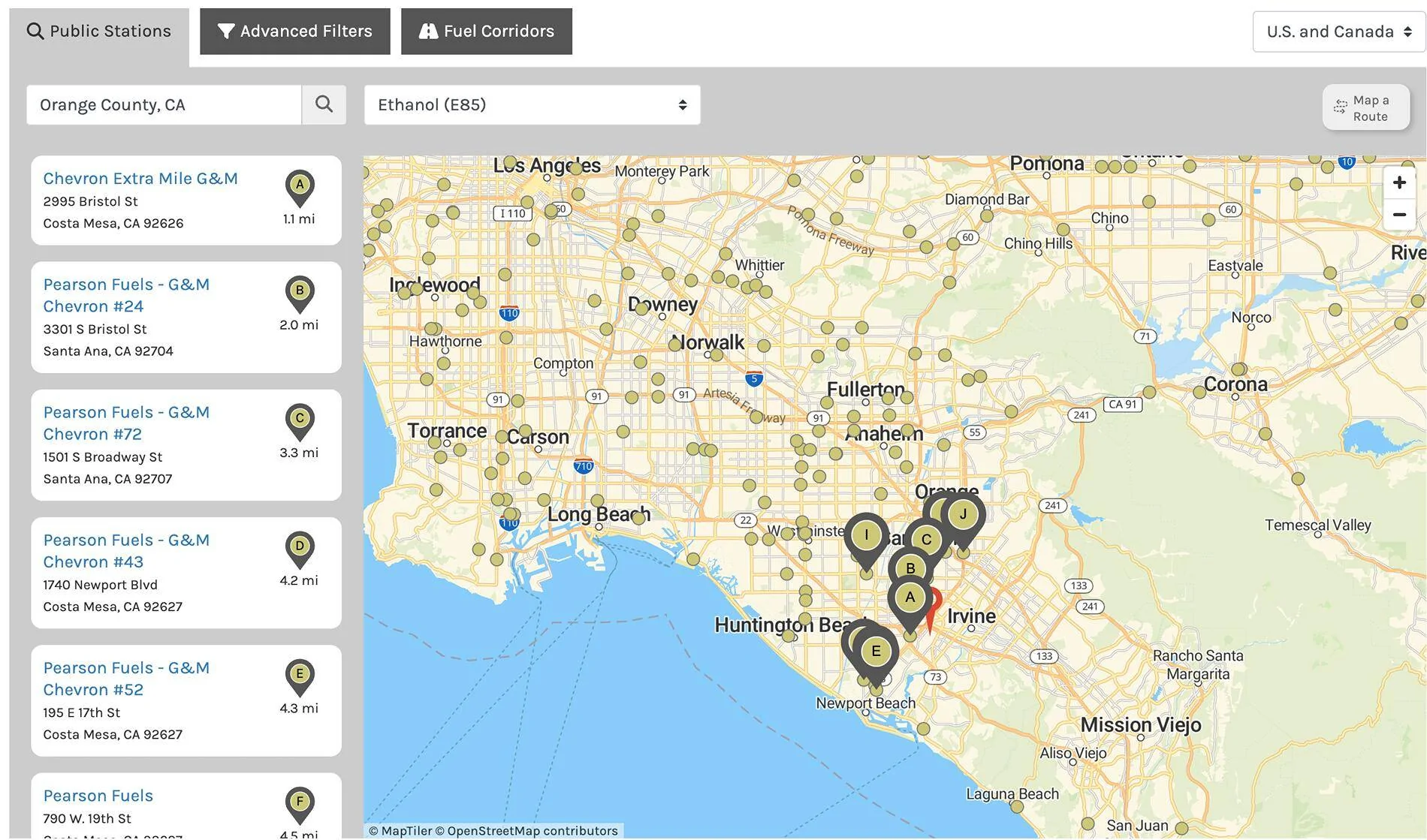

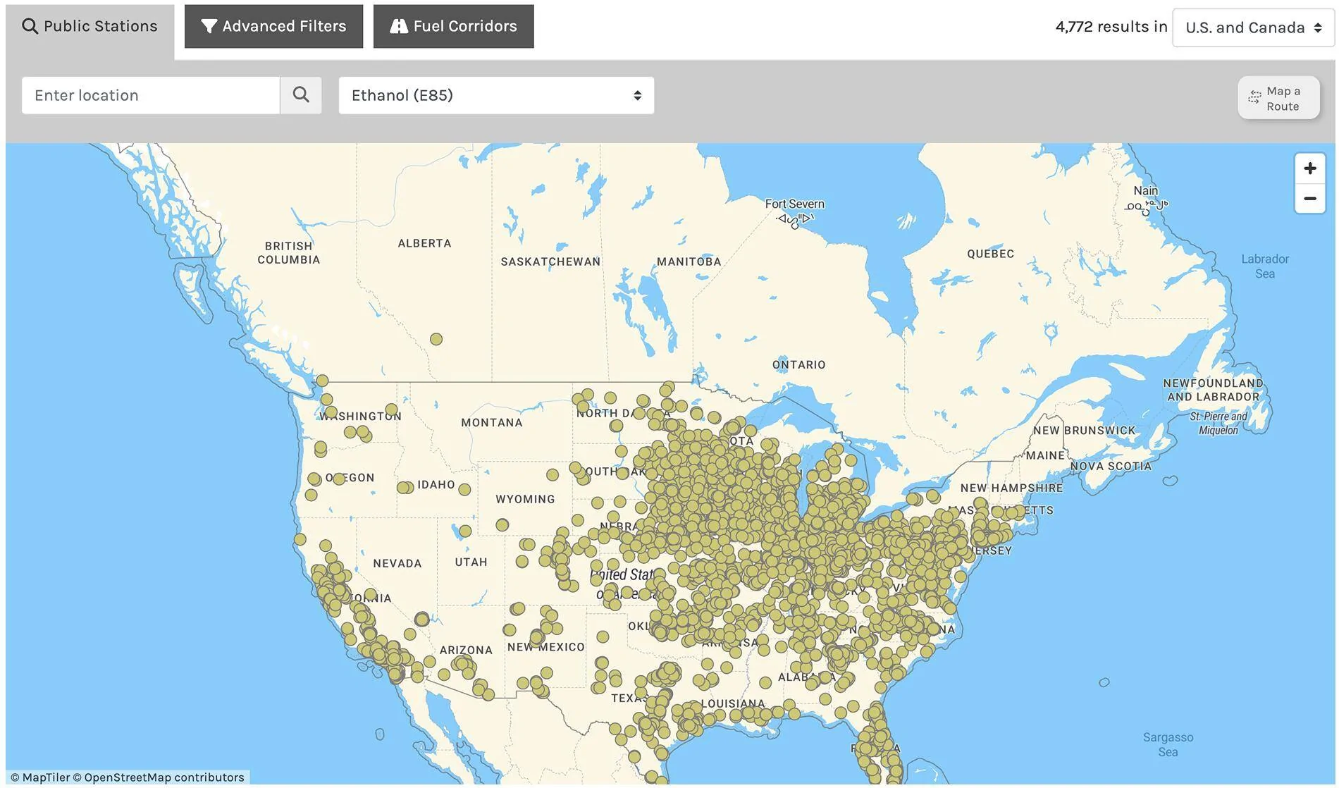

Pearson Fuels is the big California supplier. I used their pumps the most when I lived in California.
There are many E85 mobile apps and also this which is basically the best one:
https://afdc.energy.gov/fuels/ethanol-locations#/find/nearest?fuel=E85

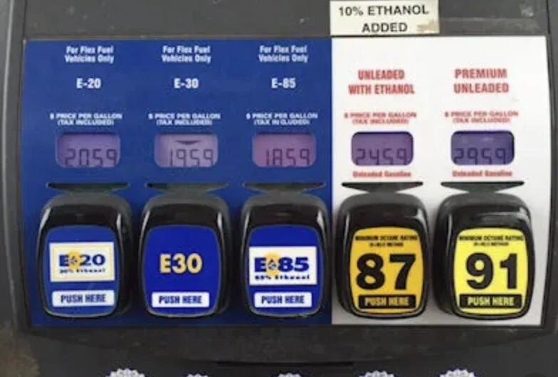

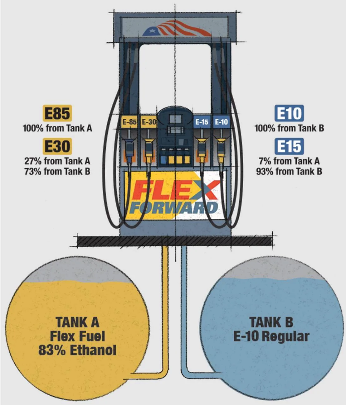

Is there one that would like you search by E30?
That's not how it works.
The stations supply E85, you have to calculate your blend and figure out how many gallons of E85 in ratio to 91 you need to make E30. So if you needed 10 gallons, you'd need 2.67 gallons E85 to 7.33 gallons 91. There are apps you can use to do your calculations, like the Fuel It app or even JB4.
Also, 91 is already E10 (as is 87 and 89). Highly recommend the Fuel It Bluetooth Sensor, helps me stay consistent.
E85 is also inconsistent at stations at times. The ethanol content can fluctuate from station to station but it's usually within acceptable parameters. There are test kits you can buy to test the Ethanol content from a pump to help with accuracy.

That is usually a blender pump and I don't think that exists on the West Coast. Mainly a midwest thing.
Going to have to blend yourself. :)
Damn. That would be nice here but never seen it in SoCal. We didn’t start getting e85 pumps until about 5 years ago. Back then there were a few, but now you can find them pretty easy.
