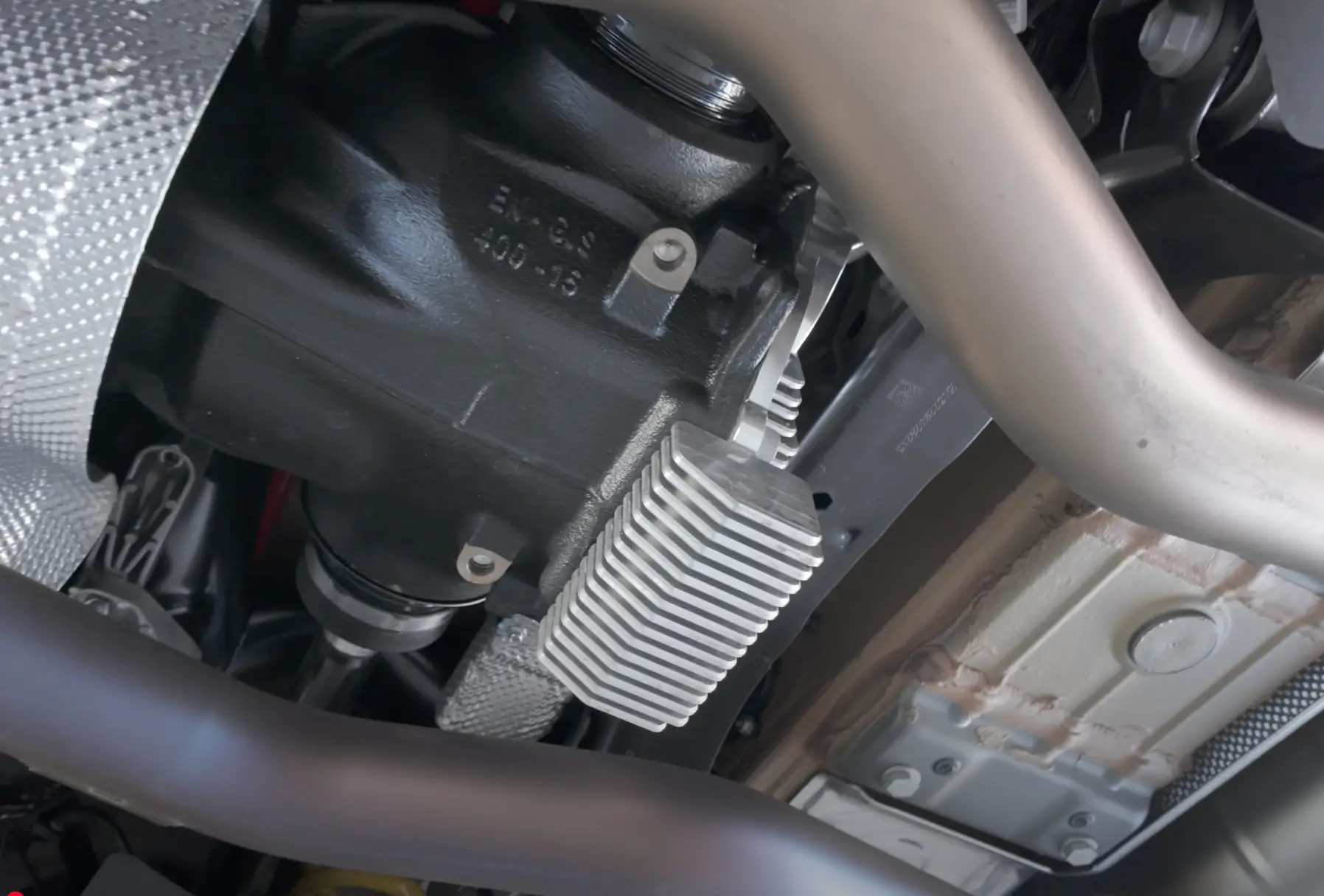

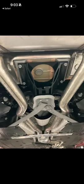

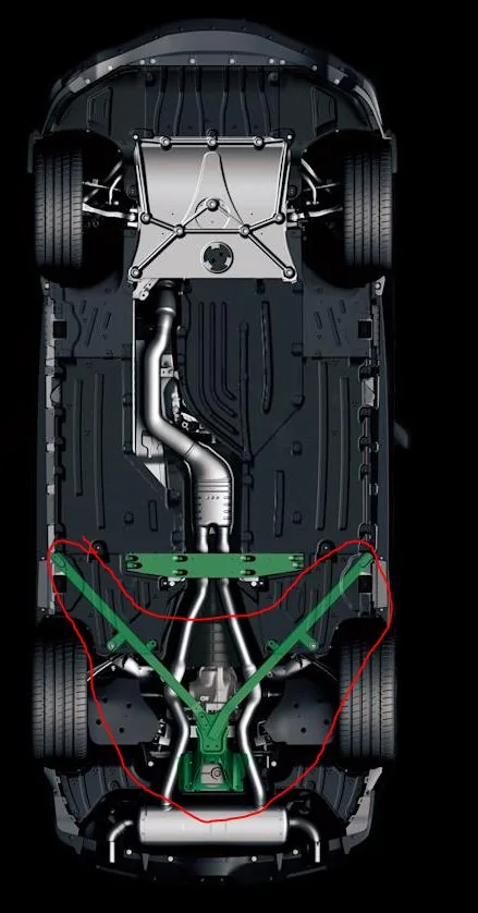

@catiktiks Also... your "lightweight" is exactly the same as the Final Edition here in North America.
The "real" Final Edition that EU/JP get does not have the brace because it runs a bespoke diff cover that would interfer with it. Also the same reason the 2026's get the M-lite diff cover with smaller cooling fins compared to the 2019-2025 Supras.

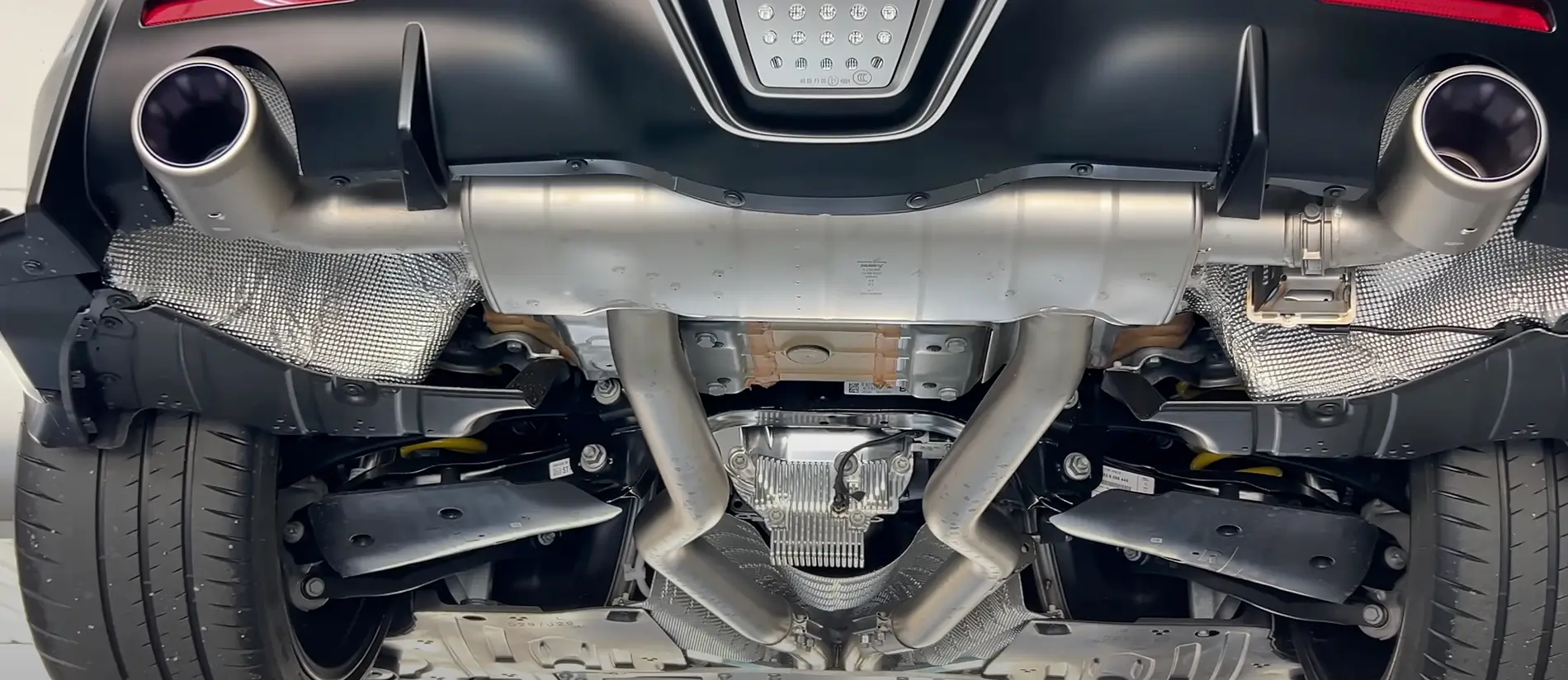

Hello. In the picture of the Final Edition's larger finned differential, I notice that it no longer has the vibration dampening weight that all Supras have. That means I can take it off too. It still weighs 2,262 kg, with its bolt it weighs 2,326 kg, which is quite a lot.

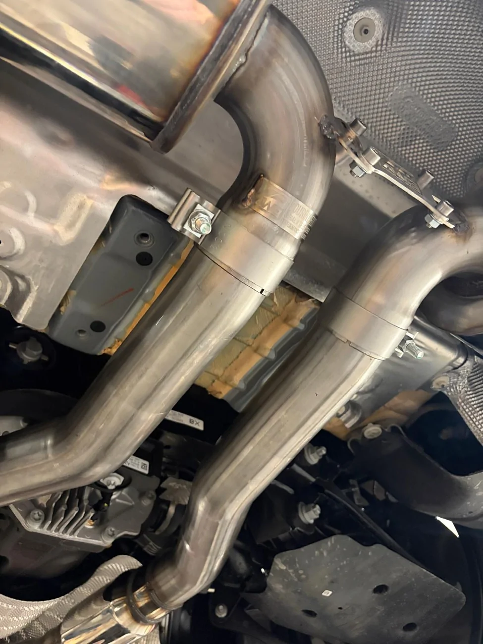

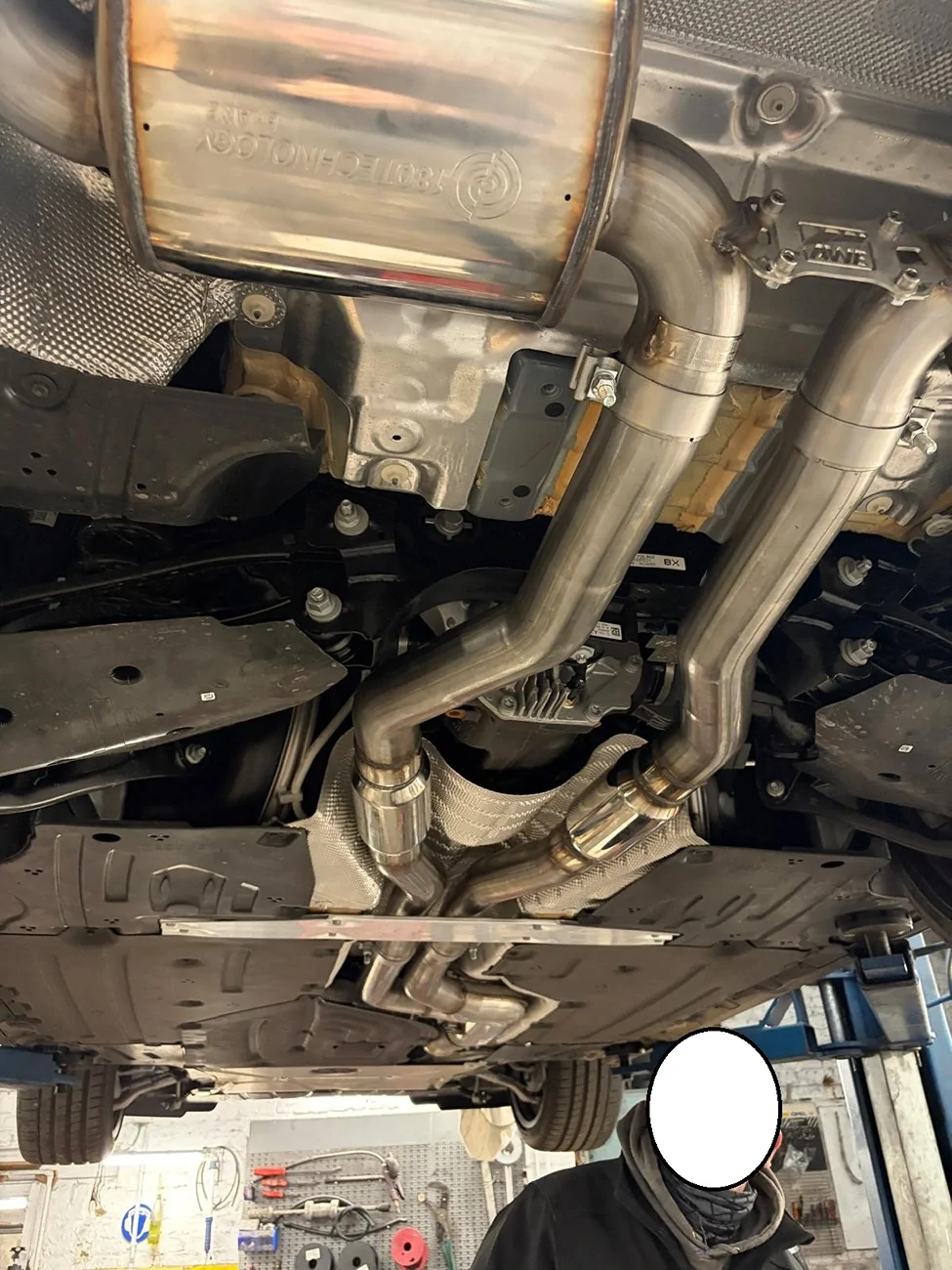

The Supras still have a lower weight on the differential bushing bolt and it is 1.489 kg. Does anyone know what happens if I take them off? Any noises, vibrations? Just dismantled but without a solid grip on the differential.
