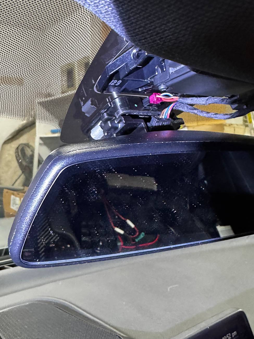

I previously used an adapter to hard wire a VIOFO dash cam to the small red adapter behind the rearview mirror. The connector splits off factory and allows me to connect two USB devices. The Dashcam has been working fine.
Several weeks later,
I then tried plugging in an Escort Max3 radar to the second USB connector and get low voltage warning on the Escort and it powers off. I noticed the USB adapter shows input 12V output 5V.
From what I've read the escort requires 12V and USB is always 5V. I'm not sure why it has a USB port then-- maybe just to connect to a computer and configure?
I tried using my meter test for 12V from some of the wires on the new adapter. Suddenly no power at all to that connector. I've spent hours checking fuses even the real hard to get to F1-F7 fuses behind the footwell carpet. So far I only checked the F1 fuse there, which is listed for DRIVING ASSIST components.
OSD is displaying "Auto lighting and wiping system malfunct."
The wipers do work, although the AUTO light on the stalk does not light up green anymore in the auto position.

The red connector is a factory connector that connects to the Rain Sensor. I see that the Rear View Mirror is attached to it also, but the rear view mirror appears to get power. There is another factory connector there, maybe that's where the mirror gets power.. (which works) Since the error refers to Wipers, Im guessing its the red plug above it that doesnt have power.
I removed the 3rd party adapter, same thing.. when I start the car I get the error:

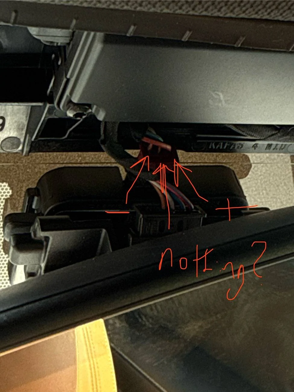

Hey guys, I just got my supra a few days ago and I tried hooking up my escort redline 360cc to the same area. I used these from amazon:
https://www.amazon.com/dp/B0DR2Q9CBH?ref=ppx_yo2ov_dt_b_fed_asin_title&th=1
I hooked it up to the red connector as seen below, black to - and red to +
So black to far left on the red connector and red to the far right on the red connector.
I don't know what the middle wire is for tbh.

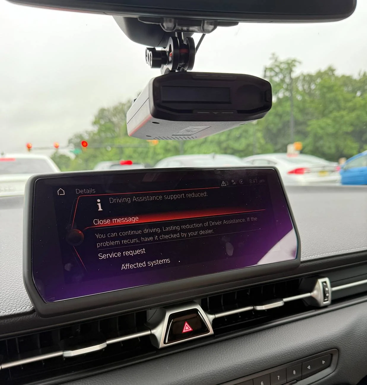

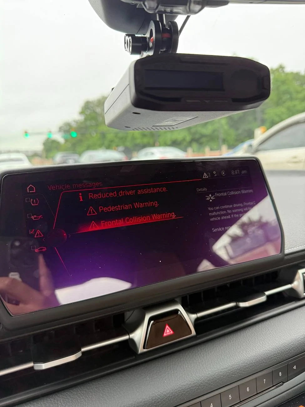

Then this morning got these error messages when I came to a stop at a red light...
After a bit the car warnings went away and the system check was ok.
Please let me know how to properly hook up the radar, and are the warnings tied together?
