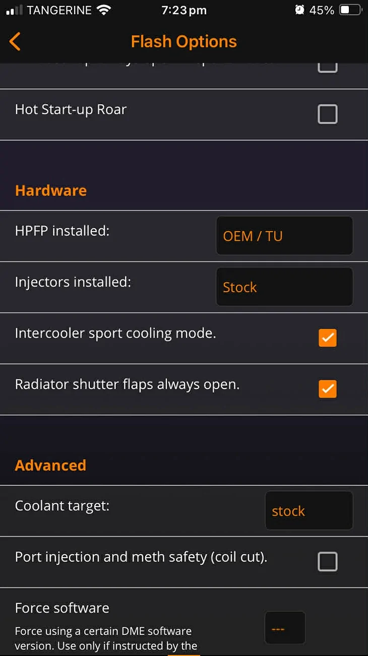

It would be fine. They have presets for both. It's not like they would be running it with mapping that was for OEM fueling. I've run HPFP and S58 injectors on the stock tune with the presets selected.

you're not capped to any ethanol percentage. the flexfuel tune can run any amount of ethanol on stock fuel system, so you can run full e85 if you want. the best performance will be at E40, but the tune safely dials back boost for higher ethanol mixes or full e85.
OTS maps are designed for the minimum required mods. so stage 2 only needs a downpipe. anything above that will not make any more power. the drop downs just apply the necessary settings so the car can still run with the aftermarket parts installed.
