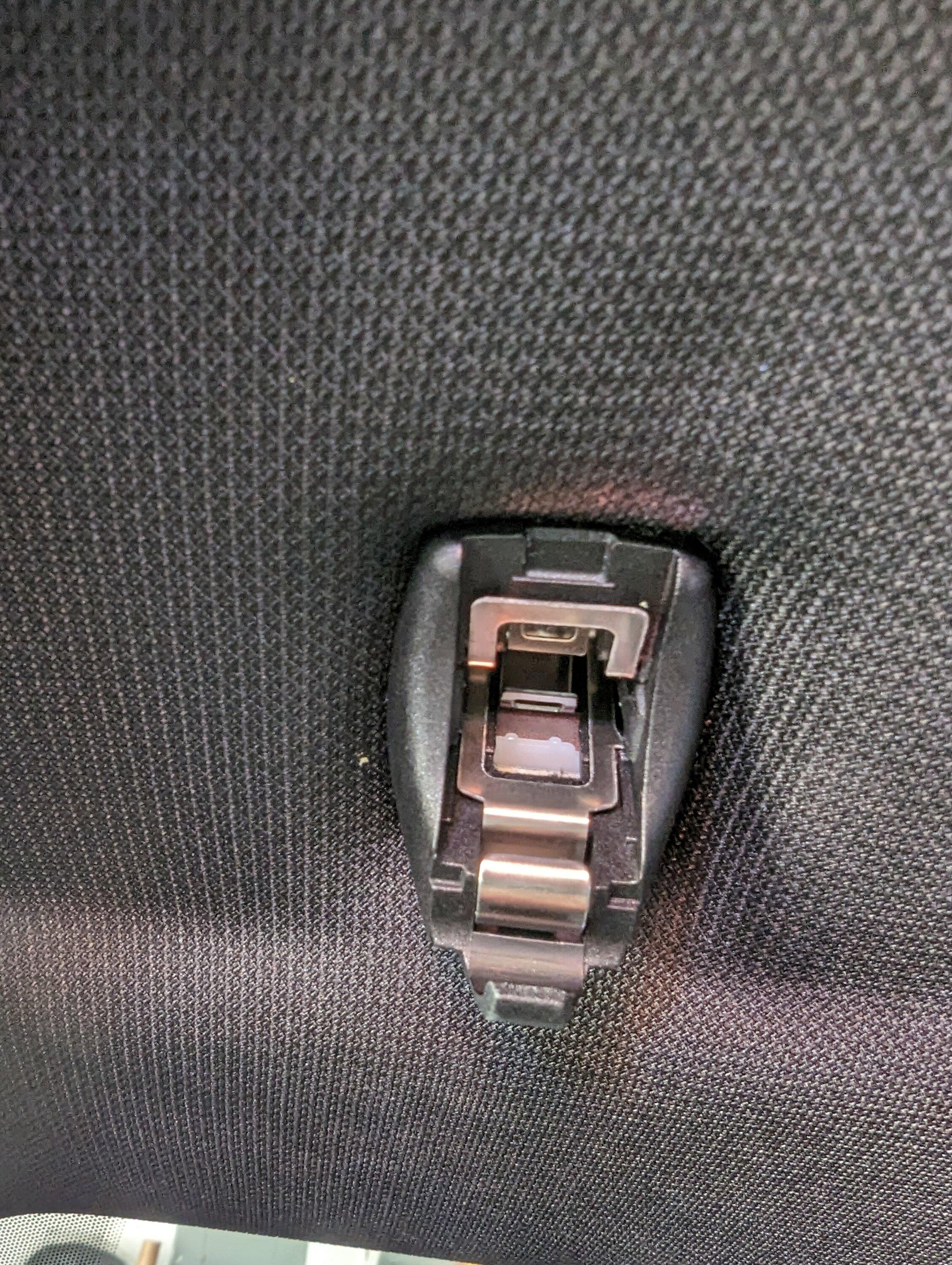

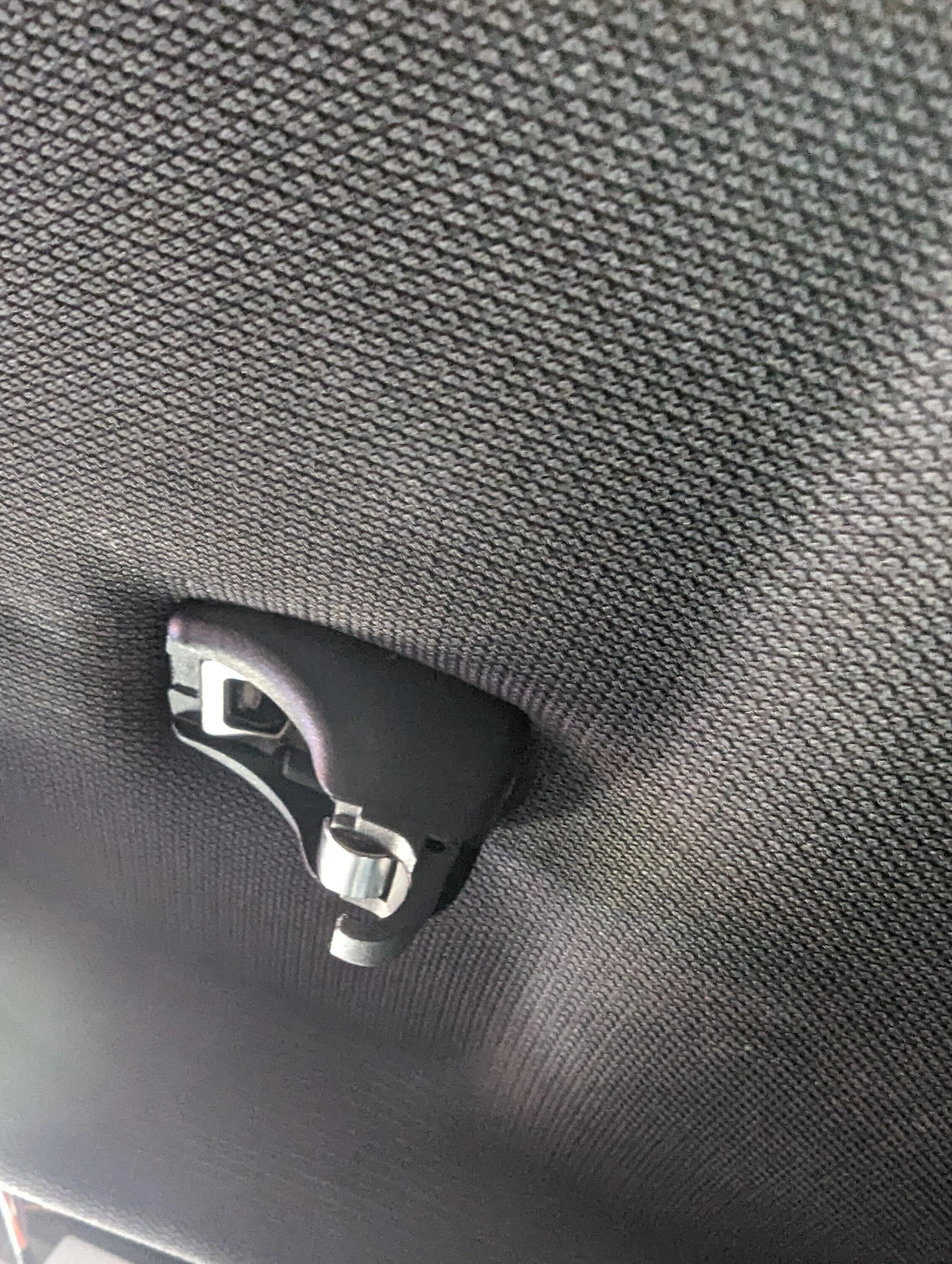

Hello! I was wondering if anyone knows how to remove this sun visor piece. I'm trying to remove the headliner and this is all I have left to yank off 😂😭

Pinch these together (inward).
I used 2 flathead screwdrivers.
Or needle nose pliers.

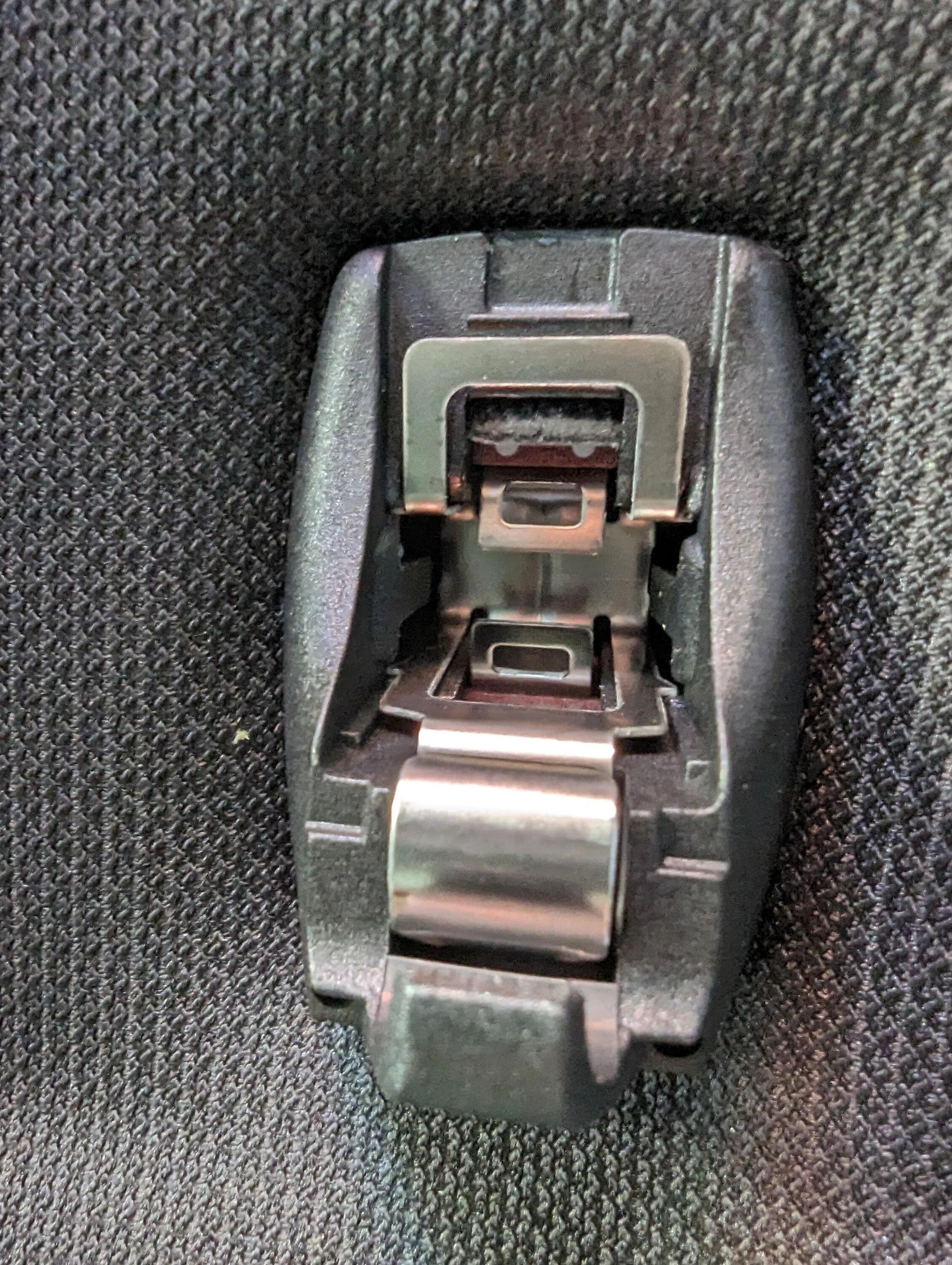

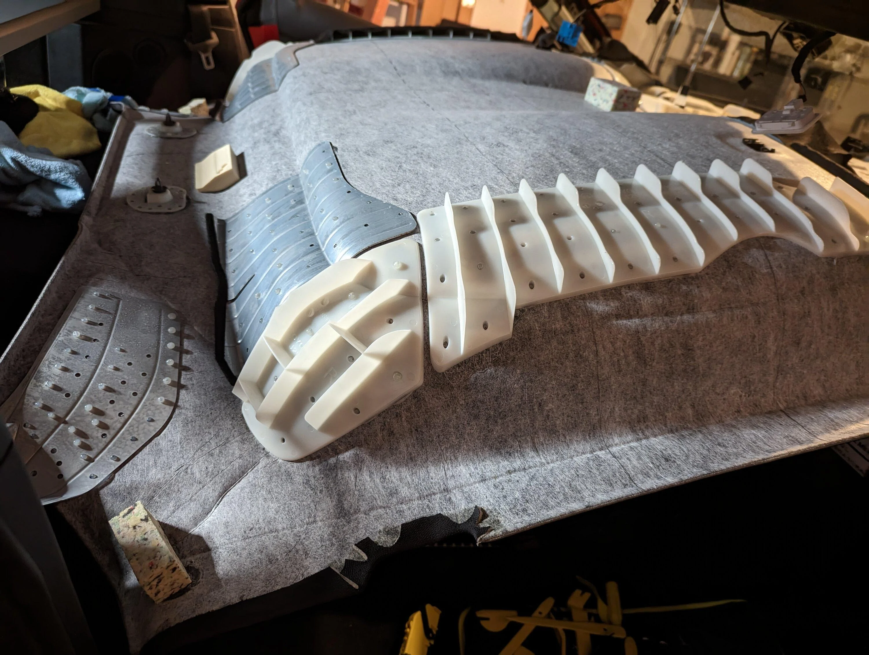

Well, I couldn't get it out the car so I'll be working with it inside, but does anyone know if these plastic and metal pieces can be removed? Or just drill through it? I'm trying to do a starlight headliner by the way 😮💨

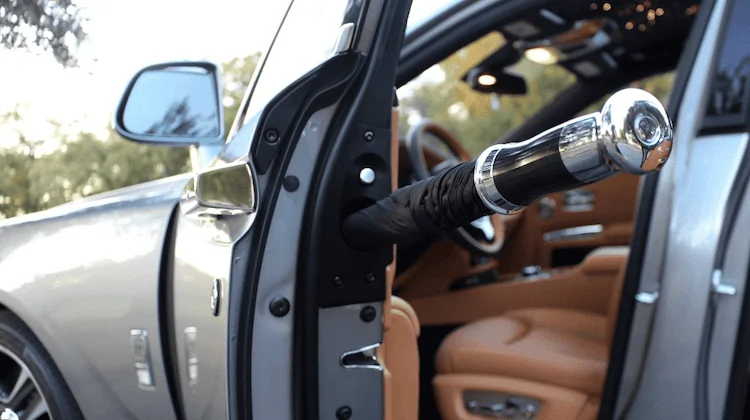

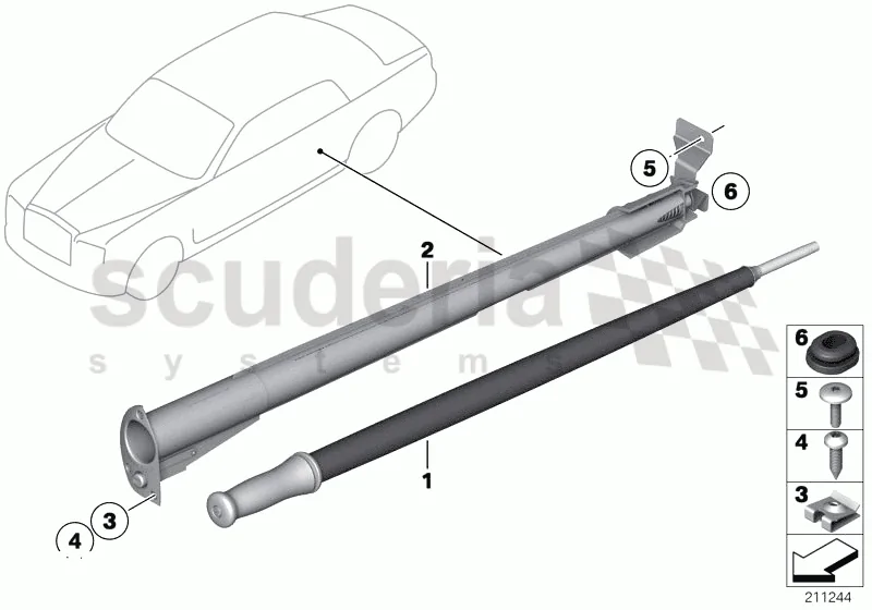

Hmm, I guess you can code in the little Rolls-Royce harpist so…
Hey I’m looking to do this in the next couple days. Did you end up removing the plastic and metal pieces or drill through them?

Not gonna lie, if I could do this and make it appear as though it had always been there I definitely would. I’ve always kept an umbrella in my car with never anywhere nice to store it.
When I visited my good buddy in Tennessee he we had two in the car behind the seats. Even if they're back pretty much all the way there is still quite a lot of room there.
J29DB03
Dec 14, 2021
1,697
3,212
2021 Absolute Zero 3.0 Premium
Yea, that’s where I have mine but I’m still not happy with it. I’m very anal about things being in my car that don’t have a proper place, realizing an umbrella is not the same as a used bag of McDonald’s.
