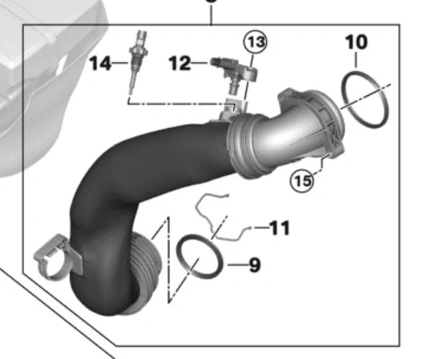

BMW part# 13718696103

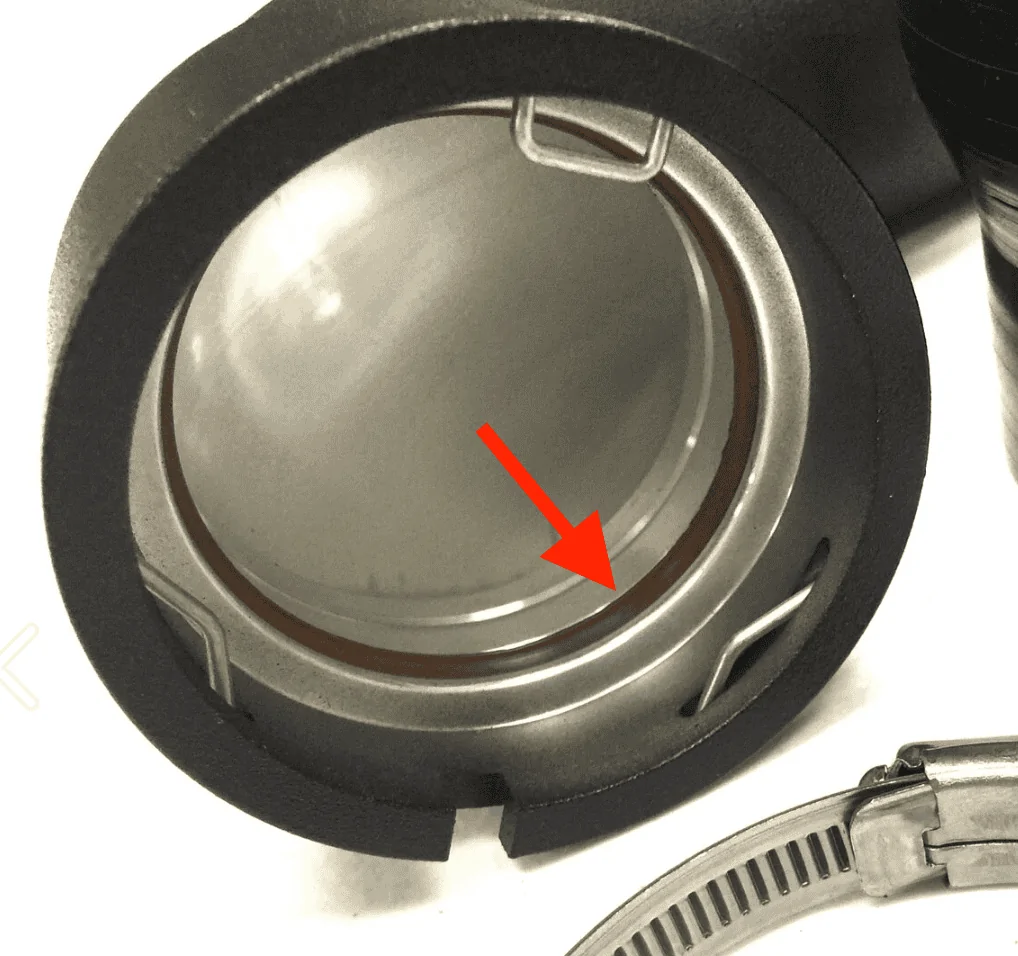

The FTP part does have gasket in it already though...
Unless it isn’t rubber, I didn’t see one. The pipe also didnt seat very well. I’ll need to take pictures of it next time i take my car apart to give a better visual. I readjusted the angle of the pipe multiple times but it never seemed to feel fully secure in there.
i really hope it’s just user error on my part and not a defective part.
There is a inner ridge that the seal goes into

I noticed that but didn’t feel like there was a groove to put a gasket in.
Either way, gonna take the car apart when it comes back from the shop today and pull out the charge pipe. Ended up ordering the gasket too from the part you listed. Hopefully it works.
