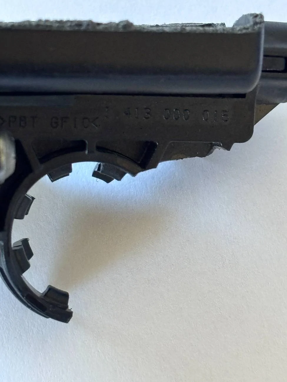

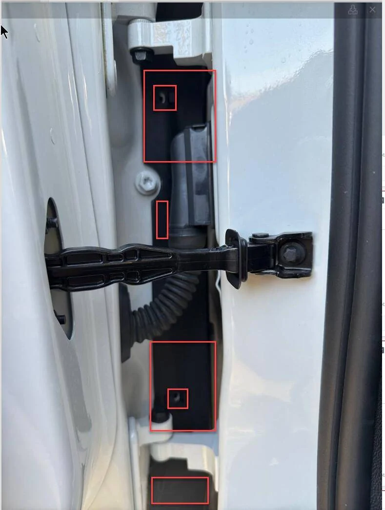

Hi,
Would anyone be able to assist me on what part number this is for both right and left sides, I broke the clips and not sure if I can order just the clips if they have their own part number or do I have to order the hardware and hope the clips are include?
Thank you for your time!

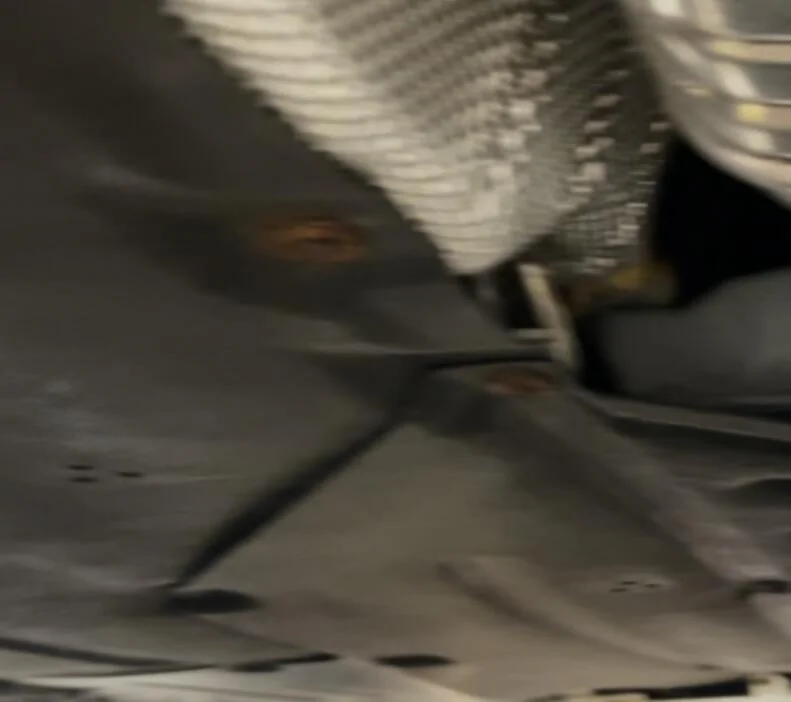

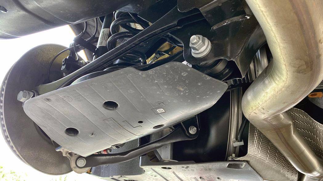

Anyone know what part no. for some of these fasteners are? Picking up this car later in the month just like to have it clean without the surface rust.

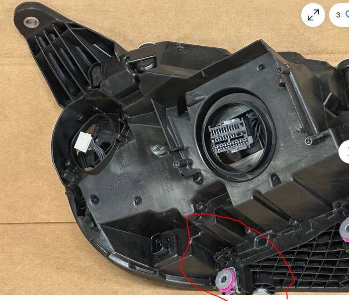

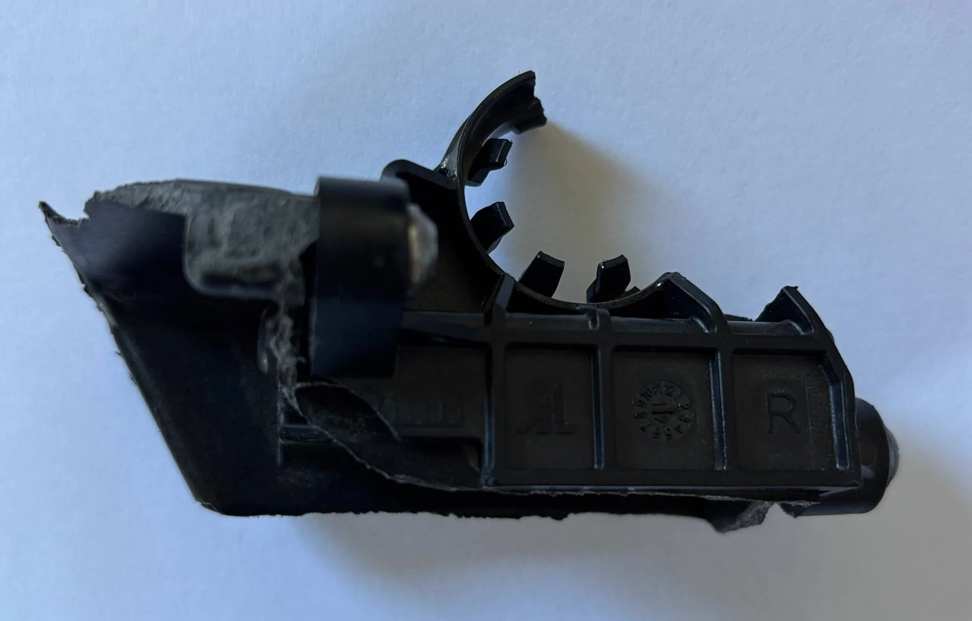

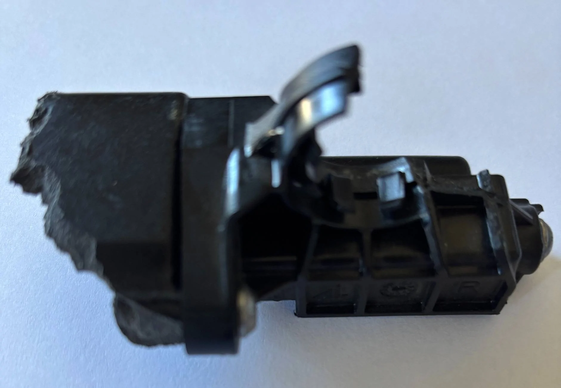

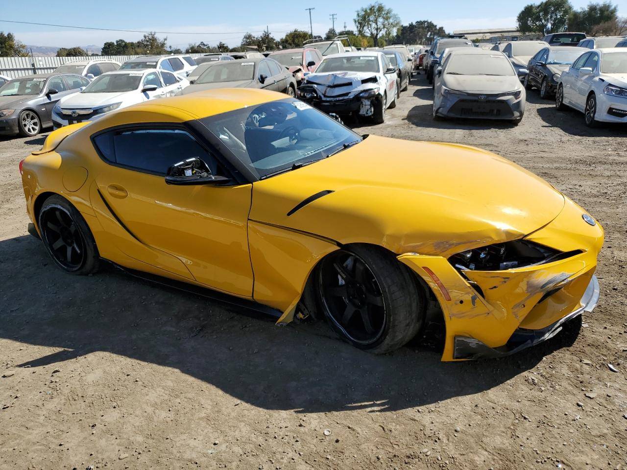

The car that was hit on the front passenger side.
Repaired everything but I'm left with that broken piece that I haven't been able to identify where it came from.
Any clues?

Looks like a bumper retainer bracket. Do you have any photos of the car damaged to help identify where it may have came from?

I did spend a couple of hours looking at parts diagrams on yoshiparts.com for anything related to headlight, bumper and aux radiator but came up empty handed.
In retrospect, the only thing I can think of is that it came from inside the headlight which was completely destroyed.

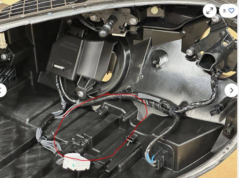

So I spent more time than I should have on this because I wanted to know myself lol. I pulled and looked at all front end components, radiator, cooling components, inner structure, fender and the rocker molding. What I could find that makes the most sense is 1 of two things.
1. The part is from a different car and it was tossed inside at the tow yard, if it was struck by another vehicle and this lodged in the bumper/headlight opening if that is where it was found.
2.Inside the headlight there is a spot which looks almost identical to these parts. The circular object looks like the one I highlighted in the picture. Since this part isn't serviced outside the assembly, there isn't an actual part number. Luckily I found some listings on line of the head lights torn apart since they are so expensive, I guess people part the lights out.

Amazing detective work. That's 100% it on that 2nd pic.
Thank you. I can now sleep knowing I didn't forget something critical.

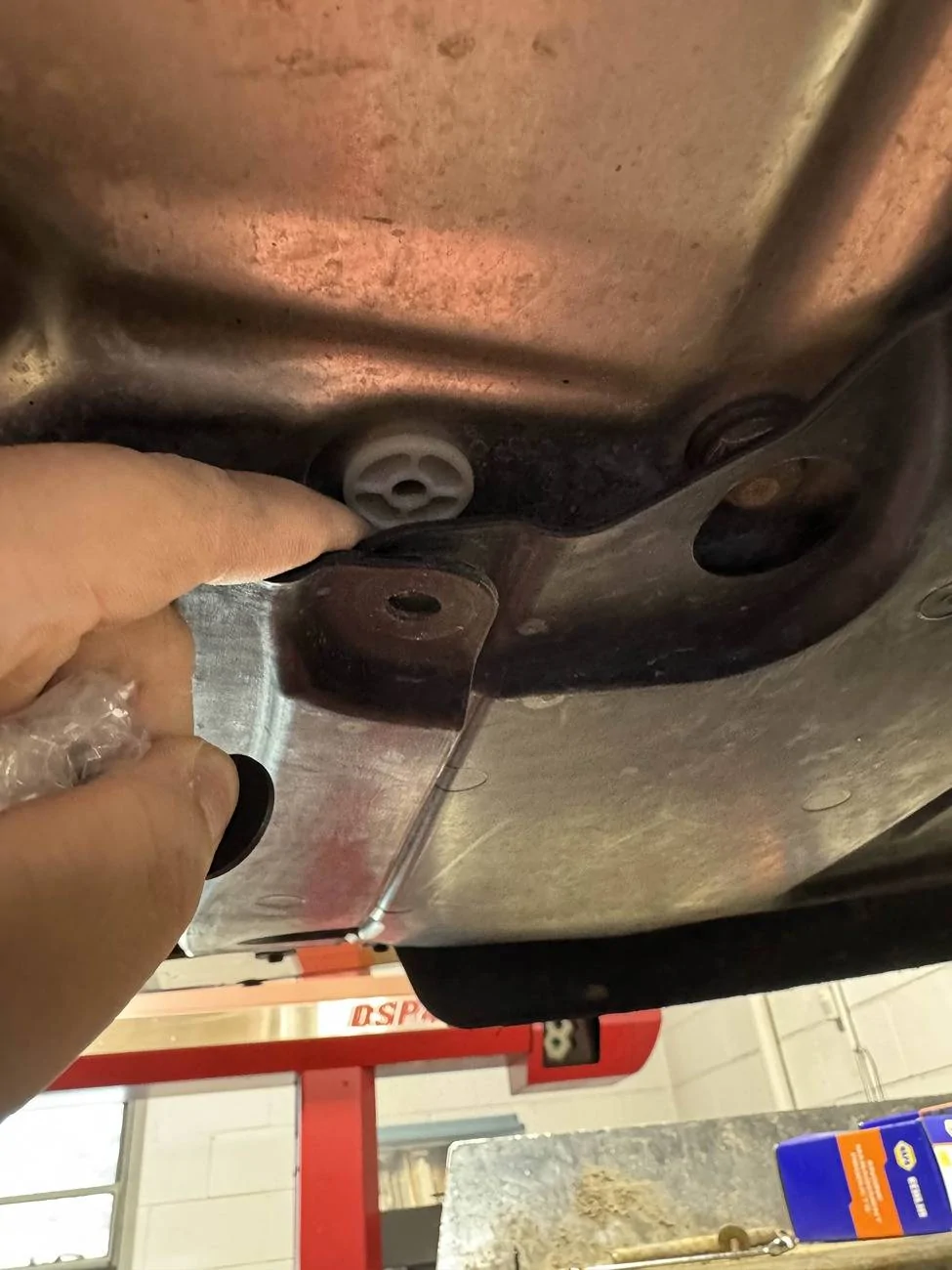

Anyone know what this plastic clip is, was replacing the rusted hex bolts from above and the threads went with the bolt.
