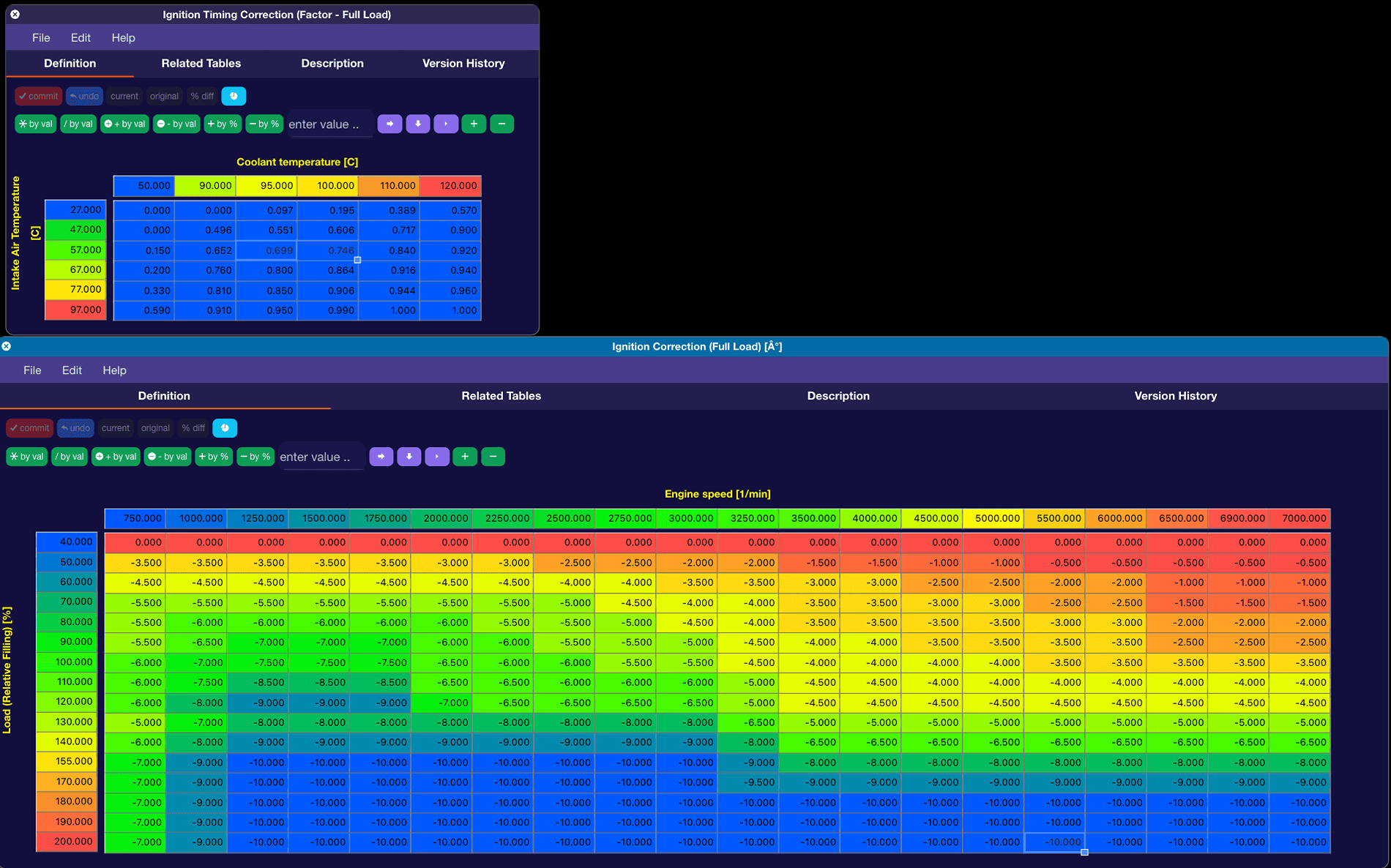

This is Bm3 Stage1 E30 I'm running. Am I looking at the "(RAM) Ignition Timing Corr (Total)" for the information I want? Or better the individual cylinders (which vary quite a bit and makes me curious why). I'm seeing -6.5 degrees total correction at times. Is it actually detecting bad sounds and reacting? Or does the timing correction also factor in things like IAT to arrive at the total correction preemptively?

Most of that is IAT ignition correction.
Your IAT's start at 115F in 2nd gear and are 140F by the end of 4th. The DME will be pulling timing aggressively at those temps.
The stock turbo pumps out a lot of heat at those boost levels.

Here are the IAT correction tables. The top table is a based on IAT and Coolant temp and sets a percentage lookup of the bottom table. So at around 140ish IAT and 205 coolant, it is at about 70% of the bottom table, so at 200 load at 5500 rpm, it is taking out about 5-7 degrees of ignition. The OTS map might have softened this a little so you are seeing a little less being taken out.

Thanks, this helped me tremendously. So the IAT/ECT table IS factored in beforehand. It's July/August in Texas so I'm dealing with 102*F ambient.
