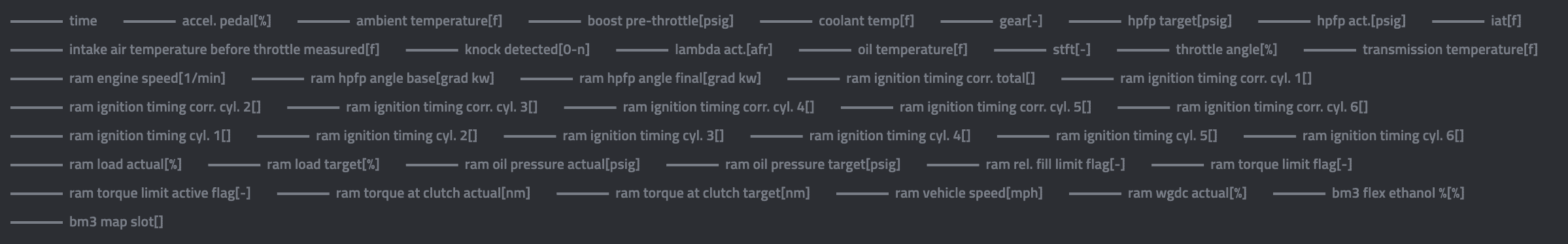

Use RAM items whenever possible. Quickly looking at your log, you don't need to log:
engine speed (use RAM)
ignition cyl 1
ignition timing 1-6 (use RAM)
lpfp act. raw
load act. rel. (use RAM load actual)
load act. rel %
Both MAF items
actually before I just keep going, just log these items:
You don't need to log transmission and oil temps/pressure if you don't care. I just log those on track.
When getting the car tuned there will be other items but it looks like you just want to log and see how the car is running currently.
ignition cyl 1
lpfp act. raw
load act. rel %
Both MAF items
Thanks again. reconfiguring right now.
