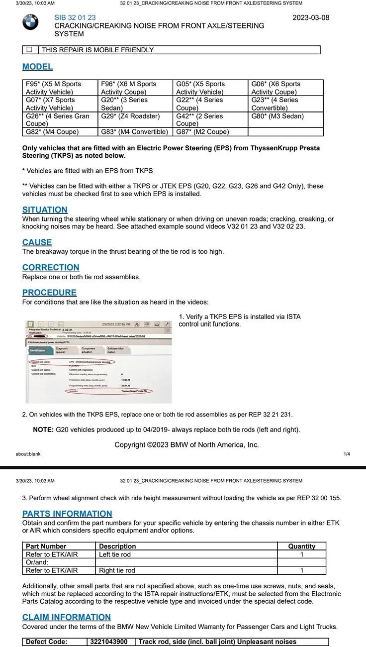

My car doesn't have the thunking, but I have the creak at 9 seconds. I jacked up the car and took the wheels off.
When turning the Hub back and forth by hand,
initially thought it was due to misaligned top hat bearings, but those were fine. No noise coming from up there, and there was no radial or axial play throughout the range of motion.
in my case the creaking noise was coming from the inner tie rod/steering rack area. But grabbing the outer tie rod directly and yanking, I couldn't make any noise. :dunno:

Were you able to ever get rid of the noise?
nope still there. i crawled under the car during my last oil change and turned the wheels side to side with my feet. definitely coming from the rack area.
But reading about bmw steering rack and lower spindles issues, mine doesn't have a characteristic dead spot or any steering wheel feedback, it's purely sound.
edit: maybe it's this??

Does the supra fall under those specs where it would be relevant?
