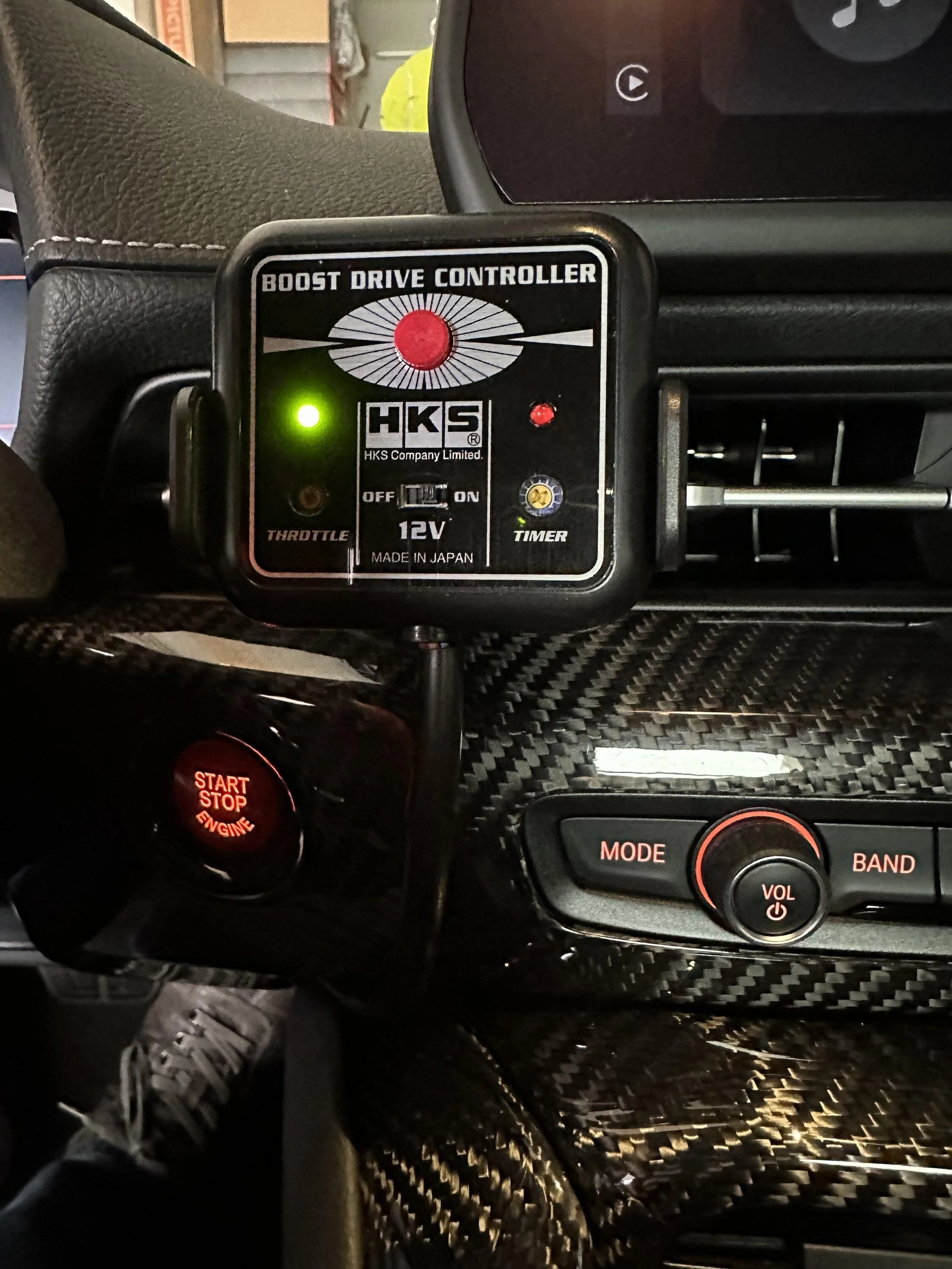

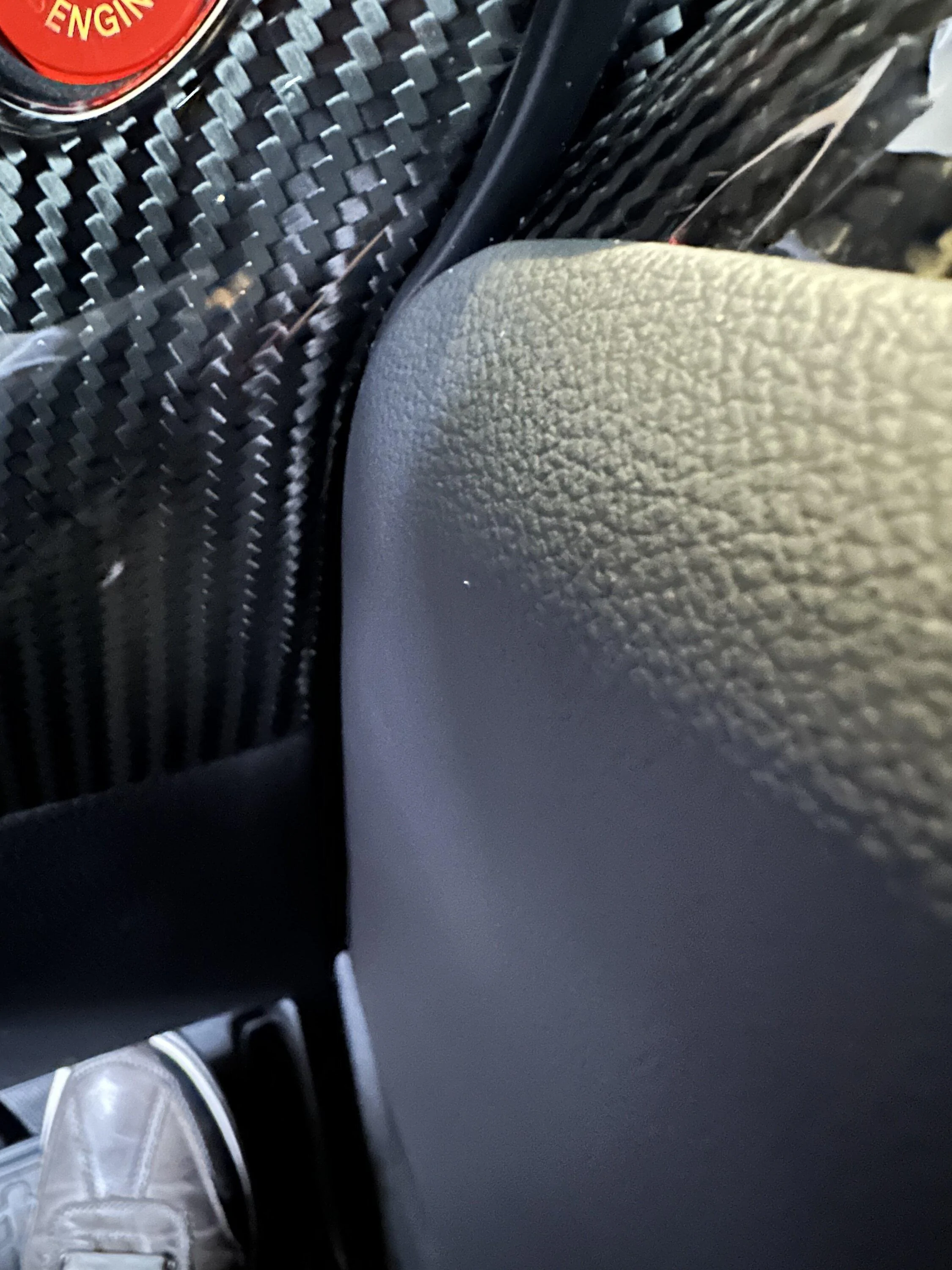

Did you remove the panel above the drivers side footwell above the pedals? If you remove that you’ll have lots of access to tuck/hide the wires from the pedal behind the carpet. Then the controller wire can just be tucked along the panel next to your right knee. Here’s a couple pics from my car.

Yes I did. I got everything apart. I tied into the 12v under the cell phone charger per directions. Do you remember if you have one empty port on the solenoid? It says to remove 3 caps, but only install 2 vacuum hoses.

That is correct. Leave the one port open.

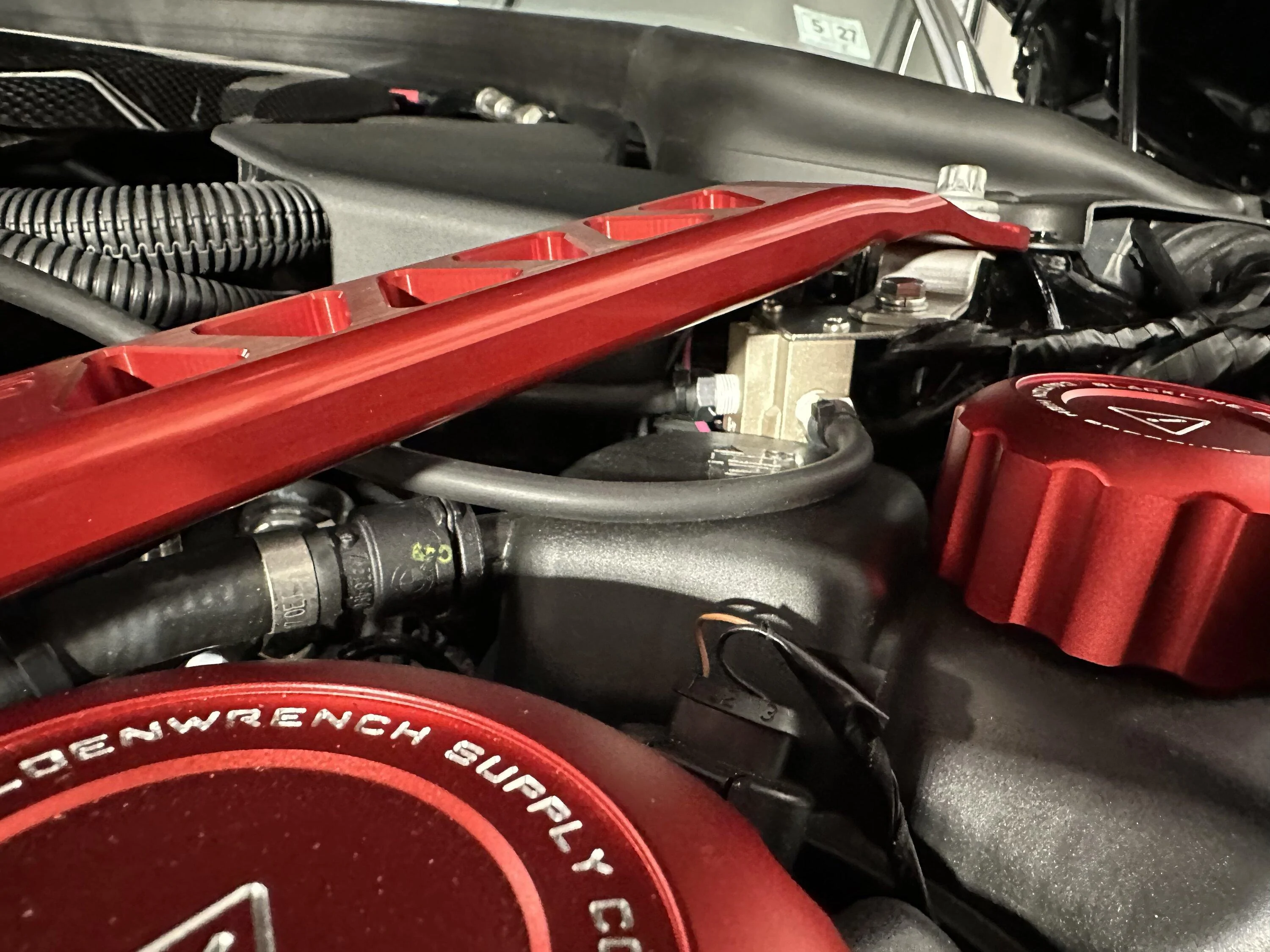

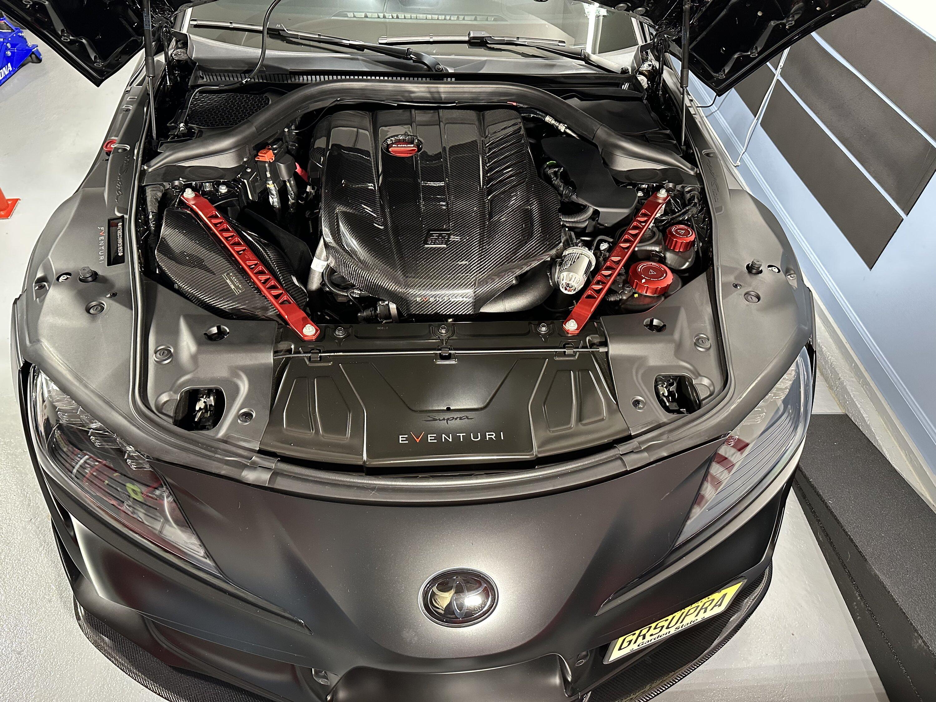

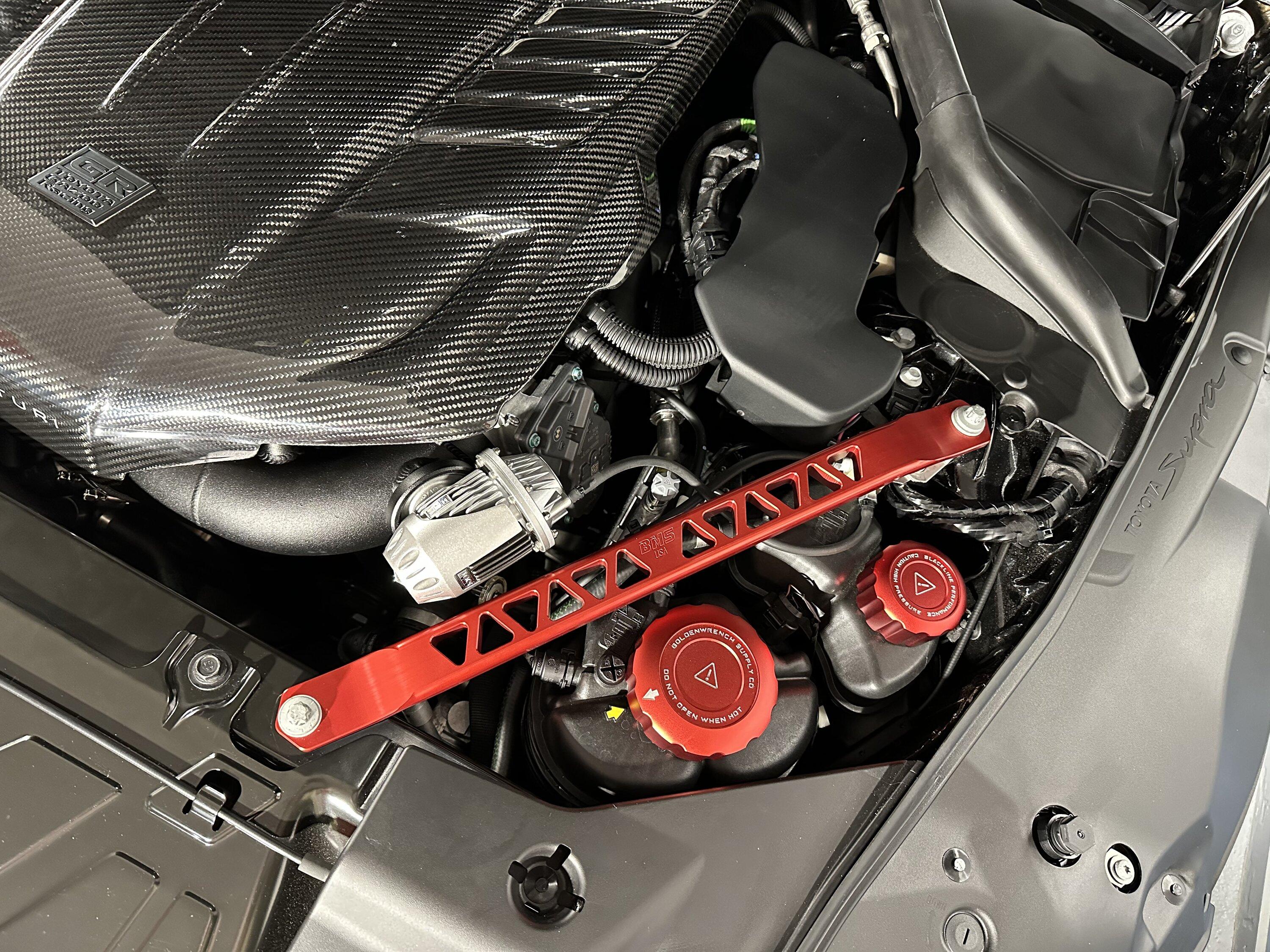

Does anyone know if the HKS BOV will clear the Blitz Strut Tower Bar?
