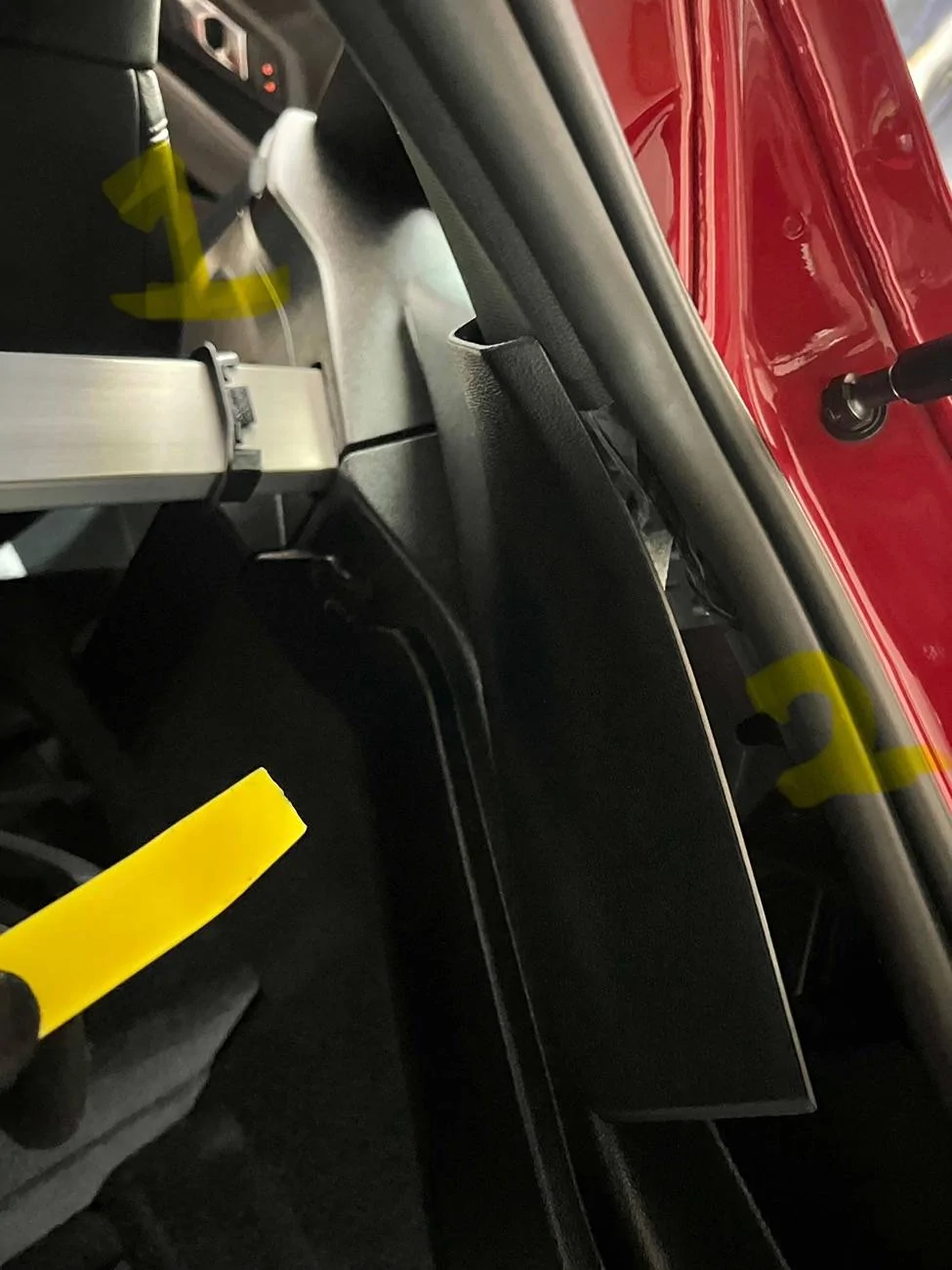

Made this quick tutorial on how to eliminate creaks cause by the interior plastic on plastic in the car. This can be mostly heard on bumpy uneven roads and more on a hotter climate. This is focused on the rear panels located next to the seats and behind them as it’s not so common to have creaks around the dashboard.

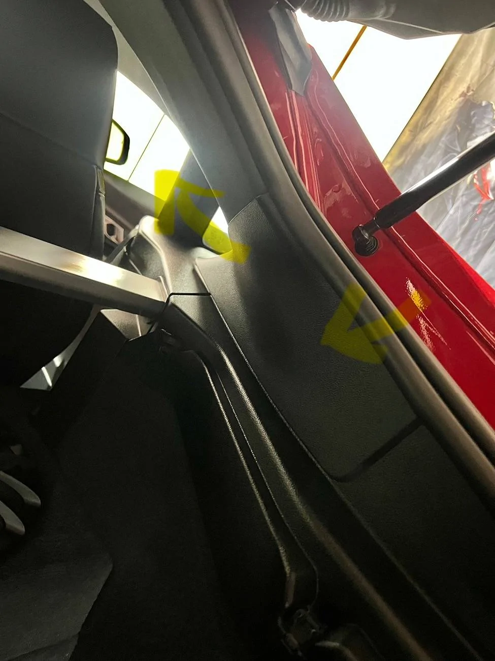

1. Remove your cargo cover
2. Locate the surrounding trim on silver bar and remove(1) my pulling it towards the side as the image shows.
Pop plastic trim(2) by prying from the rear as shown as the image. You will then need to push the trim directing to the front of the car for removal(pulling it from the front seats was easier for me)

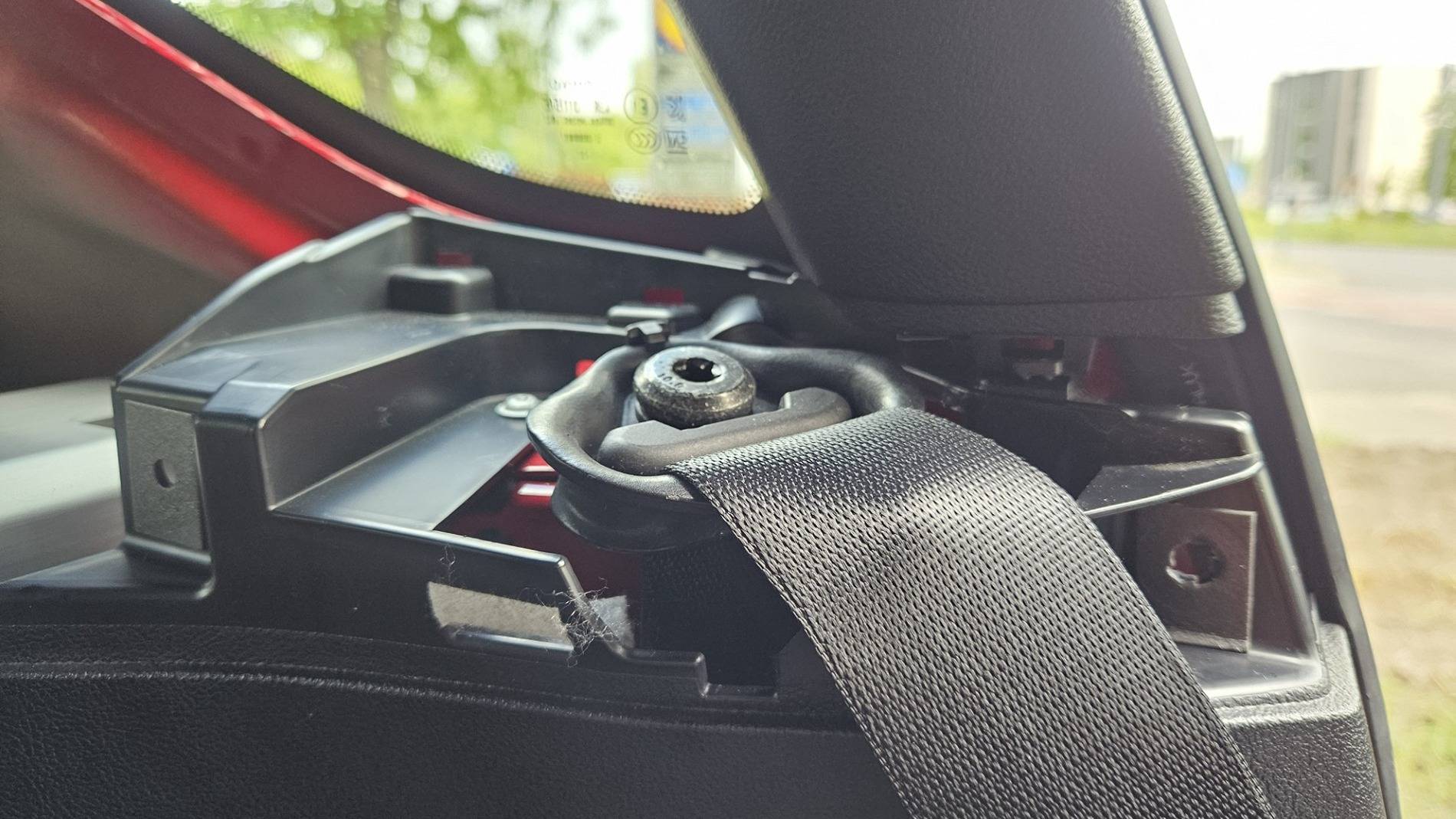

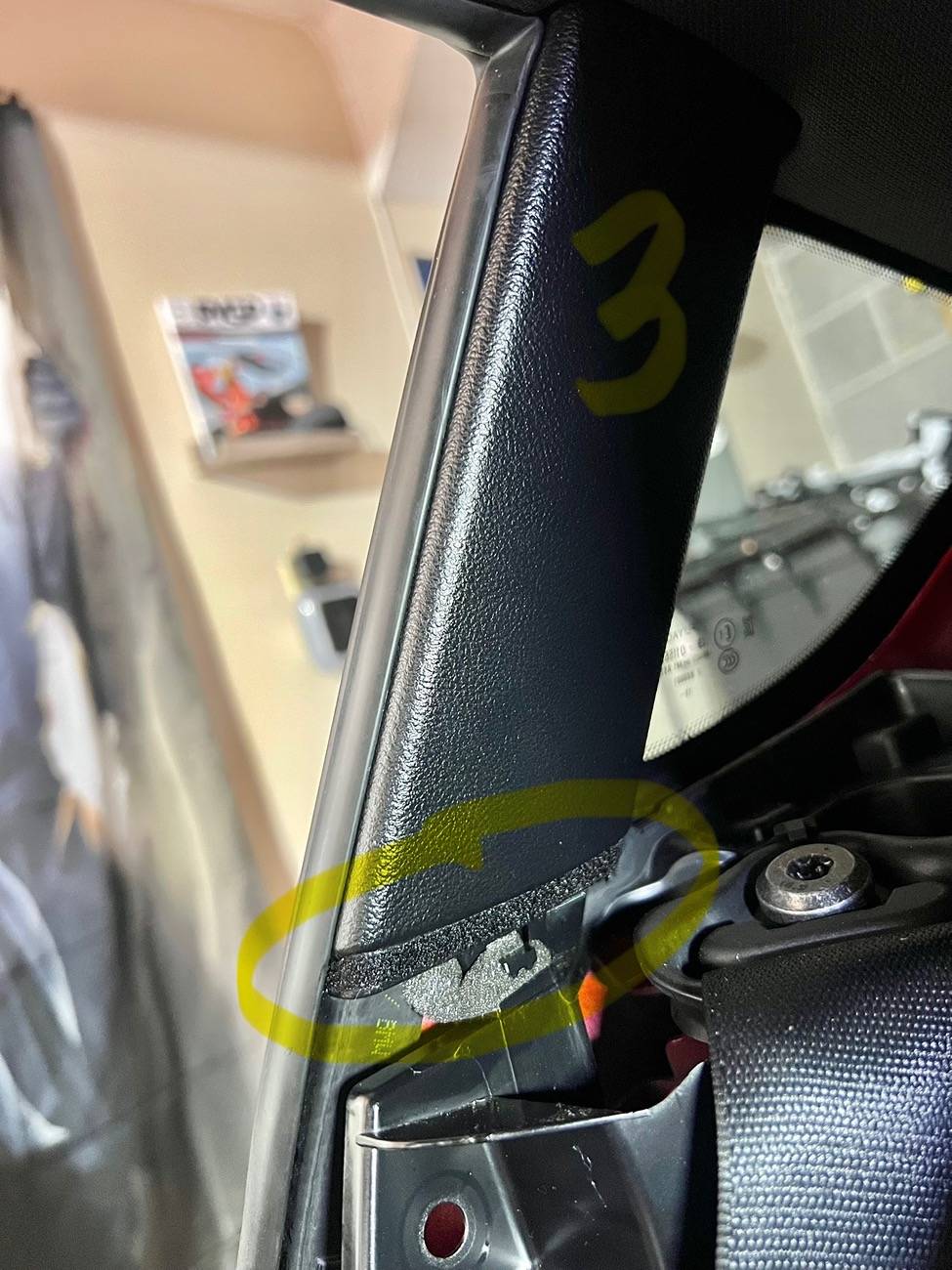

3. Remove plastic trim around the seat belt by pulling it towards you while you are siting in the front seat. Once the trim is remove you could also check if the rear bar needs tightening as you have a clear view access to the bolt(s) holding it in place.

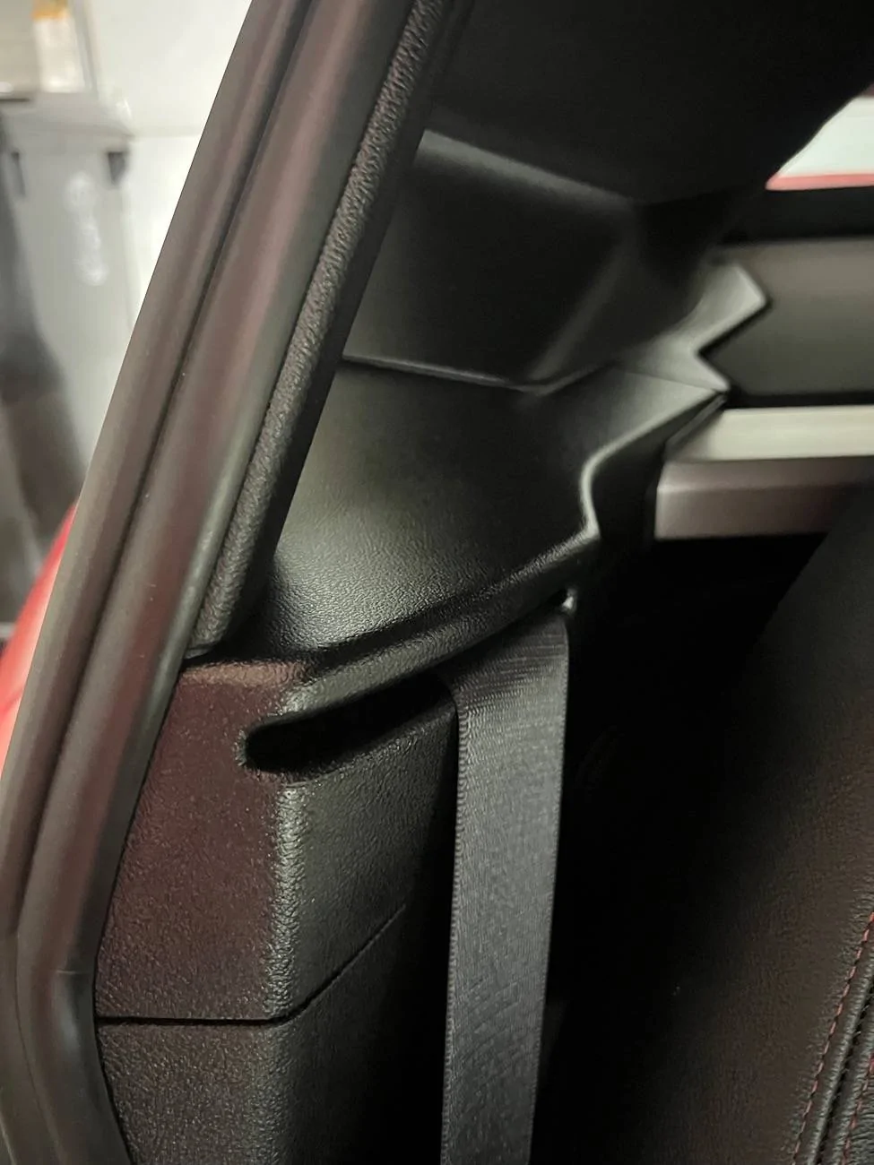

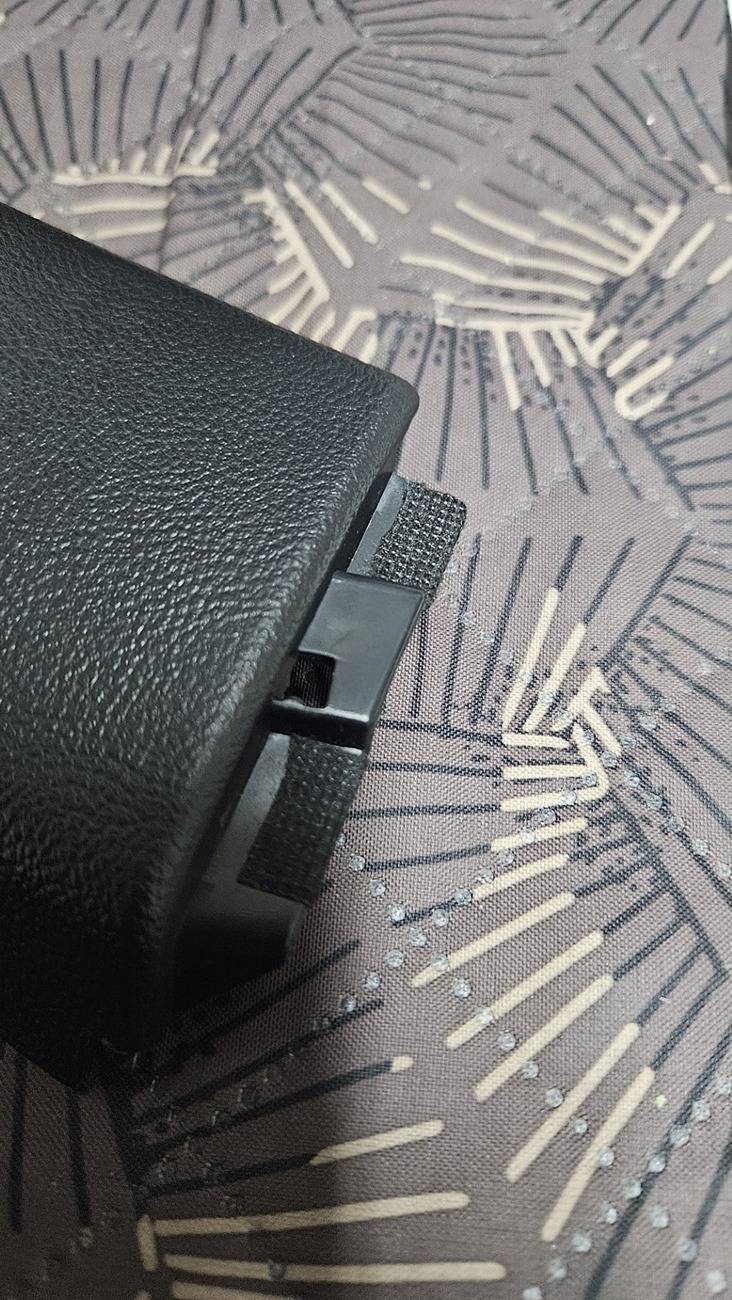

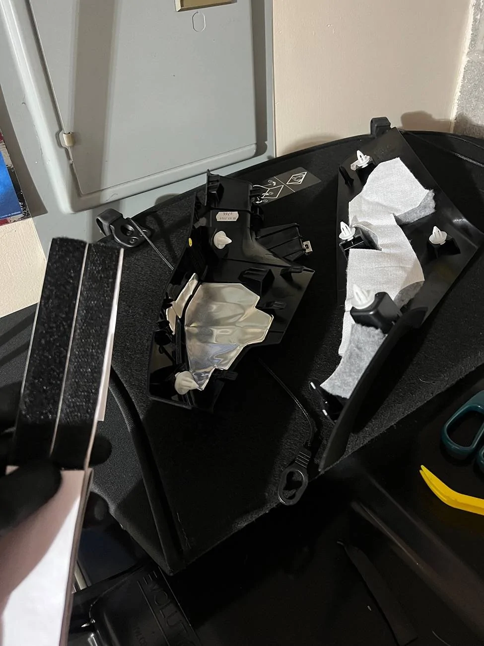

4. With the two panels add the Velcro strips as shown in these images. With the scissors I trimmed down the Velcro to have a nice clean finish.

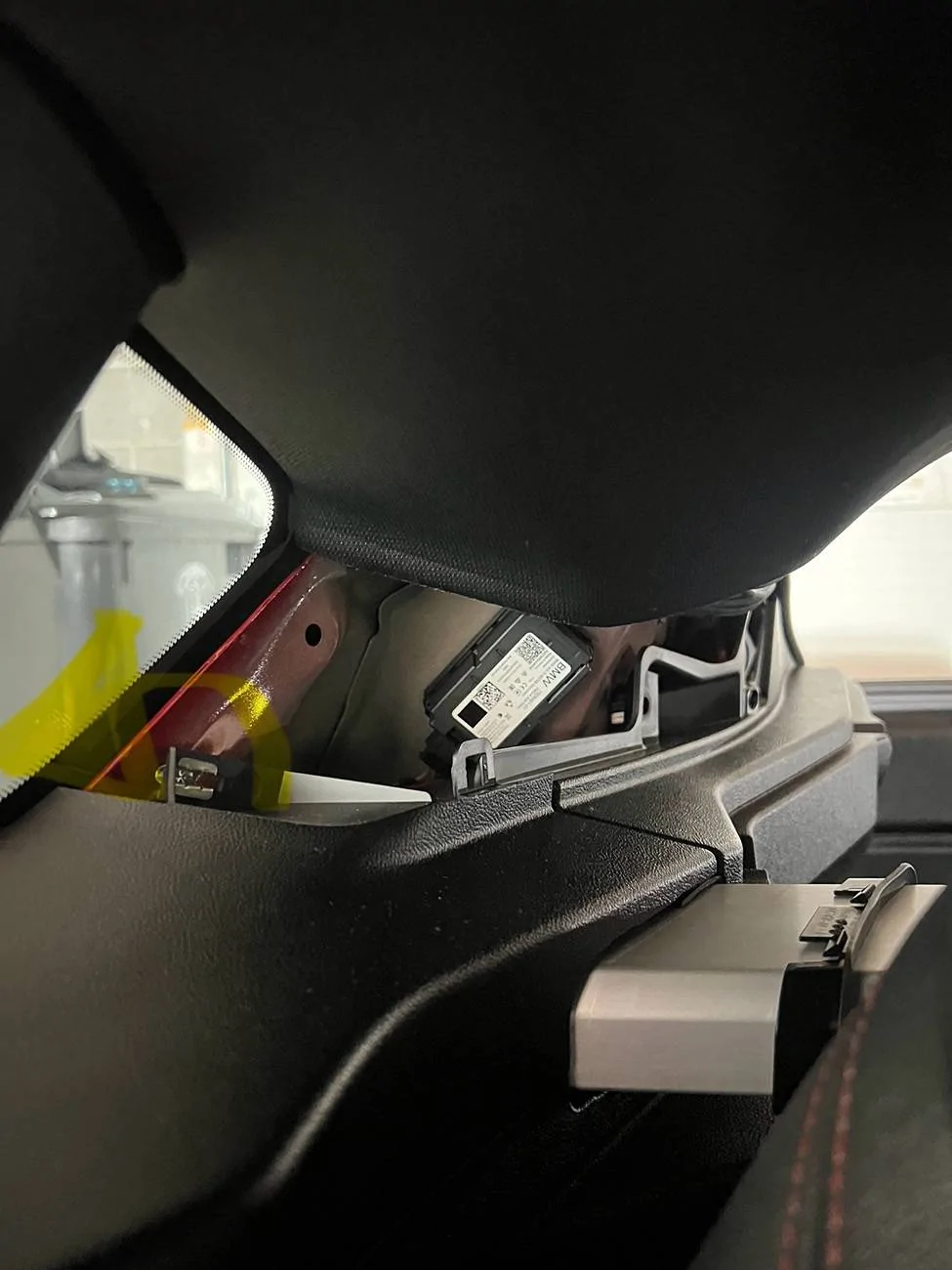

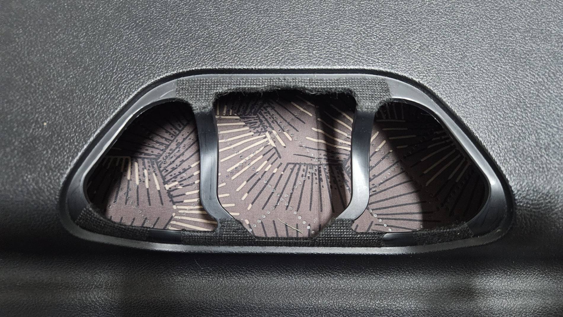

3. Add Velcro to the small panel placed next to the glass as shown below.
I added a piece of foam on the bottom clip holding it into place but you can add a Velcro as well to secure this trim.
4. Place the trim pieces back in reverse order.

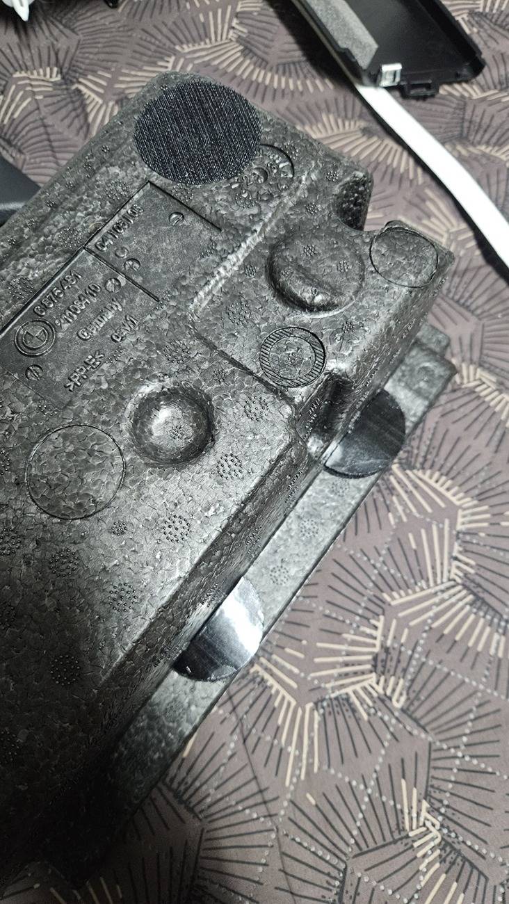

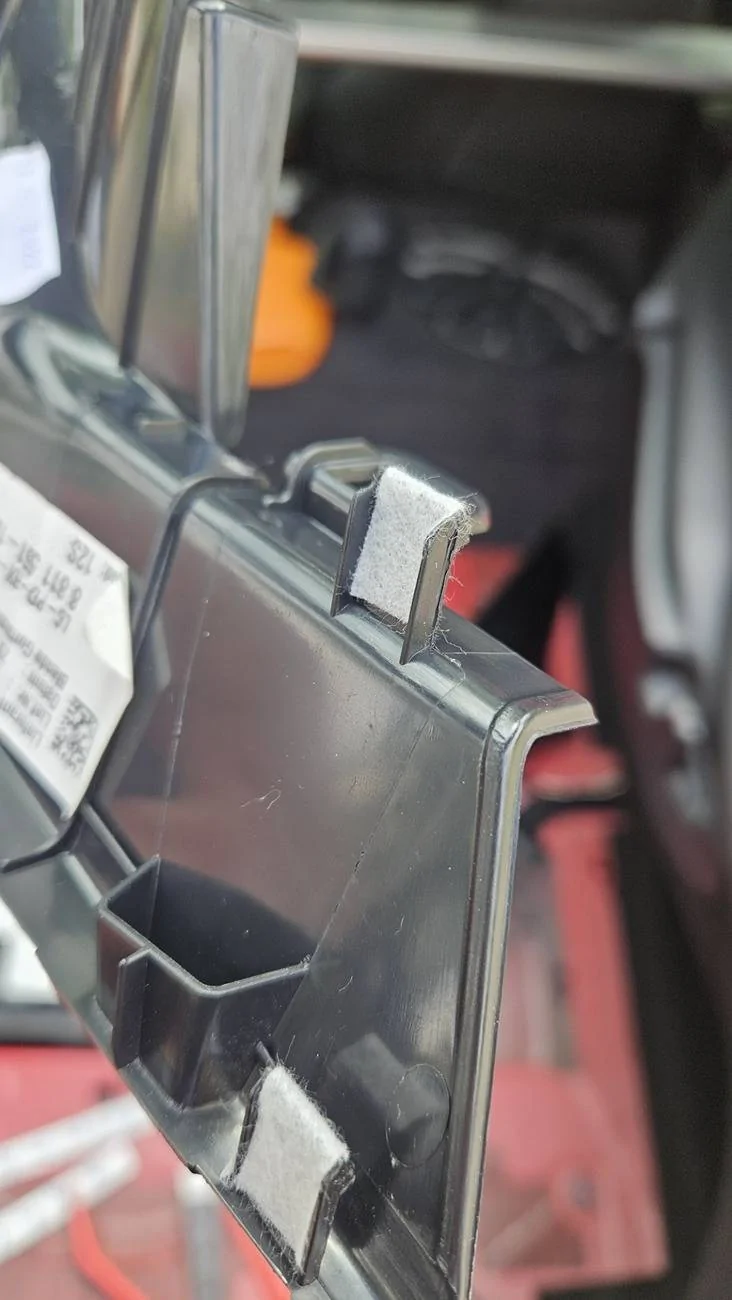

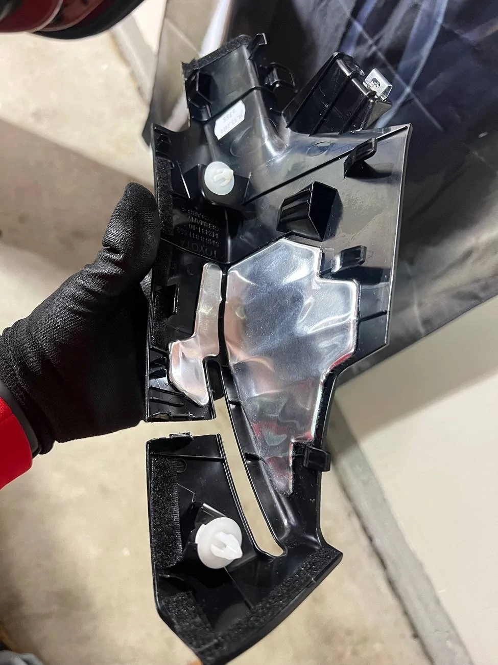

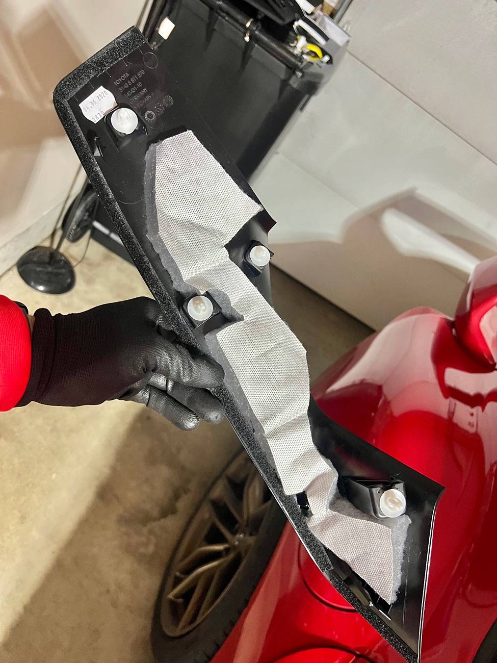

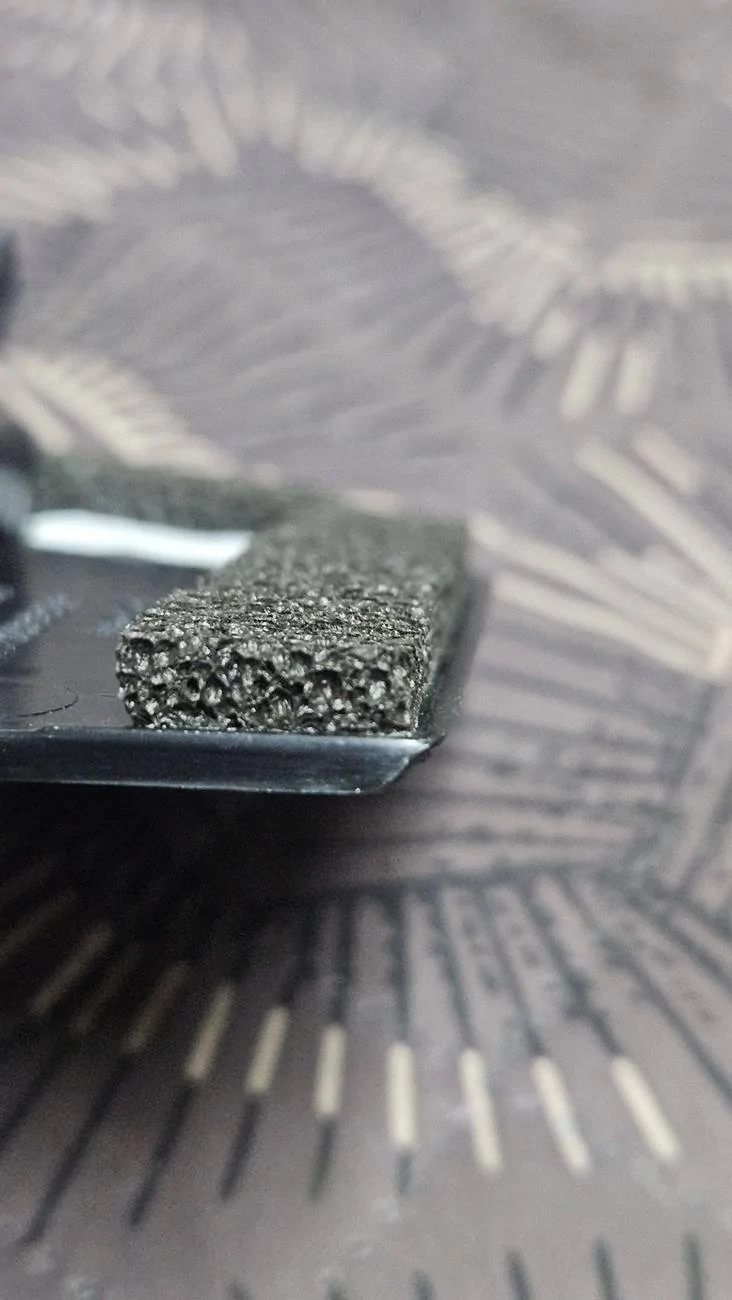

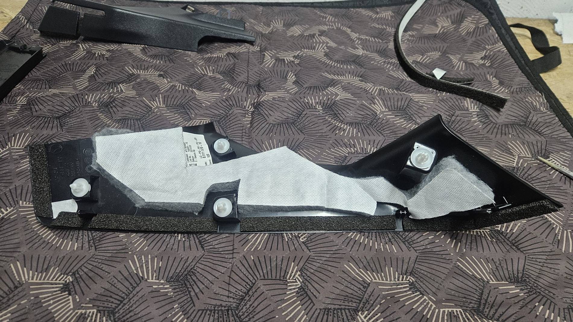

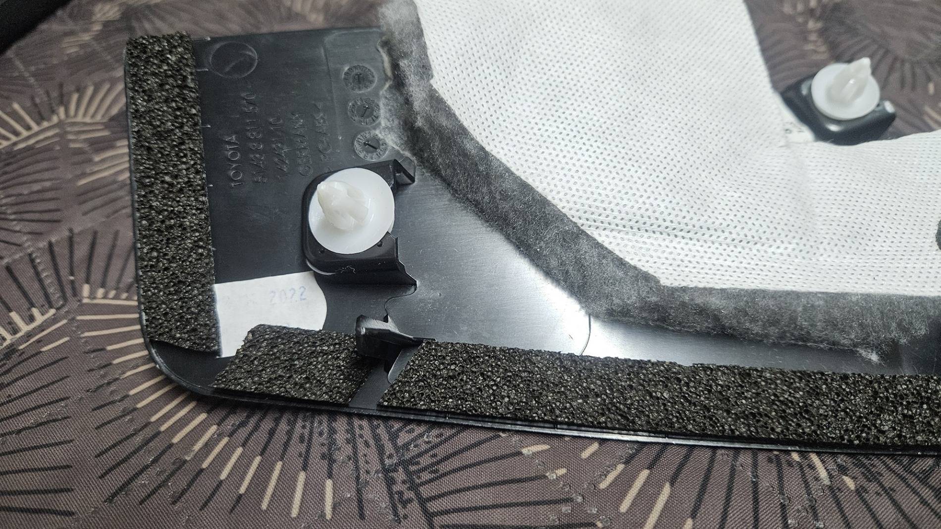

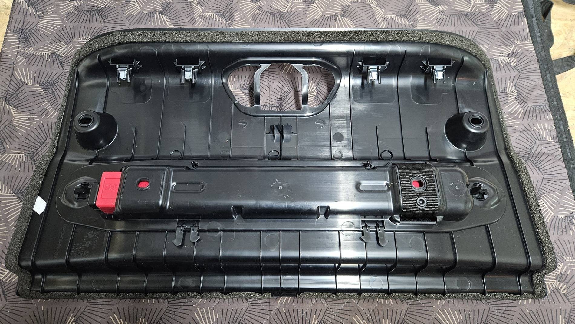

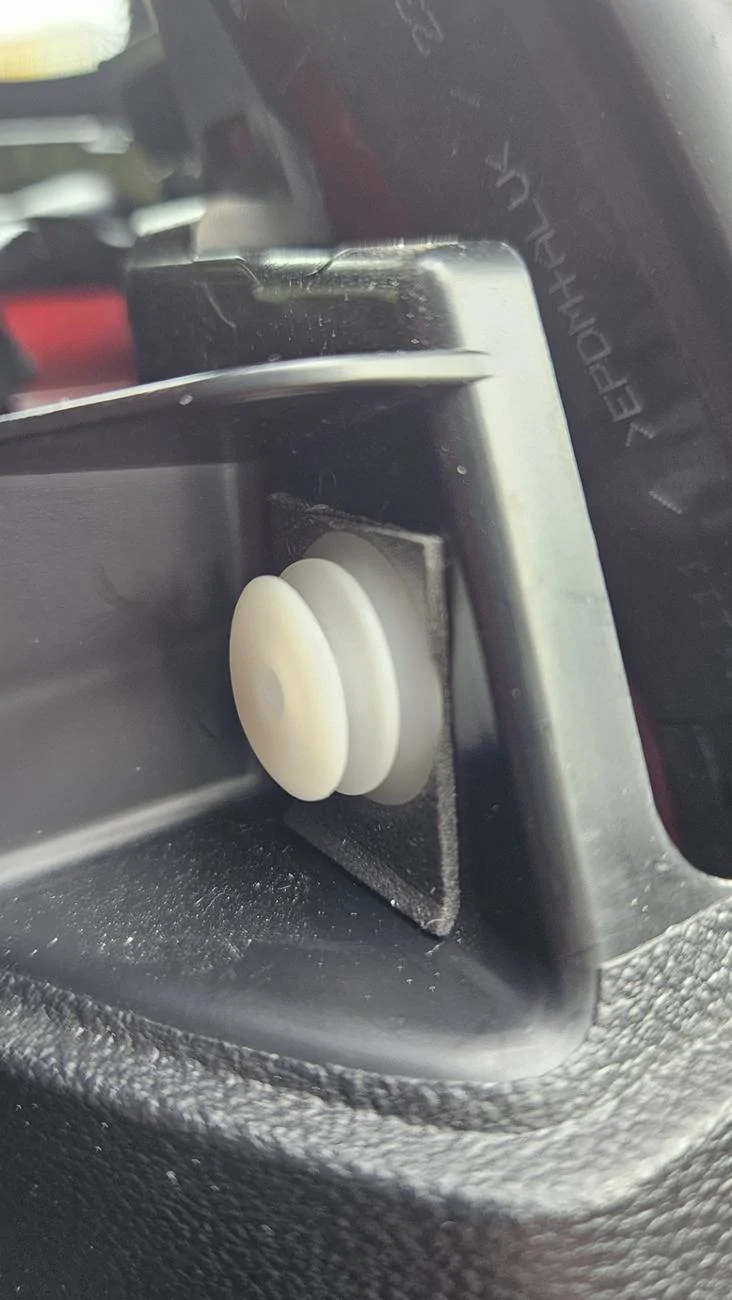

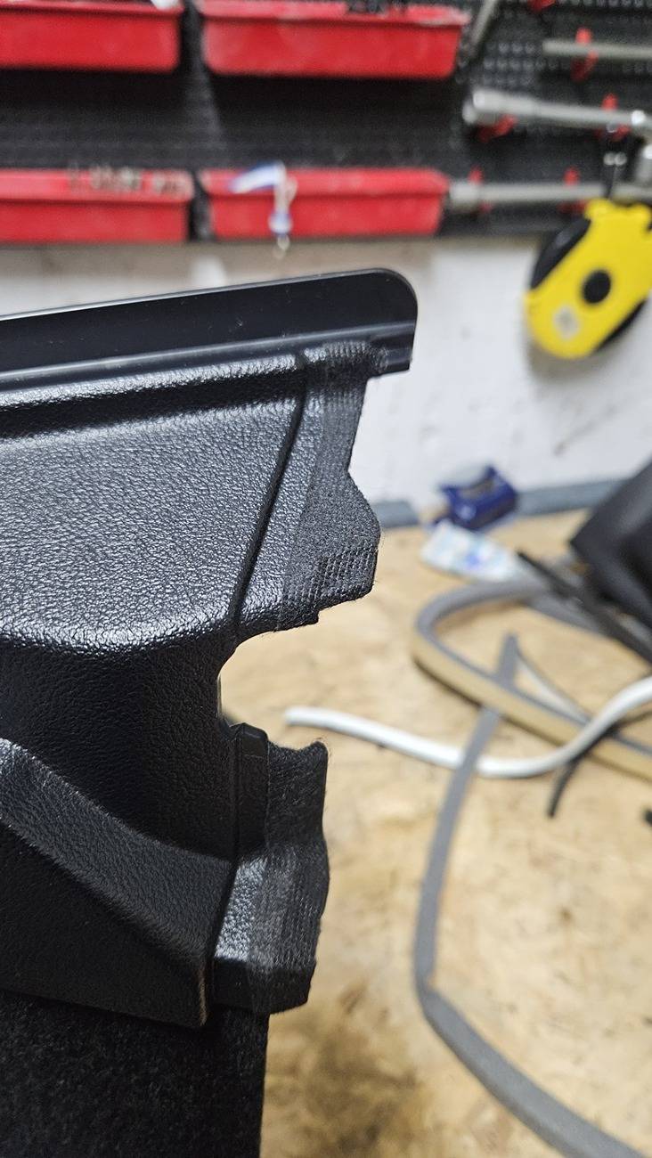

So I spent a few hours working on interior plastic trims on the side and back of the seats, which I think most of the creaking noise was coming from. Since I work in the automotive industry I used OEM automotive foams, low density (open cell) so it can adjust itself to the surface after assembly to "mute" all plastic trims and low density (closed cell) to apply in each hole where plastic clips are mounted. On contact surfaces between plastic & plastic I used self adhesive "fabric" tape or special very thin adhesive felt strips. Below a few pictures. If you purchase this materials on the market, you can do it below 20USD, it cost me only my labor ... which is free in this case ;) Subjectively 99% of the noise is gone, sometimes there's a single creak coming from this lifted trunk cover (aka package tray trim) from these metal clips where it's pressed into the side trunk trim. I also used self adhesive velcro pads on the polystyrene box for the wheel repair kit, since it was jumping on the potholes making a lot of noise on its own.
A few pictures in case someone wants to do the same job.
