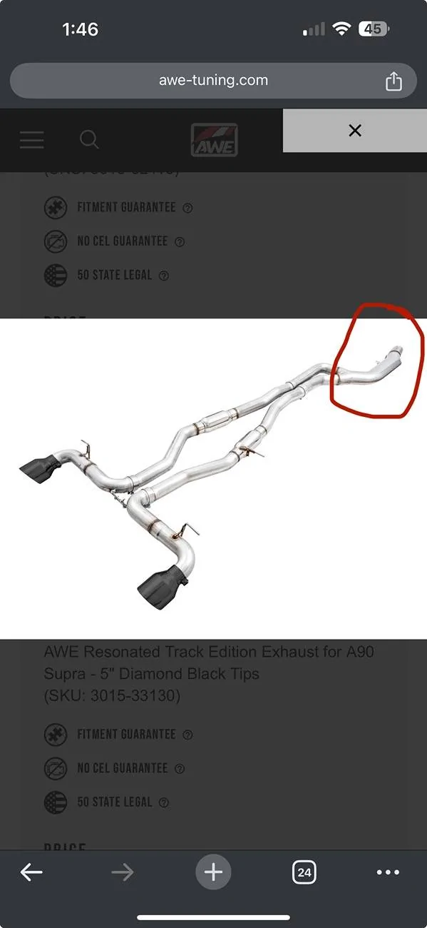

I've tried contacting AWE but having issues getting ahold of someone. Probably because of the holidays. But I am looking for just the mid pipe (image attached). The bracket for mine snapped and the exhaust is basically hanging. Worried it my damage the downpipe if it hasn't already. I went to an exhaust shop that tried to weld it back together but that eventually didn't hold up either. Anyone have any ideas? Thanks!
Any idea why it broke?? Rather than just get a new one and install, check the rest of the setup! Make sure it won't happen again + throw the OEM exhaust on for now.
I'm not sure tbh. Maybe the burbles causing too much vibration? That's what the exhaust shop said. But my car is not tuned and it's the stock burbles so idk.
And putting on the stock exhaust is going to be so much work in this cold ?. I have a couch I'm trying to get rid of taking up space in my garage or cars sitting outside.

Hey OP, if you haven't already, get in contact with our customer support team ASAP so they can jump in to assist. Keep in mind we are not in the office on holidays/weekends, but I am always a PM away if you need help getting in touch with us. Link to submit a support ticket directly.
For onlookers, it is always best to contact us as soon as you have an issue, rather than try to remedy yourslef as it can void your lifetime warranty.
If you are like @BMWAF and need to swap our your non-res mid pipes for resonated, technically we do not list individual parts for sale, but our sales team can make exceptions for current AWE owners to get you the right setup for your needs. You can get in contact with them here: https://awe-tuning.com/pages/contact-us
Their dimensions are off and it’s putting pressure on the bracket in a way that shears it off. It’s been happening to M340i owners as well, even after they send replacement midpipes.
Are you tracking much? AWE replace a bracket for me. Sara was kind enough and pointed me in the right direction, like you. As far as in the back, mine was cracking, so I had it welded. Holding up good now.
Yeah I make it to about 5 or 6 events a year. Maybe that wore it out.
