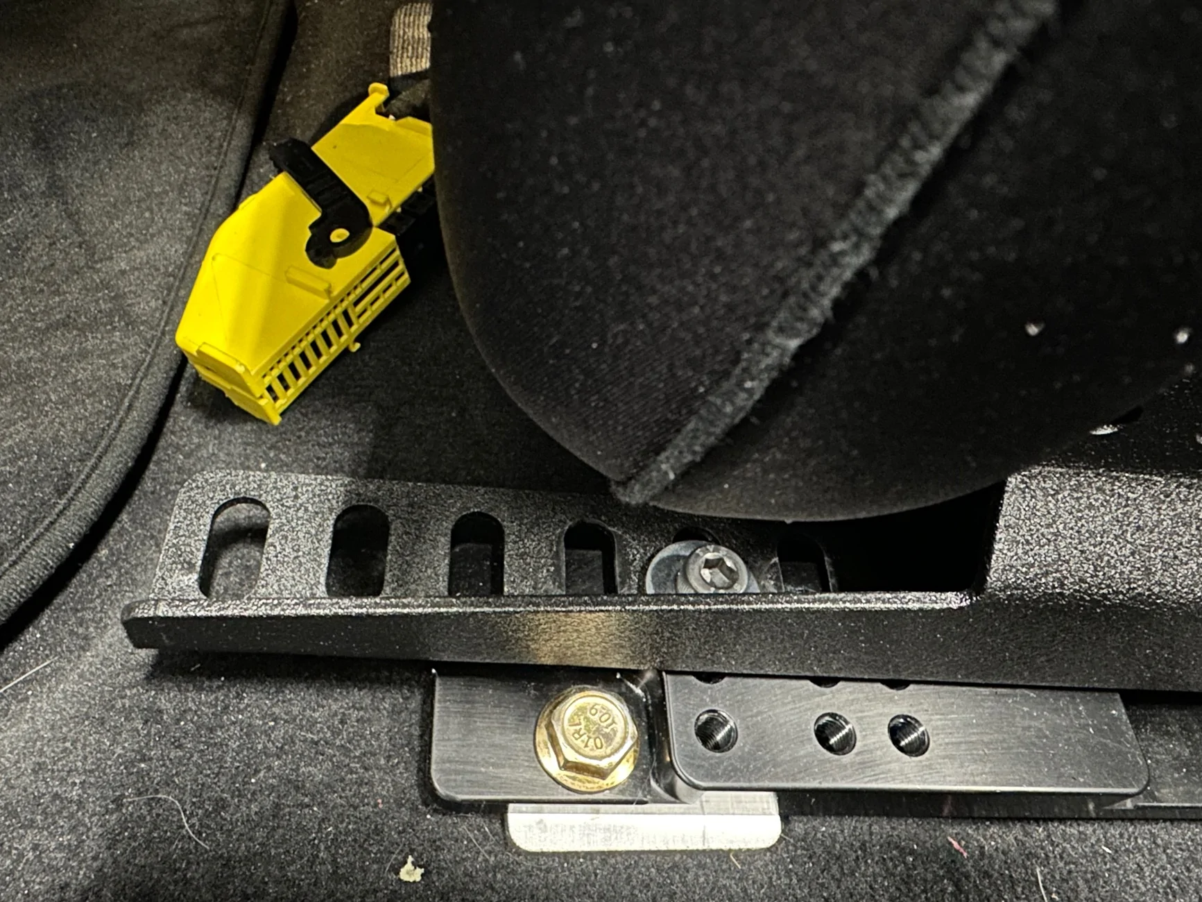

I had to bring my seat up too. You can use spacers, bottom mounts, etc. I used a combo of both.
When I saw the OP asking, I cringed on the solutions some might post. Yours made me happy. Usually I would post against modifying mounting for seats, but this appears to be a very solid option that doesn’t jeopardize safety at the same time. 👍

Thanks. I try not to F around with safety, because I def don't want to find out.

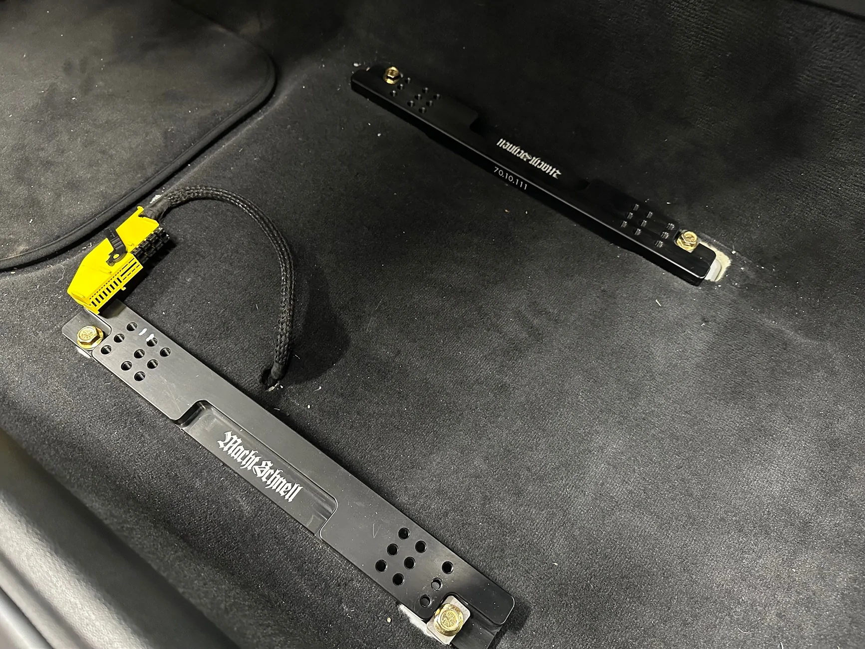

I got the tallest brackets I could find (side mount) and drilled an extra set of holes on one end. I'm 5'6".
**Edit: took me three sets of mounts to figure it out.
