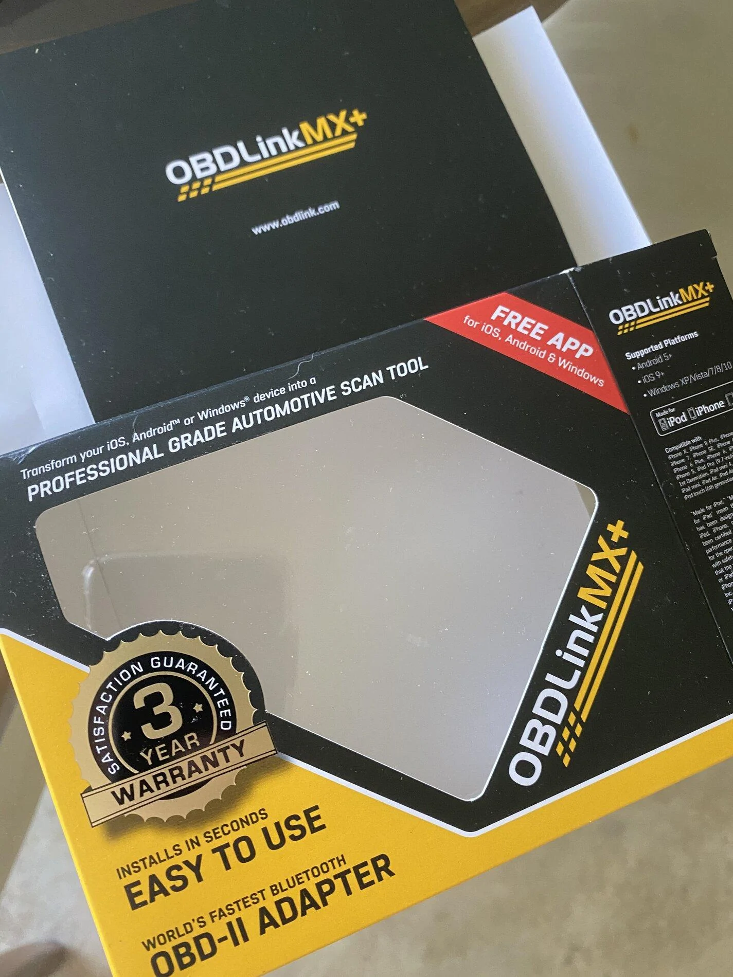

Buy a OBDLink Mx+ and save yourself the trip to a shop and reset the code yourself . It’s like 99$ on amazon and you definitely should have your own scanner for the future to save you time and troubles and money

No problem it’s fairly simple to use as well . Just make sure and hit the start button 3 times quickly without your foot on the brake to enter diagnostic mode . This will allow you to reset the code with the reader. If you just press it once like normal it will only be in accessory mode and won’t read correctly or be able to reset the code . Shoot me a dm when you get it if you need any help had member on here help me with the same thing . Was trying to reset in accessory mode and not diagnostic mode haha

Incase you’re wondering exactly what one this is the packaging
Thanks alot, i was looking into this product
