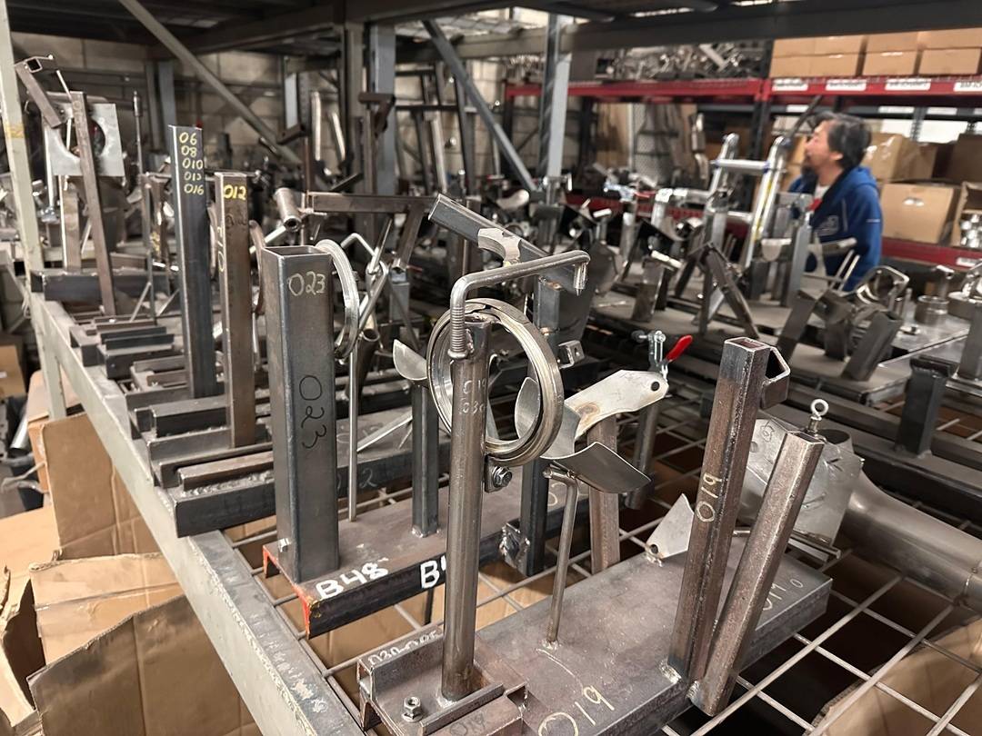

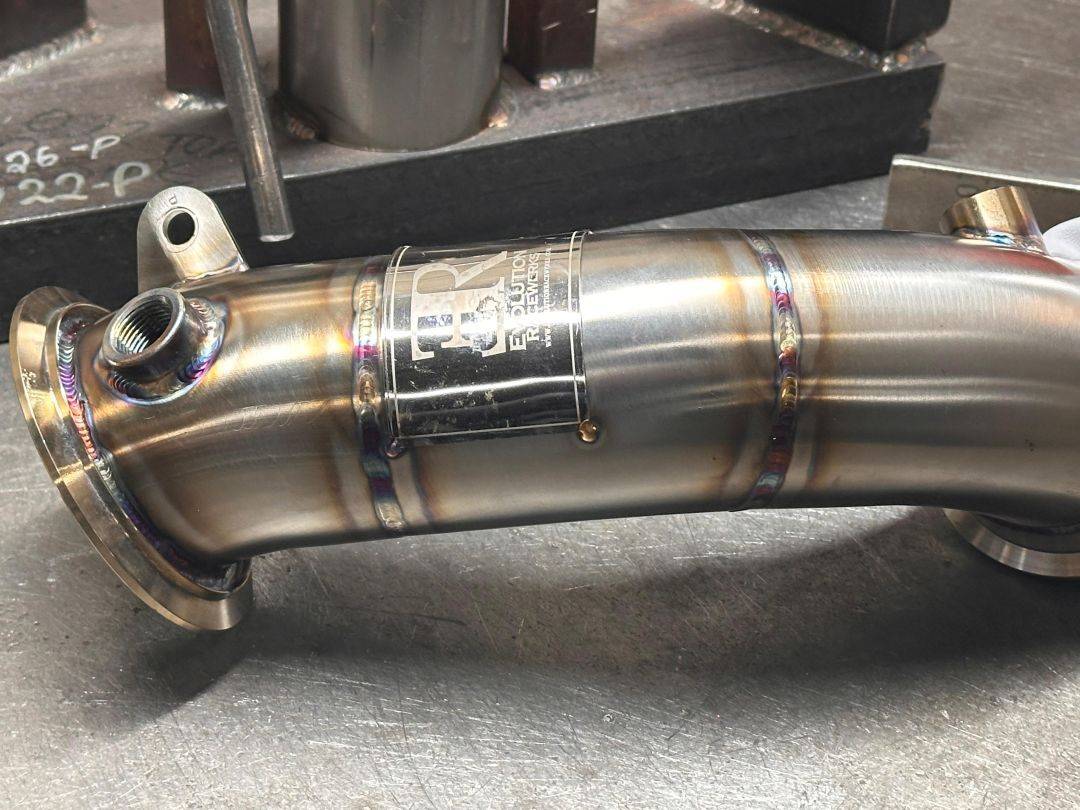

The first phase of production is designing the prototype. This is where the initial concept takes shape, focusing on engineering, fitment, and improvements.
1-Buy a new car to start the design process as quickly as possible.
2-Get it on the lift for a detailed inspection.
3-Analyze BMW’s original design
4-Identify possible improvements in airflow, performance, sound, and/or reliability within the possible clearance available.

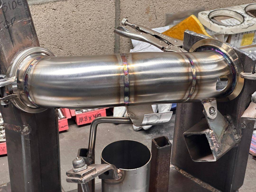

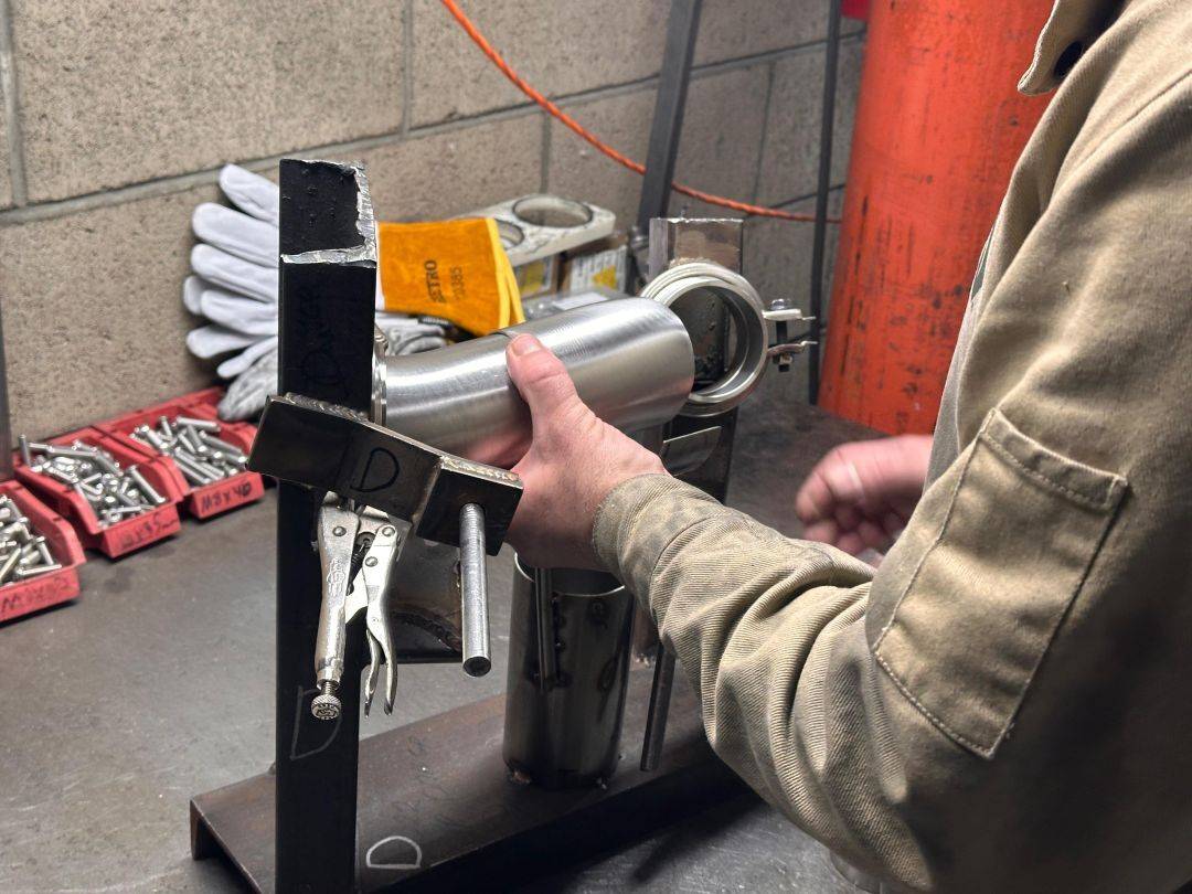

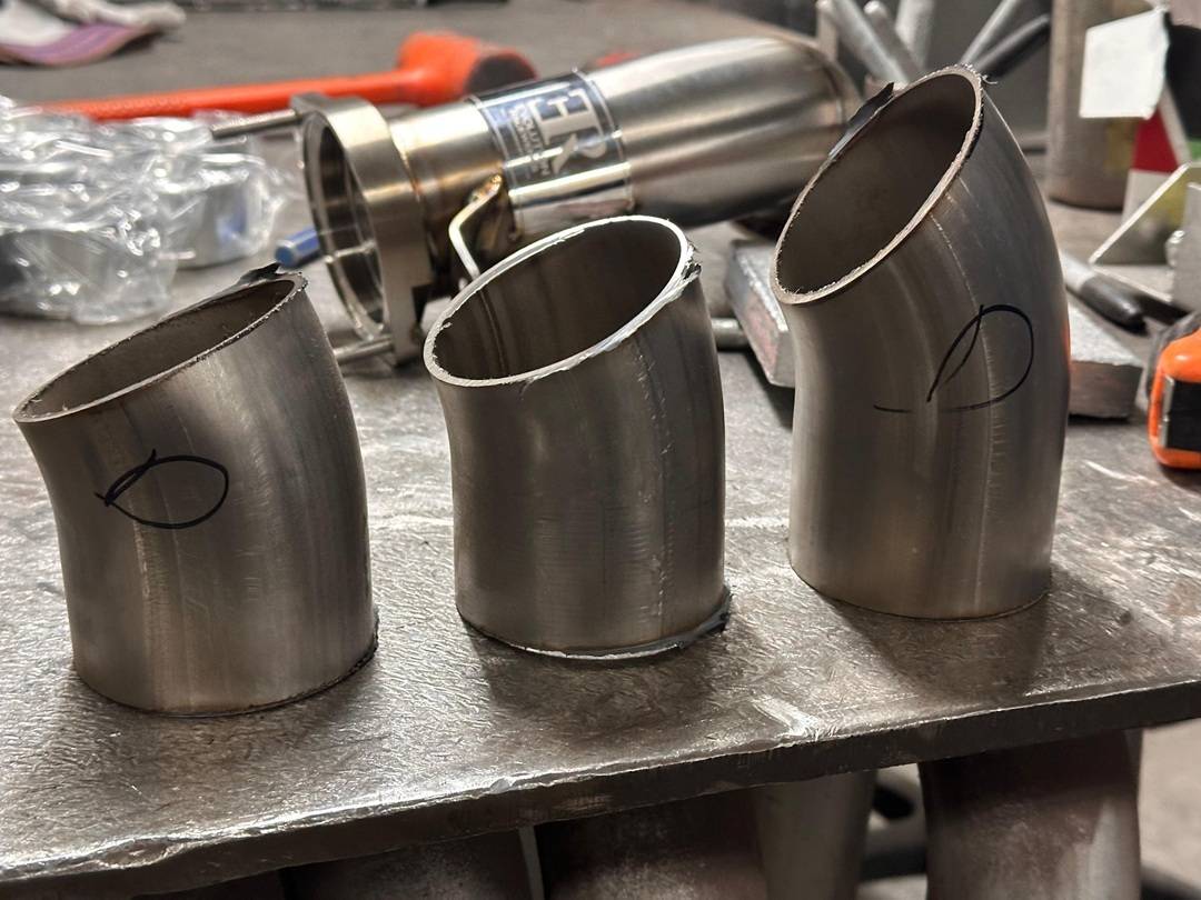

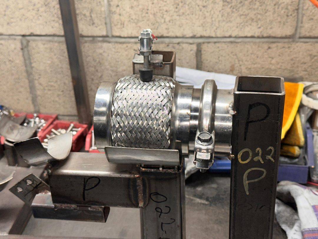

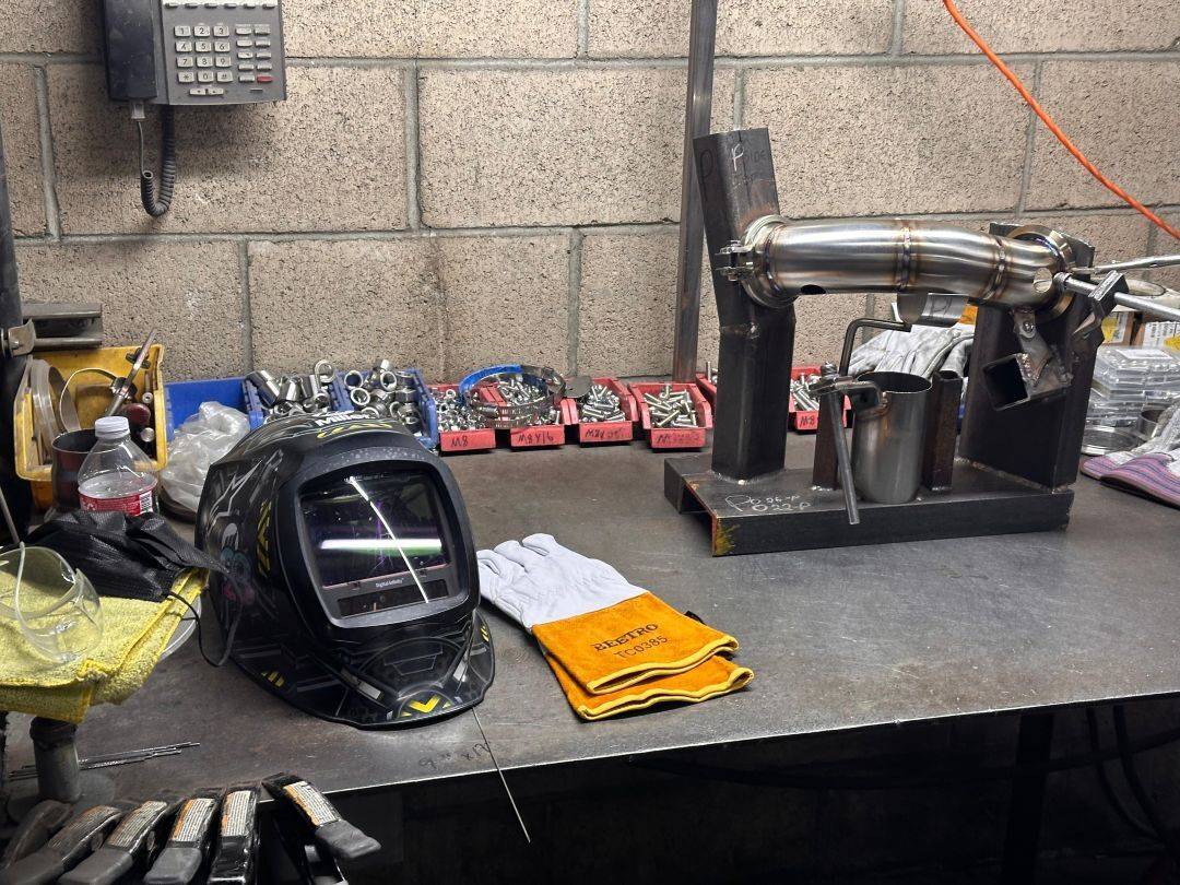

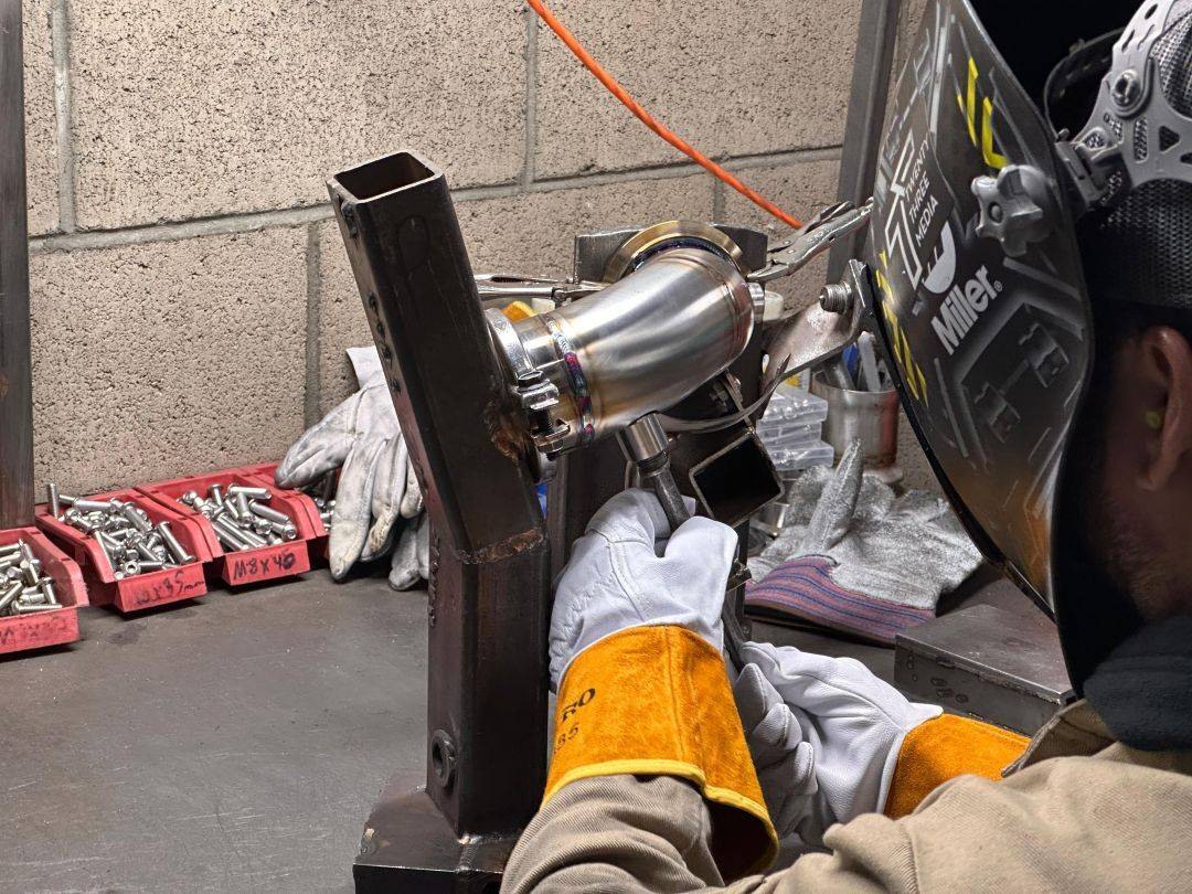

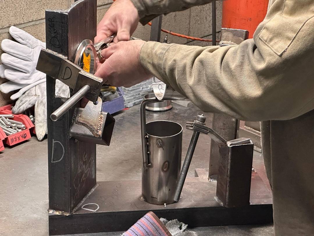

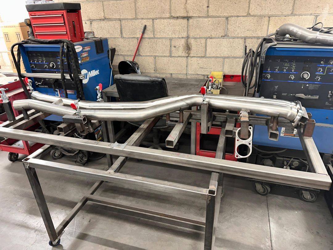

5-Use a jig to create multiple prototype designs
Phase 2: Building the Product / Prototype

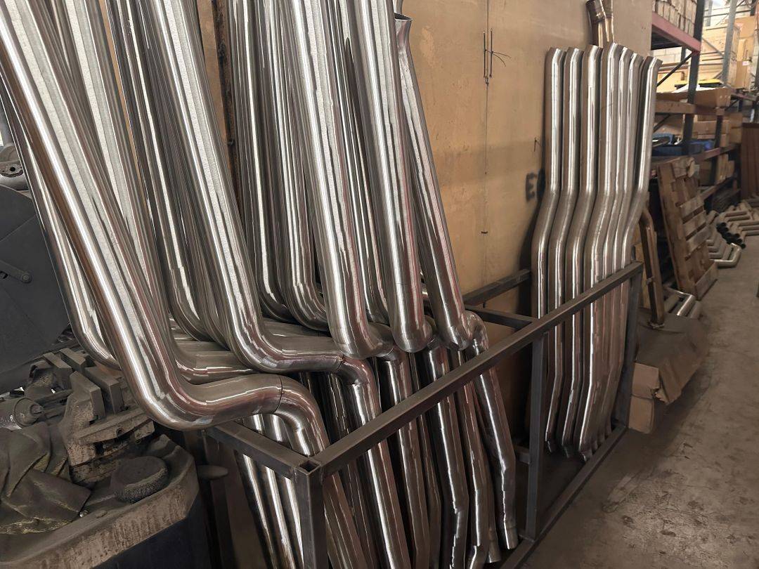

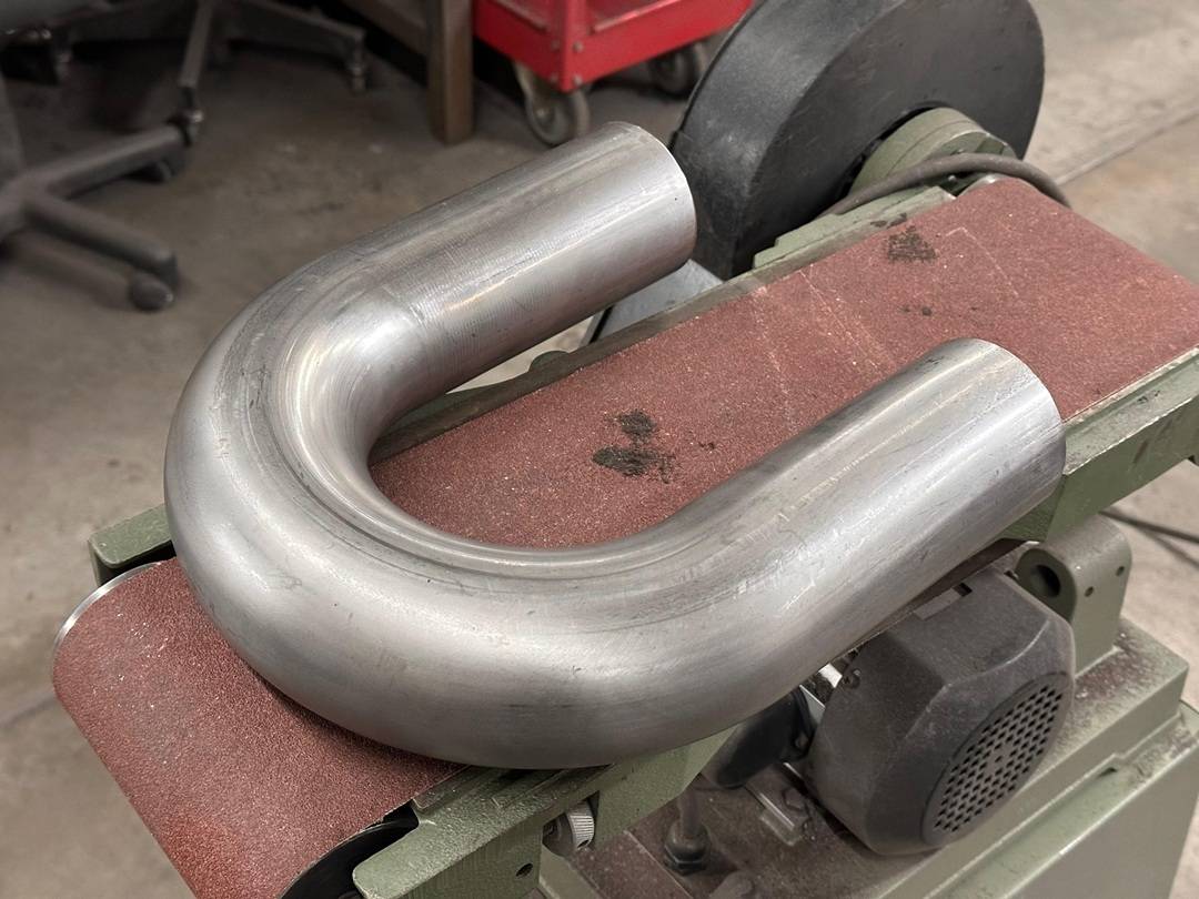

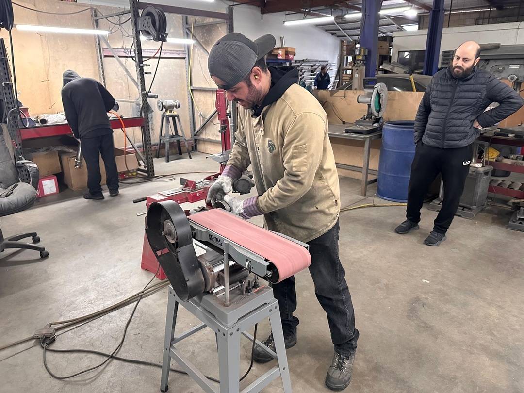

1-Start with raw material: large stainless steel pipes.

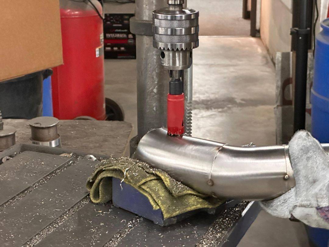

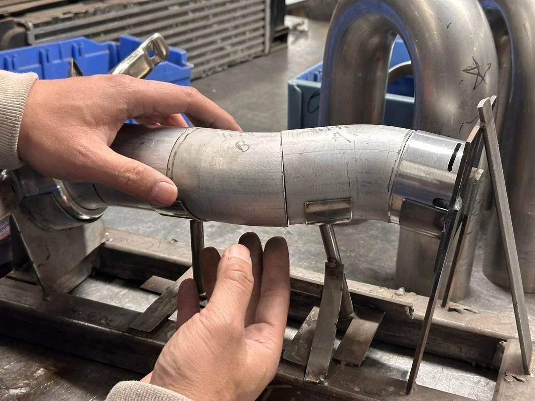

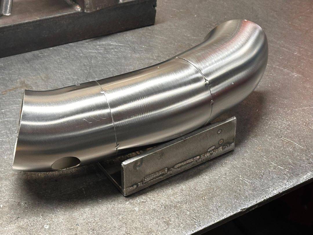

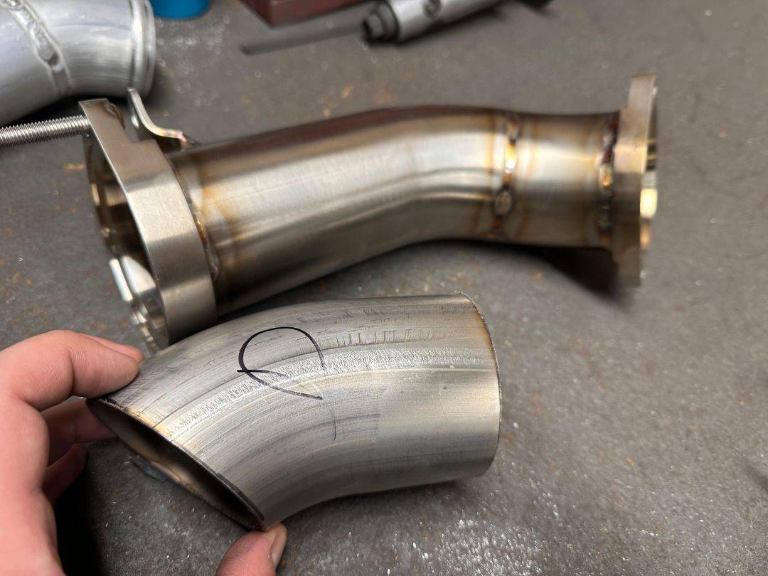

2-Cut them into smaller pieces based on the design.

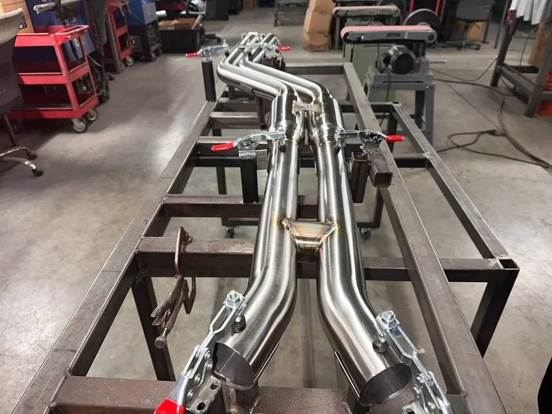

3-Check the fit on the jig to ensure accuracy.

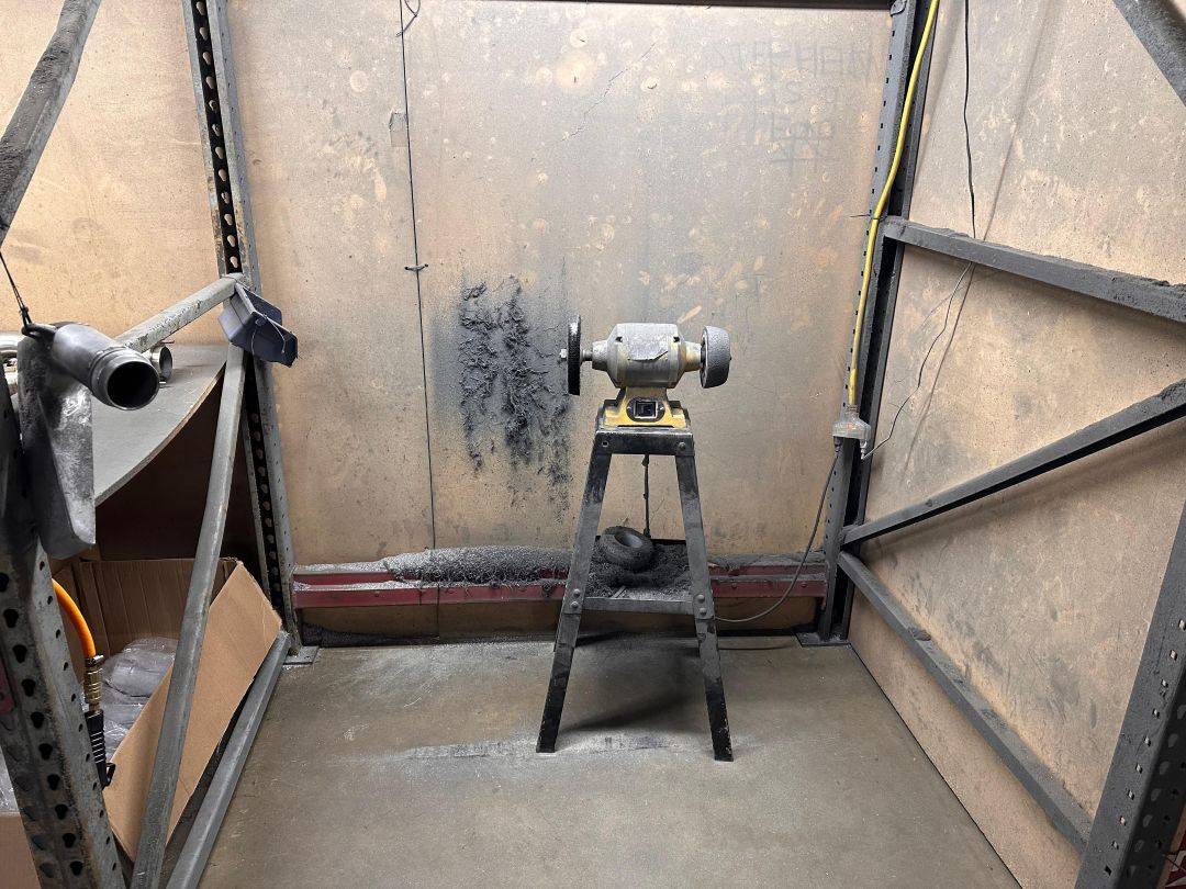

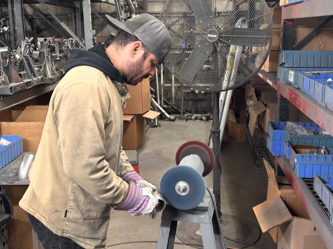

4-Apply brushing for a clean, brushed finish.

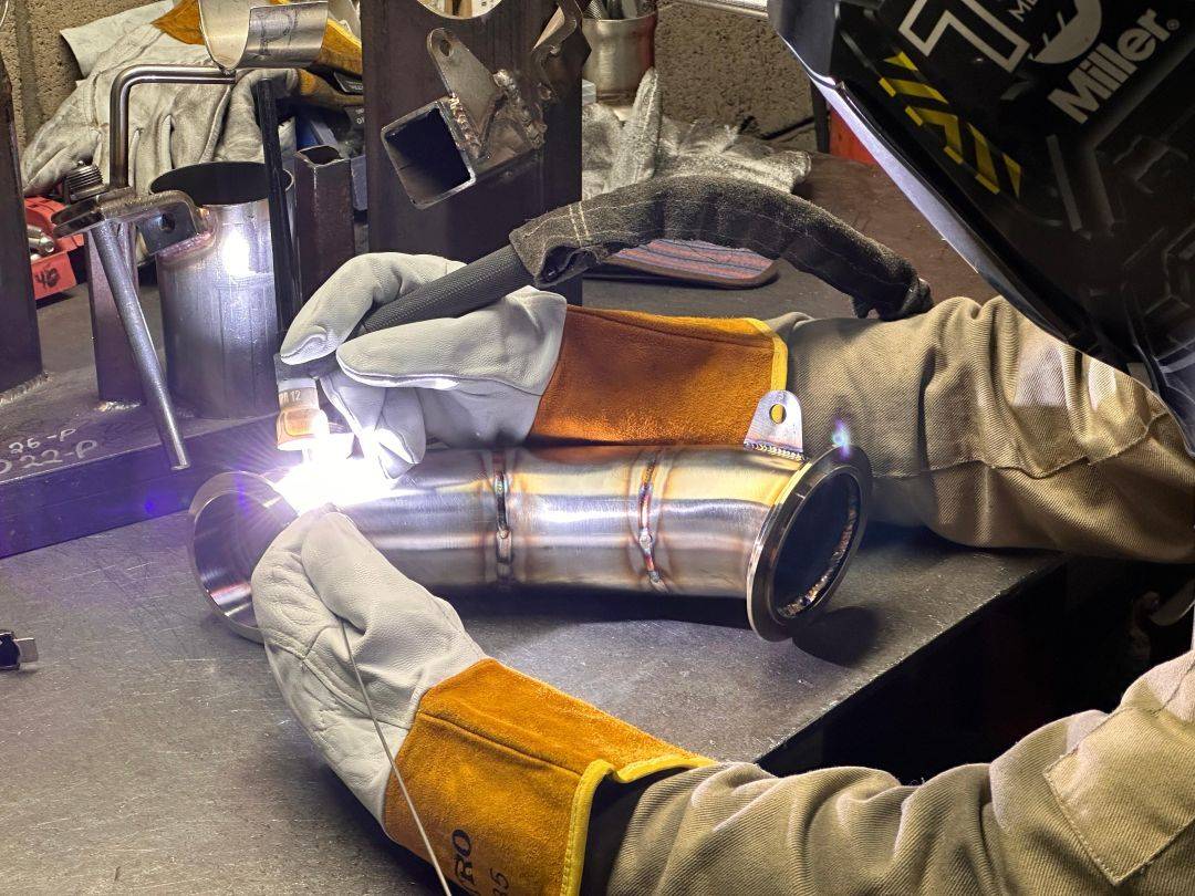

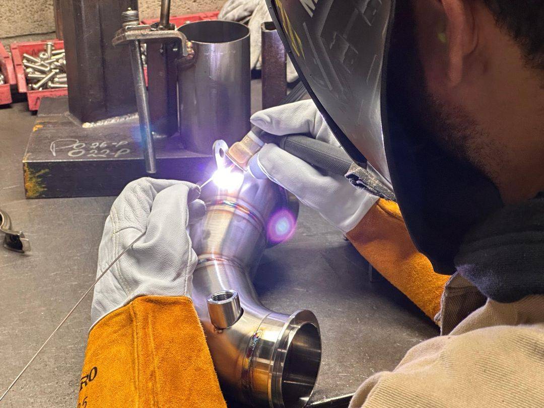

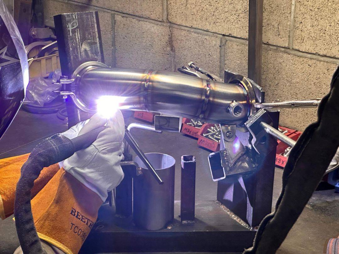

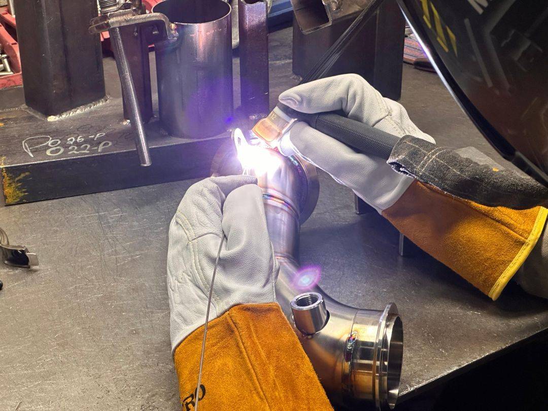

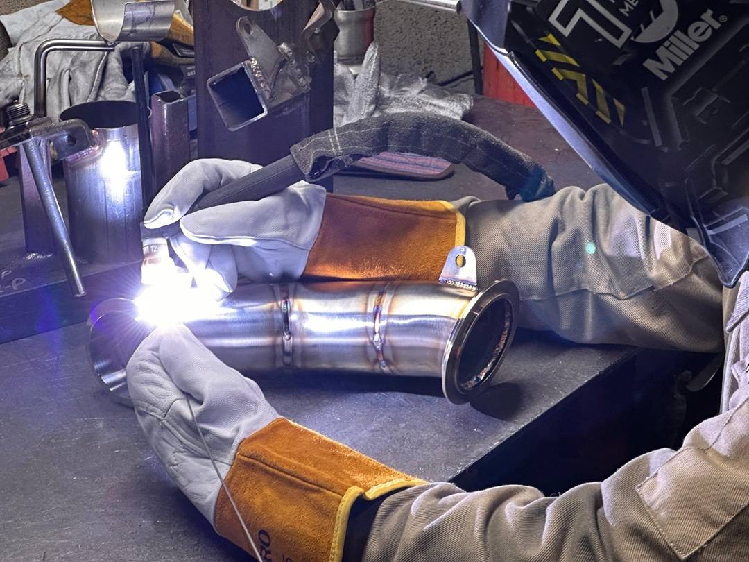

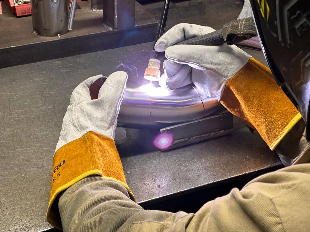

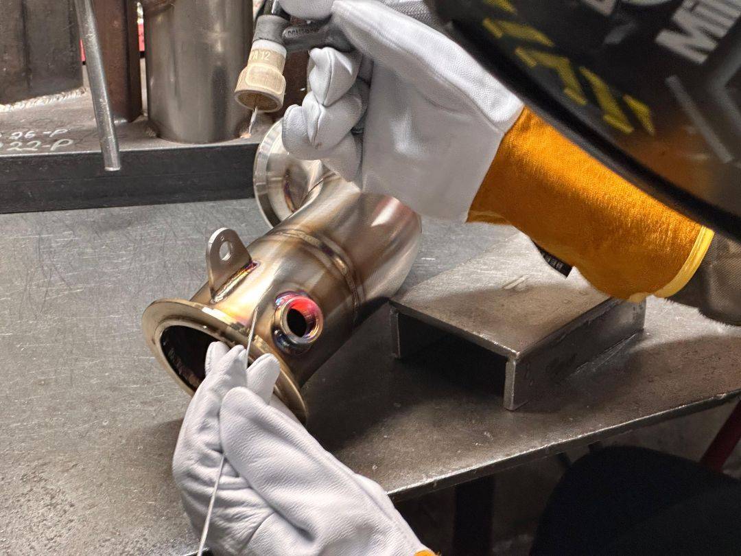

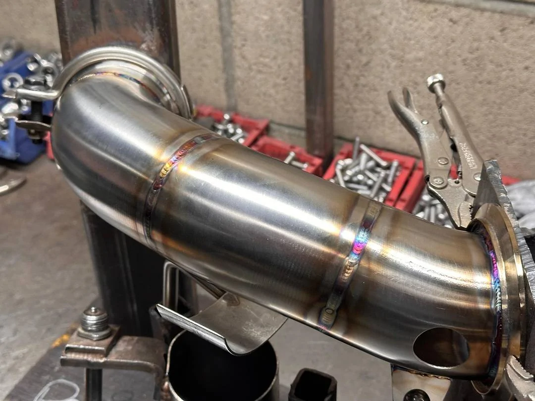

5-Weld the pieces together

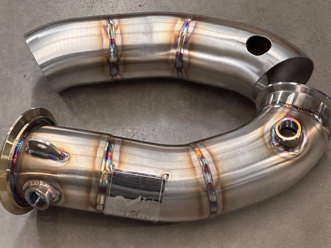

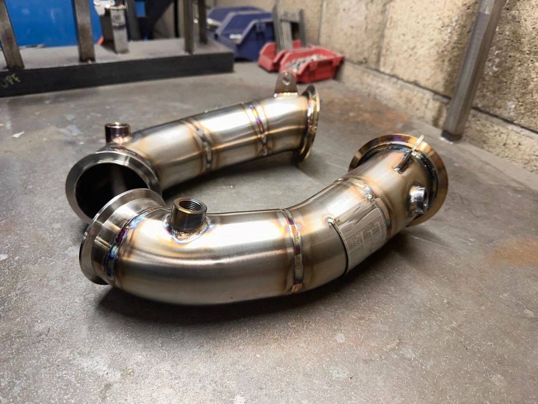

6-Test different prototypes to determine if more improvements are needed and which design offers the best fitment, reliability, and performance.

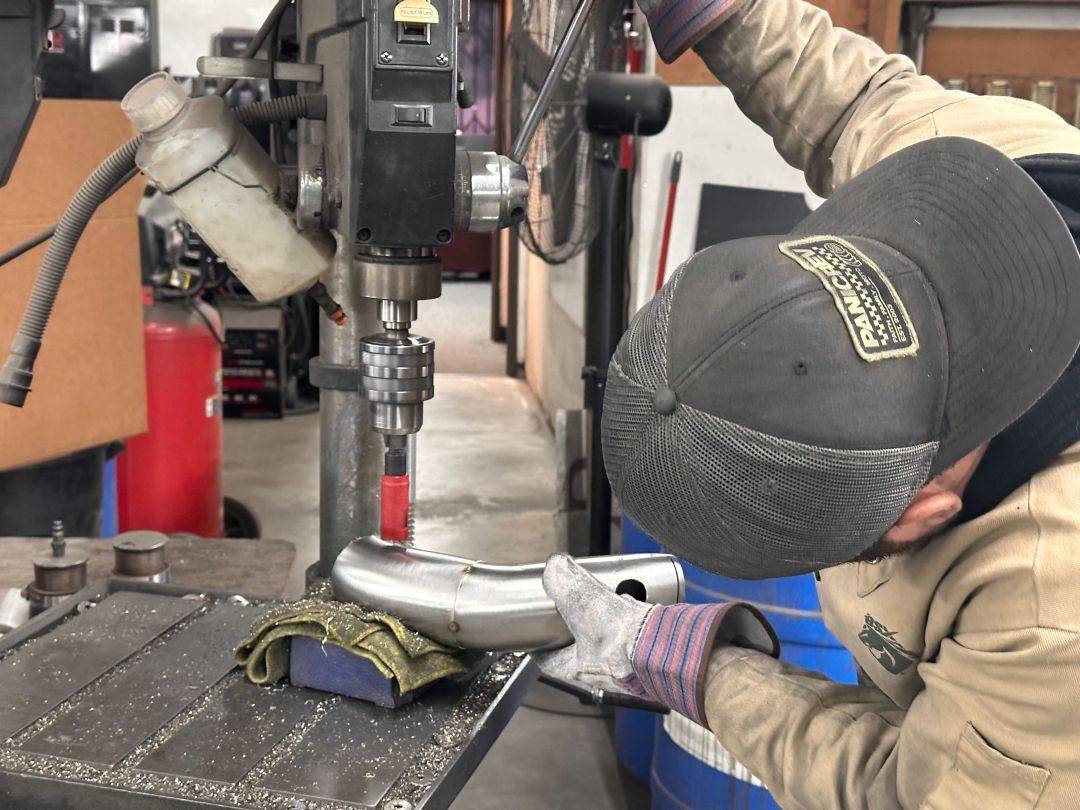

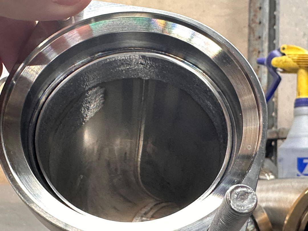

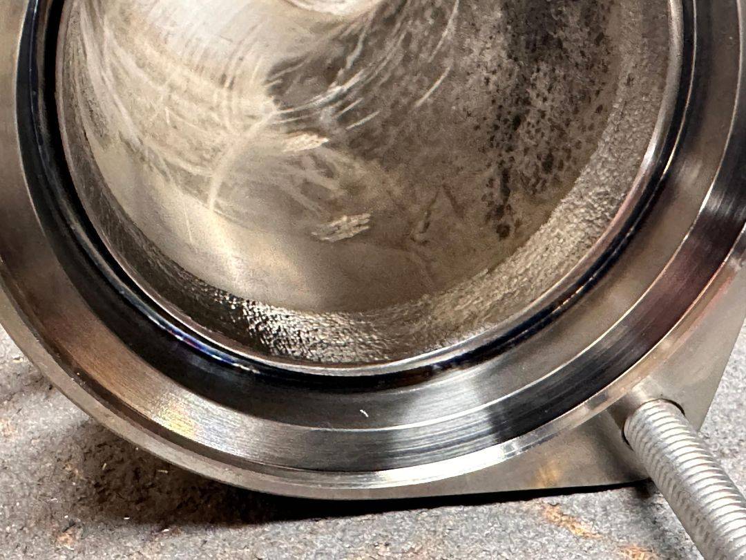

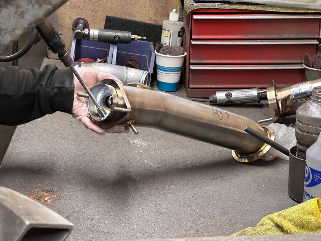

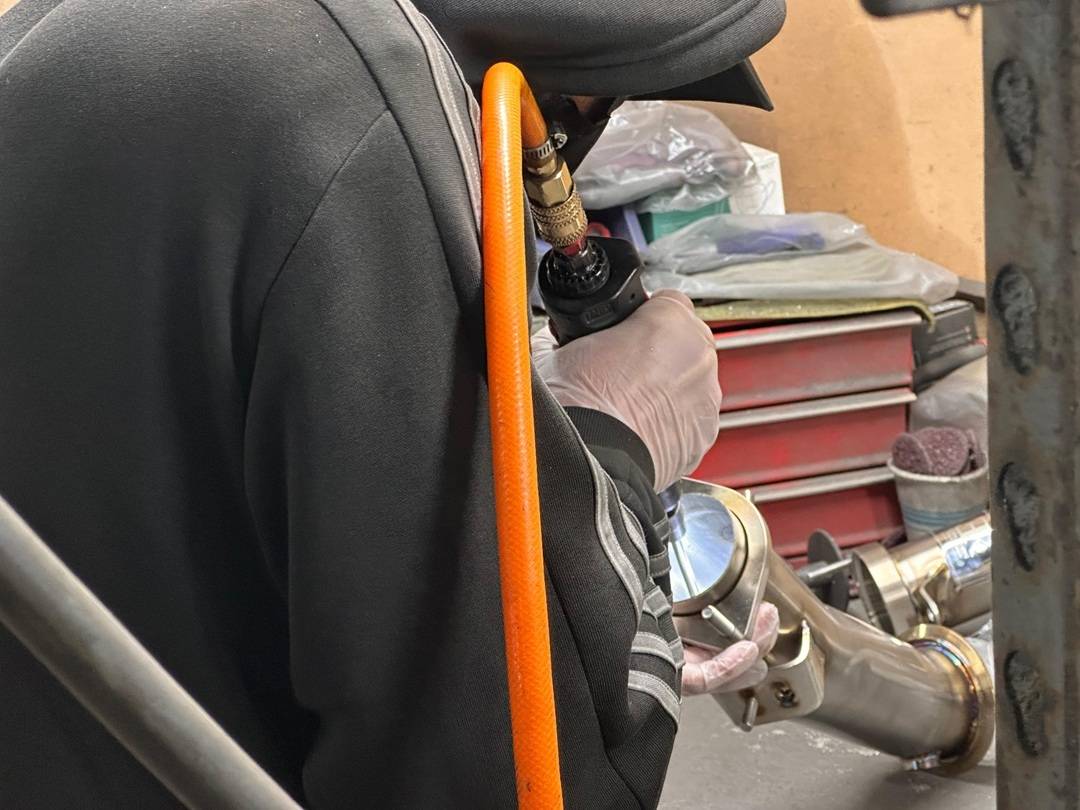

7-Deburr (clean up inside welds): This step is crucial to remove rough edges and excess material inside the pipes, ensuring smooth airflow and preventing turbulence that could impact performance.
8-If the customer requested a brushed finish, it’s done in-house. For a polished or thermal-coated finish, the product is sent to a local CA shop
Phase 3: Production
1-Build a small batch to begin initial production.
2-Beta testing: This is when vendors like us receive the product for real world testing, providing feedback and final thoughts.
3-Final approval: Once Fred is confident that he has built the best possible product, it launches on vendor websites and becomes available to everyone.

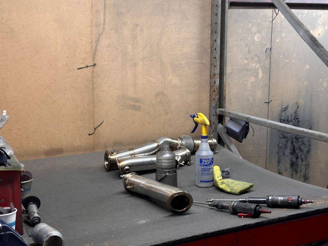

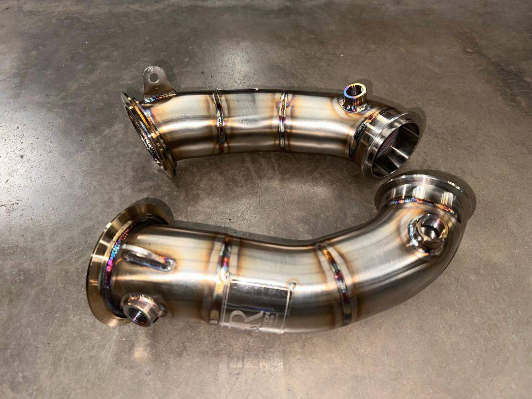

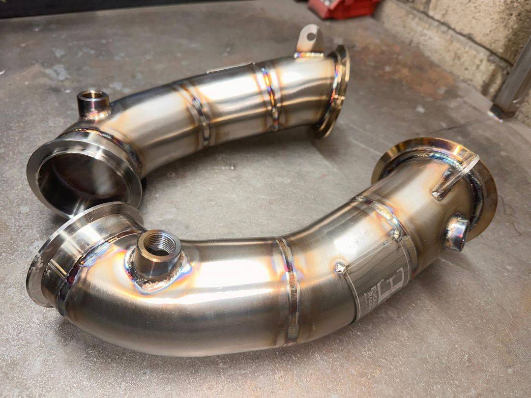

I had the pleasure of watching ER build an F90 downpipe from raw material to a finished product. Seeing the entire process firsthand was an incredible experience. Here is how it went:D

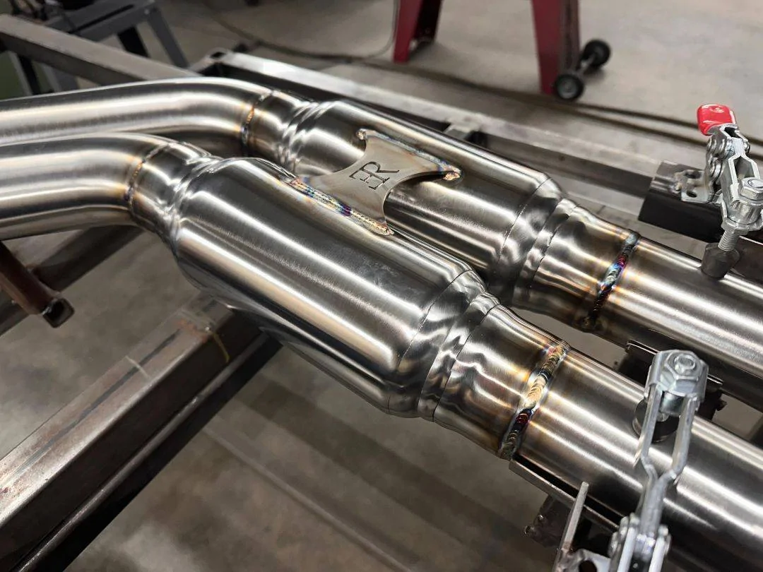

Got one of their catless race downpipes a couple of years ago, and it was excellent. There's plenty of cheap alibaba pipes to be had but the build quality and welding on the ER downpipe is top notch, definitely built to last. Plus supporting a US product and company is worth it IMO.

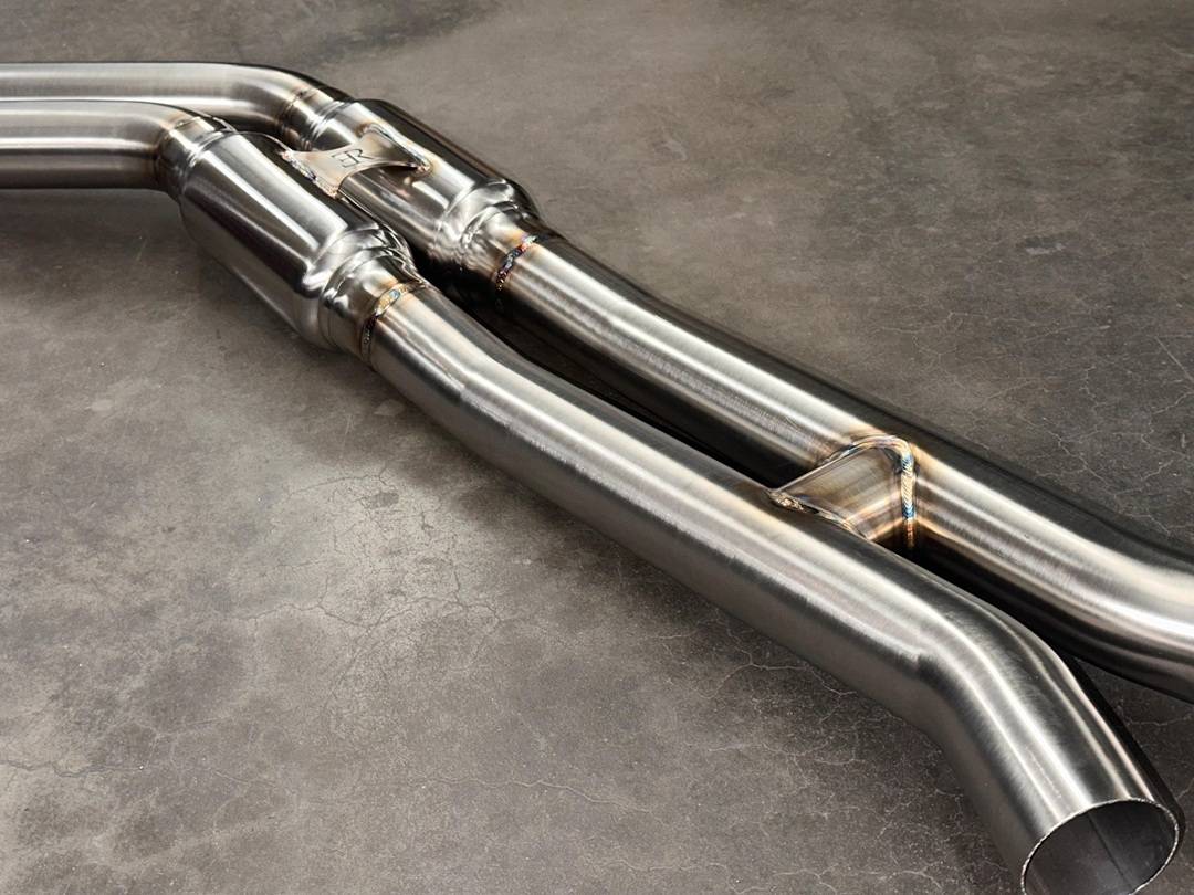

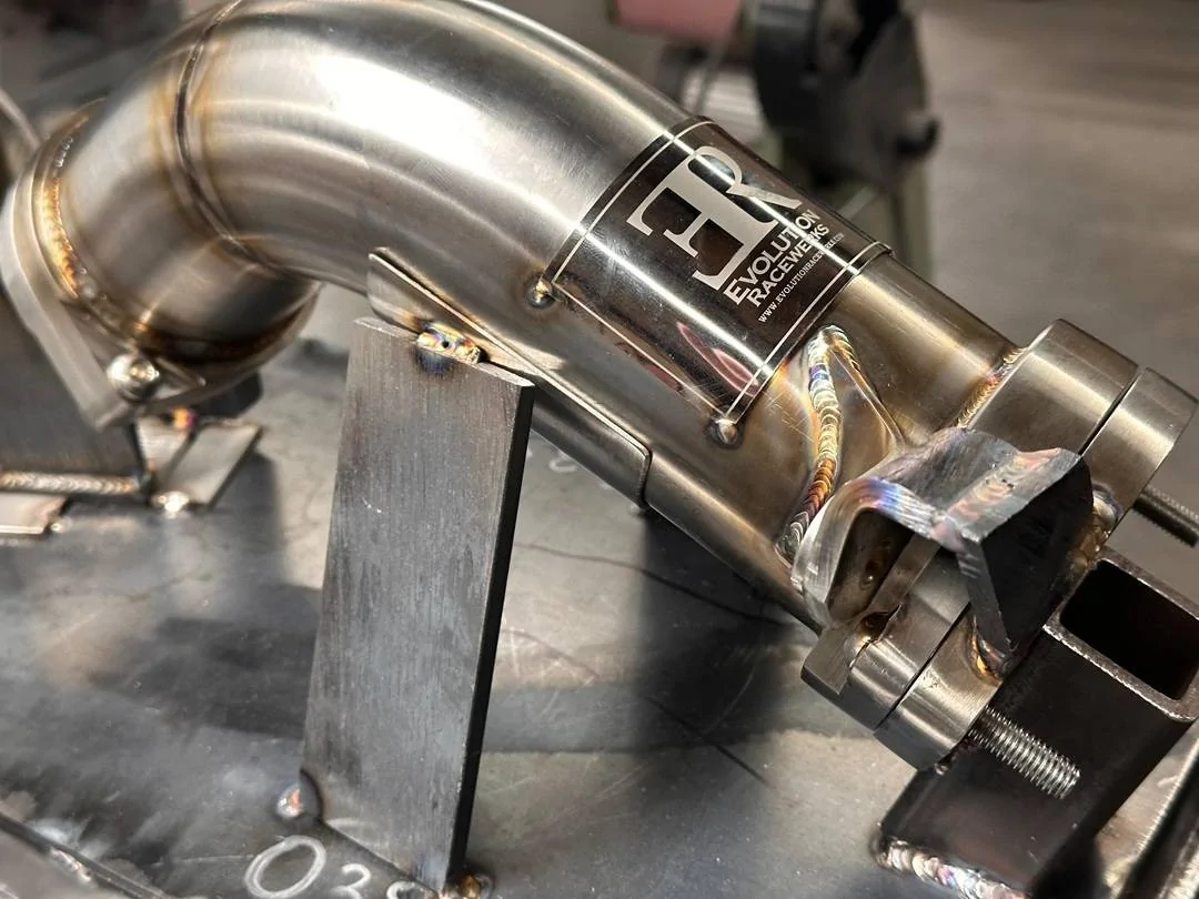

A good example of a well designed support bracket on the CAT pipe. The butt welded bracket on the Extreme Powerhouse short Catless pipe section never last in the long term.
