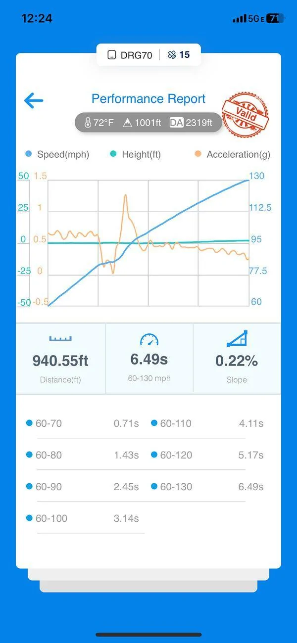

Is this spike in Dragy graph from trans slip?

I have not had RPMs go to the moon when I shift, but this spike pops up in the G force graph from time to time.
This spike happened when I shifted from 4th to 5th at ~6500rpm.
I’m assuming it’s either the trans slipping or I shifted too late and 5th HOOKED. - did not shift to 6th
anyone have experience with this subject?

Log RPM. If it spikes, either tire slip or trans slip.

Yes, actually. So this could be a break in the satellite signal?
not saying that the trans didnt slip, which can be told by looking at a log. but that spike in G's is likely from the underpass yes.
