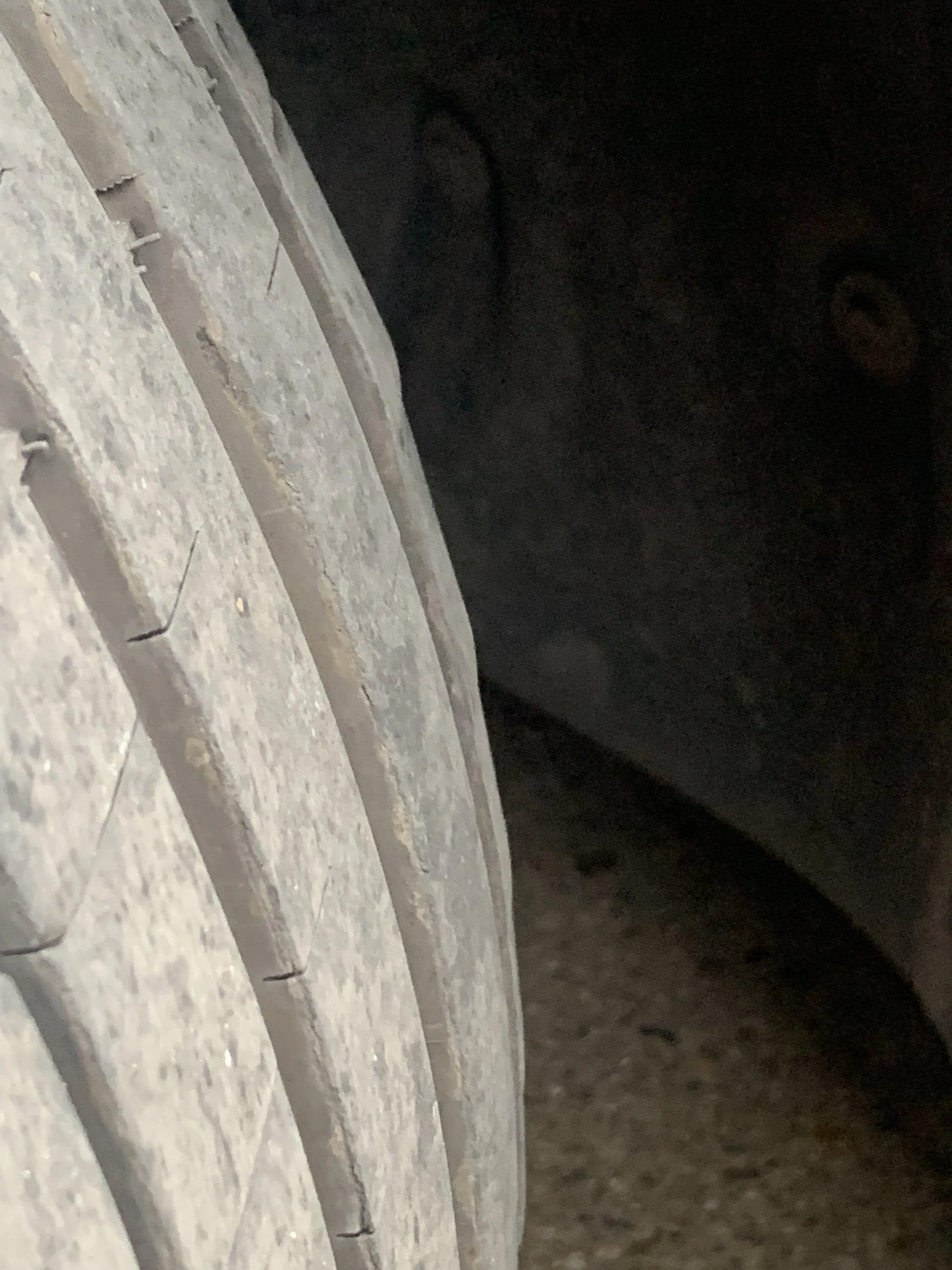

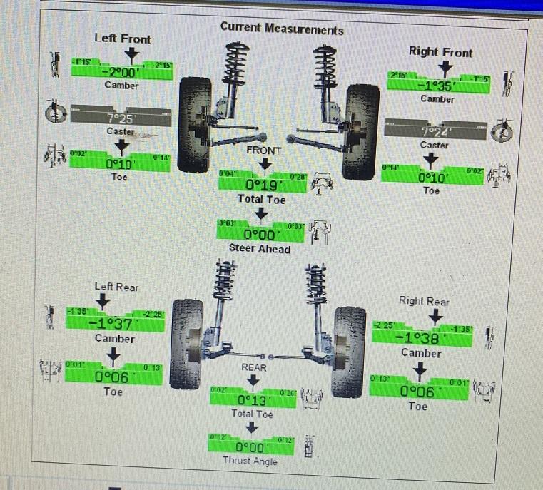

I had Michelin PS5 on all corners of my Toyota Supra Mk5 and noticed that at 20k miles awful noise from the wheels (like a wheel bearing issue )... when taking it to a garage they showed me that all four tyres had worn unevenly on the inside edges .. the tyres were essentially "no longer round" ... it was noticed that all four tyres has worn differently on the wear indicator areas ( 3 dot blocks) ... FYI .. alignment was spot on and car never driven hard or tracked. 20K is good for a set of tyres but with 5mm left it did mean that i still had to change them prematurely.

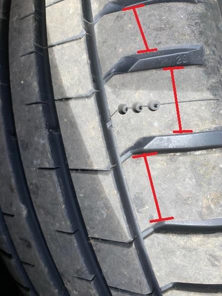

I suspect its due to the uneven block lengths of the indicators.
I include pictures and alignment ... also note the Michelin Pilots Super Sport i had on previously were fine.
Thoughts ?
as you can see on the picture below the jagged inside edge .. this was on ALL FOUR tyres.
Below is a picture of my NEW tyres ... just to show that the blocks are different lengths
My Alignment was fine ( as was my balancing )

Rears were date stamped 1122 and fronts 2522
it is strange ... its not feathering or cupping/scalloping
The noise started a couple of months ago and sounded like road noise that over several weeks got worse to the point i was convinced it was Wheel Bearing noise ... but there was no play in the wheels and i have a Mechanics Stethoscope and there was ZERO noise from any of the wheels.
New tyres cured the noise. I still went with PS5 as 20k+ is still pretty good wear and they are a better value tyre than PS4S if you dont track/fast road the car IMHO.
