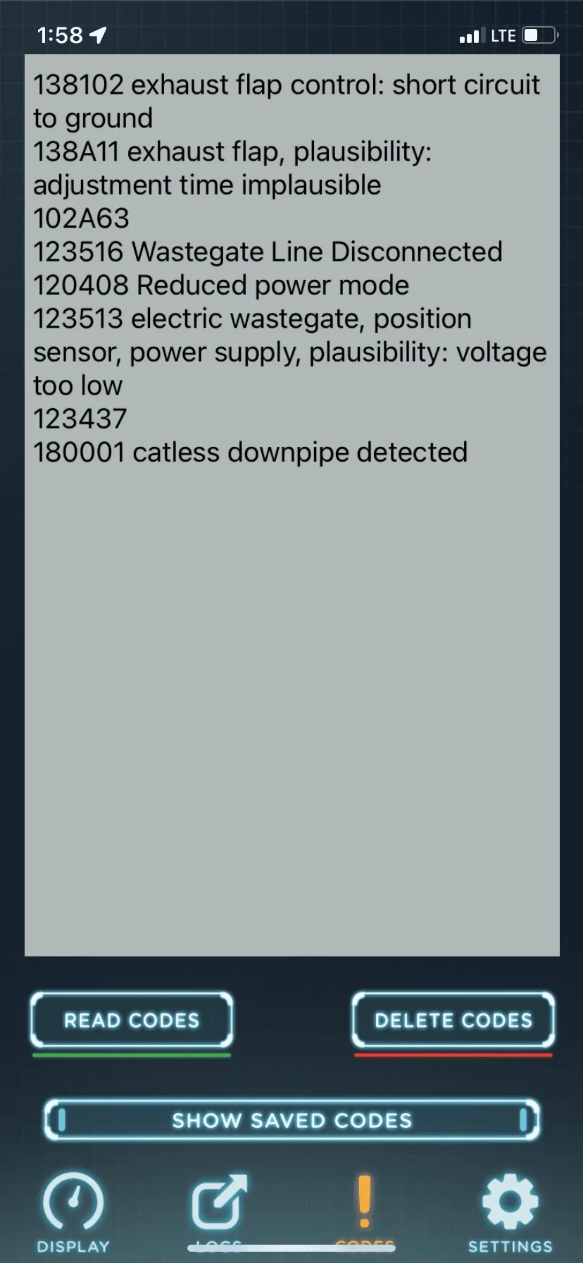

Supra threw a CEL randomly while i was cruising. I have a ARMASPEED intake and a AA DP & Exhaust with JB4 for tunning and i run map 2 only. The car isnt showing reduced power atm. I want to reset the codes and see if they’ll come up again. Im just not sure how i could. Unless its as simple as deleting the codes. Any suggestions?

You can delete the codes and see what comes back.
exhaust flap is probably because someone has removed the fuse in the trunk to keep it open.
Wastegate makes me worried your jb4 wastegate wires may be loose/disconnected. Hopefully not toasted lol.
catless DP - if yours is catless then… ok. If not then I guess you’re yet another person with an AA Catted DP and CEL lol

Deleted and went on a drive nothing so far and yea i have a AA catted downpipe so ig im on of those..
