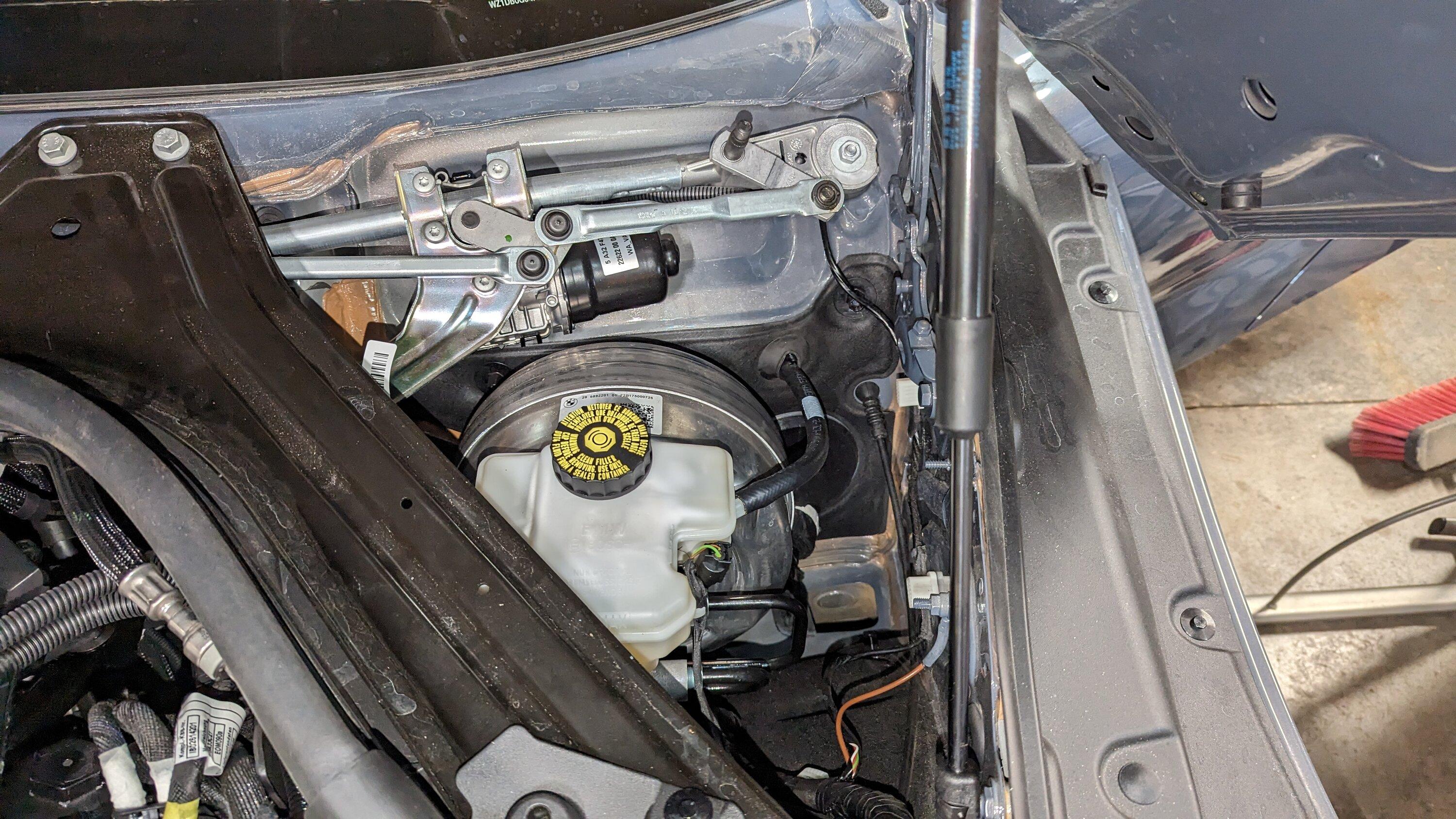

So, since nobody else cares to illustrate or elaborate in the name of the greater good, I'll do it.

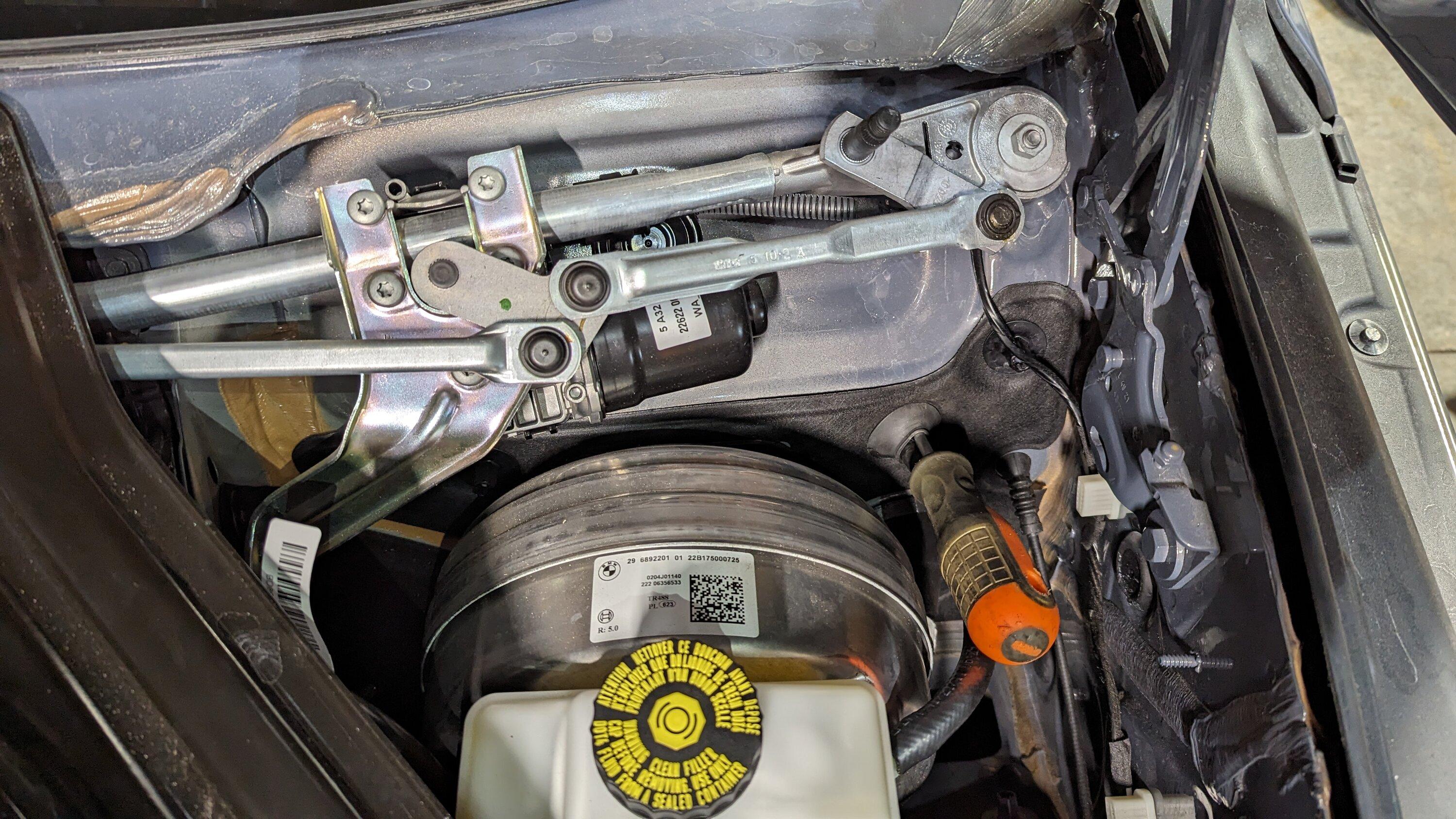

After removing the cowl trim and left side drainage tube, the clutch master cylinder hydraulic feed line is staring you in the face. This is the same spot we all utilized in the AT version to puncture the liner with a screwdriver and run whatever wires, hoses, or urinary catheters we want into the engine bay.

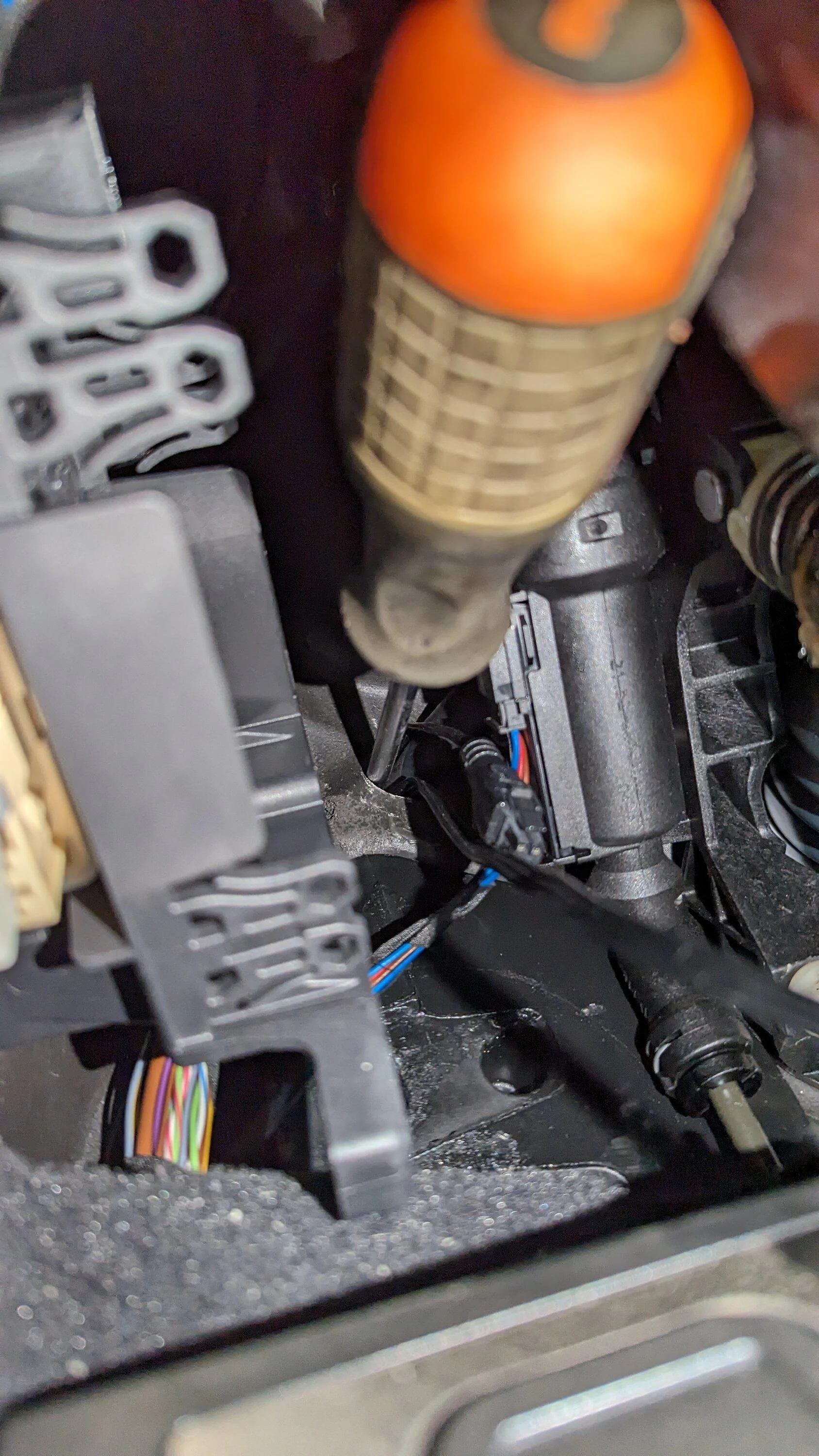

I weaseled the screwdriver in from the outside just as a "feeler" for how much room I have, or more accurately, DON'T HAVE, as we're going to cram the wire through along the hose.

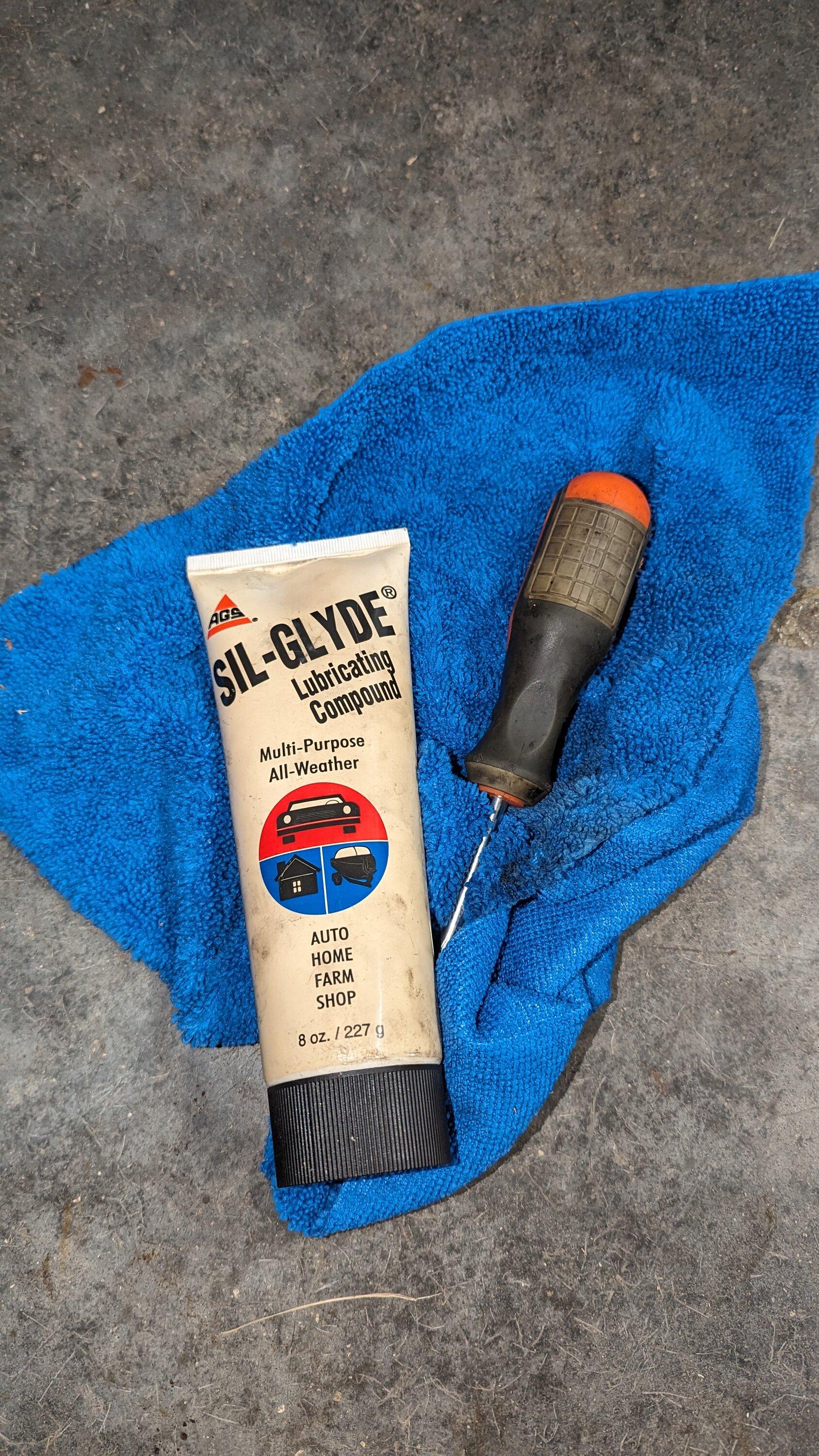

So, as the other guy suggested, the best way is to take and fold the wire over the end of a flatblade screwdriver, and firmly push it through from the underside of the dash. Here's a pro tip: Using some kind of lubricant will make it ten times easier, and lower the risk of damaging the wire or connector. I used this stuff, which has a name that sounds like a sex jelly.
..and here's the deed in action...

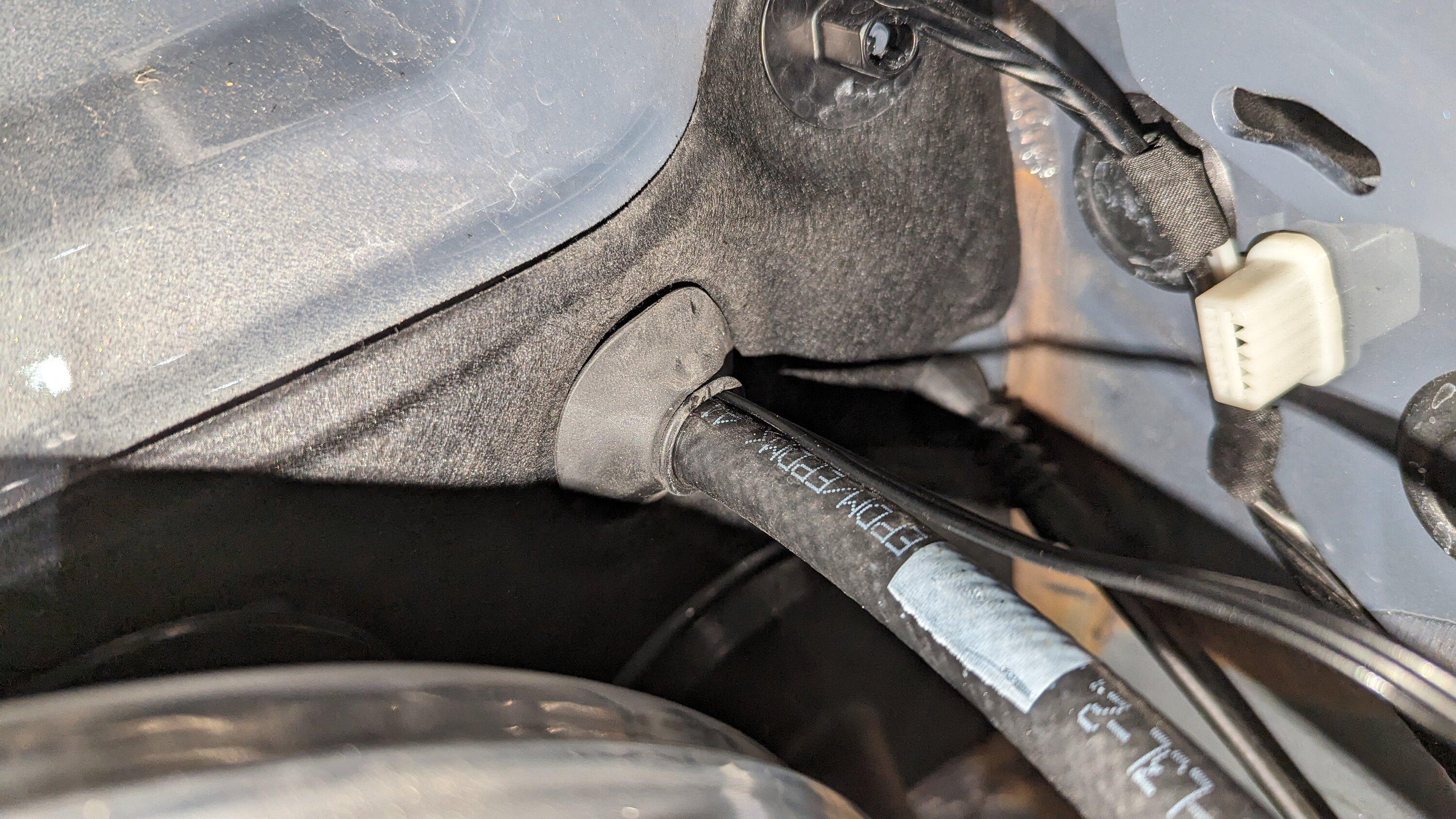

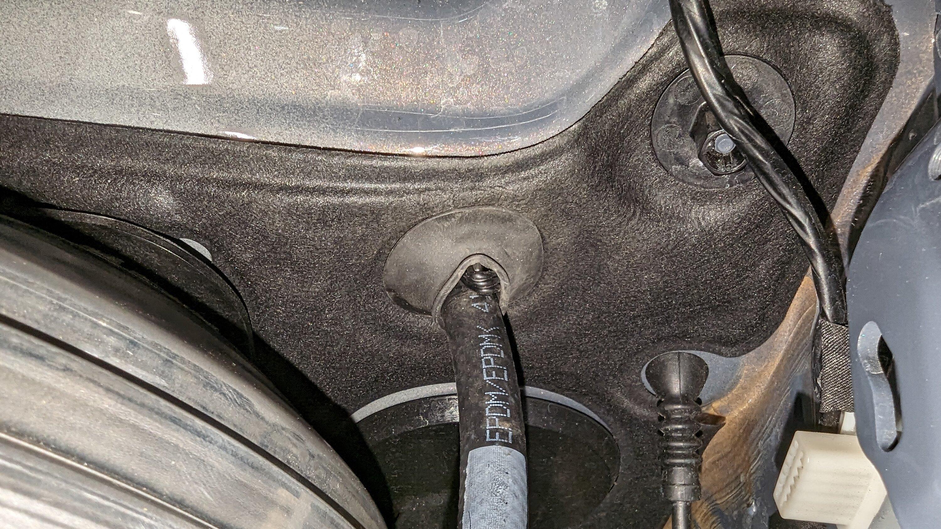

..and now we're prairie-dogging through the bunghole..
After giving it a further shove, enough came through in order for you to grab it with a small pliers and firmly pull the connector through. Pull in the slack, and viola! We can actually sleep at night knowing that we didn't run the wire externally past the door.
