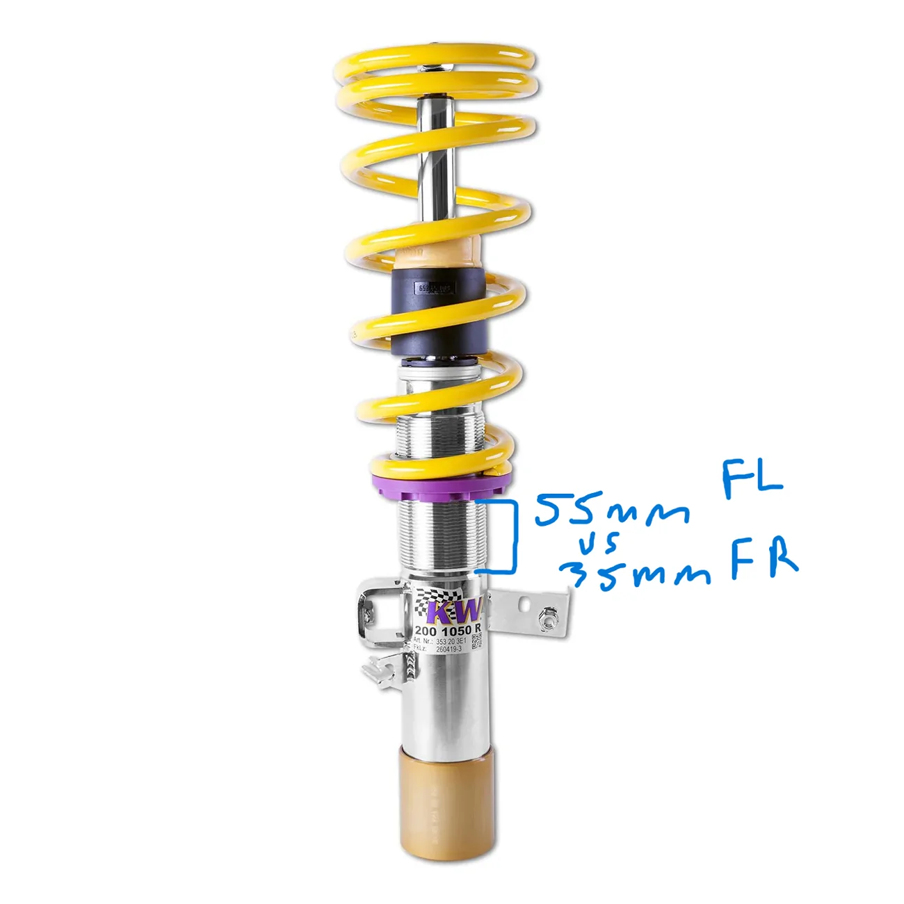

Hi guys today I was adjusting the front ride height and noticed that I had to raise the driver's side significantly more than the passenger side to achieve the same ride height after the suspension had settled. I was just wondering if this is normal.
Here are my measurements:

I've done my share of coilovers and seen different heights including 20mm. If you're confident you installed them correctly, I wouldn't worry about it.
The beauty of corner balancing.
