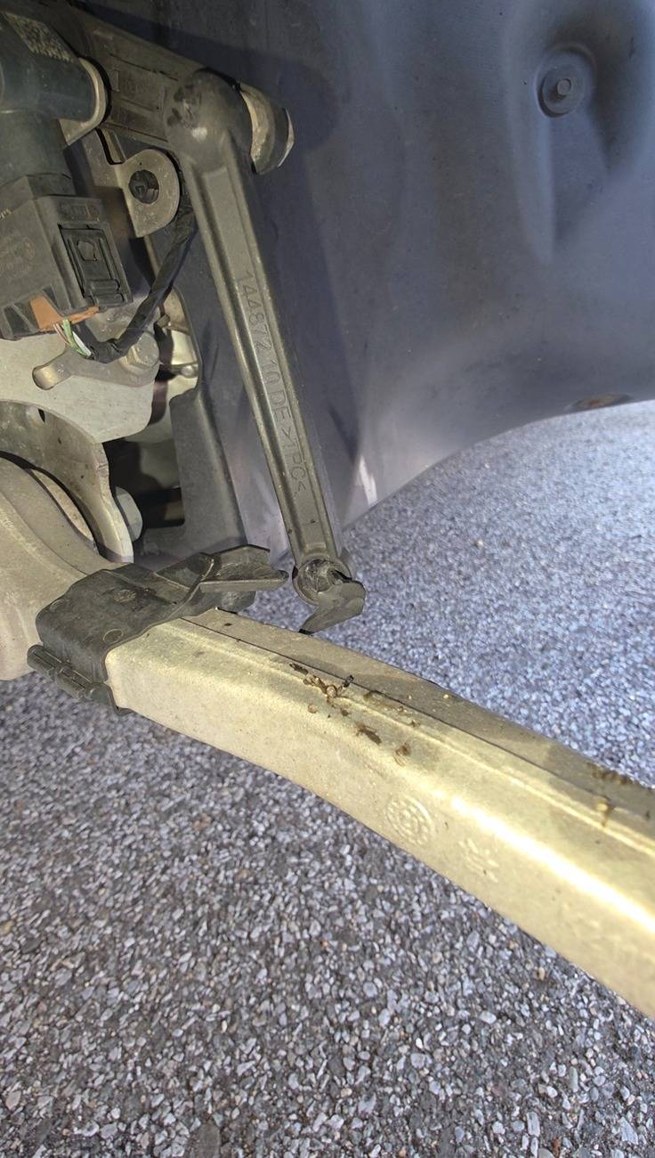

Hi, broke the front ride height sensor bracket after installing eiback pro springs. The sensor is fine only the bracket is broken-the part that attached to the metal see pic.
I looked online everyone was breaking their rear bracket and then getting the metal visconti one or something.
I don't see anything for the front one. Can someone help.
Whats the part number and how hard is it to fix. My lights are also pointing and down I can only see like 15 meters in front.

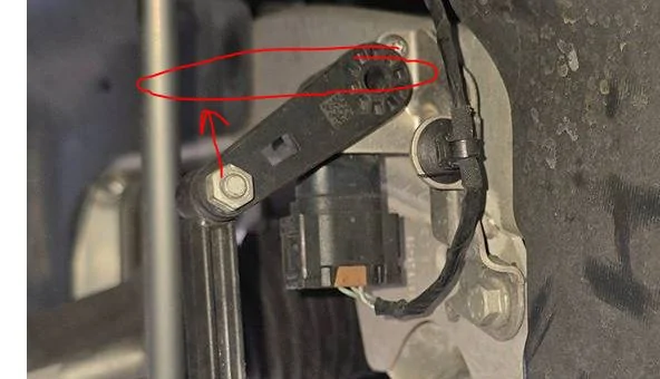

Part #: 48907WAA02. Very easy to fix. Pop off the clip that surrounds the lower control arm by prying here with a screwdriver.
The sensor itself levels the headlights so you could push it back parallel and zip tie it in place until the new part comes in.

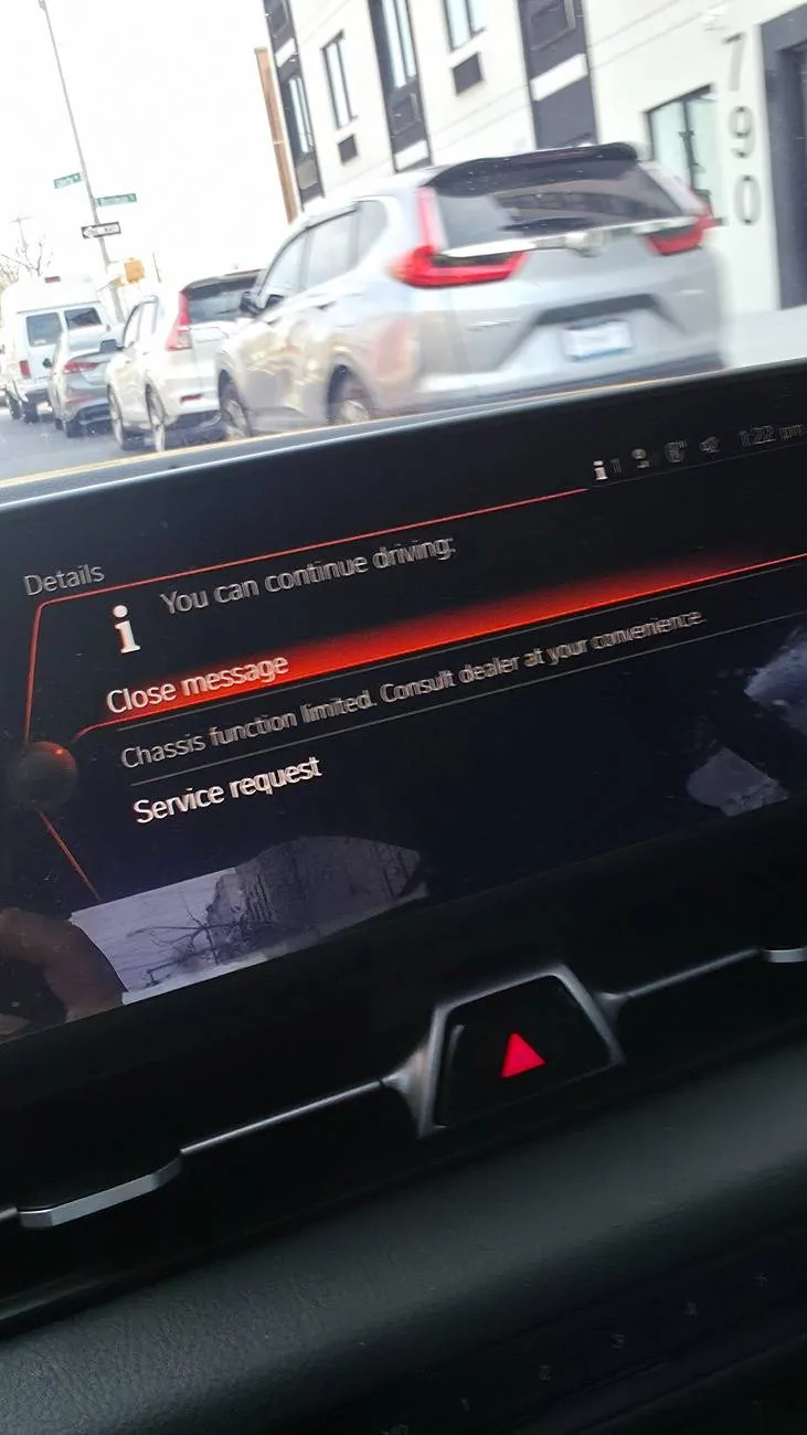

Thanks will this also remove the warning on screen that says chassis function limited? Also is there a metal upgrade part like the rear one?

It's like $15
Toyota #48907WAA02
Thank you is there a metal upgraded one I don't want it to keep breaking. I also have a warning on screen that says "chases function limited you can continue driving" is that related to this or something else

No metal upgraded version available currently. You won't continue to break it if you make sure it doesn't get broken. ;)
That error is because of your arm being broken.

It doesn’t break for no reason. Just loosen before working on suspension.
