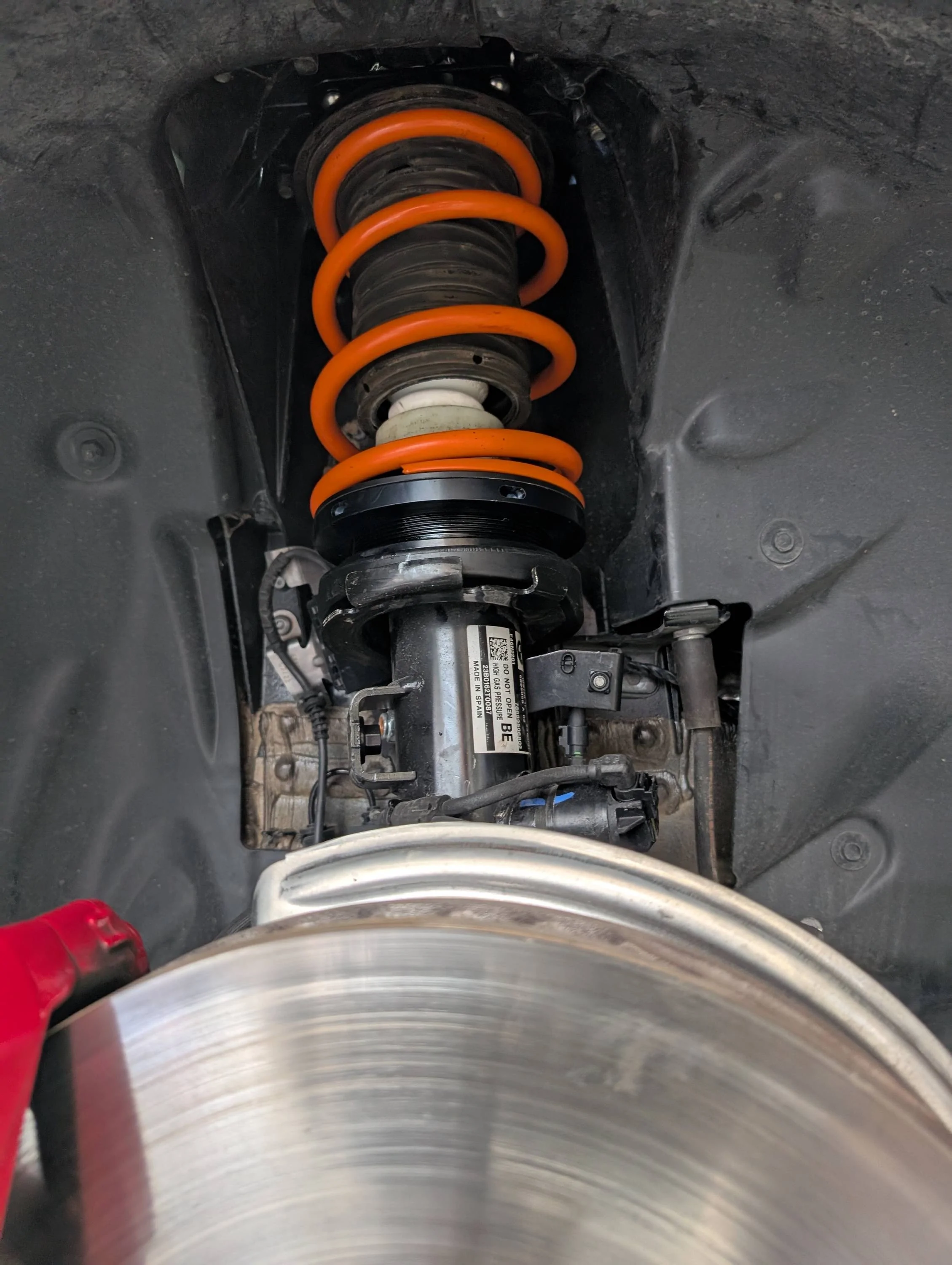

Well I got my MSS springs and Verus camber plates installed. The MSS Instructions are not overly helpful, thankfully there are some half decent YouTube videos that really helped.
I was trying to set a ride height that was marginally lower than OEM but I was not successful.
On the front I went ~3mm down from max height, this resulted in the front sitting ~15mm lower than stock.
On the rear I set the adjuster roughly half way, and this resulted in a ride height that's ~10mm higher than stock.
From reading through some of the the threads on this forum it sure seems like the rear does settle once you start driving it, but does anyone know roughly by how much? I'm tempted to raise the front by 1 turn and lower the rear by 2-3 turns.
Ideally I'm trying to go ~10mm lower up front and ~5-7mm lower in the back, when compared to stock.

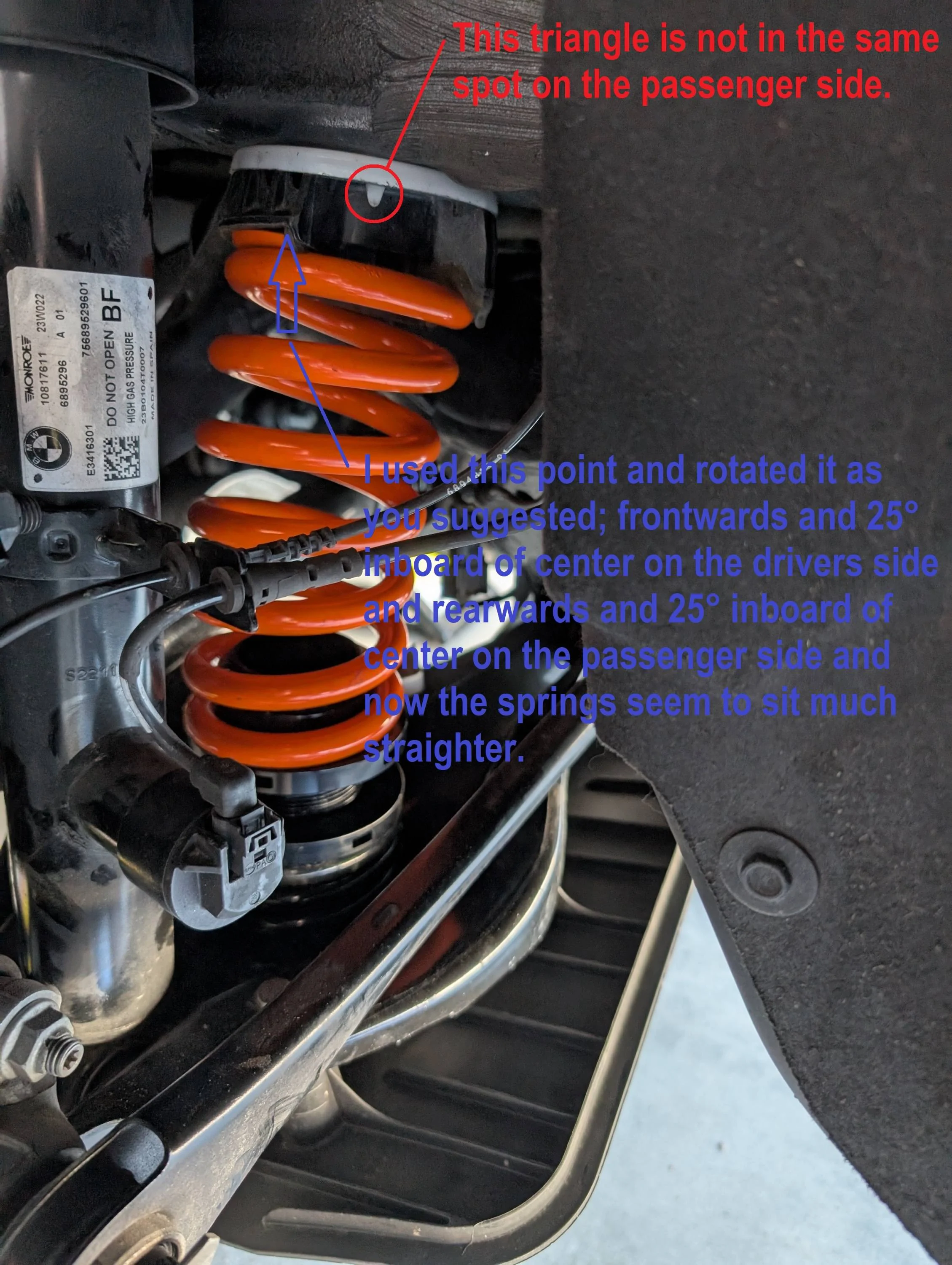

Thanks Strat-Supra, I had no idea, is there a corresponding mark on the chassis that those white triangles should line up with in the rear? To be clear, this is what you meant right?

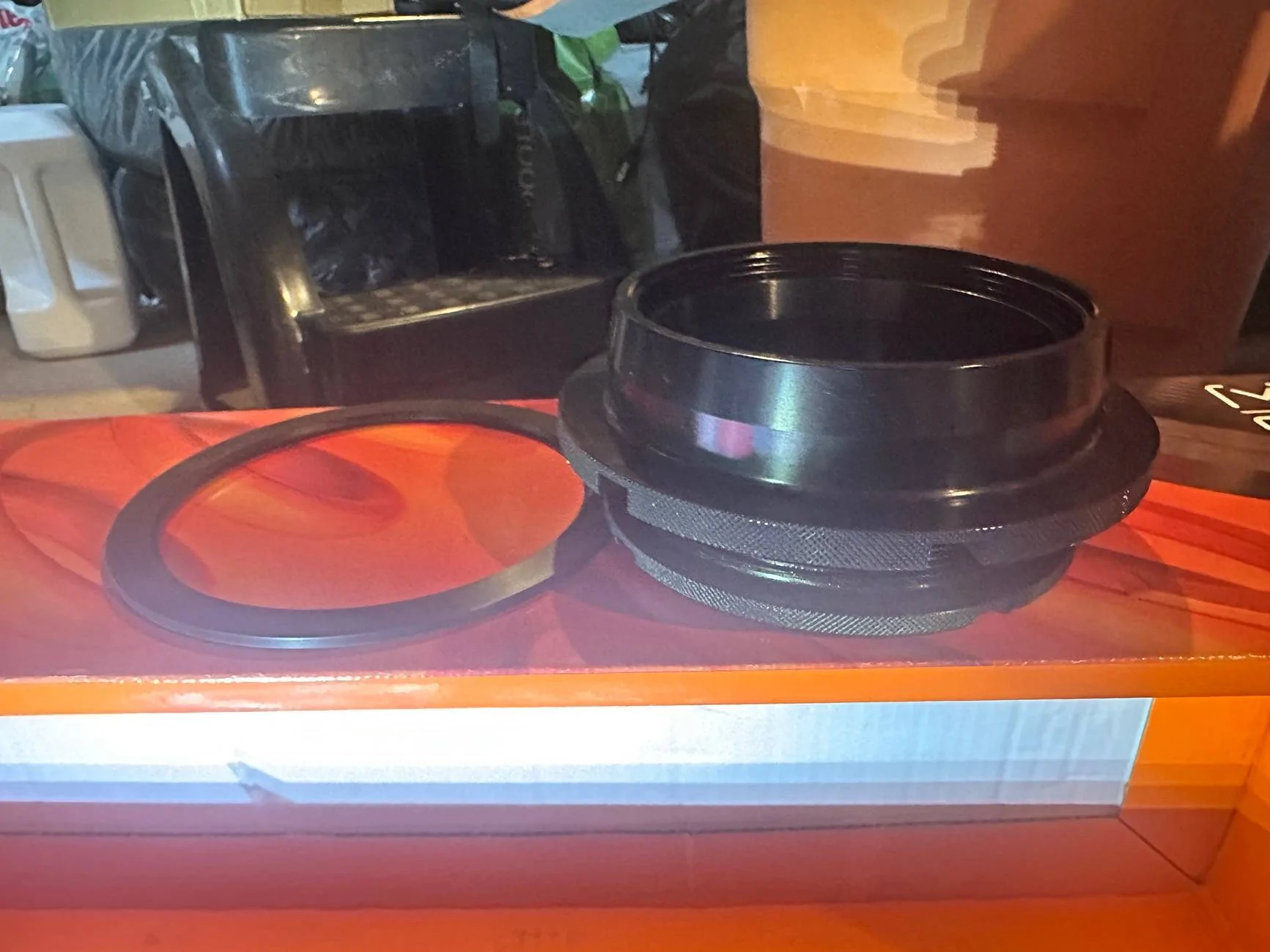

Are there multiple iterations of these springs? I noticed the adjuster in the image above looks different from mine (circular cut outs vs square). I’ve also watched a few install videos and none show the black plastic ring that I got in the box that I assume goes on the adjuster.
One other dumb question while I’m at it, when you guys talk about -20mm and -15mm drop, is that the measurement of the distance between the 2 collars on the adjuster? Or the measurement from the fender to the ground once lowered?
Thanks!

That little white triangle is not in the same spot on the other side (pass side).
I used this point where the spring contacts the rubber and rotated it as you suggested; frontwards and 25° inboard of center on the drivers side and rearwards and 25° inboard of center on the passenger side and now the springs seem to sit much straighter.
This is what it looks like now.

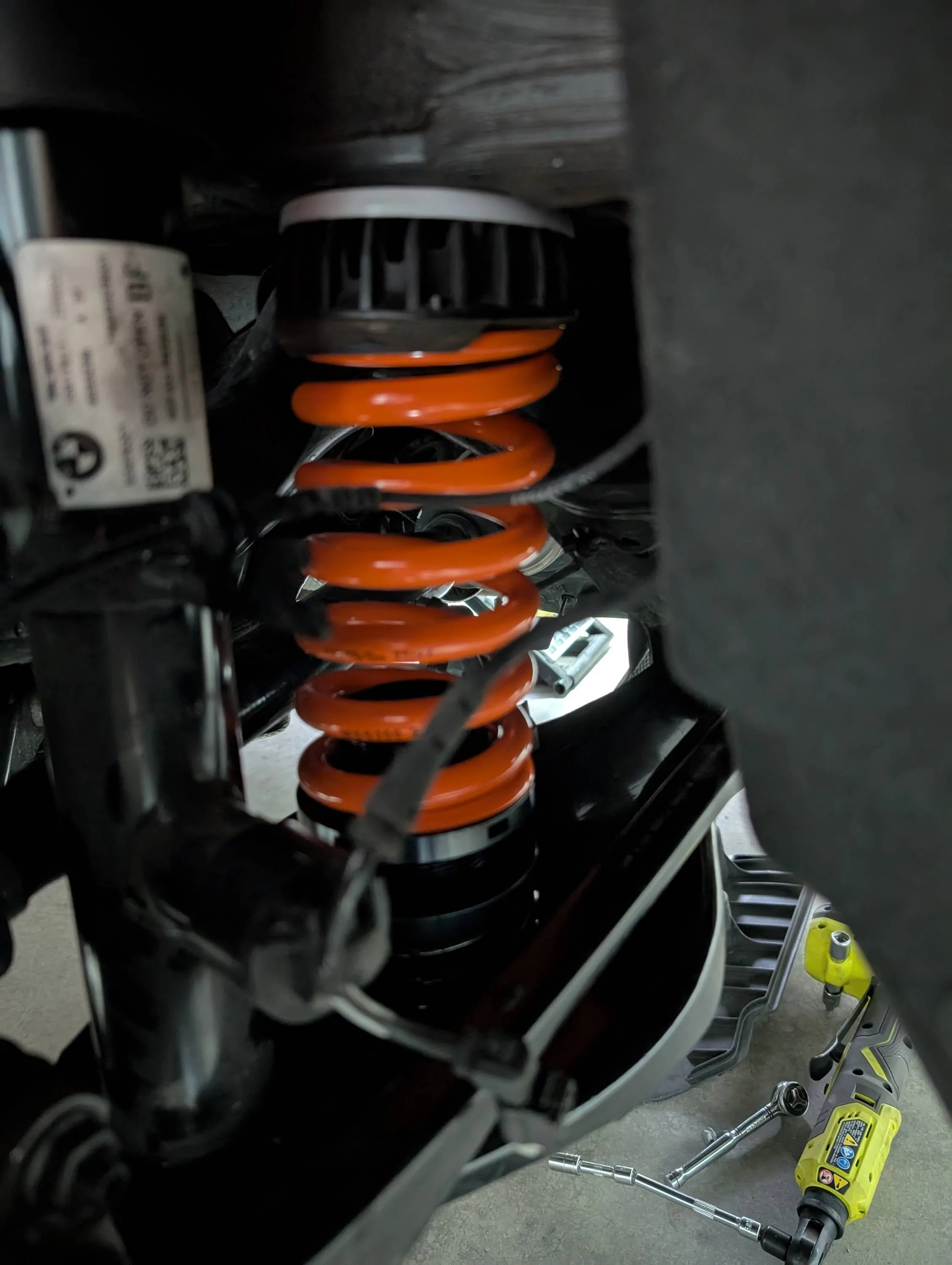

I think you need to turn it a little more, hard to tell from the angle.
This is the best picture I could get of what my driver side looks like through the wheel.
Did you use the lower OEM rubber perch? To me it caused too much compression of the spring, so I removed it. I was metal on metal for a little bit and didn't experience any issue with noise or anything. However, I did end up using isolators to not have metal on metal.
