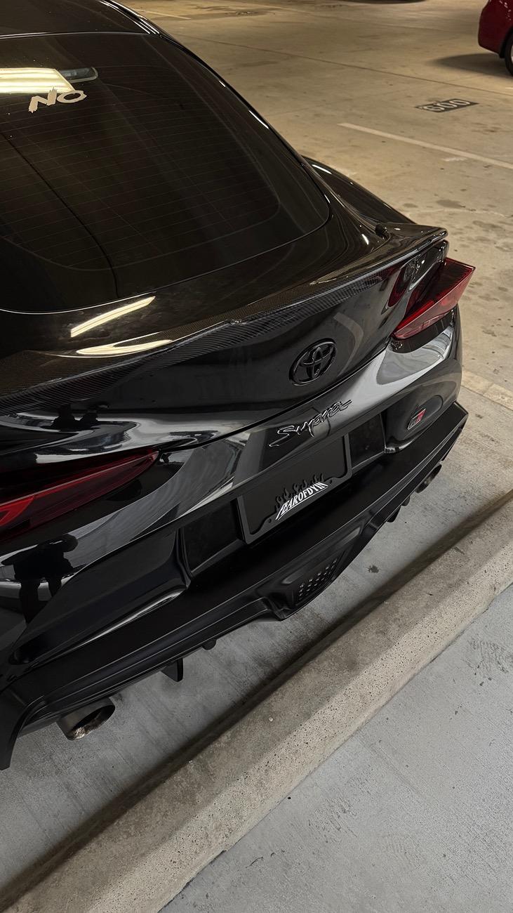

Recently installed Vusi studios electronic license plate cover.
I routed the cable from the battery up to the driver side tail light and drilled a small hole under the plastic trimming to route it out of the cabin.
I had to remove the hard plastic trimming on the back side and pulled out the corner trimming to expose the metal where I drilled the hole and fed the wire though.
I then fed the wire through to the license plate light hole on the left side to plug it in. It’s pretty seamless and the only way I found to do it without removing the rear bumper. There’s basically no delay when using the remote and has saved me a couple times already….
Figured I’d post here since so many people DM’d me on IG asking how I did it.
I should also note that the license plate cover did not fit so I had to trim the edges and 3M tape it onto the frame, can’t even tell but also my car is black lol I will work on posting a video as it wouldn’t let me upload the clip to this thread.
