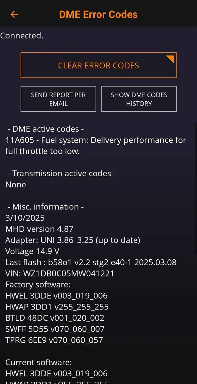

limp mode. 11A605 fault code

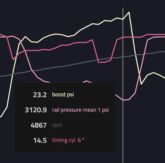

Yup, maxing out HPFP and rail pressure drop 2000 psi. Timing is also insane.
I personally would find another tuner if your current one is having an issue correcting this issue. It's a super easy solve.
