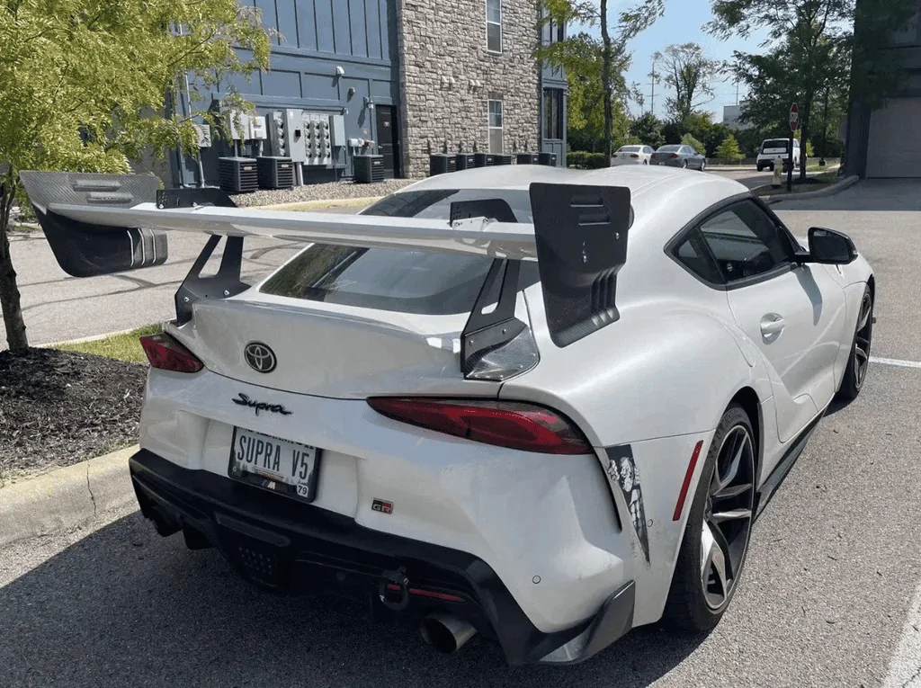

I'm curious: How wide should a swan neck wing be in your opinion? I mean, 68 inch is massive and produces a lot of downforce. Definetly too much for a normal road car and a modified track car. It's more a gadget for a full built track car. So, what's a great size for all in your opinion? ✌
Holy wing Batman. Even for the track that just looks excessive! I’d be so hard pressed to drive with something like that in town. But that’s my style and to each their own. My 18 yo son would love it! And glowing LEDs underneath ?
