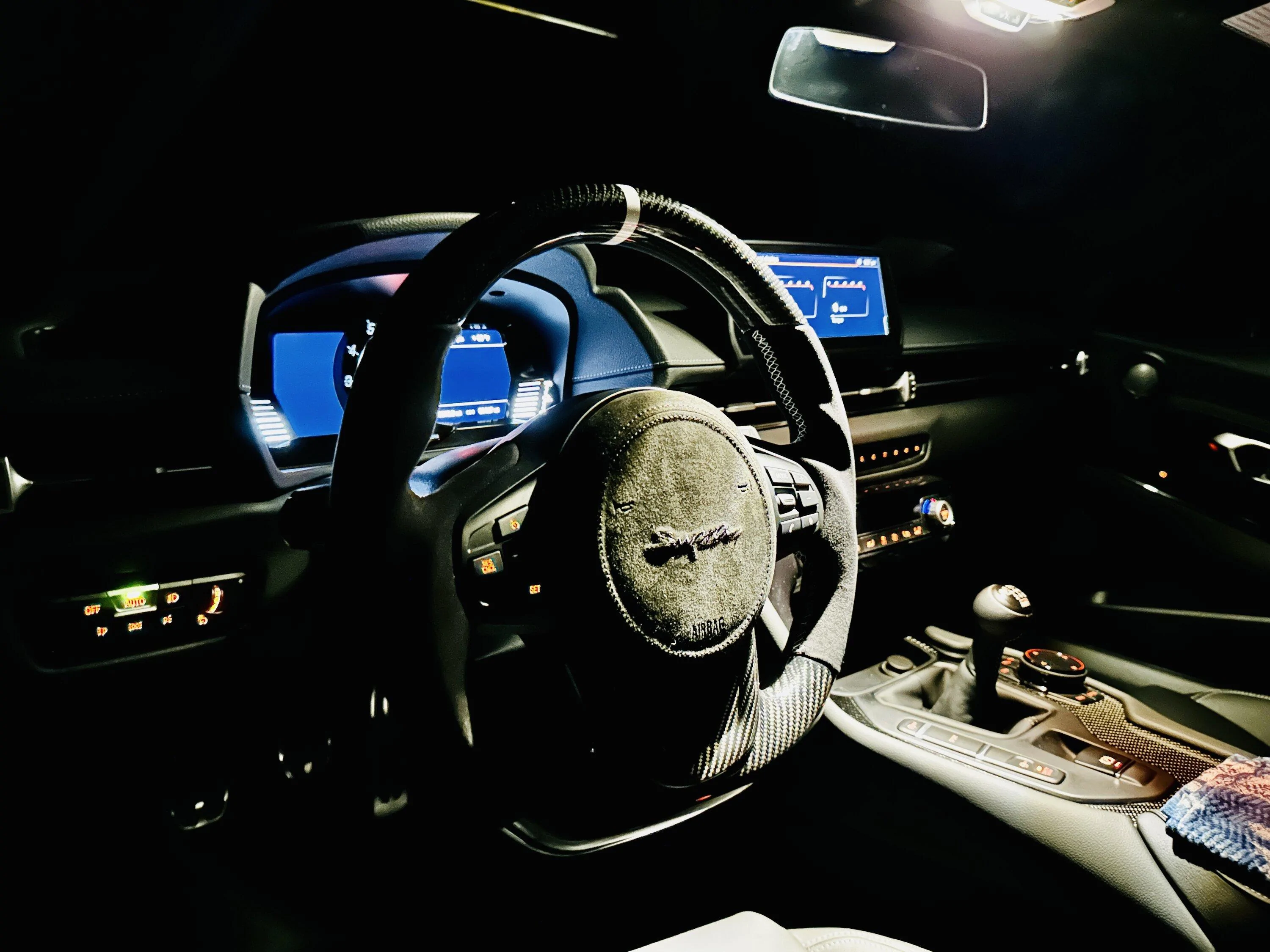

Hey just random, see you have a custom wheel, who made it? Was it for an auto so still has openings on the rear for the paddles or for a manual so closed and just opening for screws.

Is for an auto, the back is open and has holes for paddles. Canā€™t see it from passenger side or feel it unless you really reach for it. Unleashed custom can make it for manual and cover up the holes. Hit them up

Haha I make my own so was just Curios if anyone else has done manual
Only wheels yet or just me šŸ˜…

Oh thatā€™s whatā€™s sup! I would of ordered a manual wheel myself but I didnā€™t want to wait, really no difference unless you really try to look back there

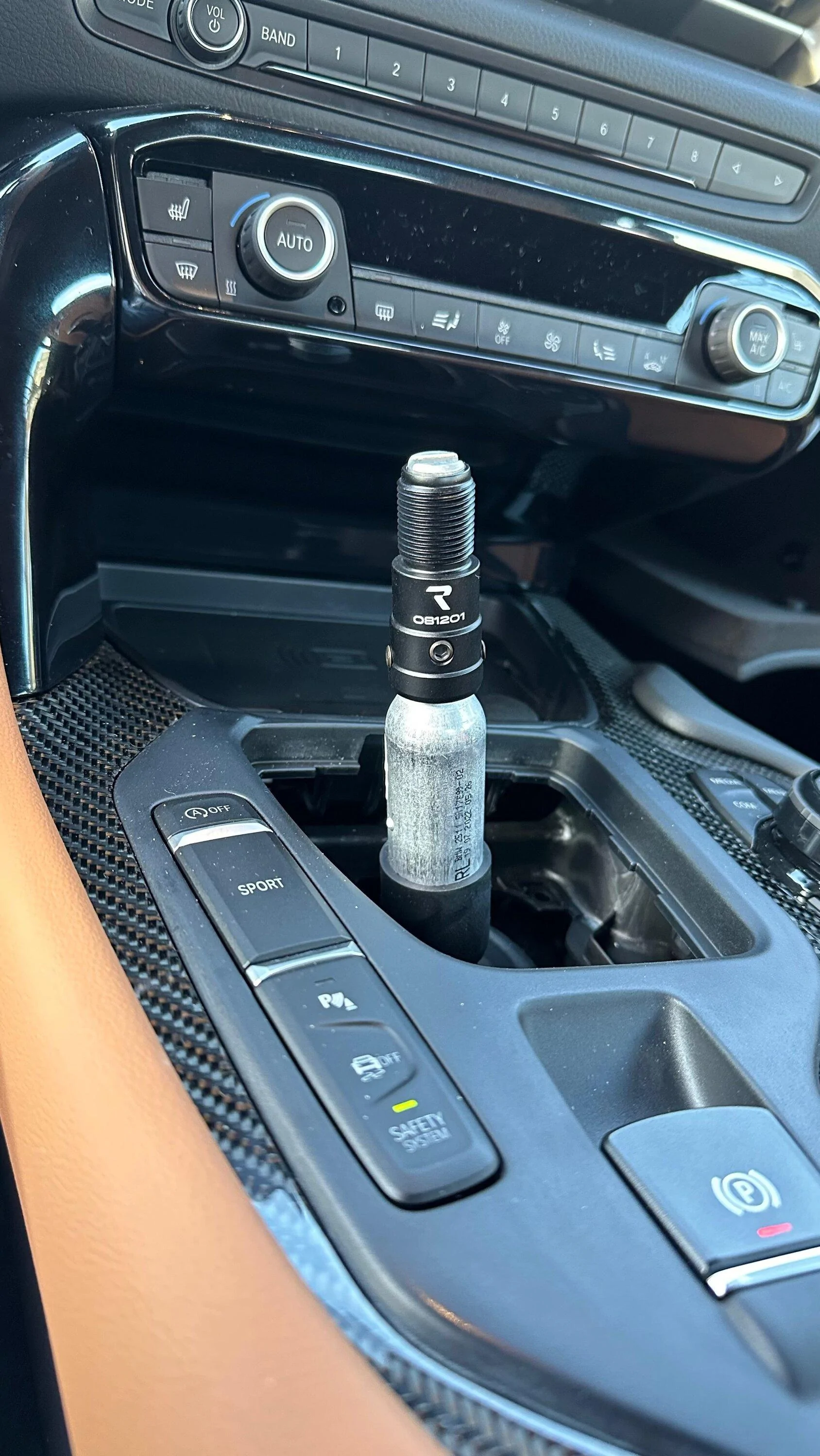

I'm getting the Raceseng shift knob adapter shipped to me for test fit. It's the one they sell for their BMW shift knobs which should work but still worth double checking. I plan on getting their Nitro model but still trying to decide if the red will look nice with the tan interior. For the boot I'm gonna try separating the plastic trim that clips on the center console and source a the boot either online from a similar BMW model or just try finding a shop locally that can do it.

Update on my end. The Raceseng non threaded adapter fits as expected on our cars. I'm gonna be getting one of their collars and shift knobs to test if it would be possible to cut the oem boot and still have enough left to make it all work. I'm hoping that cutting between 1/16"-1/8" below the knob should work nicely so that I can also wrap and glue some of the leather under the knob to be able to sell it.
