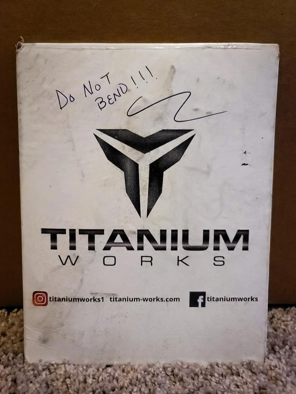

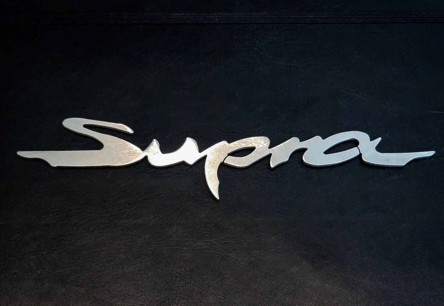

Received the Titanium Works Supra logo that will be mounted onto the new Intercooler Manifold.

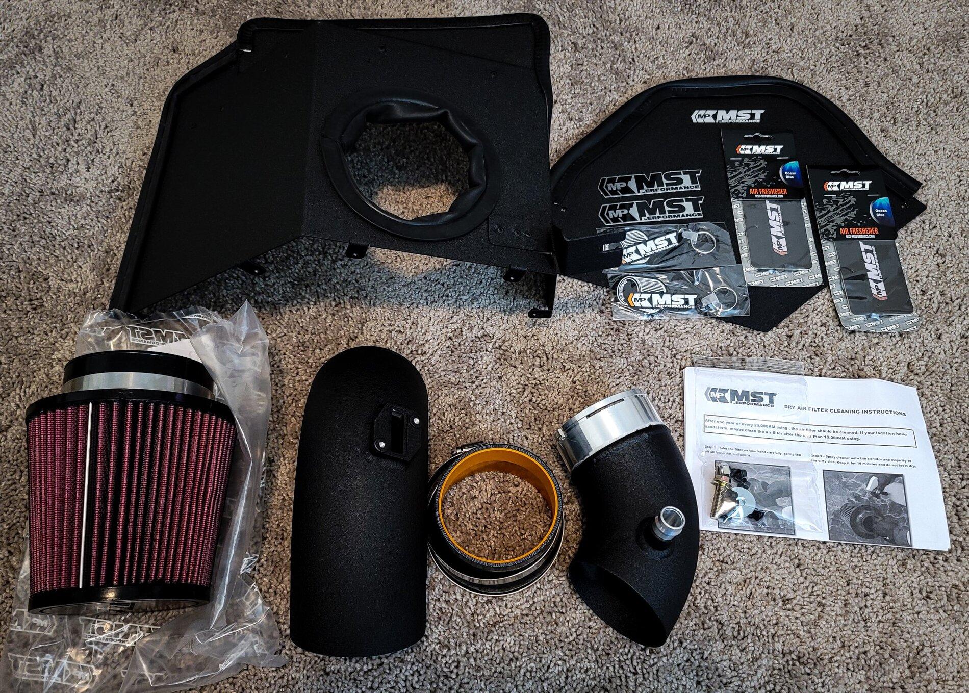

MST V2 Intake System in:

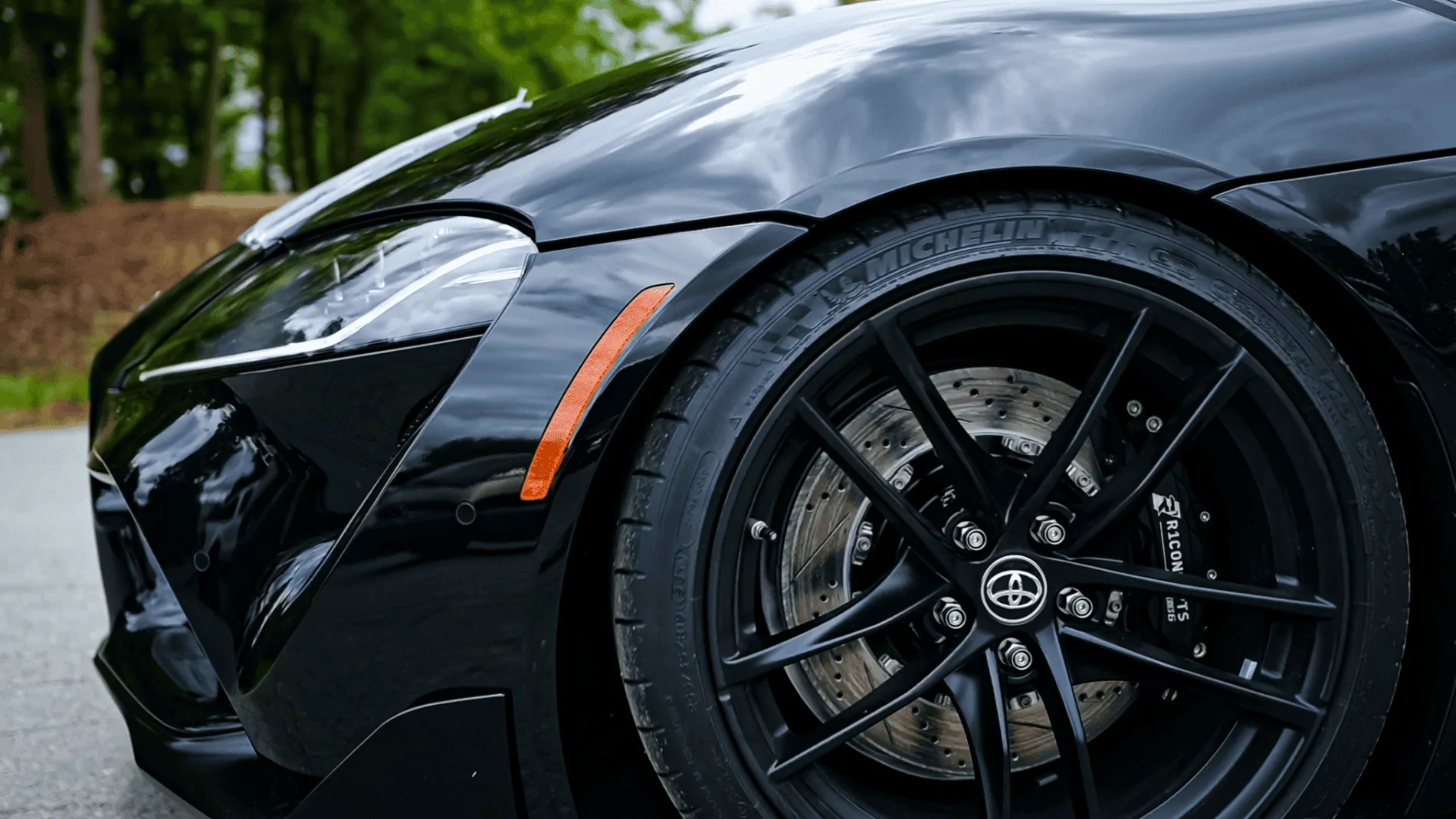

Velocity Motorsports sent some pictures over today. Ride height is still being adjusted. It was raining when I took it over so it's a little dirty. The silver accents are turning out to be a good call for my own personal taste. I was afraid that I wouldn't like the combo once I saw it. Luckily I love it.

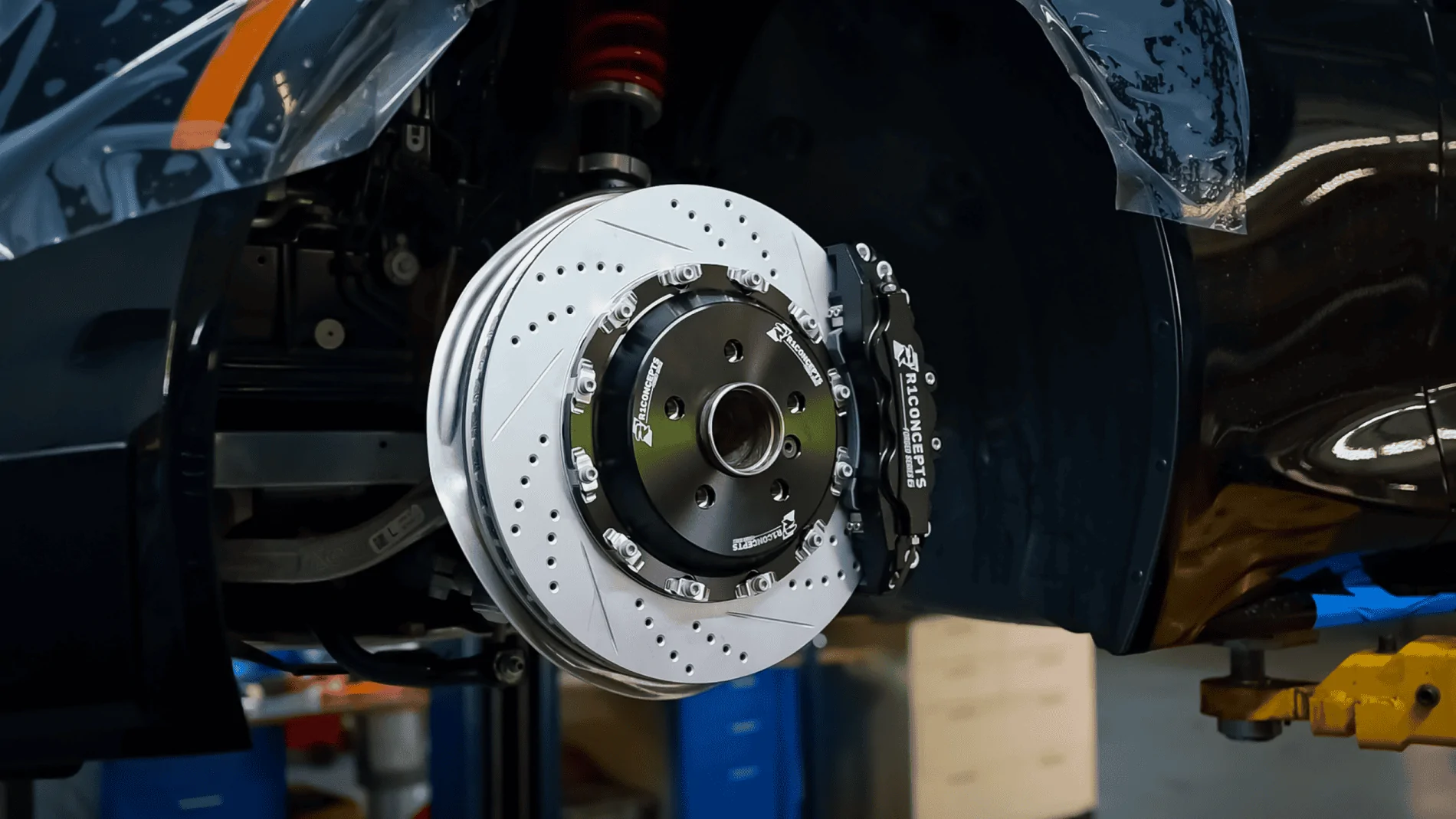

Here's a close up of the brakes and new coilovers. The car is still at the shop. The rear will be raised and it might transition straight into some body work. I might not get it back for a bit.

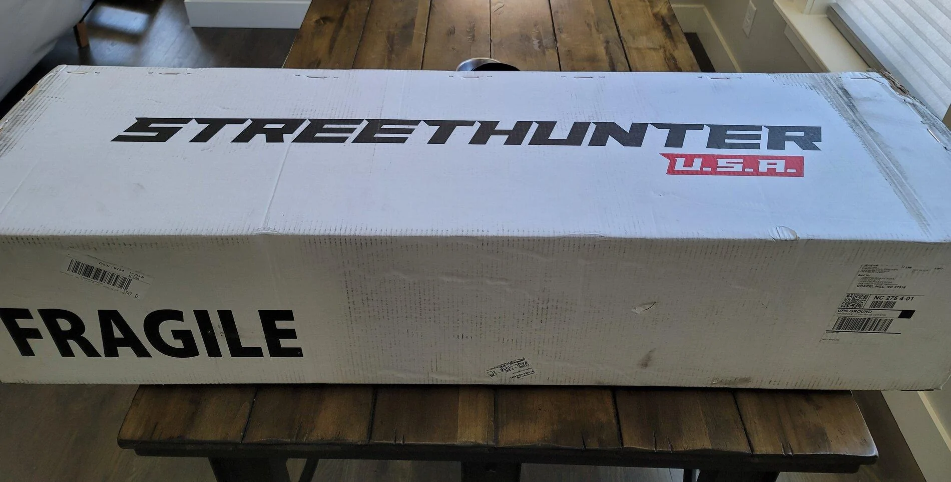

Wing is in. It will be customized to fit with the A91 spoiler. Some people think this wing is played out, but I love it. Jon Sibal did an amazing job on the design. There will be some things that we will try in case the "gap" issue arises with these. There's an awesome in house fabricator at Velocity Motorworks and it shouldn't be an issue to to get this thing fitted correctly.

Just a word to the wise on the wing install:
Be gentle when tightening the wing to the mounts. Use hand tools like the instructions say. It's a slow process, but both the wing mounts and the wing itself have been known to crack when using power tools (from self-installations and professional installers alike).
I would also recommend getting stainless steel mounting hardware from your local hardware store. The included hardware rusts.
Also, I recommend getting some sealant to place around the holes to prevent water from seeping into the deck lid.

I haven't done a wing install on the Supra, but as someone who's done installs on other cars, everything here is 100% accurate and would definitely follow.
