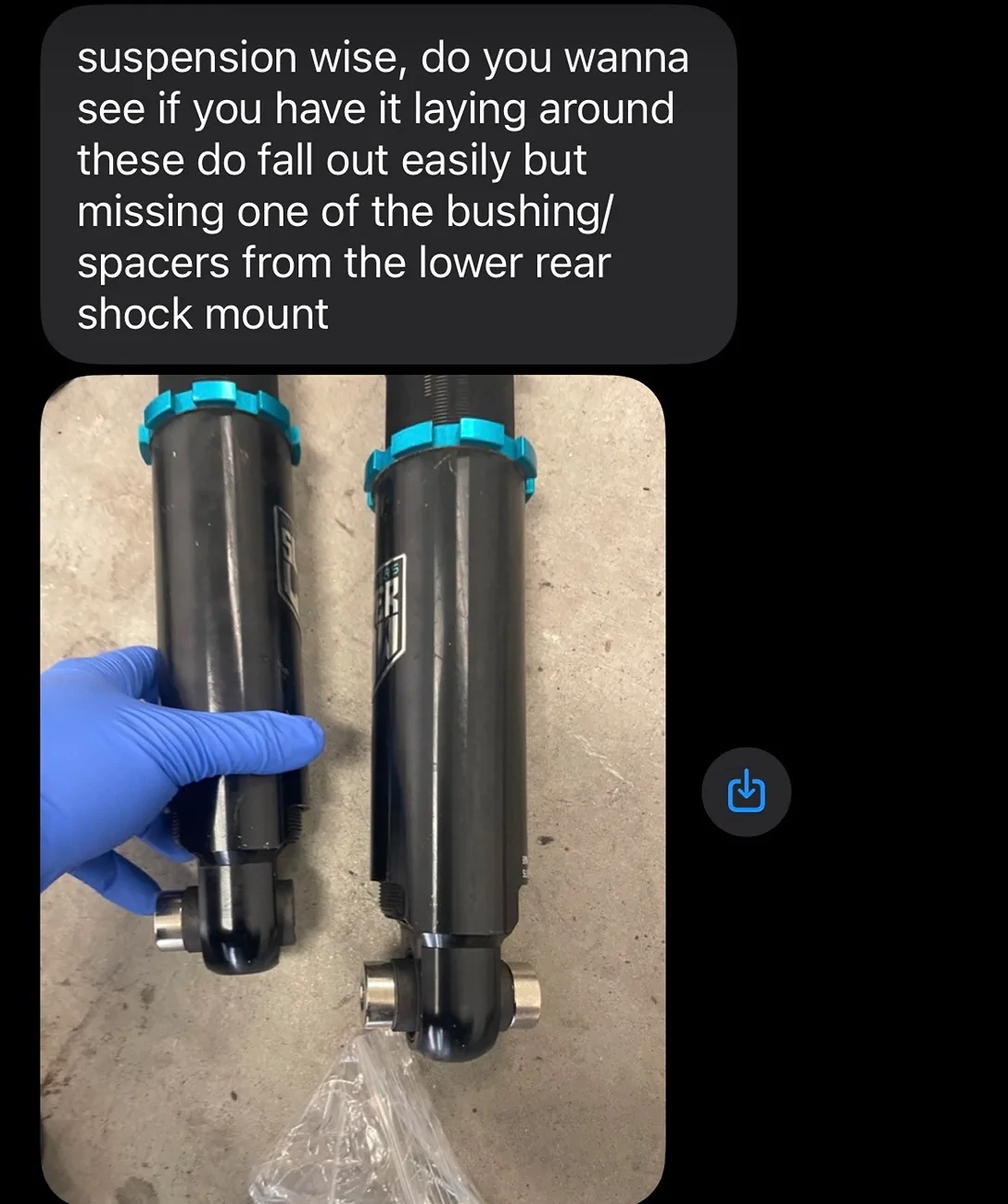

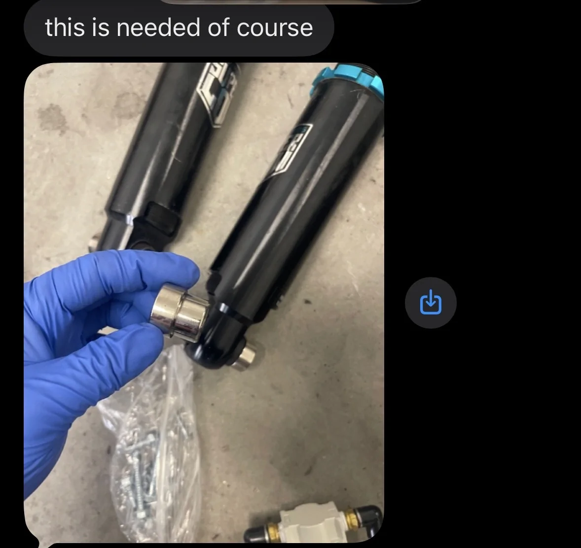

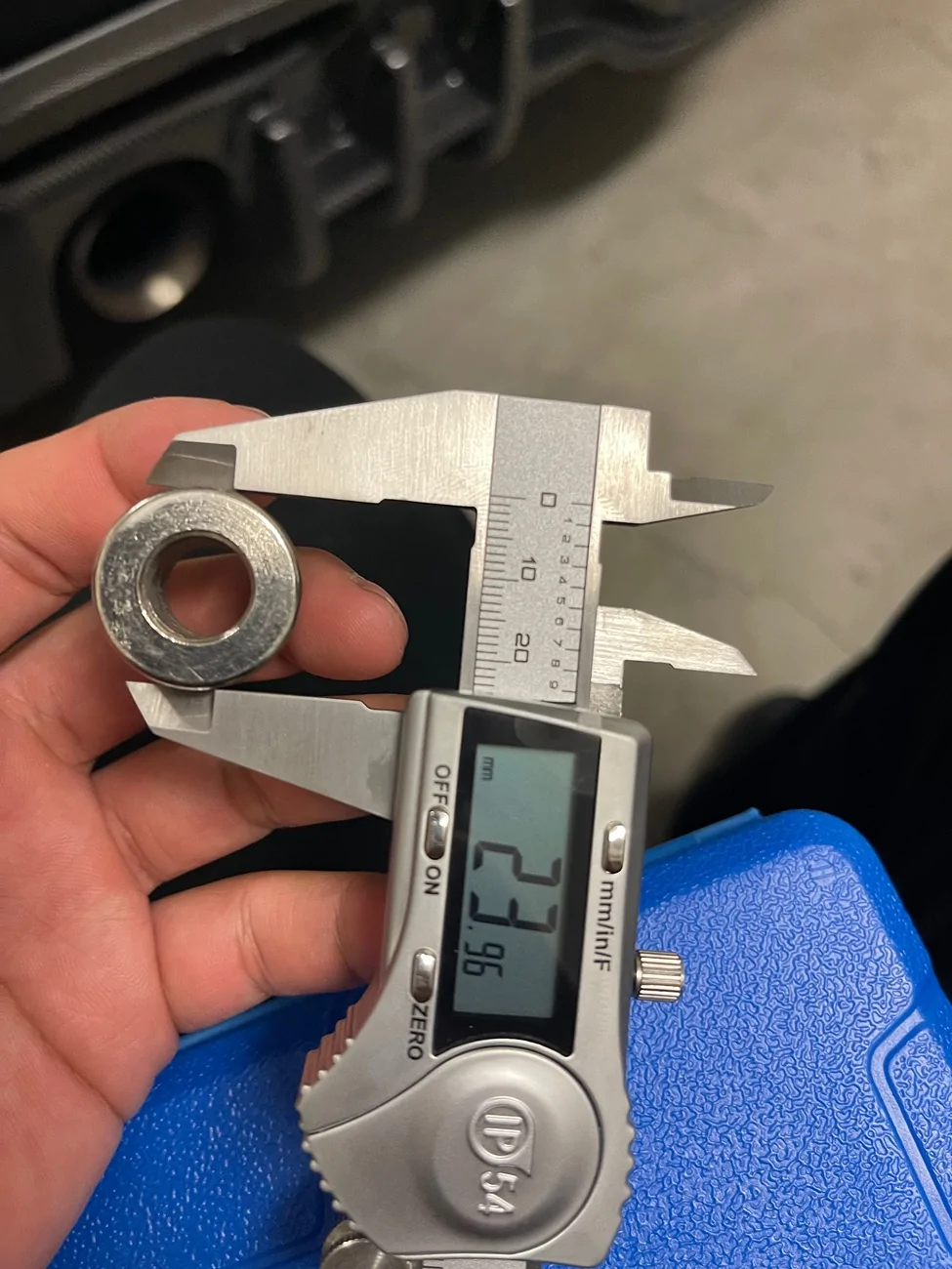

i bought a used pair of are struts from a local person for a good deal but some hardware was missing. they are bag riders super low struts. the peice i need is a bushing for the rear lower shock strut. the guy installing them says that are not like a normal bushing that needs to be pressed in. apparently all 4 of them are removable can get be put back in without needing the press. i have 3 out of 4 so just missing the 1. he is going to measure the size of it and see if there is anything online i can get. but apparently its not a normal bushing because of how it’s removable, not entirely sure. i’ll drop a photo of the part i need. i contacted the company for a new one but they don’t sell this part individually so i would need a whole new srut they said. if anyone knows what exact part this is and where i can pickup please let me know.

This is not a bushing. It is a heim joint spacer, also known as a "high misalignment spacer" or "rod end spacer". Measure it, Google it, buy it.

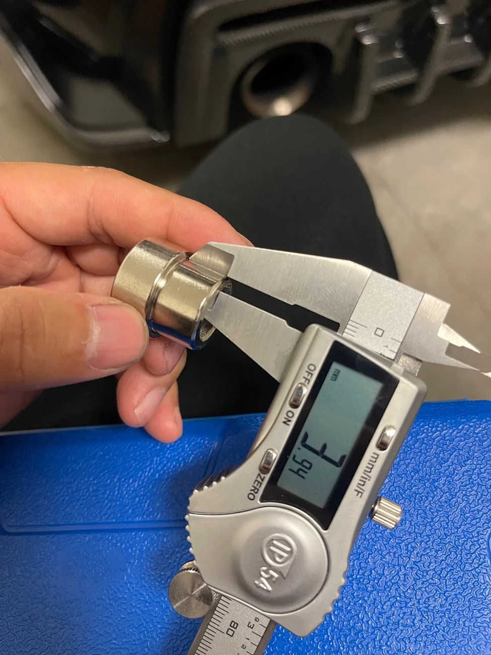

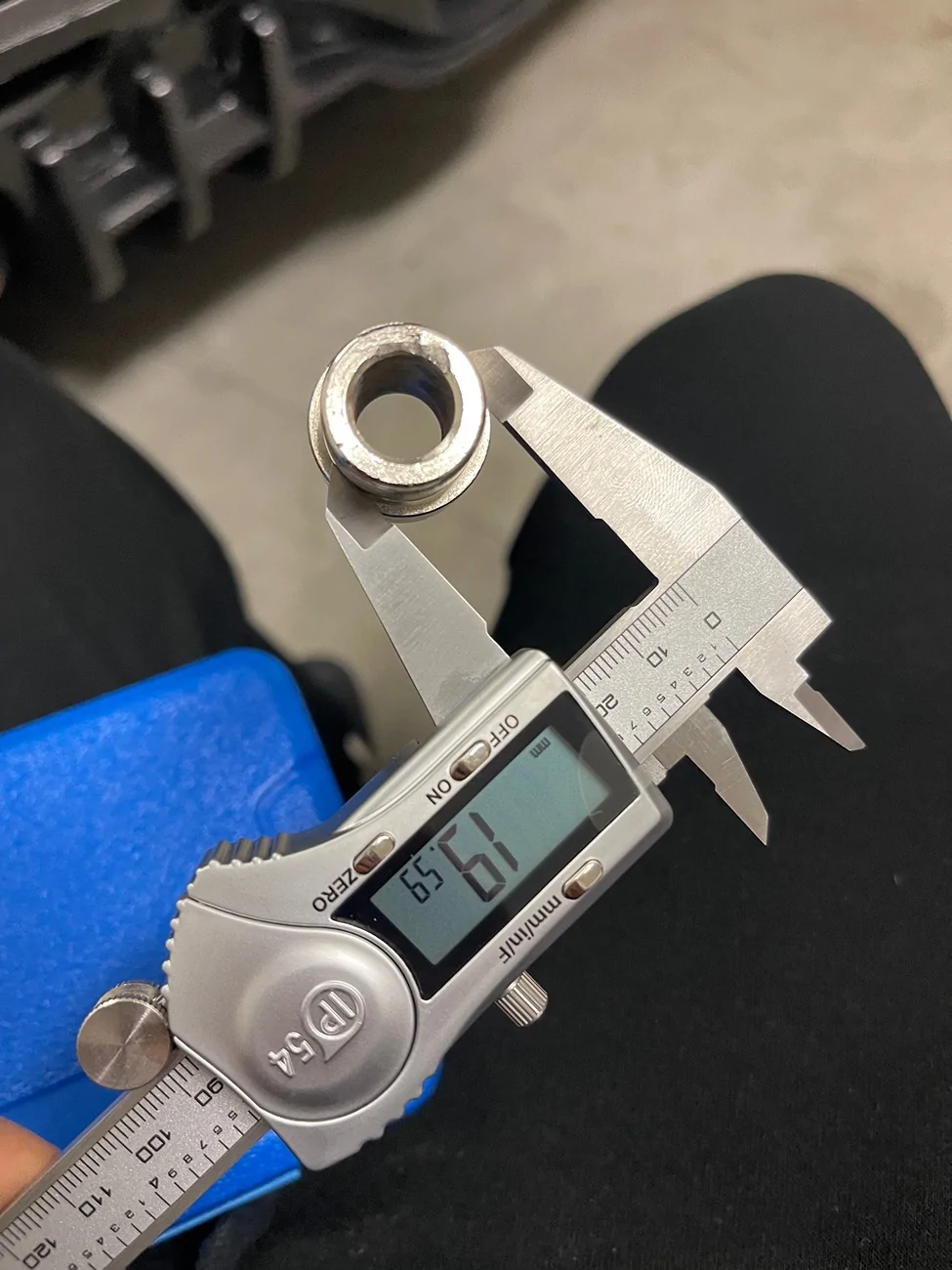

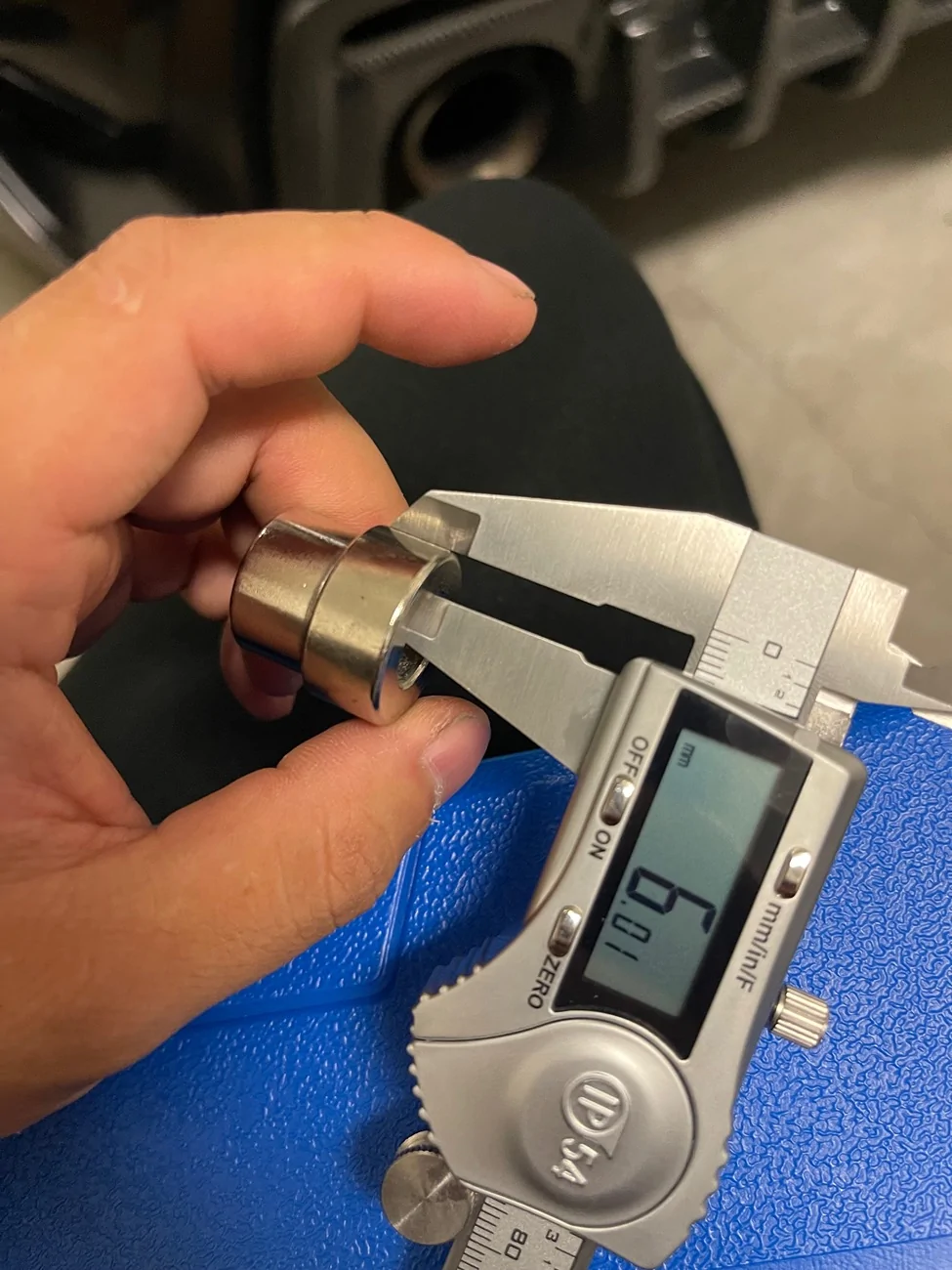

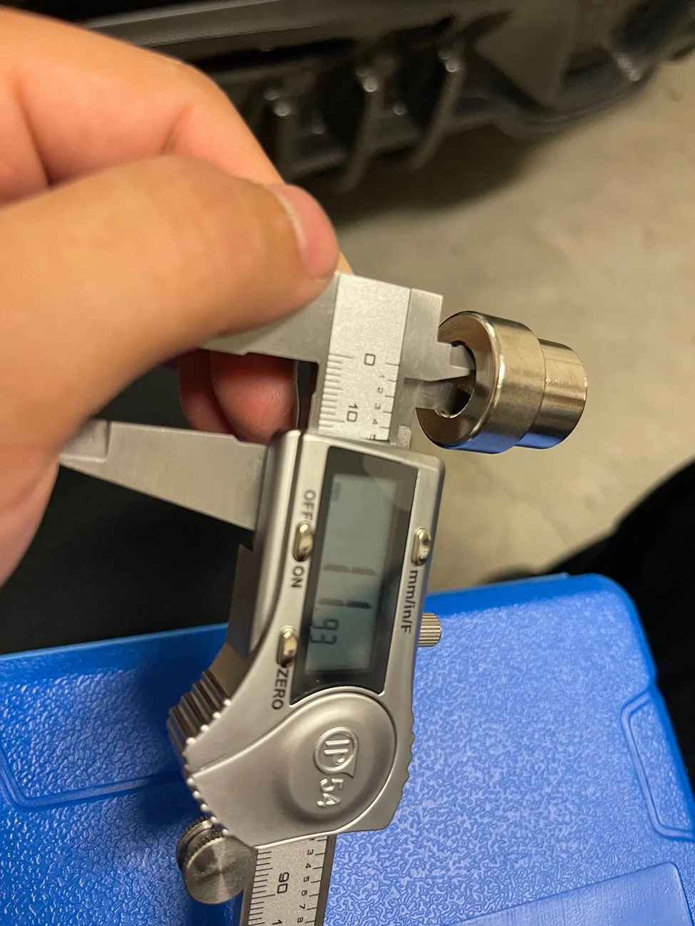

Here are my measurements but nothing on Google really matches it

If the manufacture won't supply them, you are probably going to have that made by someone with a lathe. It's very custom as you are finding. Get all the measurements (you are missing several, like the total length, length of each shoulder), put in in a simple diagram and someone can turn one up for you.

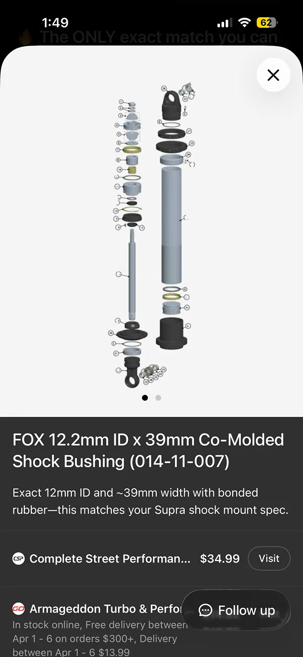

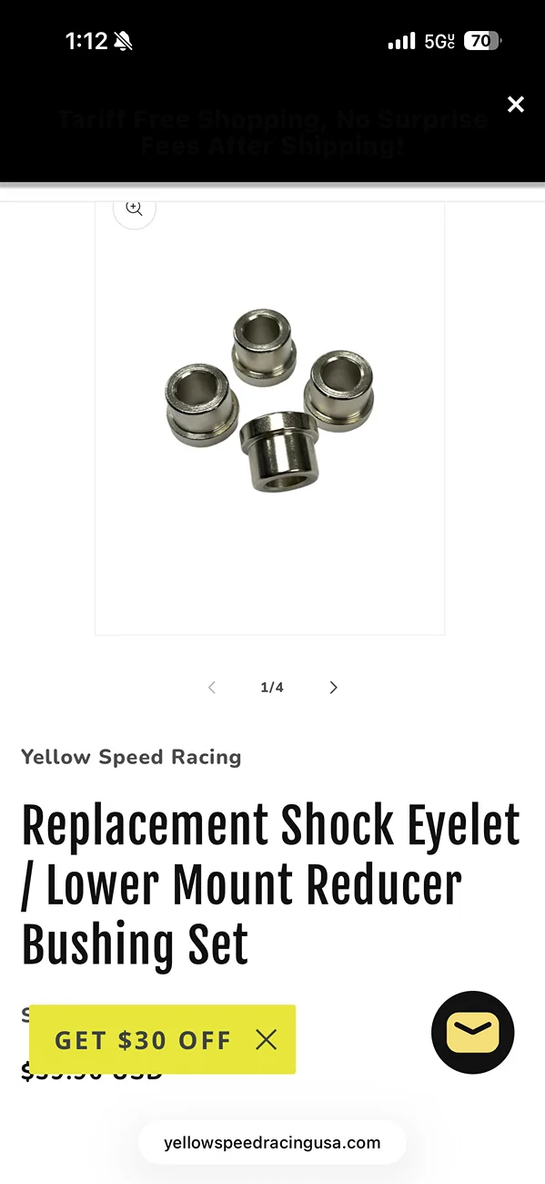

okay will most likely go to a machine shop during the week. but i did find this online chat gpt told me this might be a good match.
mack73
Nov 17, 2025
82
114
'26 Final Edition

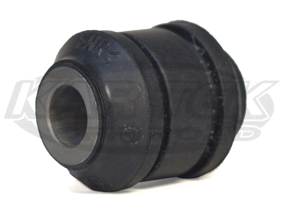

Unfortunately not going to be a good match, the co-molded piece means its got a rubber part molded on it - here's a picture of that part

ahh okay thank you for the help. i emailed this company to confirm on size, if they don't match looks like i'll get them fabricated
