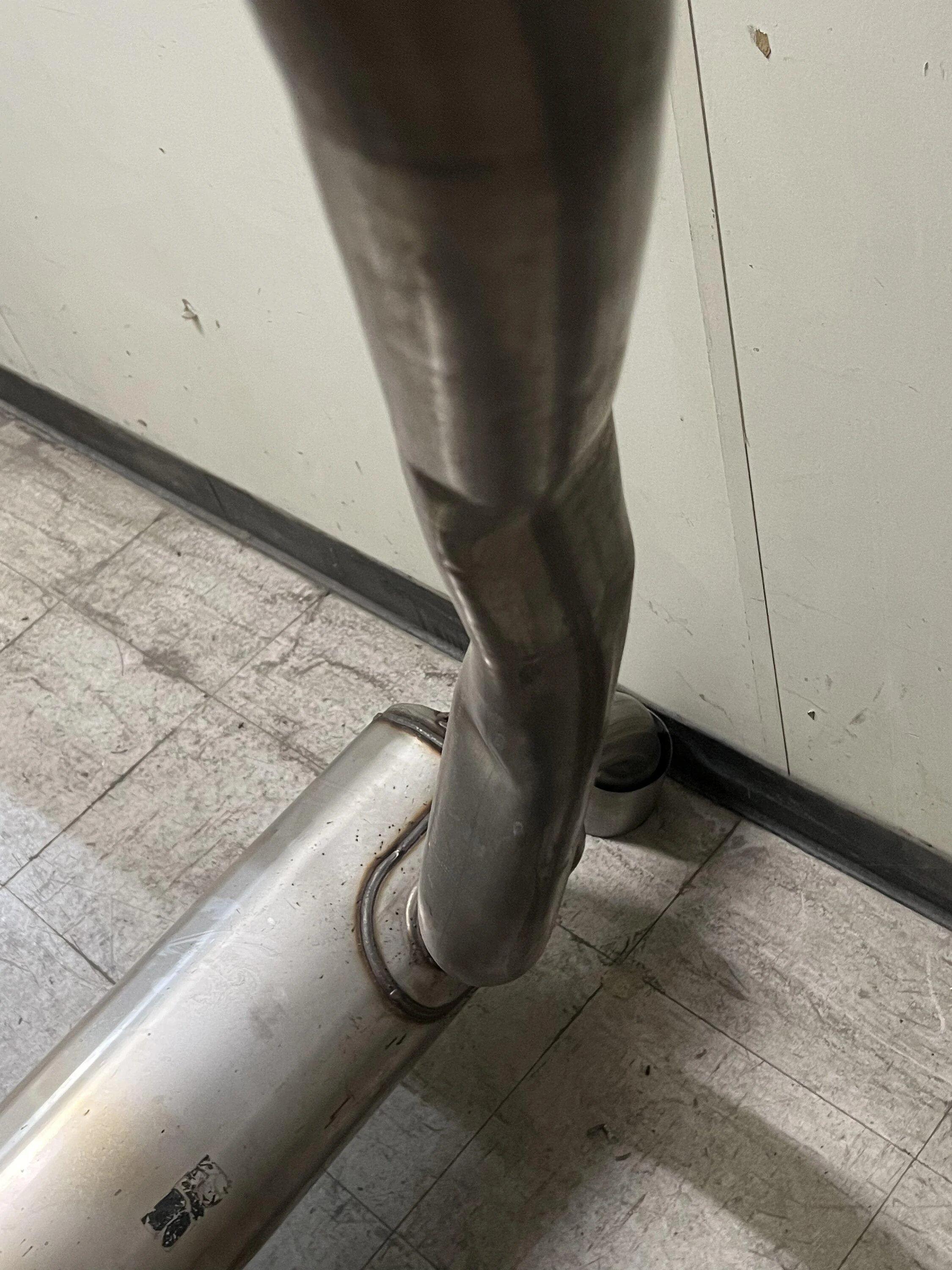

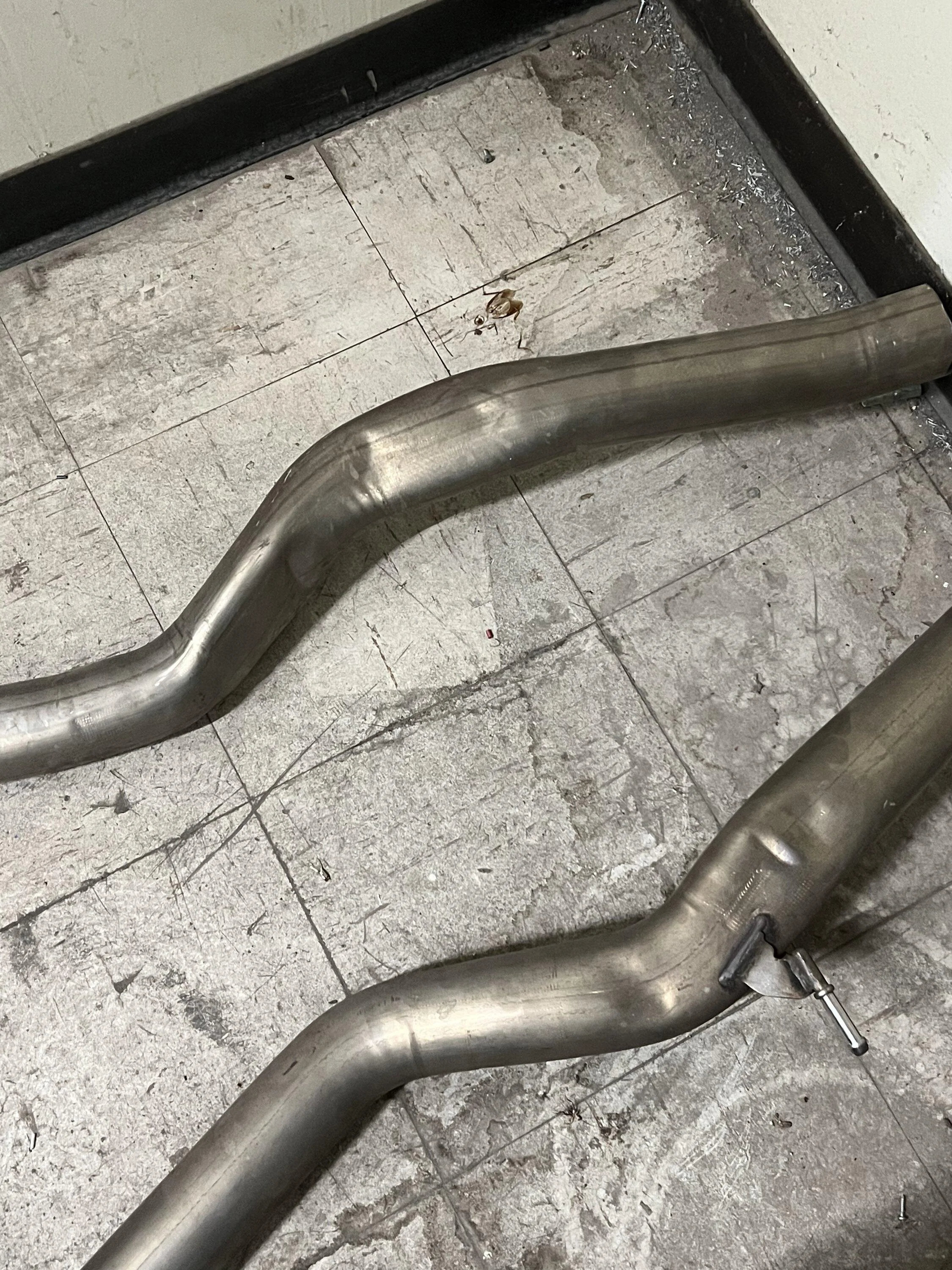

I would also like to note, this car was used with 8k miles prior, nothing on the carfax so I had assumed it was okay, but the stock exhaust was also very damaged on the underside. When I replaced it with an aftermarket, i had no alignment issues so i thought nothing of it, the car drove fine. But looking back at it, the damages are right where the rear left axle would be. Pics for reference.
Any info anyone would have would be extremely helpful ? I just want my bags to work LOL

Yeah that’s just what the stock exhaust looks like. The stock charge pipe also looks like it’s been all smashed up, I guess it’s just a BMW thing.
8,472
14,122
I see no damage here.

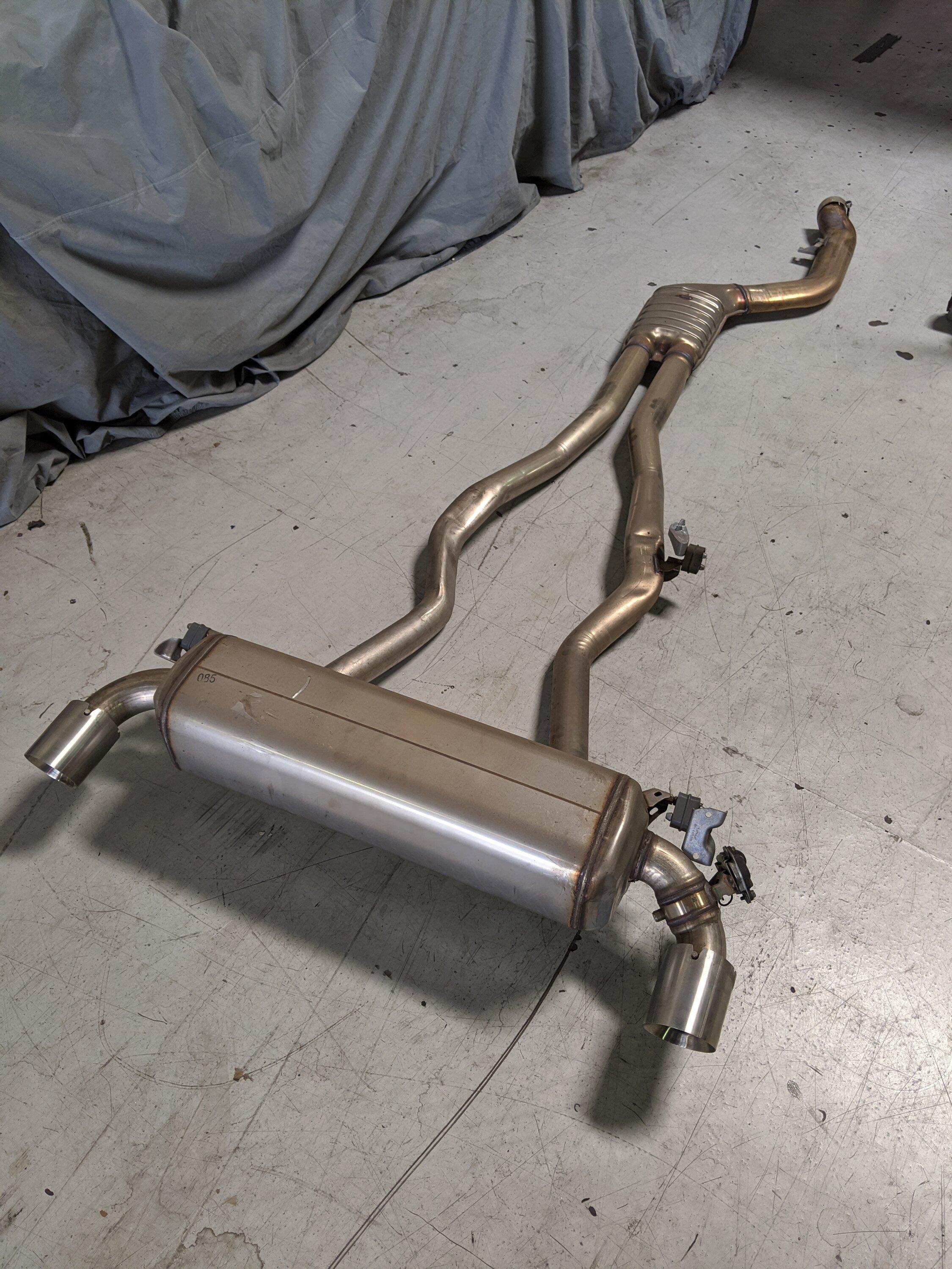

FYI all the stock exhausts come like this from the factory. It's kinda bizarre. Here's mine when it was taken off.
Yea that's definitely interesting LOL. Thank you though appreciate it, good to know mines not the only one that looks mangled HAHA
That's so weird LOL. It definitely looks like it's been mangled and beat but, I guess it's a common thing with this exhaust LOL.
8,472
14,122
It's no so much "common" as that's how it's engineered. That's how they are.
