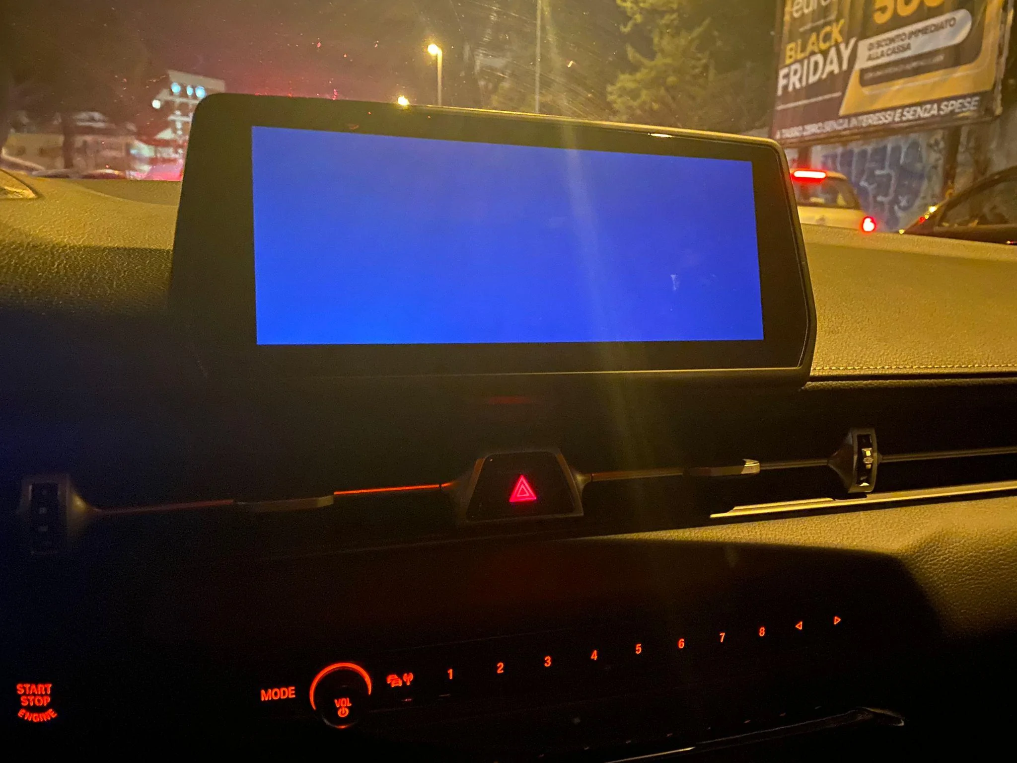

I'm having the same problem, plus the carplay disappeared, I'm waiting for a solution from Toyota.
