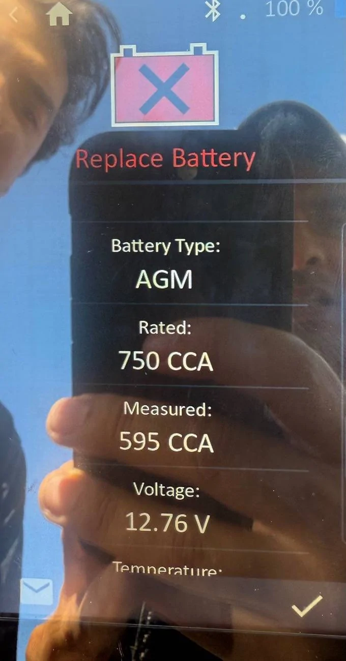

My battery died. At least that’s what the tester shows. I killed the battery messing with the car or leaving stuff connected that drained it.
I’ve been getting low state of charge messages just before this happened.
took the car for battery testing and this is what it shows.
again. As long as I dont have connected a specific after market accessory, all is good. Once I connect the accessory and it draws power the battery dies.
which brings me to May next question for @razorlab who had a similar set up:
does the RaceCapture NEED to be hardwired to Fusebox?
mine is drawing power from OBD2. Not connected to Fusebox.
I may have left it connected to OBD2 a couple of times while the car was parked.
Is that what killed my battery?

Yea that could do it. OBD2 port isn't switched power so basically the Racecapture is just staying on.
Surprised your alarm didn't go off though.
