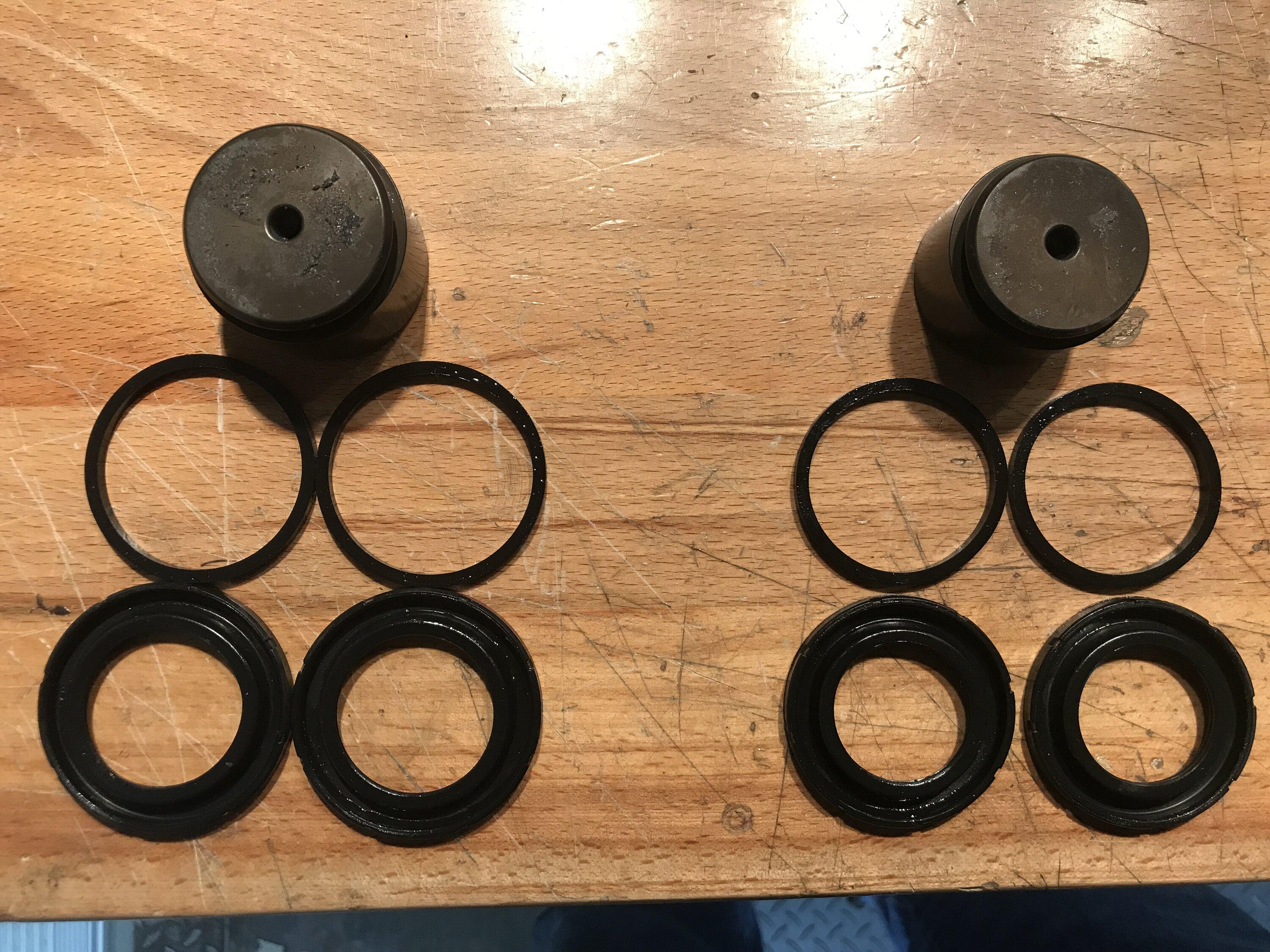

I am getting my brake calipers powder coated. I removed and stripped them down to prepare them for guy. Pistons, seals and boots have been removed. The boots were a little tricky but seem in good shape. My car only has 4800 miles so all of the rubber is in good shape so I am tempted to re-use them. Any feedback on doing that?
I am having a hard time getting correct replacement boot and seal item numbers plus it is unclear whether they come in pairs or single - Supra online parts are not clear. Front pistion pairs are different sizes and the diagram only has one item number for the front boots which makes no sense. The rear seem to be 47737-WAA02)
Any suggestions as every freaking part for this car seems to be "Single use" :D

Thanks Bryan. I am still struggling with the Front as there are 2 different size pistons - one ~40mm and the other ~44mm. The respective seals and boots are different sizes. If one item # (BMW or Toyota) get you both sizes then that will work. If it doesn't I am still stuck. The picture below are the 2 different pistons and boot/seals. Larger on the left, smaller on the right
I apologize if I am missing something stupid. There has to be different numbers or maybe there is one number for a "kit" that includes all sizes?
Ahhh. I thought you where just looking for the dust boots!
I'll do some more digging once I get some time.

Thanks guys. I will check with Centric. And the seals I think I will re-use but the dust boots are different sizes for the front calipers. In my efforts in researching at Toyota I did learn teh 2.0 supra has different brakes and apparently there was an unfinished or "silver" caliper sold with the car as the parts sometimes indicated "red painted" in the decription. Caught between BMW and Toyota and maybe Brembo for the fronts - ugh.
Thanks again.

Centric has nothing for MKV Supra - said it is "too new of a car and I don't understand the parts industry"? Wtf? Whatever. I will push the dealer again.
Thanks again.
The non premium 3.0 have the exact same front calipers, just not painted (silver)
The BMW M sport cars without the M Motorsports package have the exact same front brakes (minus the calipers being blue instead). M340i, Z4 M40i, etc
If they have 374mm front rotors, that is the M Motorsports package S33TA and NOT the same as the Supra. If they have the 348mm front rotors (M Sport S2NHA) then it is the same as the Supra.

Any tricks to get these new dust boots on? They have an embedded steel ring that is extremely tight on the caliper casting. I tried sliding them to the end of the piston (as on the internet) but they are still too tight to go on evenly. any feedback would be appreciated as I don't want to tear the new boot - I am working on the rears right now.
