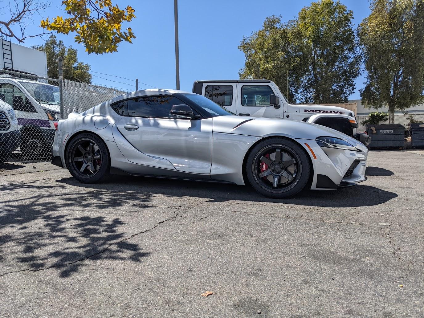

Just installed AC Schnitzer lowering springs:
lowering FA ca. 15 - 25mm
lowering RA ca. 15 - 25mm
Mild lowering and OEM ride quality

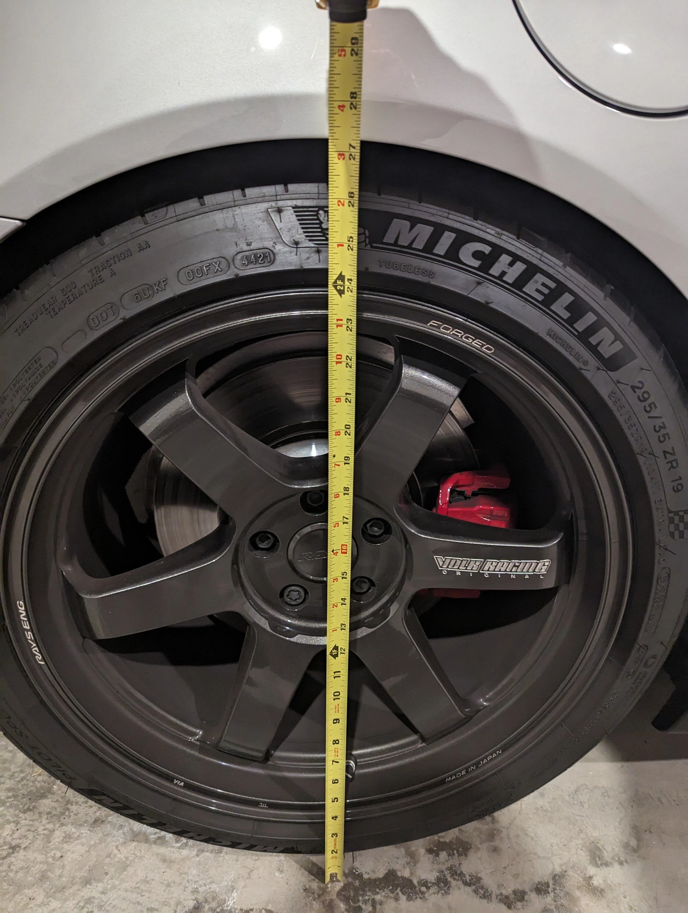

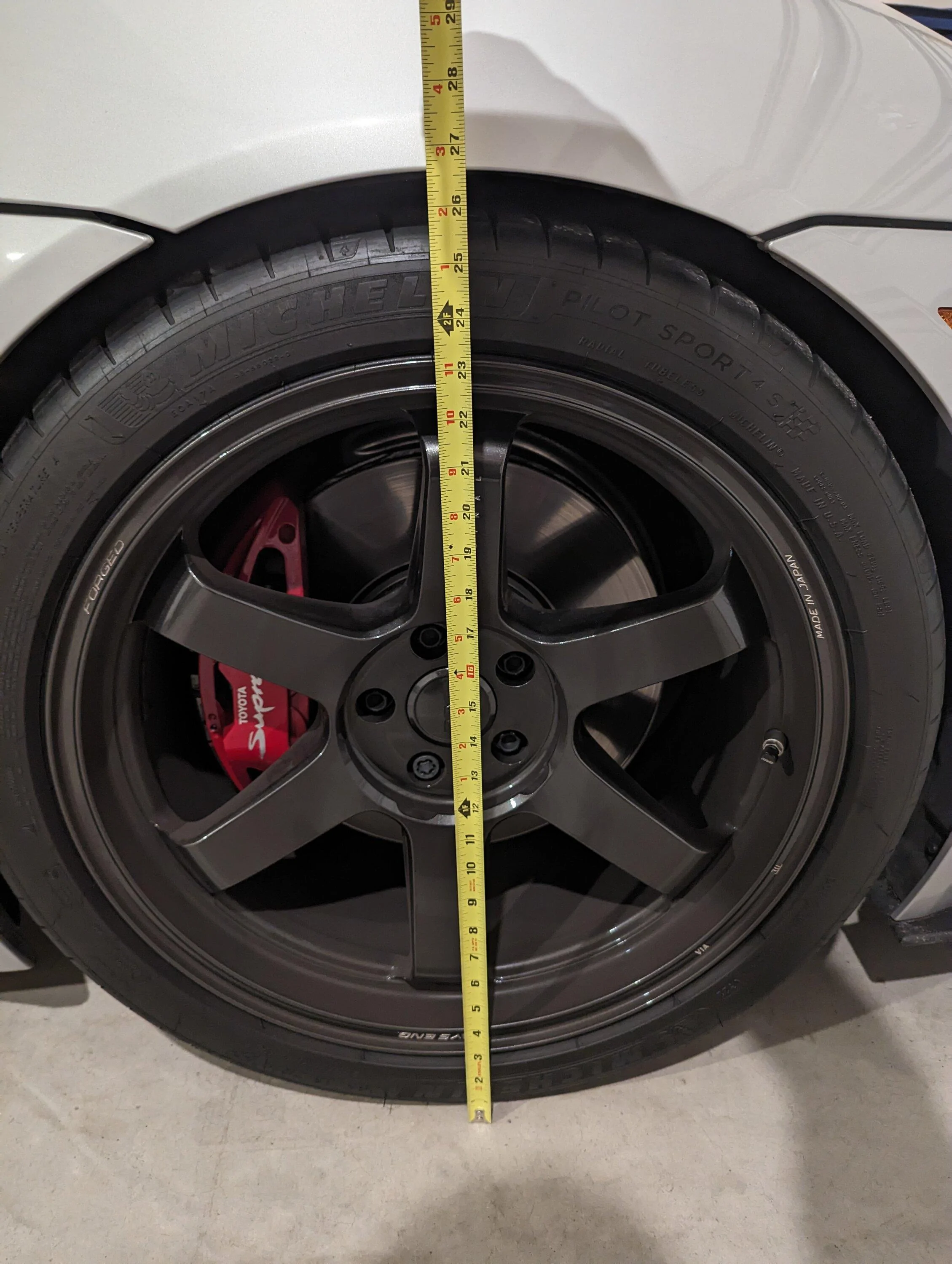

Do you know the measurements from the ground to your fender above the middle of the wheel? I'm trying to decide if I want to get these or the Euro Eibachs.
Basically I'm looking for the closest to stock possible but with a 1/2" to 3/4" drop.
I won't be surprised if ACS springs are the rebranded Euro Eibachs :) I was considering them as well, but then decided going with ACS springs together with their aero components

Thanks for posting those. They're close but it looks like they might be very slightly higher than the Euro Eibachs.
