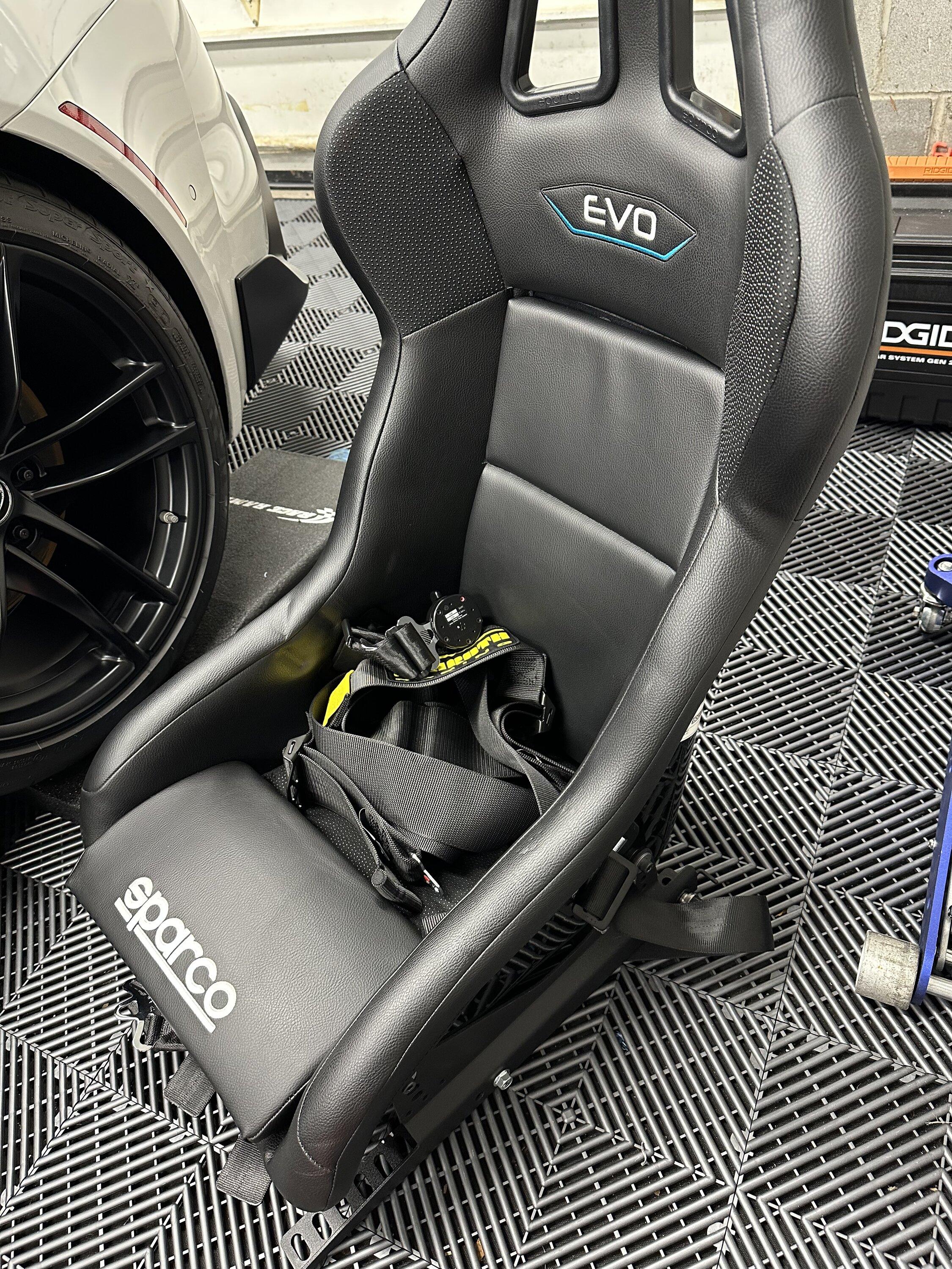

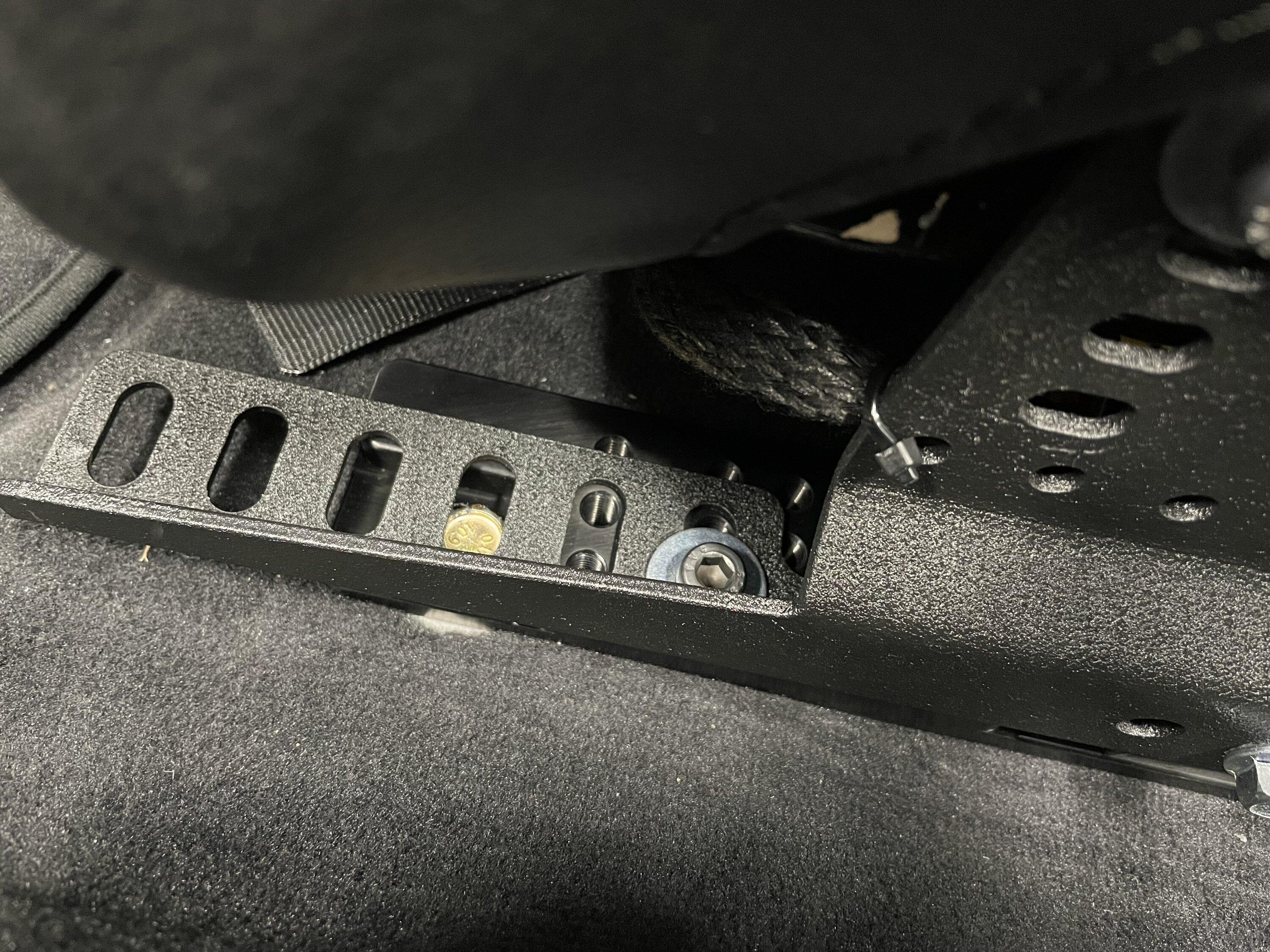

I was taking my seats out for a rollbar install and decided to do some weighing to see how much a proper bucket seat saves us.

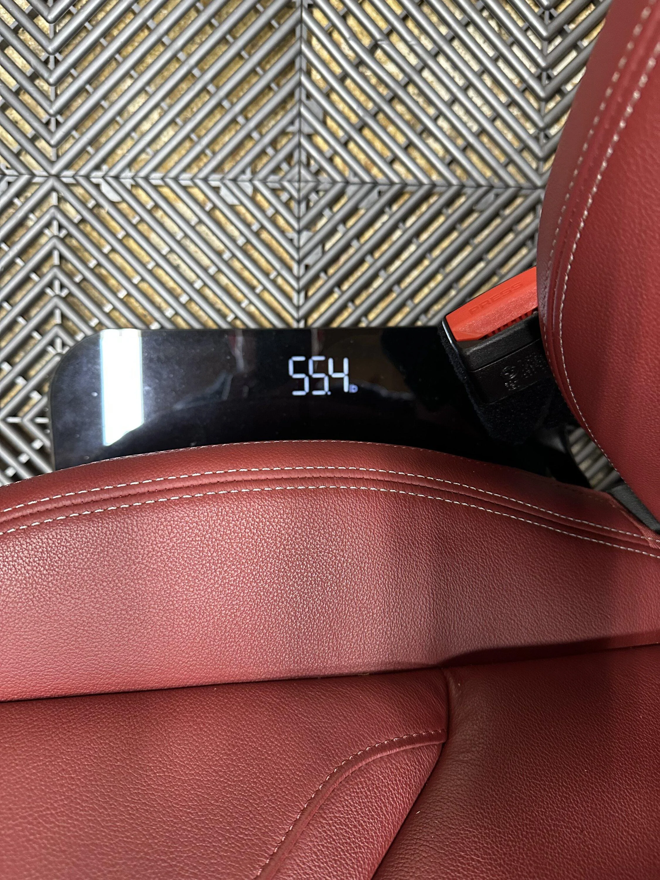

  • OEM Drivers seat: 55.4lbs

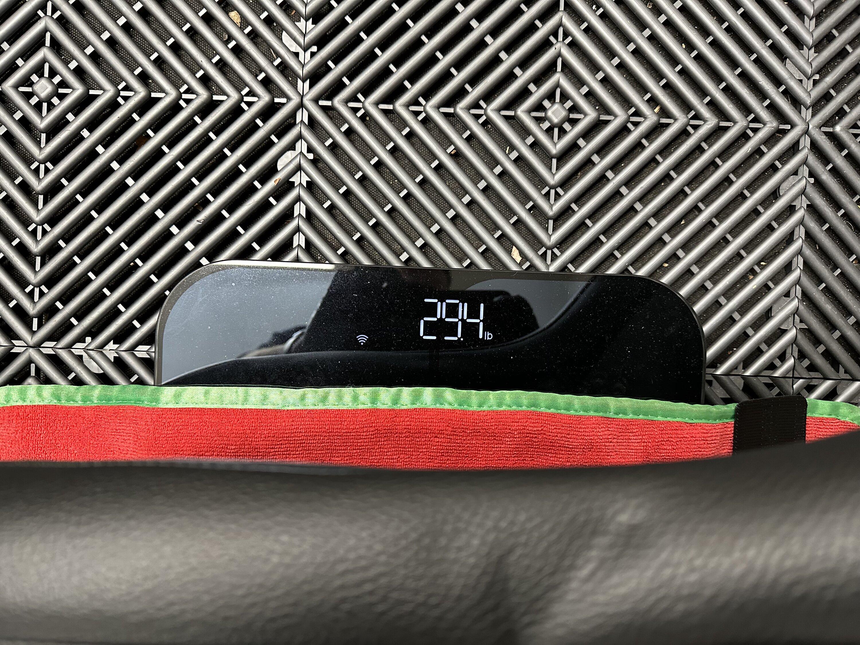

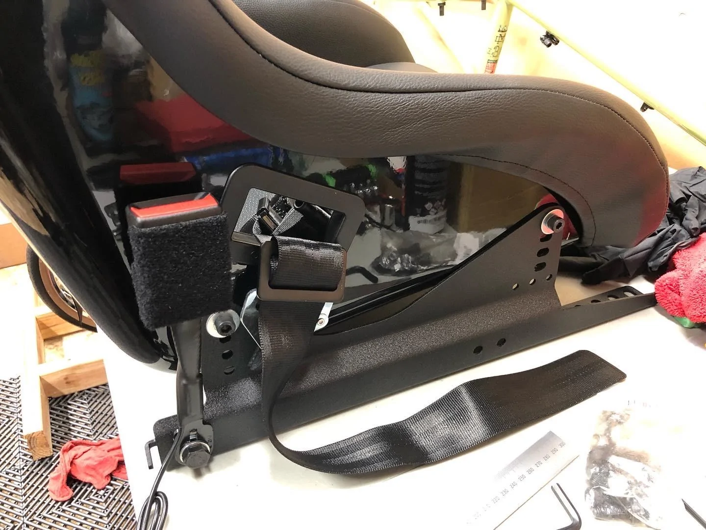

  • Sparco Evo with Brey-Krause side mounts, Brey-Krause six point bar (attaches to BK Side mounts), OEM belt buckle, and Schroth six point harness: 29.4lbs
  • Macht Schnell floor mounts, didn't take them out but shipping weight tells me they are around 3.5lbs
  • Total weight savings: 22.5lbs
Obviously you would save more weight without the six point harness and proper underseat mount but what's the point.

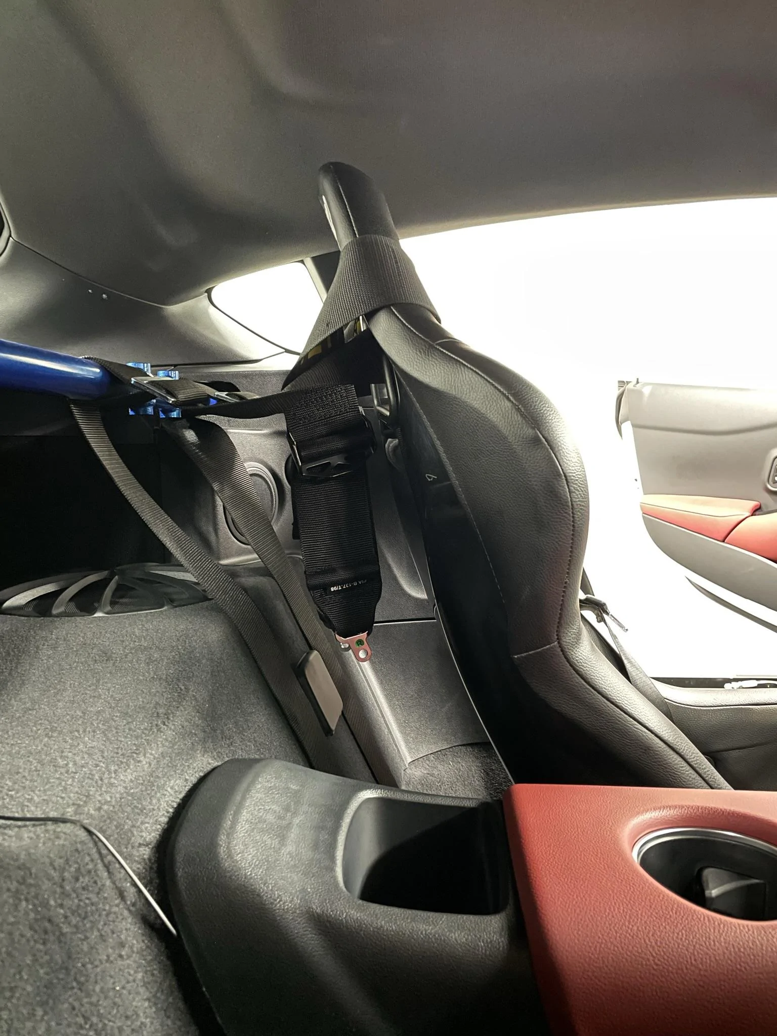

Does that give any head clearance compared to stock setup?
Great question! And less head jacked forward like the stock seats?
Rocksandblues
Bob
Sep 21, 2020
2,556
4,716
Virginia
Real race seats are designed for the helmet. Head position is so much better. I am 6,2” and my seat is in a low hole on the rails. I still have broom stick room above helmet
