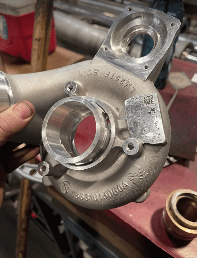

Right, that lip is there stock. They bore out the little whistle tip holes in that lip to make the whistle tip noises.
Sorta, its a whole machined insert, but close enough.

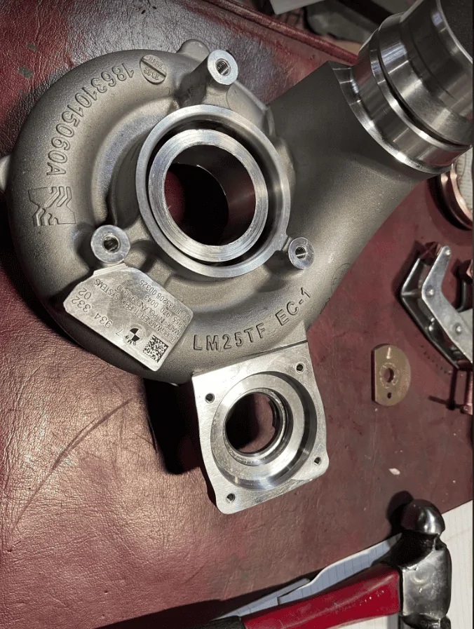

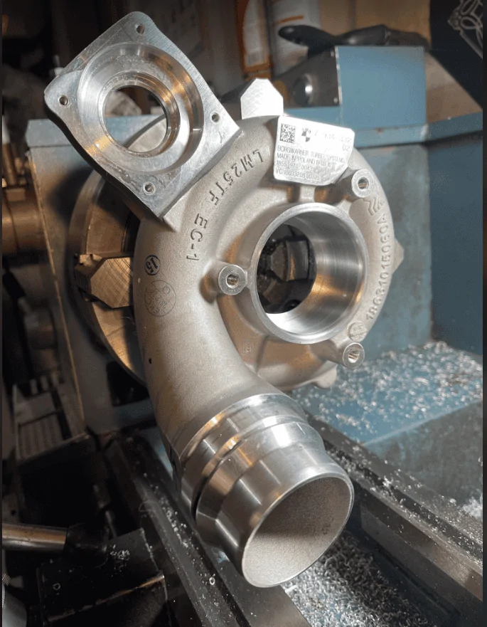

That makes sense, they bore out the OEM lip and press in the whistle tip?
basically. Its not actually a T51R mod, just inspired by it for the sound. I someone wanted to pay pure for their turbo inlet he could do that for sure, but this was done to make it fit stock inlet.
this one would be for an aftermarket inlet. its not bored out or finished, just testing
