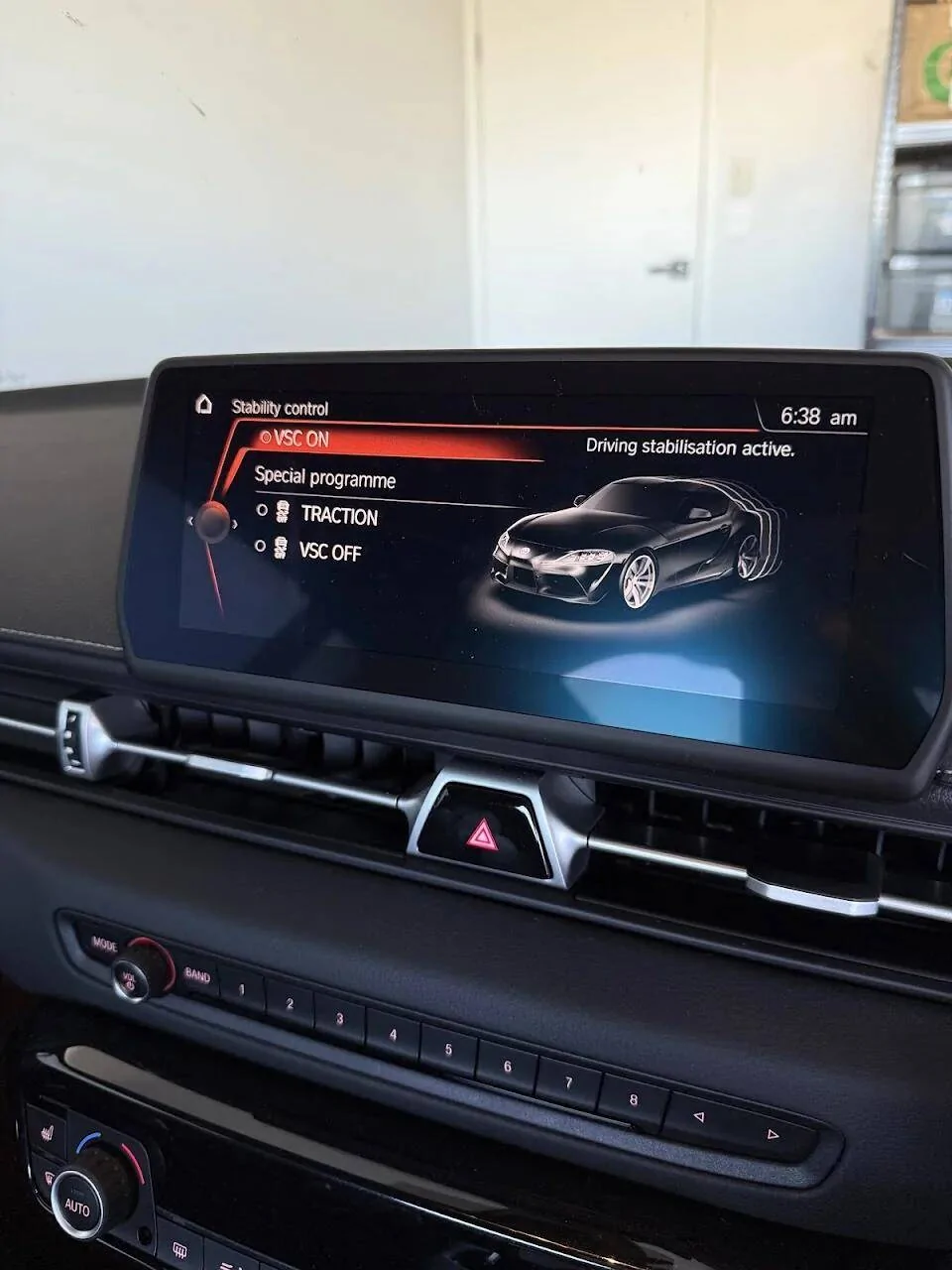

I have a brand new '24 3.0 premium auto and I am having a weird problem I haven't been able to find anything about online. 50% of the time I get in the car I get the expected 'Welcome Lucy' before it continues to the main screen/carplay once connected. The other 50% of the time I get the stability control screen which also automatically moves to the main menu after some time, but completely skips the welcome screen. VSC has always been on when the car has been turned off, the only time I've touched it was to turn it off and back on to see if that fixes this issue (it didn't).
Everything seems to work, no dash lights or warnings etc, but I would much prefer the expected welcome screen each time instead. I have also made sure to do the 'Getting started' section but didn't help.
It never seems to turn on/off by itself and the menu never appears mid drive (like what I'd expect if the button itself was faulty and triggering itself). It just sometimes appears when getting in the car.
Does anyone have any ideas?
I have tried to remove the popup like below but no change. (Did this from Z4 menu if that matters...)
FeatureECUMenuSubMenuSetting
Remove Stability Control PopupHeadunit3008 FESSTABILITY_CONTROL_POPUPnicht_aktiv
This is the screen I'm talking about.

Still need to check if there is an update.
I tried to reset but not sure if I did it correctly. I held the power/volume button down for 70 or so seconds with engine on - screen turned off and back on 3 times in that time but didn't feel much like a reset, each time it turned off it took the same amount of time to come back on.
I also tried it with engine off though the screen turned off pretty quick and just never came back on until I released the button. Issue persisted after both - first screen I see after it comes back on is the VSC screen lol.
I checked the codes, nothing.
Toyota support might be next on the list unfortunately.
It also looks like it takes time - if I stop for fuel and car off/locked and back on in a few minutes I get the expected welcome screen. A longer (5m+ or so) time turned off and it starts with the VSC screen.

the way it was explained to me: the goal is to give you the idrive experience as quickly as possible, but the welcome screen is also a loading screen. so if you wake up the car by unlocking the trunk to put in your bags or something, and take longer to get to the door, it may not display the welcome message. it's usually when the car goes to sleep and then you return to the car and immediately open the driver's door.
