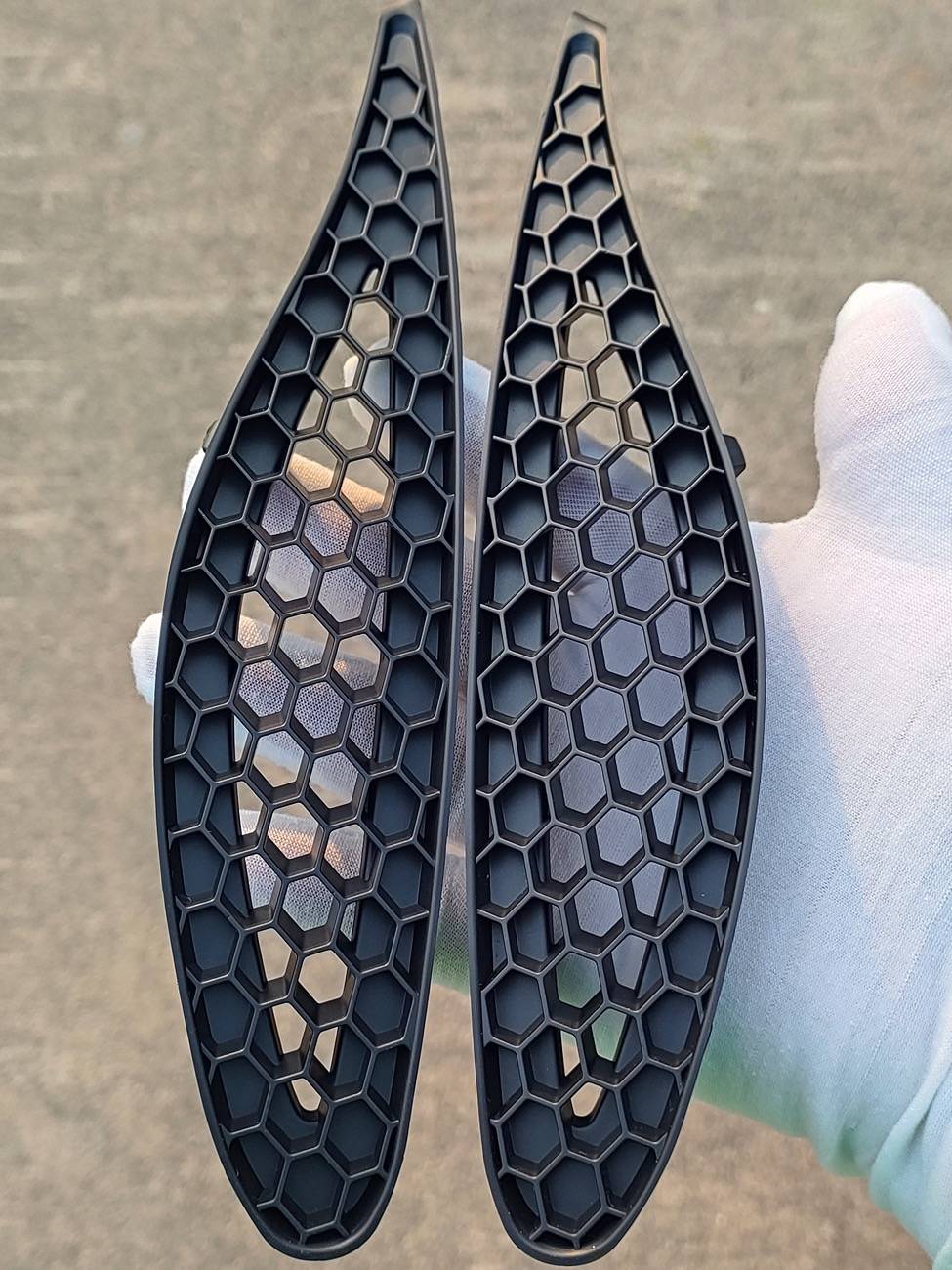

we are testing some alternative production methods with silicone molding/vacuum casting for lower production number products but ultimately the quality will decide if we will use it. So far they could not reach our quality standards.

Vacuum casting unfortunately can’t reach our quality standards and due to the moqs from our paint supplier the only realistic production method for us is injection.
I've done lots of vacuum casting and yes, it does sometimes result in parts that are not geometrically acceptable. Sometimes the material properties are different, also.

We also looked into reaction injection molding for larger parts but didn’t like the surface finish.
Like thermoplastic, single part injection molding, the surface finish of the mold used to create silicone mold(s) will reflect the part surface finish. My shifter knobs looked like glass because the aluminum master mold was polished to a mirror finish. Those were made out of an aliphatic/thermoset polyurethane. 2-part polyurethanes are best for thicker parts. What you have is ideal for single-part thermoplastic plastic that is UV-resistant.
