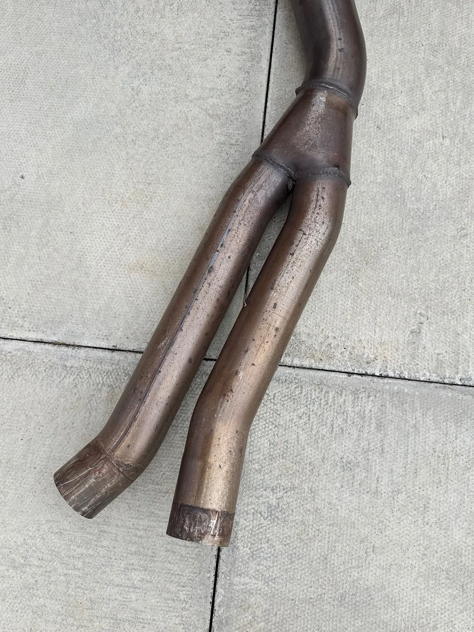

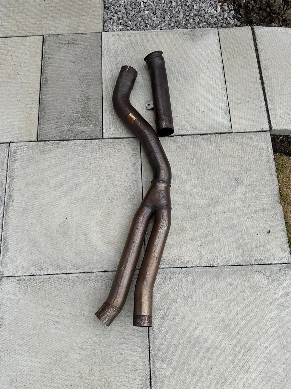

I have recently purchased a used Miltek OPF delete kit exhaust - I am having this fitted week after next, with the OPF Milltek Cheat Device.
Can you advise if there is anything missing here, before I look like a tool at the garage? I have checked on the Miltek website and the product photos look the same. Think I’m just looking for some re-assurance.
For reference, I am connecting to the standard Catalytic converter, and standard back box.

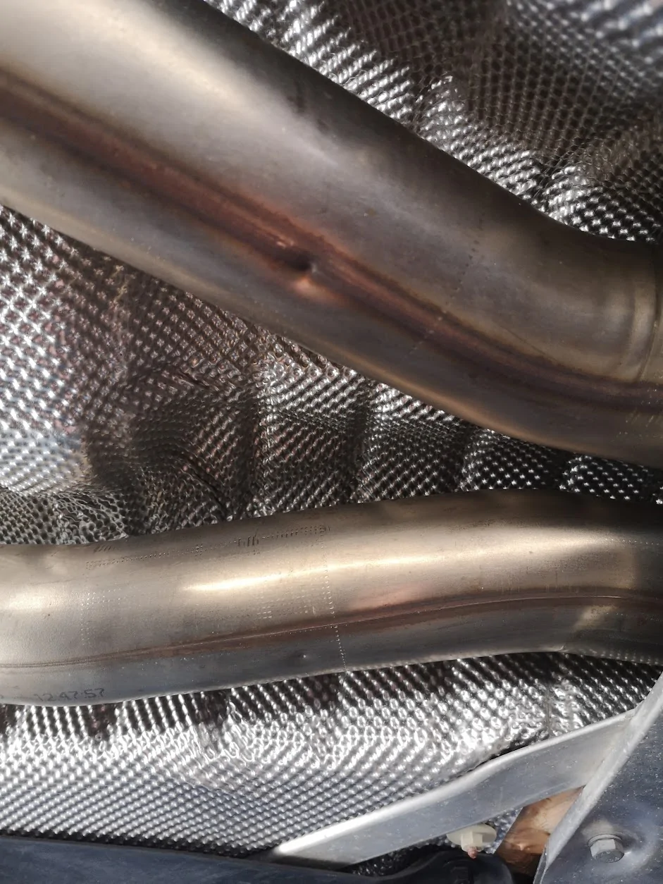

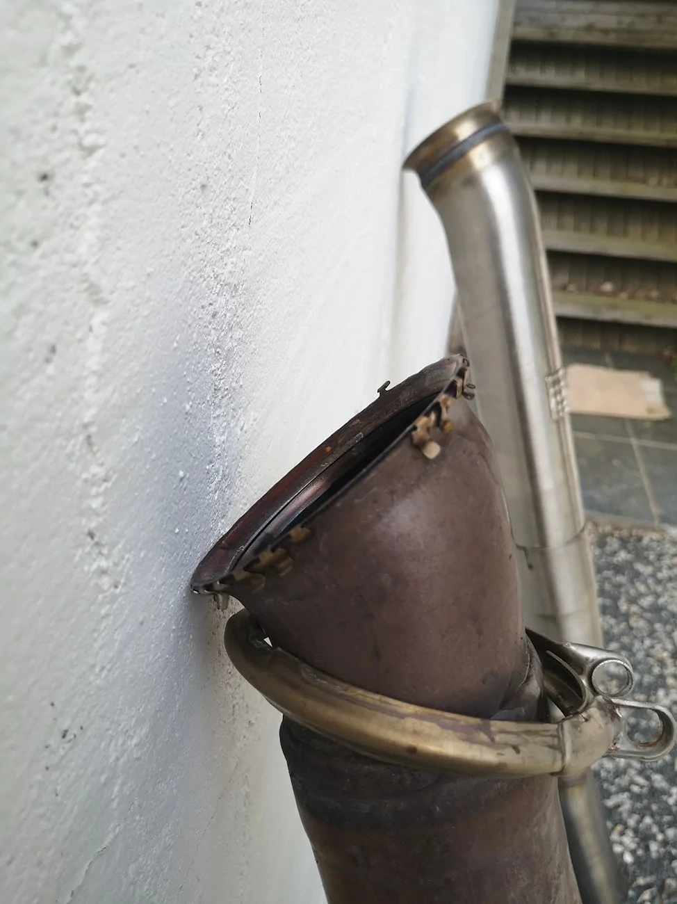

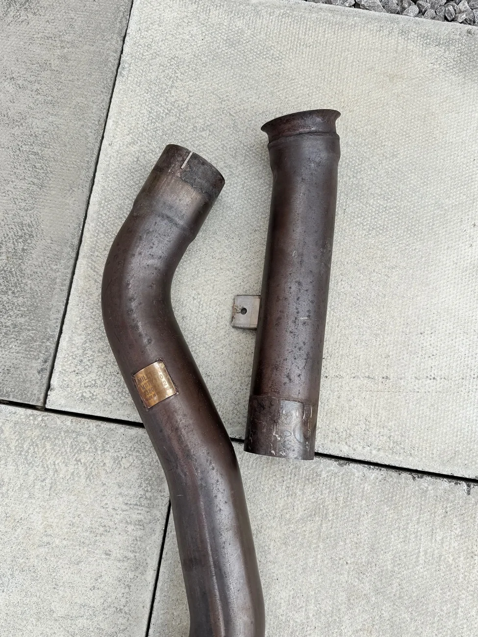

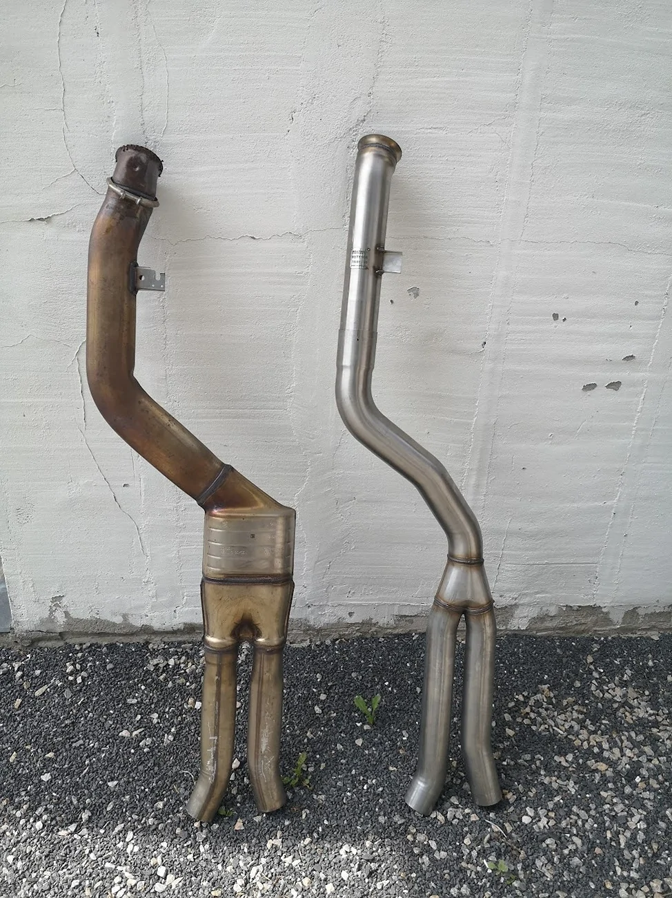

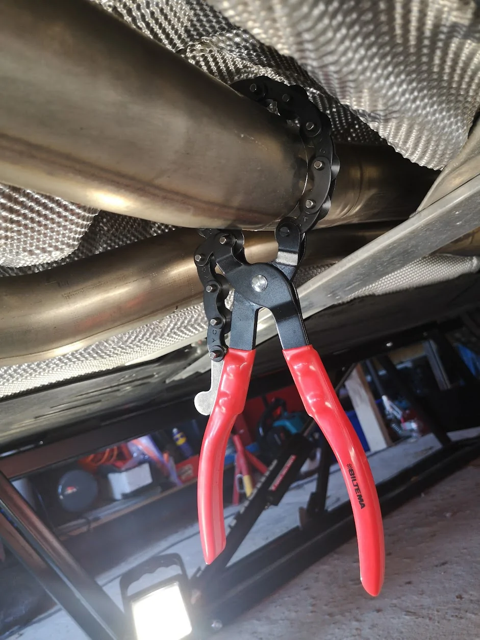

I'm running the same Milltek OPF delete on my car. Looks good to me, and I can't see anything missing.
The only issue I had was refitting the gasket between the downpipe and the OPF delete, as it made it impossible to get the V-band clamp back on properly. I ended up running it without the gasket, and I've had no issues with it for the past 3 years.
Tell the workshop to cut the pipes where the 2 large dimple/dents are.
Edit: The only thing that might be missing is the tube joiners. Mine came supplied with them for fitting the OPF delete with the original exhaust/backbox. A Milltek exhaust/backbox, however, uses pipes that slip over the OPF delete pipes, so they are not needed in that case.

Thanks Eplejus, really appreciate the detailed response and photos; sounds like I’m all good to go then and not missing anything! Phew. You know what it’s like where you start questioning yourself!
