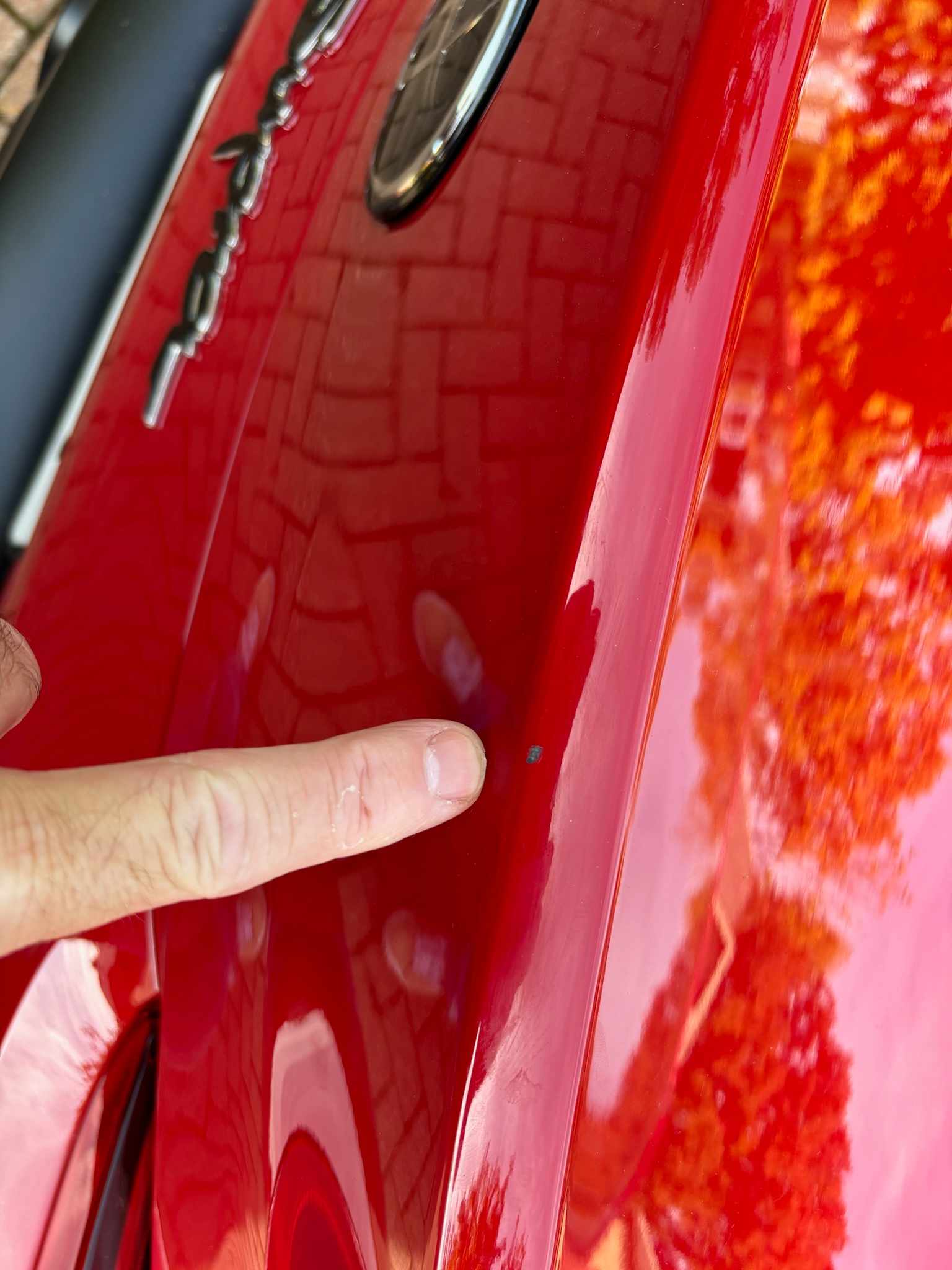

Has anyone had success with repairing chips yourself? What kit did you use, and were you happy with the result?
